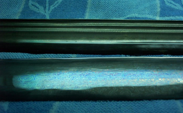

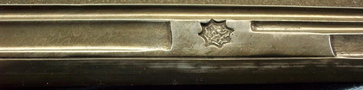

The blade on top exhibits regular so-called twisted star pattern. The one on the bottom has a few rows of stars separated by very fine white horizontal lines. This is what I consider to be a good Turkish Ribbon pattern
![]() BTW: The lower blade was restored using previously unknown to me powder mixed with water. It was given to me by a friend, and it is supposed to be from Middle Eastern mountain or river. The powder looks, feels and smells just like a plain mud/dirt, it easily mixes with water, and definitely has no acid in it. The pattern developed almost instantaneously upon application. I only have a small amount of this stuff, and have no idea where to get more. Anyone heard of this before? |
#2 |
Posts: 7,416
Depends on the powder. I would suspect that it does contain a mild acid. Alum does and is used for pickling, but mixed with water becomes a mild acid.

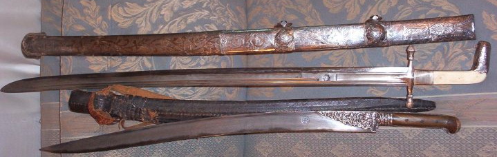

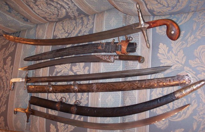

Nice blade and patterns. Would you post pictures of the rest of the piece? |

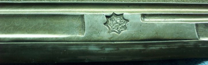

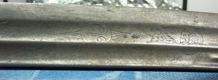

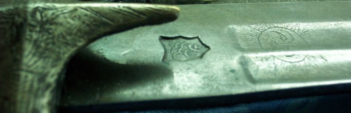

Posts: 936

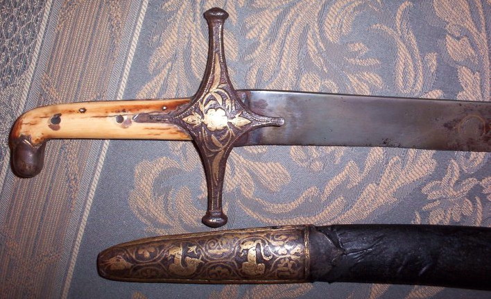

Posting pictures of the stamps on the possible "Kevorg?" blade, and another stamp and writing on another, possibly Caucasian blade. The writing seems Armenian with "1890" on top. The long blade is light, thin and flexible. I'd not go to battle with it, but it has some small nicks/scars on the edge...
Perhaps Kirill will have some comments on both blades (Thanks Kirill!!!). |
#5 |
Location: B.C. Canada
Posts: 473
Hi Alex,
For the middle saber you might want to look at Chechnia. There is a similar example in Askhabov's Chechen Arms on Pg 46. It is described as a Mountaineer's weapon. Jeff |
#6 |
Join Date: Jun 2006
Location: Arabia
Posts: 278
Hello there Alex,
