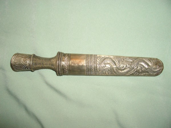

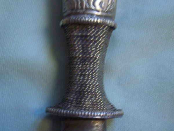

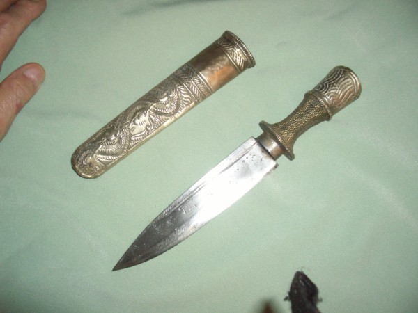

A strong blade, 5 mm thick, 14.5 cm long, heavily filed. An 8 cm long handle, rather short for European hands, with the distinctive style of the Himalaya. A scabbard with rather crude "repousse" work.
I think it is a recent work but a real weapon.
What would be its origin and name ?
Thanks for the help
Michel

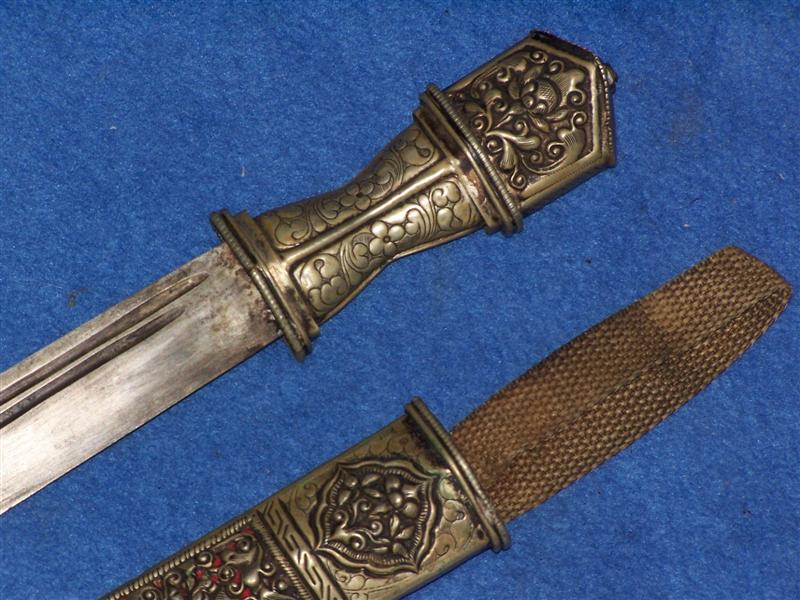

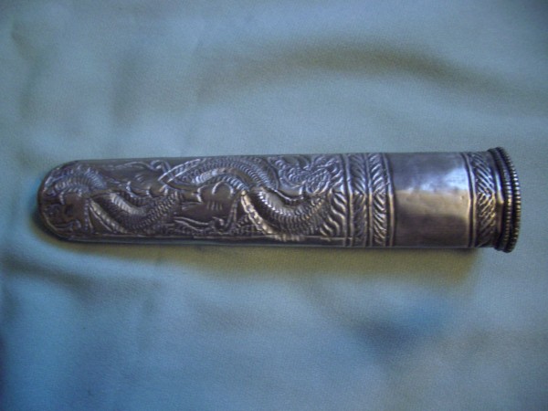

Here is a "modern" Nepalese knife used by a Hill person. (most likely 50 years plus or minus). I got this from a friend in Kathmandu. It was in dailiy use up until when I acquired it a few years ago. It is possible that it came from Bhutan.

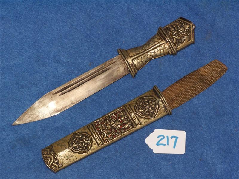

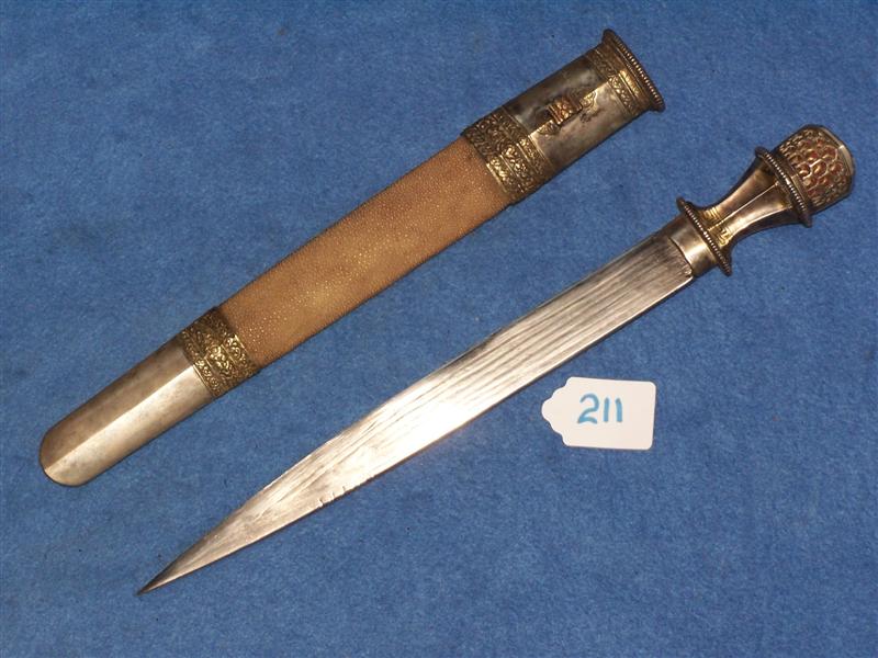

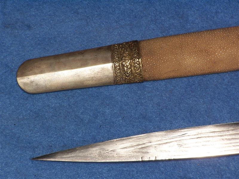

Here is a Bhutanese dagger I acquired from Lionsgate about 5 years ago when I first started collecting.

The Nepalese one is of a higher quality than mine but clearly close, in particular the blade.
The Bhutanes one is distinctly a few classes higher in all its aspects:blade, scabbard with shark skin and repousse work.
