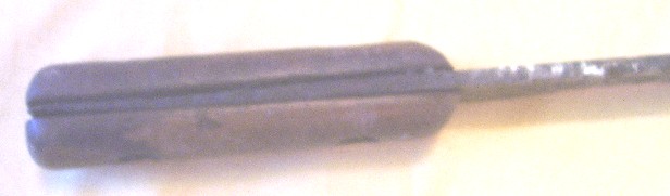

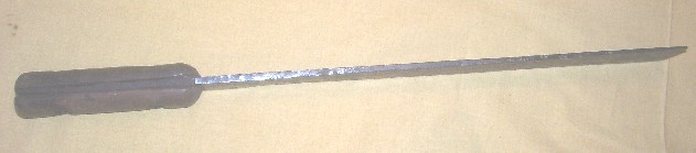

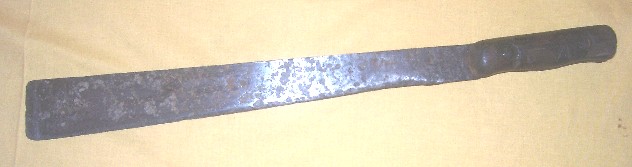

Hi,
bought this army issue machete, used extensively in SEA 'operations' during the last war.... I believe that this were locally made for the Army.
The 'slabbed' handle is of a unkown hardwood , The blade is thick, carbon steel approx 6mm thick and heavily pitted. A nice weighted feel to it.
The handle has a diamond 'stamp' with '131' and on the other side a rectangle with '437'.
OAL 19"
Blade 14"
Tip width approx. 2"
The 'squared off' tip, could possibily indicate the country or area of origin. I am wondering 'Burma' or thereabouts due to the style and the heavy British involvement in Burma during WW2.
As usual ....any information or comments greatly welcome....thankyou

Yep this is a mk.3 British issue Indian made Dha, mostly made in Calcutta & Dehradun.
Seems to have come out as a design in 1945,rather late for the Chindits expeditions but they were certanly used in Malayan emergency. The earlier ones {Mks 1 & 2 & numerous unmarked variations.} were built as weapons & were often damaged at all the tree work they were often used for.
The mark 3 was heavy & clumsy in comparison to the fighting models but solid enough for tree felling.
Spiral

However, it weighs only 1.1 lbs (500 grammes) and although slightly 'tip heavy' does not feel 'cumbersome'. (balance point is 9" from the 'pommel end')
Could there have been some variation with the Mk3, this machete feels like a compromise between a fighting weapon/vegetation chopper, and the steel used seems to have quality.....although the blade's edge is heavily rusted and has not been sharpened for many, many years ....it still feels sharp along most of its length...which surprised me.

The blade has distal taper 6mm at the handle, 4mm mid point and 1mm at the tip. With the balance point 9" (from the end of the handle) out of an O.A.L of 19" gives approx. 47% of its length. Now, I am much more happier that its not exclusively a 'garden tool'
If this is not the usual spec of the Mk3, could this be, perhaps a MK2 blade in a Mk3 handle
