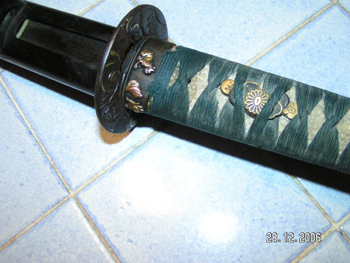

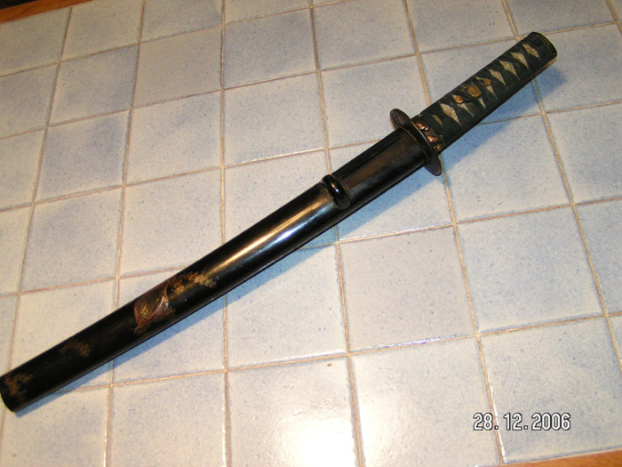

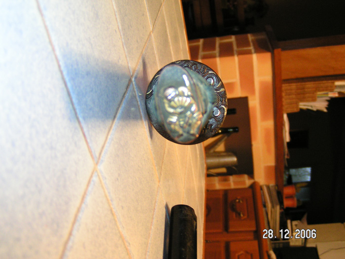

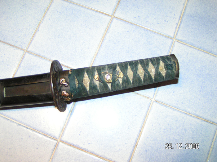

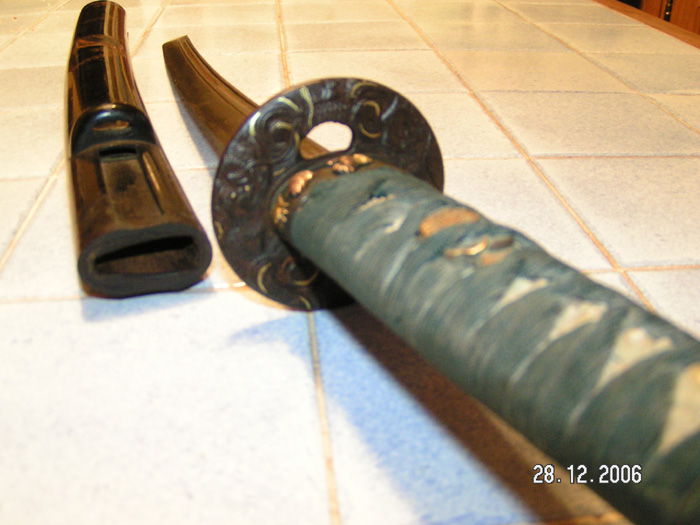

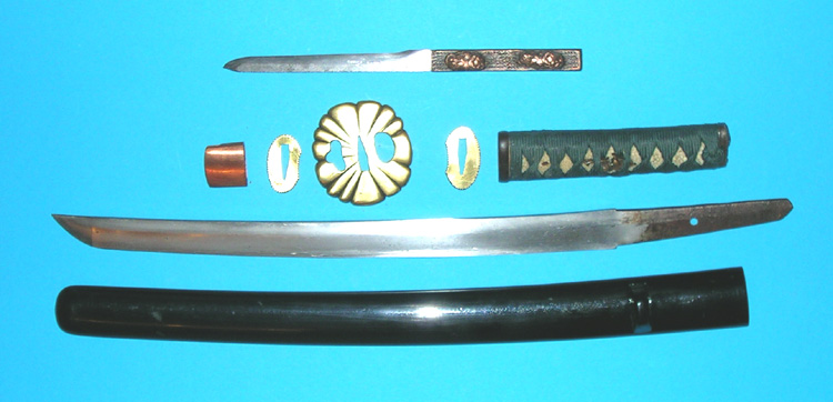

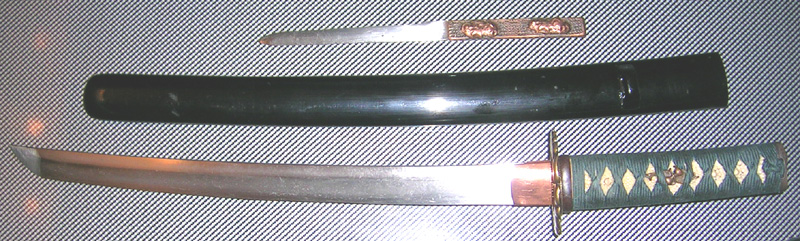

my new japanese wakisashi

I figured after all these years I've been reading this forum that someone
would sooner or later post something about Japanese swords :-)
Nice looking sword, unfortunately I can't tell much about it from the
one pic of the blade. Is the nakago (tang) signed? Are the fittings (tsuba,
or fuchi) signed?
From what I can see, I really like the tsuba motif of the menuki. Really neat.
If anything is signed, please post a readable pic of the signature. I can tell
you more about it if it's signed. Maybe some better pics of the blade would
also help. Sometimes the style of hada and hamon can indicate the maker
or at least the school.

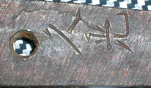

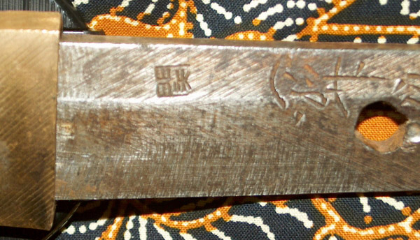

I made some pictures of the tang of a wakisashi I bought some time ago.
it is fitted with miltary mountings and has a wooden katana scabbard.
Nothing special at all, but I'm curious to the signature. If you can make anything of it, please....

Henk -
It's a WW II sword; has a Seki tang stamp. Smith is Kane something,
but I can't translate it all off the top. (Have had a couple and killed
a few brain cells this evening). I'll get back to you and post a translation.

Henk -
The translation is:
Seki junin Fujii Kanefuji saku (関住人藤井兼藤作)
Courtesy of the folks at the Nihonto Message Board.

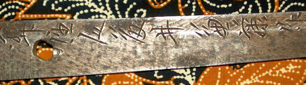

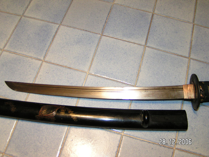

I take advantage of this thread to send a pic of the tang of a wakisashi I bought some time ago to have a translation.
Thank You in advance and a Prosperous 2007.
Paolo

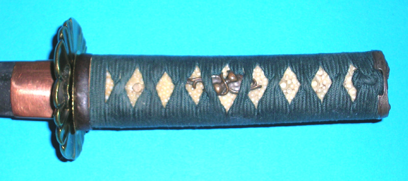

Sorry for the mistake, here is the pic.
Paolo

I believe it reads "Hisamitsu"

Thank You, very much, but knowing nothing about Japanese edge weapons, what does it mean ? Is it a sign, an arsenal, the name of a smith ?
Paolo

It is the swordsmith's name. But there have been many smiths with that
name thru various periods of Japanese history, so I can't date it closely
or tell you which Hisamitsu. I would suspect the sword is somewhere in
the Edo period, circa 1600-1860's.
Rich S

Hi,
Sorry to tell you, but to me it seems one of thoose better chinese repros... Well maybe I'm wrong, just the overall appearance talks in that direction.
