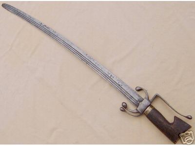

That's what we call a nimcha in N America, anyway, Greece, too? I hear it's called a saif (sayf) in Arabia and Africa. Saif, or "sword" seems to be the term for a long sword, while I am told that nimcha actually means something about short or small, so the threadstarting type may actually have a better claim to the name....confusing and irrelevant enough? What I've meant to mention about these is that their wearing at formal occasions, as well as their shape (highly curved, thinnish wedge-section blades with fine cutting edges) are suggestive of butchery; typically Berbers feast on freshly slaughtered meat.
There was an interesting varient on ebay recently; I'll see if I still have the number.
I do, and it's like a cross with a flyssa; #6512009521

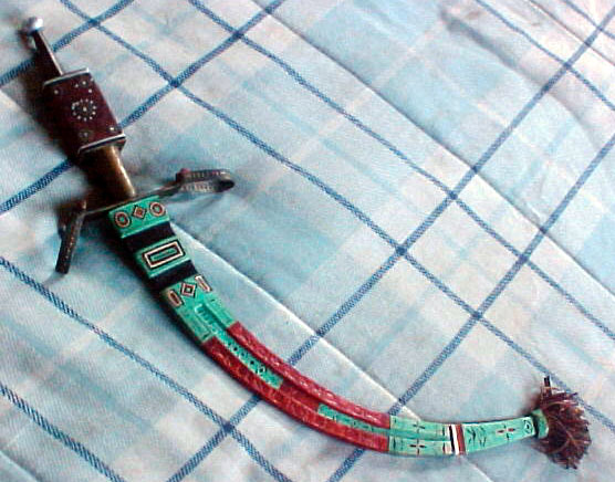

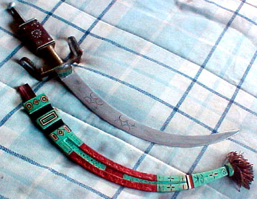

When I try to follow the link it comes back cannot be found, but from what I've read I'm fairly certain I know the items being discussed here, which immediately made me think of THIS piece and wonder if it's not in the same category?
Overall length 19 1/2" with a 13 1/2" blade that's 15 1/2" if measured along the outside of the razor sharp convex edge.
I picked it up as an inexpensive tourist piece on a whim, and as is so often the case, was quite surprised when it arrived.
For all of it's awkward appearance, it's surprisingly comfortable in the hand with the "guard" hinged so that it adjusts to the grip.
The entire piece is VERY well made, solid and razor sharp with a definite Taureg style, even down to the coloring.
While my initial reacion was that it's gaudy, in fact it's EXACTLY the same colors as a traditional takouba, with the exception that most swords seen are well aged and thus faded.
If this is in fact a Taureg version of a "Nimcha wedding knife" then I'm inclined to think that perhaps both were or are originally ceremonial weapons/knives that are just so exotic in appearance that they've gained wide appeal in the tourist market as well......this goes well with something that Artzi Yarom once told me, that most of the "tourist" pieces are or were real, traditional weapons first and NOT something dreamed up just to part the traveller from his funds.
I hope Artzi will forgive me if the quote isn't exact, but I'm fairly certain it's close in content.
Just as an added thought, while experimenting with different grips I found that if this piece was held with the convex edge facing out and the tip facing the elbow it would be capable of delivering an incredible slice that would have a tremendous disembowelling potential, almost always gauranteed to stop a disagreement, making it far more formidable than it appears at a casual glance.

Nice. Is that single edged? How does that squarish handle part work in the hand?

Posts: 10,851
Hi Mike,
This colorful piece you post is most definitely Saharan, and as you note, quite ceremonial. While it is likely found in Tuareg territorial regions, it is most likely not Tuareg, even though clearly influenced by their weapons as you have observed. The blade seems almost like a remnant of a shamshir blade with the clear parabolic curve. The flamboyance of the hilt and scabbard suggest to me Burkina Faso regions, where Mossi tribes prevail, and the extreme colors bring to mind the Fulani of these same regions (who incidentally also carry takoubas). The opposed semi circles on the blades seem interpretive of the opposed crescents seen on takoubas, which may be the Tuareg influence suggested.
I like the reference to Artzi's comment.His perspective on ethnographic weapons is brilliant, and his opinions in discussions paramount. As he perceptively has noted, in these regions even weapons that are primarily elements of costume, are meant to be worn traditionally and carry great significance to those who wear them. Although many are not of the high quality once required when prime combat weapons, they are not simply 'tourist items', in most cases. The ones that are can be easily recognized...they look more like letter openers!

As always, thank you for the information Jim, and I've noted the Mossi/Fulani attributions...the takouba, like the kaskara is found over such a wide range that it's easy to erroneously focus on just one small area and thus leave oneself with built in blind spots.
Tom, the hilt is surprisingly comfortable in the hand as it's small enough that your palm just wraps around it, and yes, it's single edged, sharp on the outside of the curve widening to a thicker spine on the inside like a "real" dagger! **grin**
If you take Hal's comments about a "whirling dervish" style of fighting it's actually easy, as I said, to imagine this slicing without effort and yet having the potential for a return thrust, if delivered upward that would automatically slide right into the chest cavity, a "one-two" attack with awesome lethal potential that actually feels natural and probable, quite unusual for a ceremonial/tourist weapon.
