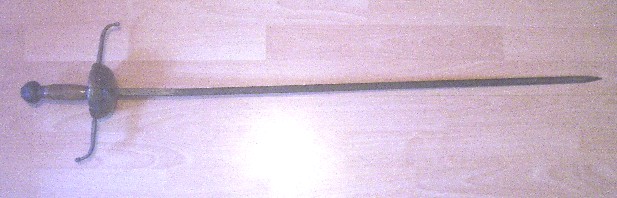

Default 1730 Rapier or a Victorian 'Copy' .........any ideas?
Not an Ethnographic weapon.....but I know there are those on the Forum with exceptional knowledge of early European blades.

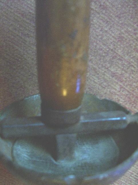

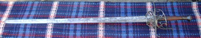

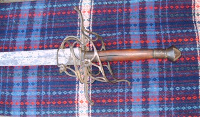

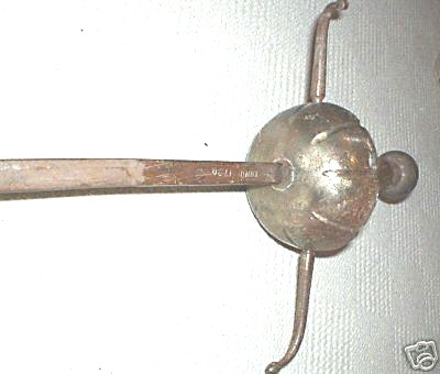

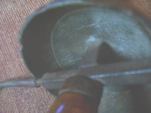

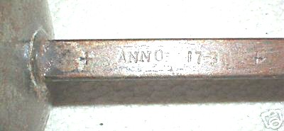

I have taken a chance on this....it is 44'' long overall, cup hilt with s- shaped cross guard. Inscribed 'anno 1730' (obviously could have been engraved recently)...certainly has age....the 'acorn' shaped pommel seems to have the tang 'peened' over.....not the usual 'screwed on' type typical of 'Victoriana' wall hangers.
The sword weighs nearly 2 kgs , approx. 4.4 lbs, no scabbard.........The handle is leather covered wood.
So Gentlemen......please tell me....what have I got?
Old 23rd November 2006, 09:48 PM   #2
Posts: 6,006
Hi David.

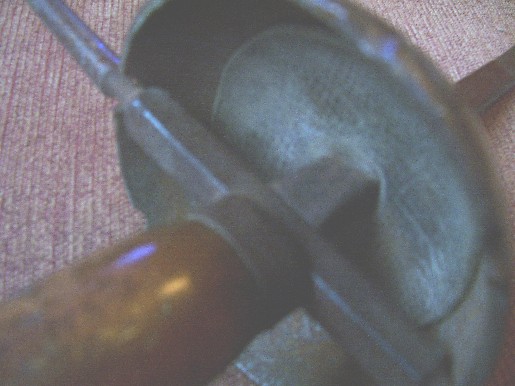

What is the pad in the cup made of? I am not sure about the engraving the style is quite modern looking to my eye. It is certainly a very heavy version of an epee like weapon. The picture are not that good. Could you take better pics?

Hi Tim, not in possession of the sword ...yet. It'll be on its way soon.
I believe the pad is leather....but not certain. I agree the lettering seems suspect...but I have seen, on the net, examples of engraved lettering from around that period (early 18c) and it could be authentic .....but then again a good forger would ensure it was similar....
I also agree about the weight......seems business like, have you any further thoughts on it?

With the usual disclaimer about how cautious one has to be doing evaluations through photographs...
I would say it's a "Victorian Copy", meaning it's a piece made for decoration, probably quite some time ago, but not that much as 1730. It's an attempt to a cup-hilt rapier, but it's only intended to look kind of well in a wall. Not even the blade seems original, also, but I would need better pics to really say that. Just some hints, as I don't like to just drop statements without some reasoning behind: the quillions are wrong, in shape and section, the construction of the hilt is wrong, the different elements don't harmonize together, and the blade, as I said, for what little I've seen is wrong, too. And, if the weight is correct, then it's too heavy, also. I apologize for not being more precise, but I'm a bit shorto fo time, right now.

Nearly 4 1/2 pounds in weight!
So No chance its a real fighting rapier, so then i would say it must be a wallhanger.

The date inscription is definitely later than 1730. If applied at the time of the manufacture of the blade, this one is a fake.

I thought that, if this piece was generally consistant with cup hilts of the early 18th century, the stamp could simply be a catalogue mark. This would support your theory of a costume piece. Logic would dictate that a good costumer would want to keep weapons and costumes period-correct and.

Actually Schmidt, and probably others who entered this cottage industry, did not intend to deceive or defraud buyers..it was later owners who tried to pass these off as authentic. What you say seems very possible, that such markings might have alluded to the sword or type the interpretation was taken from, but this sword does not correspond to examples I am aware of, especially not as late as 1730. I think this item was fashioned with a degree of artistic license, as might have been the case in Victorian times as noted.

Well Gentleman....the sword has arrived...and provided more questions than answers........

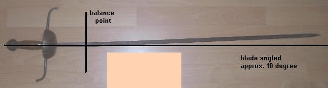

The Rapier sits well in 'the hand', it weighs 2.5 lbs. There is no welding or braising evident anywhere on the sword. The cup hilt has a worn leather disc inside. The arrangement of cross guard and cup hilt 'invites' your index finger to curl around the crossguard behind the 'cup'. This hand position provides greater control of the blade. The balance point is situated approx. 10'' (26cms) from the end of the pommel. Interestingly the exact point at which the doubled false edges start....the blade finishes in a very sharp point. The tang is peened over the pommel. The hilt is slightly 'offset' from the blade and the blade itself is angled (approx. 10 degrees) from the 'centre line'. The overall impression of the construction is that it is a 'solid', no frills, 'useable' piece
Also at the 'ricasso' (?) there are crude markings ....3 dots (in a line)...then a symbol ( two 'C' 's back to back and joined at the curve. similar to the 'Chanel' logo)..and then another three dots in a line. (see diagram below)
I'm beginning to think that this was a practical piece.......perhaps a practice rapier of the Victorian era?
Comments gratefully received .......
