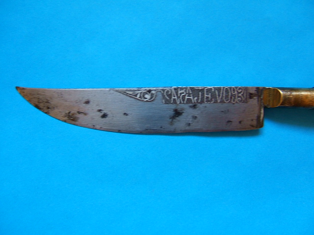

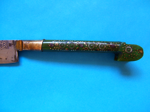

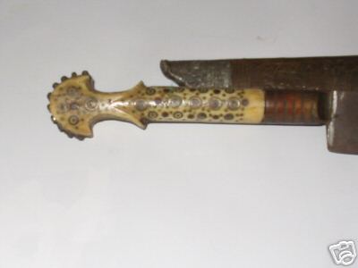

This just ended to on ebay and was mislabeled as a Yeman dagger. the hilt is a of a different design when compared to my other dagger. How many hilt variations are there on these daggers? It seems that both daggers have the same makers mark? I found the same hilt design on a dagger in Tirri's book today also with the same makers mark on the blade. Here is a small version with a green bone hilt that I picked up this week.

This one does seem a very different variation with this form pommel!
The shape brings to mind of course Moroccan koummya daggers, which seem a bit out of place in Bosnia. It seems that in research on the koummya, if I recall, it was suggested that the distinct arc shaped pommel may have derived from the Italian cinqueda hilt. Possibly there may also be a common influence root here?
One key thing I seem to see often on these Bosnian daggers is the dot and circle motif, which in turn seems to derive from very ancient symbolism and is often seen on various weapons especially from regions in and around Afghanistan. I've seen them on 'lohars' (or whatever they are!)and on a Buzkhashi whip I have (OK, no wise cracks about whips guys!! .
Another thing noted on Bosnian weapons is those raised studs or posts that look like cleats on a sports shoe. These seem to appear on various edged weapons from Bosnia, including the yataghans. Anyone have ideas on any possible symbolic significance? Seems like it would make these weapons a bit awkward to handle.

MY favorite is the green dyed ivory hilted one - little rarer than the rest.

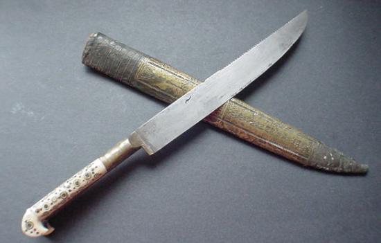

Great pieces Lew. In Hermann-Historica's "Dolche und Messer aus dem Persichen Kulturraum" there are some examples, which help illustrate the variety in styles.

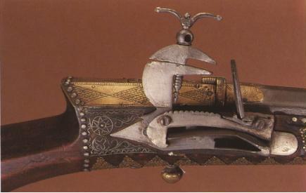

I am not sure if the dot and circle motif is derived all the way from Central Asia, but this type of decoration is found on firearms from the region - you can see them on shishanes's stocks.

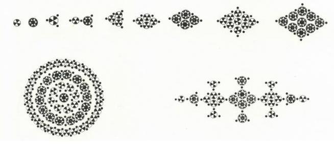

These simple geometric motifs seem to be found in various cultural spheres of course, most often suggested as having solar symbolic significance.
They are in any case quite ancient, and with trade routes, may have diffused widely.
An amulet from early 3rd century BC was found in Mathura in India made of bone, and with these dotted circles, and associated with protection i.e. shield significance.
In "The Afghan Amulet" (Sheila Payne, 1994, p.153), the author notes that "...the Kurds decorate the tombs of men with daggers, guns and tools. All are carved with solar circles, just like the tombs in Sind. They worship the sun and fire, just like the Zorastrians. They believe in the magic of a circle, which drawn around them will protect them".
This simple symbol in ancient Chinese meant 'sun' in the oldest Chinese writing ("Dictionary of Symbols", Carl G.Lungman , Sweden, 1974, p.25).
The influence of early China is well established over the ancient world, but it would be difficult to suggest direct links to the appearance of such a simple geometric figure in the contexts mentioned here. It does seem worthy of note regardless.
It would be interesting to know of other weaponry or material culture where these dotted circles appear.
