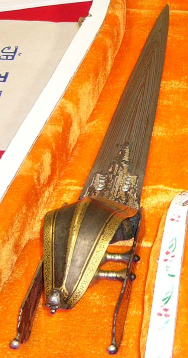

I am a new member and am very interested in the collection of indo persian weapons (especially edged) such as the katar image attached (not mine )
I am looking for advice on how to care for indo persian blades especially those with wootz blades as i am awaiting the delivery of a wootz tulwar.

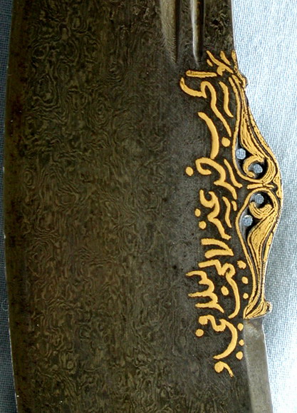

Lew, please forgive my ignorance and lack of knowledge - I am not familiar with the term "restaining". May you clarify it?
Also, every time I try to clean rusty spot(s) by any mechanical method(s) I end up having a zebra-like wootz blade covered with light and dark spots, so I personally prefer to clean/lightly polish the whole blade evenly, and re-etch it. Most of the times the end result is more attractive and even-patterned blade. You'll hate me for saying this, but in these cases the aesthetic appeal takes over the historic preservation concept. Sometimes I just can not help to find out what the pattern will look after cleaning and etching... Hey, look at most famous old paintings - many were restored, I've never heard a concept of not touching an original painting or a sculpture or a building to "preserve its history". In addition, is beautiful wootz blade is not the same or even better work of art after it is polished/etched to reveal it's original beautiful pattern? It is granted that it MUST be done by someone who knows what he/she is doing!!!!!!!!!

First I agree with Lee 0000 steel wool is great for removing any light surface rust. I do not like using any type of wax on wootz blades they have a tendency of cleaning or removing some of the etch from the blade. I would only use a good oil. Mineral oil is ok for starts a light coating will do make sure to wipe off the excess oil from the blade. Alex yor jambiyas etch is fine so I would not fool with it just a bit of oil will be fine. The only time I will etch is if a have a rusty old blade which I want to check to see if it is wootz. After a good cleaning I apply a weak solution of ferric chloride to a 2 inch area and I wait to see if the pattern pops through. Some wootz blades have been so over polished over the years that they can actually loose there ability to have the pattern brought out.
