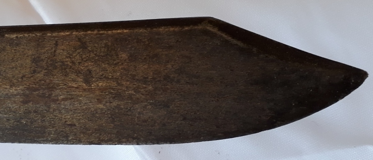

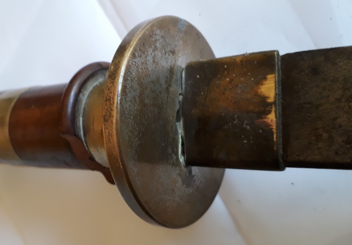

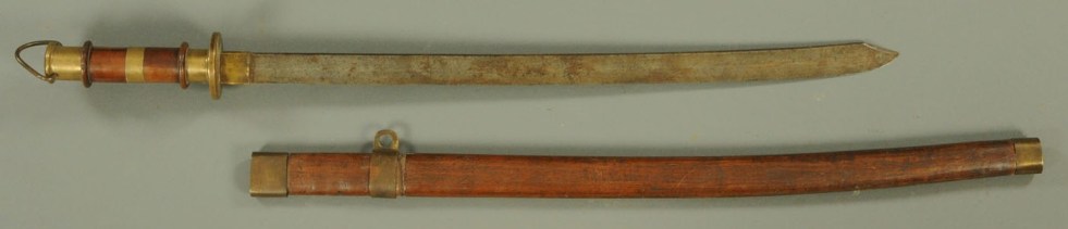

Does anyone have any idea about this sword?
I bought it without knowing what it was. Normally I’d say that was a dumb move, but I was very curious and it was affordable.
I can’t see any makers or other marks.
It feels very solid, and fairly heavy for its size – 1kg without the scabbard.
The blade is 615mm, the hilt 150mm (not including the suspension loop).
I think the blade may be of a laminated type, but my inexperienced eyes can’t confidently see through the dirt and tarnish. It has a pretty good edge.
The brass components of the hilt show traces of silver plating.
The shape of the blade (goose wing?) to me looks possibly Chinese, and the hilt looks very vaguely Tibetan...........maybe.
If I had to guess I’d say it might be from China, perhaps from a local armoury or arsenal during the first half of the last century. But that’s just a wild, uneducated guess, I have no idea really.
I’d be very grateful for your opinions.
I’m sorry the pics are pretty poor, I’m happy to try and take some better ones if it’d be helpful.
Thanks in advance,
Casaubon

The picture is small but from what I can see, the metal tassel ring looks like the one on my NCO shin gunto. Considering the length of the sheath, could the tip of the sword have been broken?

Sorry, but the closest that has been to Japan is China or Indonesia,etc.
Not a Japanese NCO or Shingunto IMHO.

Best guess is Indonesian, imitating a Shin Gunto. We know these were made with very variable approaches to copying the original. Carried by officers in PETA ... The Indonesian Independence militia.

I'm sorry for being unclear. I didn't mean to imply that the sword was in any way Japanese but rather that the part may have come from a Japanese model 95 or may have been copied from same. I still wonder if the tip of the blade had been broken off.

Almost bid on that one myself. It's an oddball and opened cheaply. Had other irons in the fire tho. The Dutch are fond of clip pointed swords, so may have been a Dutch East Indies area marriage. guard look dished like a Chinese one, tonku looks odd, grip is round like Burmese/Thai Dha/Daab, raised rim bits of wood over brass are odd, and the loop on the pommel may have been for a sword knot or tassel. All in all - unusual. Probably WW2, doubt it was in any way japanese military. Police maybe?

It's worth being aware of these guys, as their swords keep turning up on the collectors market. They are often called "Island Swords" or even "Last Ditch" but are in fact local made copies of, or are influenced by Japanese Shin-Gunto. Follow the link for more about them
I think these blades are collectable, but worth bearing in mind that they are not Japanese, and this effects resale value.

Wayne is on to something I think with his reference to the clipped blade of the Dutch klewang (a.k.a. Maréchaussée sabel), which has been discussed on these pages previously—see, for example, here. The blade of the sword that Casaubon shows has a tip similar to that of the Dutch klewang, but the blade is not from that sword—the Dutch klewang has a curved blade and the fuller is different.
Many, many Dutch klewang were modified by occupying Japanese forces in Indonesia, and the conversions they made have been lumped under the title of heiho knives and swords. Frequent characteristics of the heiho pieces are removal of the knuckle bow on the original klewang, and shortening of the blade by removing the distal part that included the clipped tip. Resulting blade lengths varied from 20+ inches down to as short as 12 inches. They were used mainly as jungle knives and machetes.
