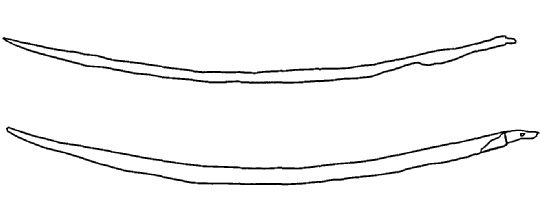

Technical question - how large should be the sabre's curvature for us to consider it a shamshir ? I am trying to arrange my material on sabres, and come to some funny conclusions.
All books I have follow Pletneva in measuring the curvature in cm (how far away the blade from the line that connects the hilt and the blade's end).
Can someone say if 15cm for a meter or so blade would qualify for a shamshir ?

Ok, here is the picture. Would it qualify to be called persian shamshir or not ?
Nah, most likely not. Sorry to bother.

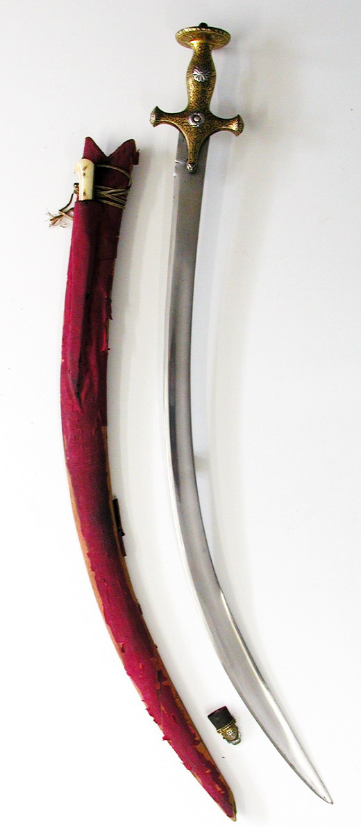

Then tell me, what is this?
Is it a tullwar or is it a shamshir?

Thats a nice heavily curved shamshir or perhaps more killj type blade with a lovely & ornate tulwar grip & typical Indian riccaso you have there Jens.
