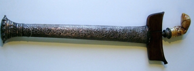

Hi all,
It's been quite slow on this list for a couple of days and I hope you could help me learn some more about this Keris.
It was collected in Minangkabau but I think it looks like it has influences from Gayo/Aceh as well as Bugis?
The hilt is described as an Indragiri variation in the book Hulu Keris.
What do you think about the origin of this Keris?

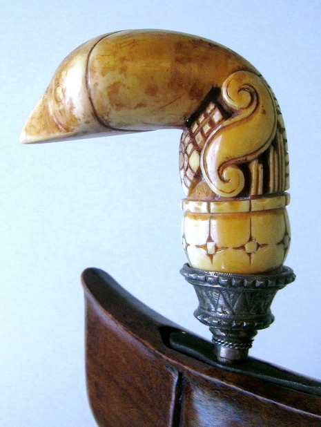

I kind of agree with Indragiri opinion of the hilt (Pg:65, Fig:107).

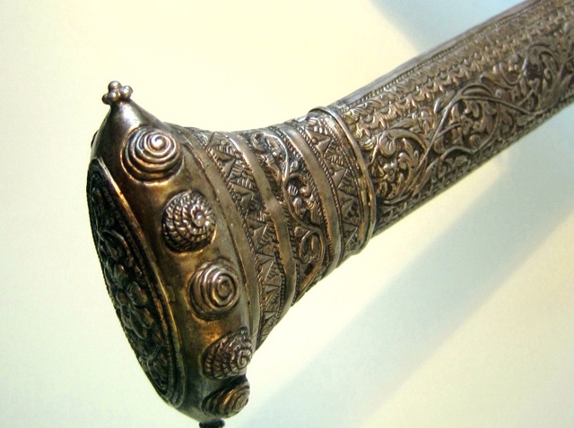

For the sheath, there is quite a gap, when the blade is sheath, which suggests, the blade is not original to the sheath, or vice-versa.
The pendok's buntut looks similar to this piece.
http://www.kampungnet.com.sg/modules...view_photo.php
Wide, flaring with whirls decor. It is however not the same as Gayo style.

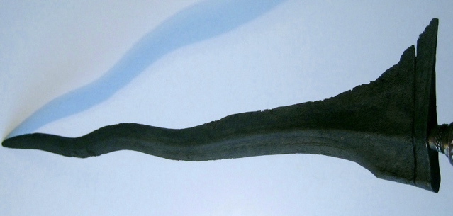

The blade, hmmm... tricky. Could it be a Javanese trade blade, dressed in Sumatran style? The blade design is Dapur Pulanggeni. Just my thoughts.

Michael,
To be honest it looks to me as a composed keris. I love the dress, but the blade doesn't fit the sheath. I think Alam Shah is right that the blade is javanese, not uncommon to find a javanese blade in Sumatra and in a Sumatran dress, but the sheath wasn't made for this kerisblade.

Alam Shah,
I am impressed by your humbleness
On the gap I don't think it's that prominent.
When in the sheath it fits tight and doesn't move or "rattle".
But you are correct that there is some small space on the top of the sheath.

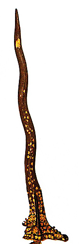

Hi VVV
is it just the photos or is the hilt not a good fit in the hilt cup?
DrD
Old 27th September 2006, 06:05 AM   #6
VVV
VVV's Avatar
Posts: 1,637
Hi DrD,
Now you make me insecure.
But if you compare with the following Keris, the first Panjang in my archive, that has the same kind of Selut it seems to have a similar fit.
Maybe it's because of that I turn the handles in all directions when taking pictures (instead of turning the complete Keris)?
Or maybe none of them fits?
I will take it apart tonight when back home and have a really close look.

Michael,
I'm afraid I have no reference pictures to show you.
I think the keris doesn't fit the dress because you can see on the picture that the blade doesn't fit perfectly in the wrangka. In my opinion the blade was put in this scabbard because the blade was going in and had a reasonable fit. So the sheath was a replacement.
