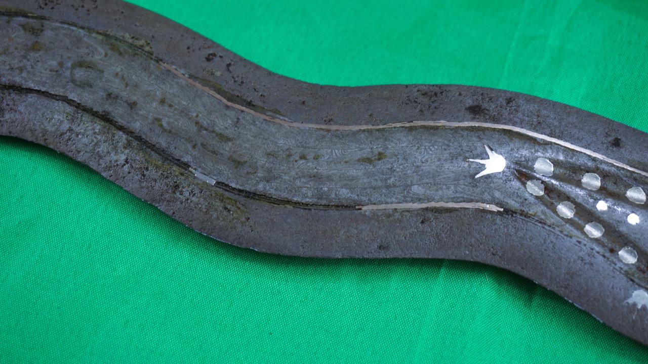

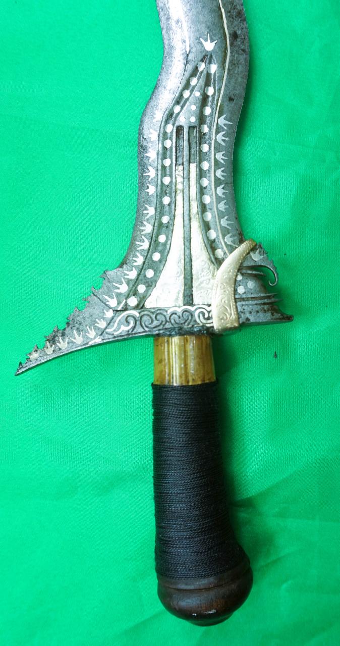

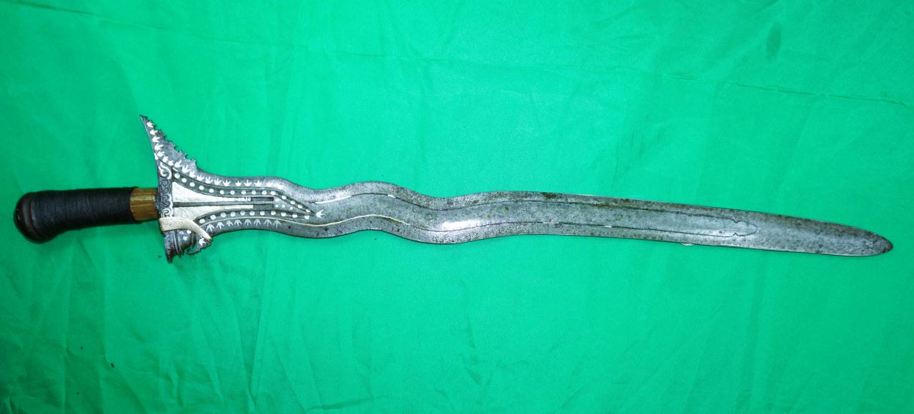

Maguindanao kris, 1800s, similar in form to Krieger's #1 sample in Plate 14 . 22.5in blade, 27.5in overall. Wooden hilt with brass ferrule. Silver inlays of arrows and circles with apotropaic purpose. Twistcore blade with 4 bars at the middle. I had difficulty etching the blade; the pattern was barely visible even with repeated bouts of white vinegar. Since I didn't want to use FeCl₃, I used dental etching gel as an experimental etchant.

What a great blade! 4 twist core laminations are not commonly seen. I'm envious (Most I ever get is 2 twist core laminations ).

This is a really excellent blade. 4 twisted rods for the whole length plus inlays - this is seldom seen.
This seems to be a much later hilt, but there are examples of quality blades with old, simple hilts.

To be honest, I'm not familiar regarding the age of the hilt- the current cord wrap is already my installation (the original wrap was extensively damaged brass wire). Gustav may be right in his conjecture that it's a younger hilt; I've seen similar hilts on American colonial era krises; the blade I would conservatively place as mid to late 1800s. Regardless of age though, it looks like a functional hilt. Now with regard to owner's preference on blade+dress combinations, it's a bit complicated.
