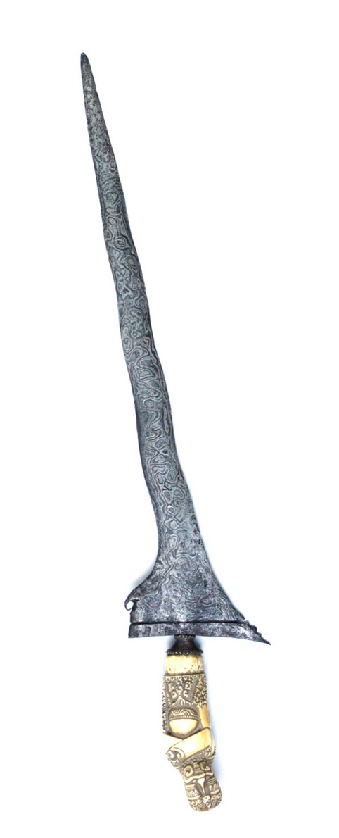

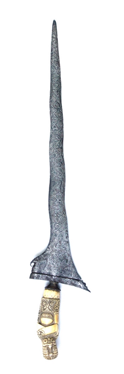

To start with a blade from Jean's book.
My impression is kaku (clumsy, not harmonious).
The weak undulations make the blade appear wonky and somewhat unbalanced. Other features are more difficult to evaluate due to erosion, but for the gandhik I find it unharmonious that the angle seems to change quite abruptly (viewing it going up from the gonjo), though this might be due to lighting.
