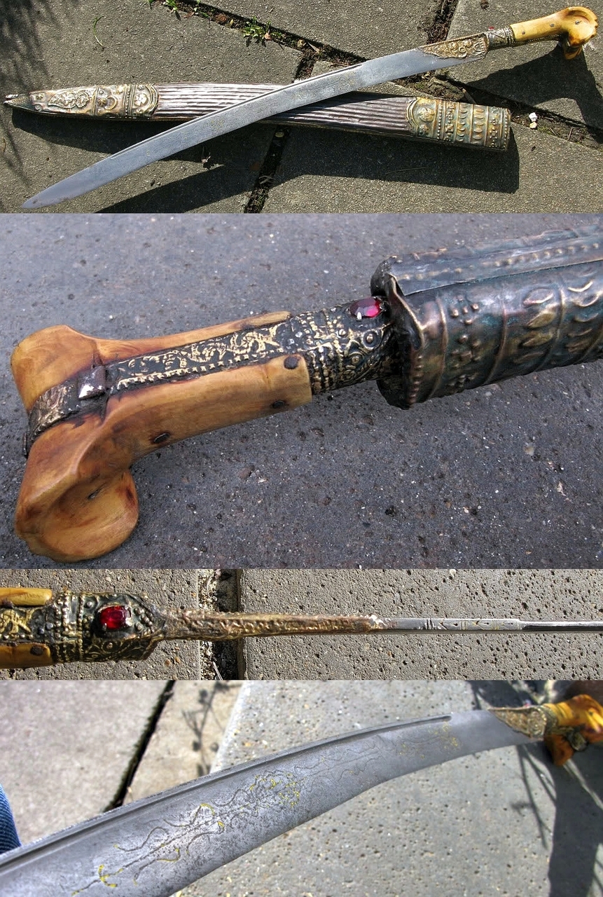

Since this yatagan is now listed as being "sold" I was wondering if any forum member has an idea of were this yatagan may have come from. I can not remember seeing a scabbard like this one before.

Off hand the Balkans.
Old 6th November 2015, 07:28 AM   #3
No I don't think.
Not all the Yatagan are from the Balkans.
What make you think that?
It's a very strange yatagan...

Unfortunately there are not a lot of images but it is strange looking, I have gone through a lot of images online and that I have saved but I can not find anything like it, it is large and has some interesting details like the notches carved into the ears of the hilt and a stylized star and crescent on the scabbard chape.

I still have not seen anything similar to this yatagan, here are some additional pictures. 28 inches long.
Old 17th January 2016, 11:03 AM   #13
I like your yatagan, the date on the blade is 1825.
Is the central part of the scabbard silver?
Congrat!!

Old 17th January 2016, 11:27 AM   #16
In the last set of pics, the fourth from below, scabbard fitting: isn't there a half-moon and a star?
Old 17th January 2016, 11:32 AM   #17
To me it looks like a half moon and star, sort of stylized. The tip of the scabbard looks like a fish head, it reminds me of the balkan style scabbard tip.

This yatagan is similar in some ways, the blade has gold marking on one side and silver on the other, the scabbard ends are similar as is the grip which may be wood, it is the closest I have seen.

Thanks for the close ups. Now I see that this is truly more unusual than I originally thought. Though still leaning Balkan, it now does not seem as Balkan as I thought now that I see these later picture close ups.
Regarding the 2nd example, what region does it come from in the Ottoman Empire?
Also I agree with Kubur regarding the fish/monster scabbard finial. Quite common on Ottoman yataghans, both on sword and dagger styles.

I am sorry but am I the only one here who feels we are debating late 20th century (at best) fittings? Referring to the yataghan starting this thread and the one in post 18, not the Foca examples of course.

IMHO, you might be correct re. wooden handle and scabbard but the blade and metal handle fittings ( again, IMHO) seem to be old.
I am wondering whence it came to the market. I have seen so many crude and thoughtless renovations from Bulgaria....

Anything is possible when it comes to such items, do you have a particular reason for thinking that this is recent work, have you seen similar examples?

The engraving on both blades and the hilts seem to be quite similar in my opinion.

Ariel already summed it up nicely: while the bolster and the hilt band may be original to the blades, the wooden hilts and the scabbards are most likely modern. The material on the hilt is wrong, which is a result of traditional materials such as walrus ivory or dark horn being hard to obtain. And the style of the decoration is way off as well: it looks like a modern artist's own interpretation, as opposed to period craftsmen who usually repeated a few motifs, found across a wide range of surviving specimens. Finally, the workmanship of the scabbard metal parts is too crude to believe it could have passed the standards of the esnafs (guilds) back in the day.
Now, this does not suggest any attempt to deceive. I just consider these to be a modern attempt at restoration.
Teodor
P.S. Ariel is correct that there is a multitude of "artists" who restore old weapons in Bulgaria, with results varying in quality and appearance. I am also sure that Bulgaria is not unique in this regard. I can provide examples, but I do not feel modern replicas should be the focus of these fora.

What makes my antennae twitching is the apparently different metals of the bolster parts and the scabbard fittings, the clumsiness of the scabbard's mouth ( the real things are almost in line with the handle and not almost twice as thick as here) and the crudeness of the scabbard decoration. I am also very uneasy about the " fish head": usually it is almost like a separate detail, turned up and more like a "dolphin-head". This one is short, stubby and looks like a herring:-) .
The more I look at it, the less I like it.
But the blade is unquestionably real.
TVV is correct: Bulgaria is not the only one place in the world exporting benign or not so benign:-) "restorations". Simply I saw quite a lot of things on E-Bay coming from there with similar features and very similar wooden ears of a non-traditional contour.
