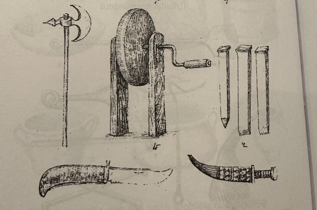

6: A diagram showing metalworks produced in Sasun, the form of local daggers, knives, and war axes. (From Petoyan's book)

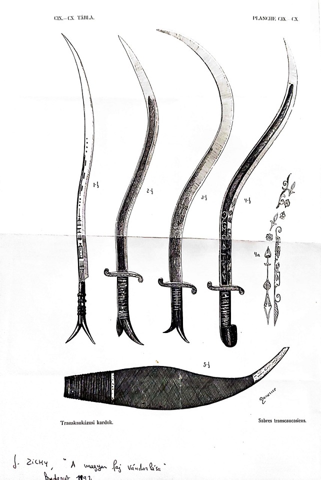

It seems the case of the 'Black Sea' yataghan which was the topic of much consternation and debate is one example of the kinds of arms that might have connections here.
While these were finally determined to be 'Laz' bicagi, and regarded as 'transcaucasian' it seems they were found well into the Caucusus as well, and I recall contacts in Tblisi saying they were well known there. Most of the examples from reference material (Triikman & Jacobsen, 1941; Vichy, 1897) seem to have been from Erzerum and Trebizon.
Seifert (1962) describes these as Kurdish-Armenian yataghans, and it seems that description categorically aligns somewhat with the material here.
