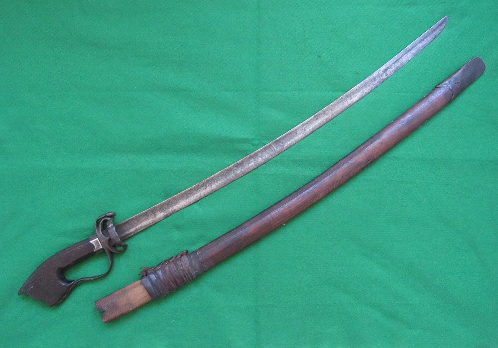

Nimchas are among my most favorite swords. When I use nimcha in this thread, I am referring to a certain hilt type, and not the small, half-sized blades that the word originated from. Among nimchas, those from Oman, Zanzibar and the coast of East Africa fascinate me the most. To differentiate from Maghrebi nimchas, I will refer to these as Zanzibar nimchas, even if many of them were made and used in Oman and other areas under direct Omani control or Omani influence. I am also specifically excluding Yemeni nimchas - not because they are not related to the Omani ones, but for the purpose of setting some limits on the subject of the thread.
When studying these swords, I have always thought that some basic typology would be useful. As collectors, we love to put things in nice, neat categories, but beyond that, observing some differences and similarities between various types might also help enhance the collective knowledge. The typology below is based not only on the half a dozen Zanzibar nimchas in my collection, but also on a picture archive of approximately 60 swords I have gathered over time. Many examples come from this forum and other collections, others come from online museum catalogues, and some of course come from auction and dealer sites. Do not worry, I do not intend to inundate the thread with pictures taken from the internet but am just pointing out the sample size I used to come to some conclusions.
One can go about a typology in various ways, but the two that make the most sense would be based on blade type or based on the shape of the guard. I chose the latter, because I think it gives a better system compared to blades, which come in a huge variety of shapes, sizes, curvatures (for the curved ones), width, number of fullers, etc. This is not meant to be any kind of a final, authoritative typology - as new examples come up, I will probably revise my own thinking multiple times. This post has become much lengthier than I originally planned, so let's launch into the topic.
Type I - Guards with a D-Ring. These are all the Zanzibar nimchas with a D-shaped ring to the side. As a general rule, these all have hilts of dark horn (I know of at least one example with an ivory hilt, but it is a really rare exception). There are two sub-types within this type.
Type IA - Guards with a D-Ring where the D-Ring is filled. Those guards are the hardest to forge and all the ones I have seen are on nimchas of high quality, with nice blades, hilts and scabbards with fittings almost always made of silver.

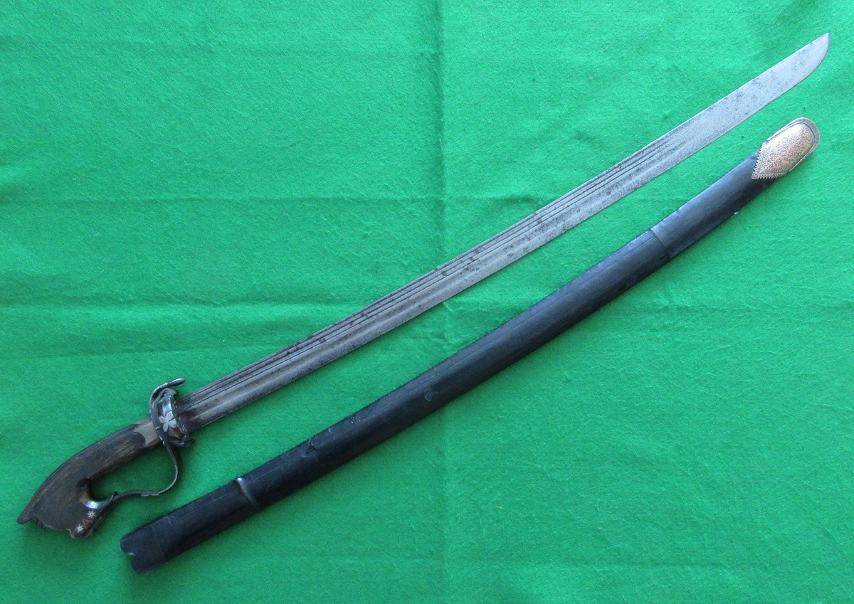

Type IB - Guards with a d-ring where the ring is not filled. Those are almost the same as IA but the rings are just that - rings. Some nimchas of this type are just as nice as the IA ones, while others are of lower quality. On my example, the ring is actually broken, perhaps showing a potential structural issue with Type IB compared to Type IA.

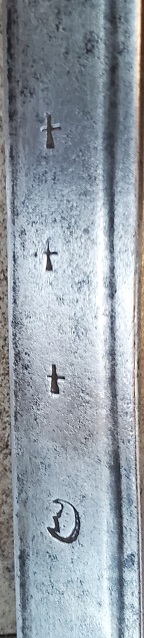

One of the mysteries of the Omani/East African nimchas is the general lack of markings. I have seen a few with marks, but they are still less than 10% of the total I have seen. On top of that, almost always the rare marks you find on them are not European or in imitation of European marks.
This is even more puzzling when compared to the other 19th century swords that were used alongside the nimchas - the kattaras and the guardless, conical hilt saifs. These other swords are almost always extensively marked and the marks tend to be European or copies thereof.
It appears that either the blades were kept unmarked or any marks were ground out on purpose. Why, I have no idea. Interestingly, this seems to be true of only Oman, Zanzibar and the Comoros, because the Yemeni versions tend to have all kinds of imported blades with their markings.

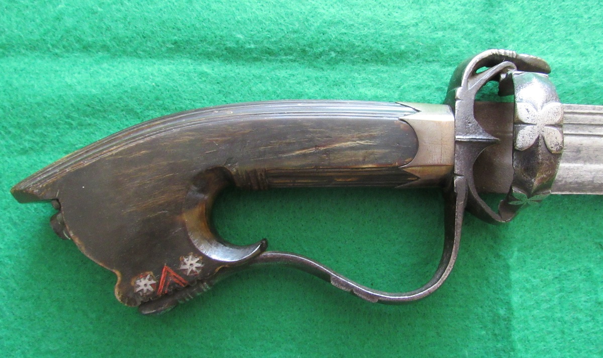

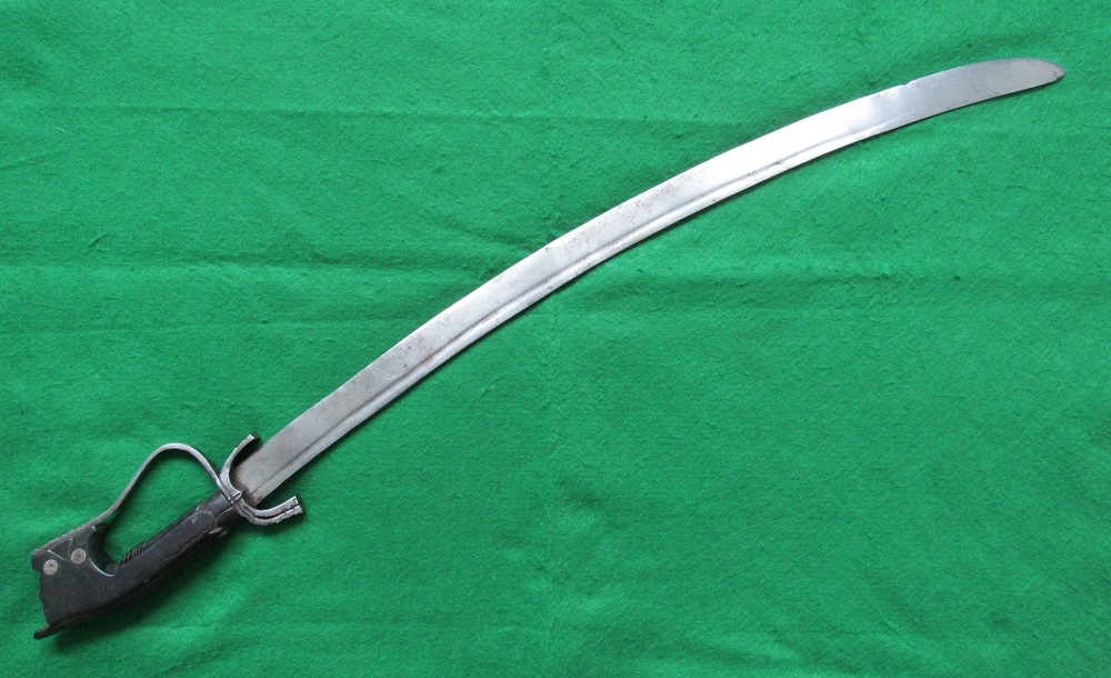

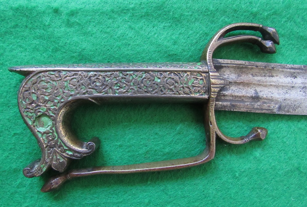

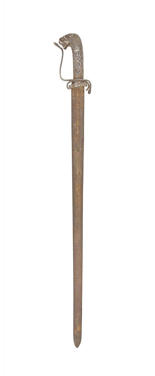

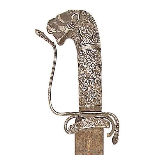

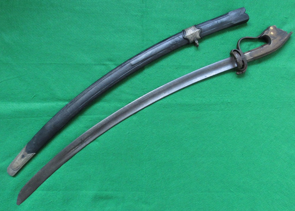

I was browsing Google images today and came across a very interesting sword, which only deepens the mystery of nimcha hilts for me. It was sold at a Bonham's auction in 2015, and described as 19th century South Indian sword. I believe it is earlier than that, and the hilt and guard have many interesting features.
Obviously, the lion pommel and the grip decorations are beautiful and perhaps correctly attributed to India, as they are unlike anything found either in Oman/Zanzibar or the Maghreb. Members with better knowledge of Indian arms may be able to identify the patterns and confirm where they are from.

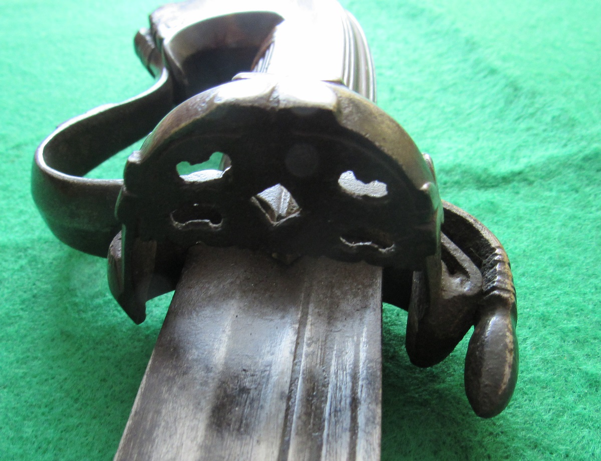

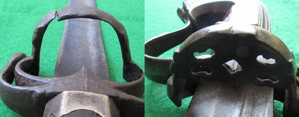

But the guard is similar to BOTH Zanzibari and Maghrebi nimchas. Take a look at the D-ring - it has a four-petal flower in the center. This is pretty much the same flower from which the flowers on Zanzibari rings are derived, illustrated with a picture of one of mine.
But then look at the quillons - their ends are shaped as multi-faceted flower buds. This is typical of early Algerian nimchas, like one I have with a brass guard.
The blade is a broadsword blade with a single short fuller and no markings. Interestingly, Zanzibari blades are almost always unmarked, especially the straight ones.
So, what to make of this sword? If the lion pommel and grip are Indian, it would be closer geographically to the Zanzibari and East African nimchas. But it also exhibits Algerian guard traits, so could it be derived from some old ancestor of both of these, brough by the Ottomans to the Indian Ocean?

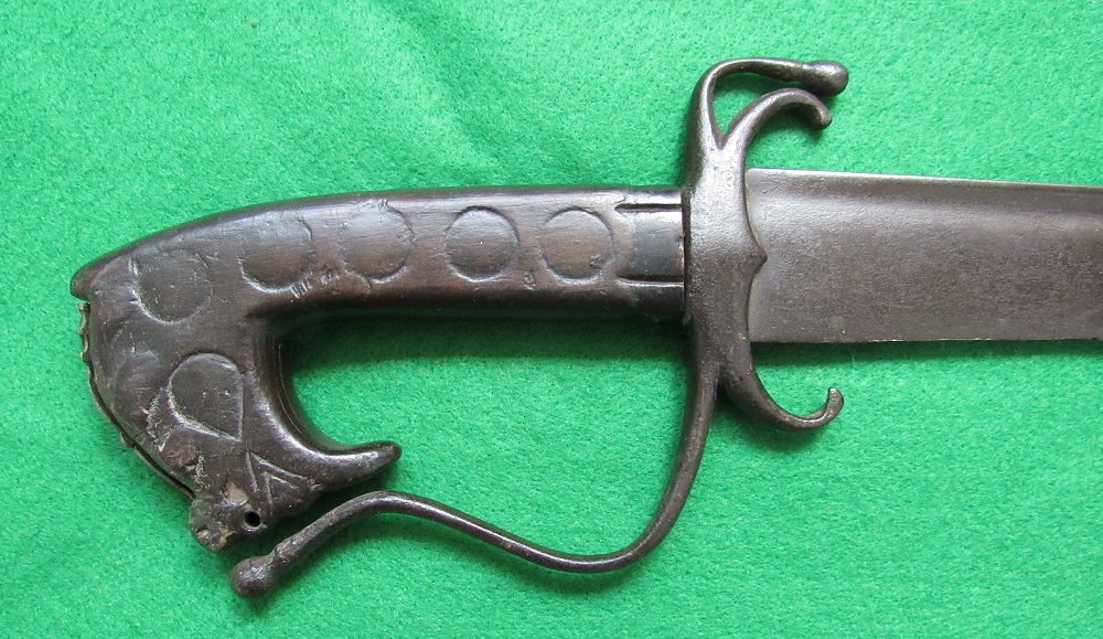

Jim, thank you for your support. If you or anyone else have any thoughts on the lion hilted nimcha and where the lion may be from, I am very interested to learn what you think.
The similarities with kastane hilts are certainly there, and Eric Claude has even mentioned that theory in his recent book. There is actually one more, old nimcha hilt with a figural hilt. It is number 1005 in Buttin, and he classifies it as an Arab sword from the 16-17th centuries. The dating is subject to debate, but it is interesting that Buttin has placed it in plate XXX, among other Arab arms and armor and next to Zanzibari nimchas, and not on the previous plate next to Maghrebi ones. The pommel on this one looks more like a monster, perhaps Makara from the Hindu mythology. The quillon finials are also in the shape of monsters.
Those are the figural nimcha hilts I know of, but if I am missing any, please feel free to add them here.

This is kind of a tough one Teo, but I am inclined to agree, this could be into late 18th c. perhaps into mid. The blade reminds me of the blades on Omani sa'if (generally called kattara in modern parlance).
I think this well might be Indian, and there are of course striking nuances resembling the Sinhalese kastane, as noted.
The 'lion head' does seem more toward the Hindu mythical creatures in the pantheon, but the makara and yali are zoomorphically combined forms, with the makara more reptilian or aquatic and though the yali has elements of the lion, the elephant features lean away from this lionhead.
The ring guard which has for some time (since about '80s) been regarded as a 'Zanzibari' trait cannot actually be specifically assigned to preponderance there. As can be seen, a wide scope of sword types prevailed there including shamshirs, 'kattara' and others. In my view the 'Zanzibar' attribution to the ring guard versions of the Arab sa'if (commonly termed nimcha) may have come about when a volume of swords of the ring guard type found in an arsenal in Yemen were said to have been fabricated in Zanzibar.
The ring guard, like numerous weapons in the Arab sphere, have distinct influences from Italian weapons, many early forms carried via the conduit of trade networks.
I was once told the 'nimcha' or sa'if is not a North African form, but Arab and with of course a great volume of these becoming well known in Algeria and Morocco. Buttin of course labels these Arab sa'if with some Moroccan and Algerian sub attribution. I could not find any of these (and with ring guards) with any Zanzibar attribution (Buttin, 1933).
Getting to this unusual example in the OP, it seems to reflect various elements of the Arabian trade sphere, from Ceylon to India, to Arabia (Yemen, Hadhramaut) and with the familiar guard system of the nimcha, kastane, etc. (North, 1975).
The repousse? silver work seems mindful of the work on Arabian (Hadhramaut) swords that were made for their mercenary forces in Hyderabad. The ring guard of course seems a feature also popular in Yemen, though odd with the nimcha style guard system.
Then we have the Omani style blade well known in Zanzibar, and the ring guard as noted regarded as Zanzibari.
Truly a conundrum, but not surprising given the complexity of these trade spheres.

Jim, good point about Indian production meant for Arab mercenaries in Hyderabad. This could be yet another example of that connection.
You are correct that the ring guard is not a key feature that distinguishes between Oman/Zanzibar nimchas and those from the Maghreb. As discussed earlier in the this thread, there are plenty of examples from Oman/Zanzibar and the Comoros without a ring guard. There are also examples from the Maghreb with the ring guard. The shape of the knuckle guard and the tilt of the pommel are usually a better indicator of geographic origin.
The sword with the lion head pommel does not look to me as coming from the Mediterranean, and the Indian attribution has some merits, so it is more likely to be connected to Oman/Zanzibar/Comoros examples, but it is intriguing that the quillon finials are like those on Algerian nimchas. The only way for me to explain this feature is through an Ottoman connection. In the 16th century, when the Ottoman privateers were at their height in the Mediterranean, Ottoman naval power in the Arab sea also peaked, with notable Ottoman involvement all the way along the Indian coast. In fact, the battle at Diu preceded the siege of Malta and the battle at Lepanto by more than half a century.
The quillon block, quillons and ring guard are very likely to be derived from Italian (or Portuguese or Spanish) swords, but the grip and the pommel probably came from the East. This kind of fusion probably does not happen without the Ottomans, but how exactly it occurred is a mystery to me.
