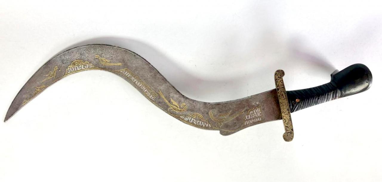

These rare weapons are often modified European blades with a yatagan hilt and persianesque decoration. I recently discovered a picture of one with a rather spectacular curve, complete with an unintelligible Armenian inscription.
I had previously assumed that these weapons were coming out of Armenian/Kurdish populated areas in Eastern Turkey, but given the fact that the inscription on that particular piece closely mirrors similar (equally unintelligible) inscriptions found on some Caucasian Kindjals, this makes me doubt my previous assumption.
Perhaps these weapons were coming out of somewhere in Southern Transcaucasia? Or maybe perhaps the kindjals with similar inscriptions were coming out of Eastern Turkey?
I would be interested if anyone has any insights or further information to share.

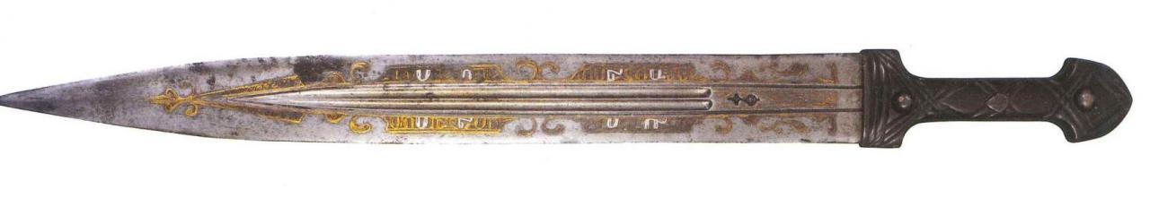

Below: A picture of this monstrosity and an Armenian-inscribed kindjal to compare its inscriptions to, as well some other specimens of these yatagans.

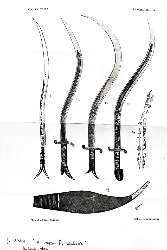

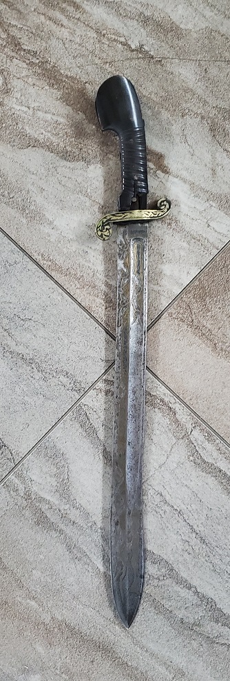

These are indeed Transcaucasian weapons as far as I have known and distinctly associated with the 'Black Sea Yataghan' as per Jacobsen & Triikman (1941).
It seems these Danish authors used material from "A Magyar Faji Vandor" (J.Vichy, Budapest , 1897) in identifying these.
Attached
Plate from Vichy

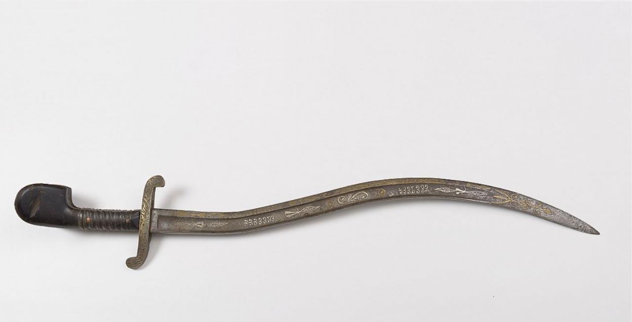

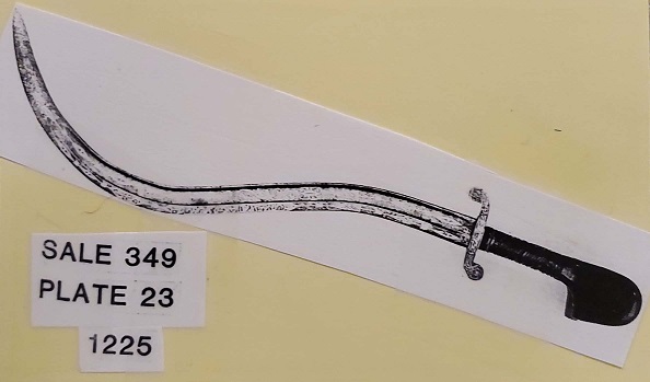

From Wallis & Wallis sale 352 1989

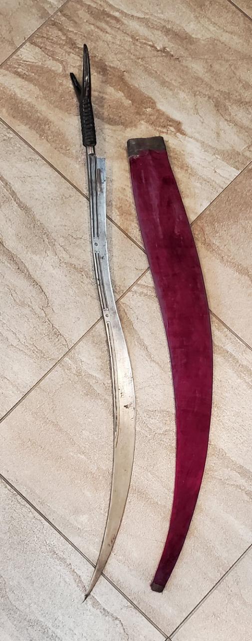

My example with straight rather than recurved blade (there were numerous variations)

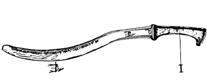

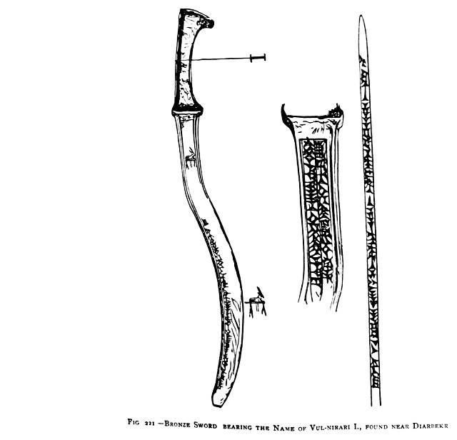

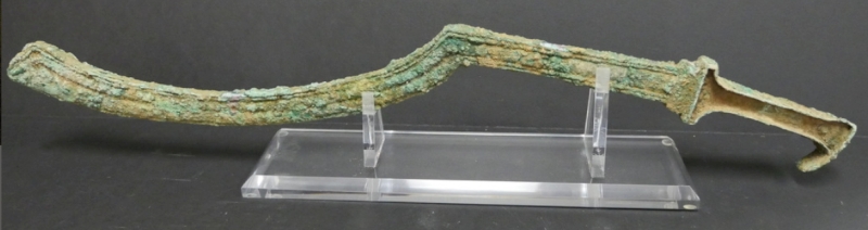

An interesting 'bronze age' sapara (Burton, 1884)

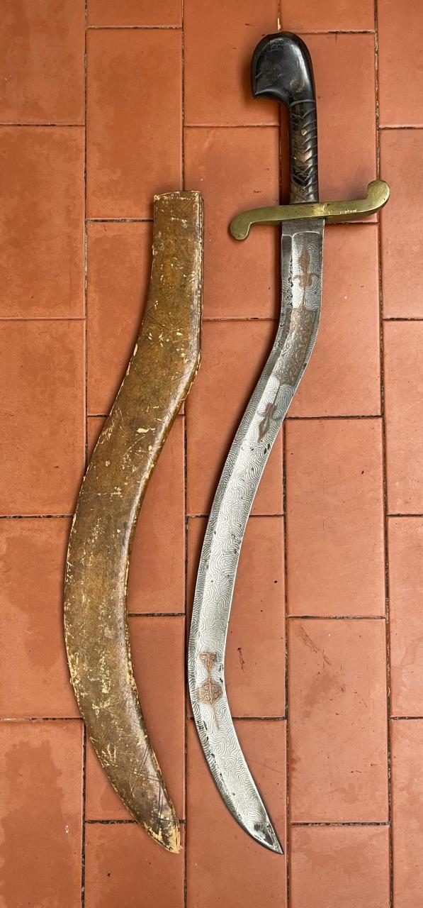

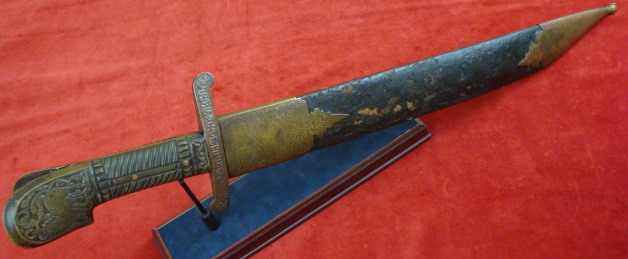

My example transcaucasian 'Black Sea' yataghan

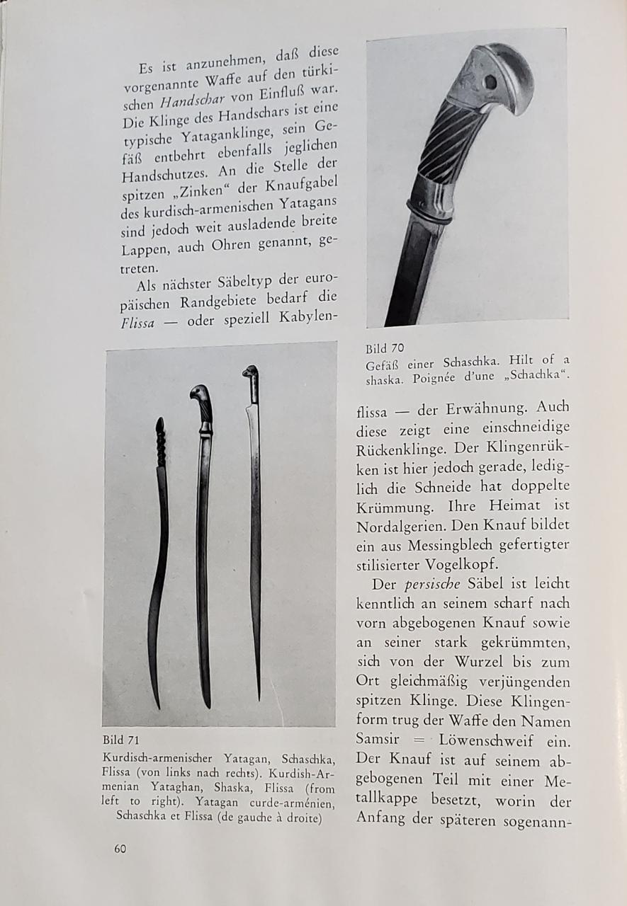

From "Schwert Degen Sabel" Gerhard Seifert (1962) who informed me his identification was from Jacobsen
These weapons seem to have been known in the Caucusus, especially the 'Black Sea yataghan' (Laz bichagi') as many have been known with Georgian inscriptions.

That drawing of a bronze one looks a lot like a kopesh...
Real kopesh found near Jerusalem at bottom

I see a few issues with both the Transcaucasian and Anatolian classifications I have seen for this weapon.
Its hard to deny the obvious similarities and correlation these weapons share with the Laz Bichagi, yet we see some samples that are inscribed in Armenian. While there were ethnic Armenians known as the Hemshin living in the Lazistan region of Turkey, who were widely reported to have shared the same bandit and warlike propensities of the Laz, by the 19th century they were Muslim and completely ceased using the Armenian script. Thus, its not possible to attribute this weapon to them.
The other option would be that they are from the Erzurum region, a region right next to Lazistan that was inhabited in large numbers both by Armenians and Kurds. It would seem logical that such a weapon could have been made and used here, yet this would not explain the obvious Persian decorative influences on some of these, as well as the similarities of their inscriptions to those found on "Armenian style" Kindjals (some of which also have Persian inscriptions on them). It seems such influences could have been present if the weapon was coming out of Armenia proper, a region which was under Persian rule for many centuries.
Yet Armenia itself is very far away from the Pontic Region where this weapon's supposed cousin, the Laz Bichag, was used. Plus, there are no analogous weapons anywhere else in the Transcaucasus, even places that are much closer to the Pontic region. While some Laz Bichagi have Georgian inscriptions, I feel that these were doubtlessly wielded in Guria, a region of Georgia which was both nearby Lazistan and shared the same "Pontic Culture" of this region. Indeed, the first photo that comes up when you search "Gurian men" shows them wielding Laz Bichags. All of this can not be said for Armenia.

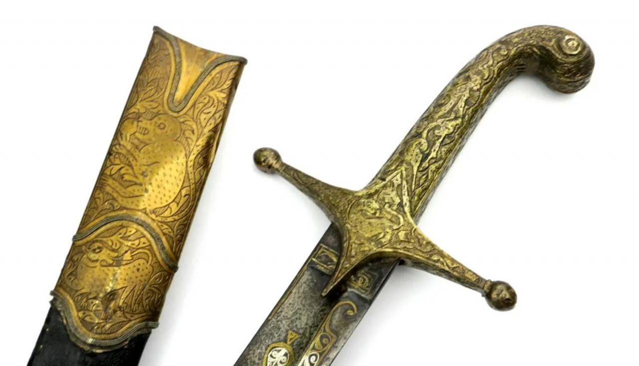

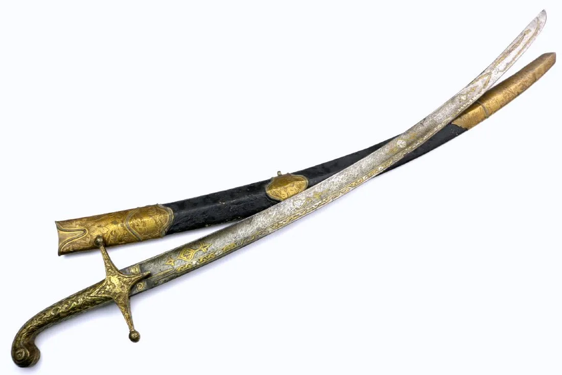

To add another layer to this story: Pictured below is a sword that was on auction a few years ago, clearly sharing the same blade decoration and scabbard fittings as those found on Kurdish-Armenian yatagans. Compare the fittings on this sword to those found on the example from Tirri's book.

Well observed Avto Gaz, and well placed as you are clearly well versed in the ethnography and geography of these regions. I very much appreciate your detailed perspective and explanations as I consider my knowledge and understanding of these weapons very much a 'work in progress'. While I have actively studied these for many years, the resources needed are not always easy to find, nor obtained, and what I presented took many years to find.
I would note that in the references I have consulted, which includes correspondence with museums which were cited in Jacobsen & Triikman (1941) indeed confirming the items in their holdings, often noted collection of them in ERZERUM and TREBIZON. Here I would point out that the Kurdish and Armenian peoples have been widely diffused geographically throughout all these regions through diaspora over many years, and cannot be geographically defined, at least specifically.
As I have been told by respected scholars, 'ethnographic weapons have no geographic boundaries', which seems an obvious and well placed axiom.
I would note here that the Armenians are known as profoundly skilled craftsmen, and the producers of remarkable arms in Ottoman contexts, as well as throughout Transcaucasian and Anatolian regions, even into Europe (notably Lvov) and particularly present in Tiflis (Tblisi, Georgia).
I am certain they were active in many arms making centers in addition to these, which come to mind as prevalent.
This is accounts for an undeniable fact in adamant geographic classifications, that ethnic groups are not limited to specific regions, and proper description must go to the most predominant characteristics of the weapons. To class a weapon form as indiginous to a region it should have remarkable preponderance there as well as some chronological development with viable provenance.
I can recall, by analogy, the so called 'Zanzibar' sword (Demmin, 1877; Burton, 1884) which of course had been seen there, however later research revealed these were in fact the 's'boula' form from Moroccan regions which had migrated there through trans Saharan trade networks.
It was claimed these were Abyssinan because of several examples which turned up in some obscure references on Ethiopian weapons in which ge'ez script (Amharic) was present. Simply explained, these arrived there from the Moroccan regions via the same conduit.
By the same token, these Black Sea yataghans have also been mislabeled 'North African' by some writers due to inscriptions on the blades described as 'African' , and the presence of some from North African regions. This I attribute to the Ottoman presence there in the 19th c. and obviously the ethnic groups present in that context, including Armenians et al.
I recall Mr. Seifert himself when I asked about the example he pictured in his book (1962), he told me he had the Kurdish-Armenian classification from his colleague Mr. Jacobsen (1941) and that he was puzzled by the 'strange' inscriptions on the blade. As many years have passed, I can only speculate that these were perhaps Georgian ?as we know some examples of these have displayed. In conversations with a colleague in Tblisi, I was told that these indeed were somewhat known there as we discussed them. Again, the Armenian presence in Tblisi the obvious source.
