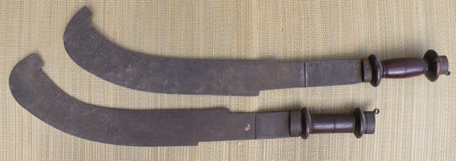

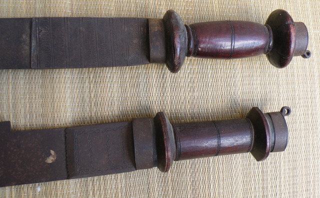

These two West African swords (need cleaning) are recent acquisitions. I havn't seen this pattern before, they seem to have a combination of styles.
Can anyone help to shed more light on them. The forested/coastal region of West Africa is very interesting but somewhat under studied... Thanks in advance. |

2 African swords, these are the 'blade form' of the usually ceremonial swords called 'hwi' from Dahomey (now Benin) in west Africa coast . The hilts are more known as a Sierra Leone form which usually had larger broadsword blades (some of kaskara form). Basically these are slave coast swords of mid 19th c. to latter. |

From what I can find, I think Ibrahiim is on the right lines ... most likely Fon (Dahomey) swords. However the Mende type hilts and "sandwich" style of blade attachment are a bit of a puzzle, as the Mende are about a thousand miles away from the Fon along the coast ??

when you have "panga na visu", there is on page 40 a Fon sword, very similar from handle and blade form (but here with cut outs) but also with the small "hook" at end of the spine, described as Fon sword called "gubasa". Regards, Detlef |

I think that in looking at these two 'cutlasses' which are distinctly with the curved 'hook' type tip blades with Dahomean character, and notably incongruent 'Mende' style hilts, we consider the dramatic diffusion knwn in these regions.
The Mende (of Sierra Leone) as well as the well known slave coast 'capital' of Ouidah (in Dahomey, now Benin) were among the littoral of West Africa which comprised this thousand miles of 'slave coast'. This region was still quite active in the mid 1900s, so movement of influences seem reasonable. It is interesting that the 'sandwich' type element of the blades is a well known element often seen on the blades of West African takouba in Saharan regions, and it has been noted that the Mende hilt style has been known to be mounted with kaskara type blades. This reflects diffusion of even more dramatic distances, which are well established in trade route networking over considerable periods. Then factor in tribal diffusion, warfare, and even religious influences transmitting these characteristics and feasibility is seen. These curious blade shapes are indeed representative of Fon type blades of Dahomey, and these are often known as gubasa, but in nearby Ghana similar swords are 'ada', and the Fon were in other contiguous regions as well. What is most interesting is that these blades are solid, and seemingly of functional character rather than the ceremonially decorated examples of these swords usually well embellished with pierced cutouts and extraneous features atop the blade back etc. |

Here is one of the swords after cleaning...
