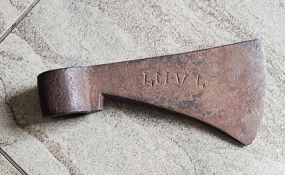

This axe head is of the form (regarded as French in style) that Nuemann ("Swords and Blades of the American Revolution", 1973, example 89a, p.274) terms a 'ROUND POLL CAMP AXE'. It is 8.25" in height, 4" wide and weighs 1.9 lbs. with long flaring half axe blade.
The markings (not yet identified) are in the manner of most of these type axes termed 'hache de traite' , which loosely means 'trade hatchet' in French. It is probably blacksmith (ID pending) made in Canadian or American northeast regions (Quebec was one possibility) and possibly traded alongside the wares of the Hudson Bay Company.

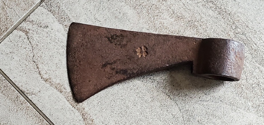

I am also hoping that someone might have seen this apparently four petal flower (clover?) deeply stamped as a mark; and the deep initials LMVL on opposite face .

Wow, Jim! This is an incredible early round poll axe, as you so mentioned. I've seen so many variations of the stamp on these and most are, to my understanding, lost to time. Contrary to some sources, although these were indeed traded to Native Americans, they were also used by the fur traders themselves as well as scouts, soldiers, frontiersmen, etc. These types preceded the later hammer polls and pipe tomahawks. They were absolutely used as both a tool and a weapon. Looking upon the early axe forms, one sees a familiar pattern of starting out as weapon, then weapon-tool and eventually tool only into the latter periods. Perhaps there is someone out there that recognizes this petal stamp? I'm not at home, but I'll try to look at some of my sources when I can.

I have seen a boarding axe with a similar 4-leaf clover stamp said to be Irish in origin but have never been able to confirm that.
In Henry Kauffman's 'American Axes' he shows this example and states 'trade axe excavated in NY state and bearing the lobed mark found on a number of trade axes'. But there is no further information other than that.
I think that, if the maker was sophisticated enough to have a 'clover' stamp for repeated use, then he would also have had letter stamps or a name stamp. So the crude letters are probably added later and more likely indicate a personal possession.

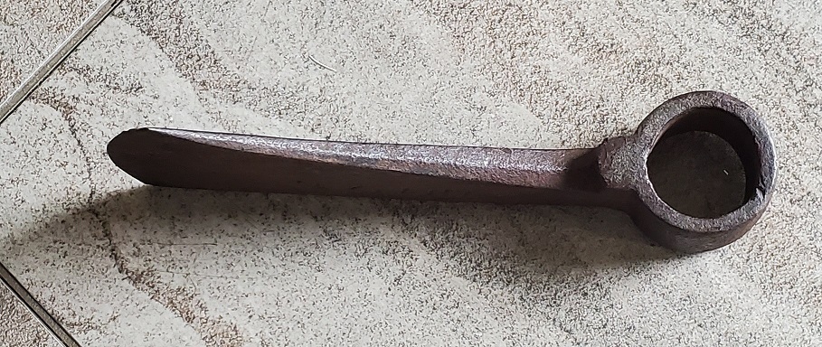

Are there any signs of a seam in way or the blade within the eye that would indicate its construction?
It seems a little too even to be pure hand made so I'm thinking maybe early 19th when blacksmiths were using water or steam driven power hammers.

Thank you CC for the great input! It seems the clover notion is pretty viable and of course Irish association seems likely for obvious reasons. However the other option is the Dutch 'kleeblatt', which is a four leaf clover that seems to commonly occur on the quillon terminals of various swords. It has never been clear what this means, but it is a distinct consistency which seems to have been present in 17th into 18th c.
As the Dutch were of course prevalent in northeast America, especially New York, this presents interesting possibilities. As the profile of this axe head seems to be pretty well visually a match for the example in Nuemann and several other references as noted, that was pretty much my benchmark.

As I note, Im pretty new to this field, so I cant speak with any particular authority, but as far as construction, in the top view a seam extends along the blade which I thought would concur with the fold over construction method. I had thought the type of power hammers you describe were as early as 17th c. and were well known in Solingen, but not sure how much in use in the colonies as yet pretty remote.

Hello folks! I was looking at H & K's tomahawk book and did see an early Dutch example with a 'flower' marking, but it had 7 petals. Still very similar...
