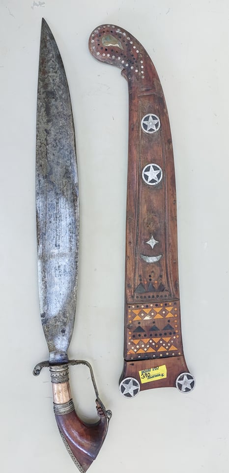

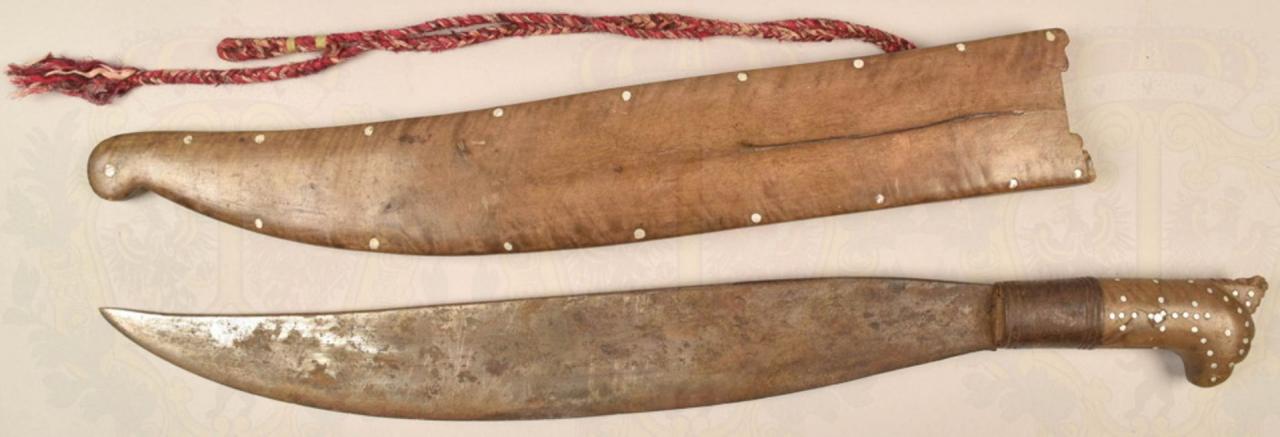

Just won my first keping by a German auction house. It was described as klewang from South Mindanao, Zamboanga. 49,5 cm overall with a blade from 37,7 cm. Ferrule from iron. Pictures from the auction house.
Old 9th September 2023, 04:47 PM   #2
Posts: 4,747
Hi Sajen,
Interesting looking blade. The scabbard style is circa 1960-1970 with peripheral nails holding the two pieces together, and the smooth surface with rounded toe. Maranao work I suspect, perhaps made in Zamboanga. The multi-pinned pommel is consistent with mid- to late- 20th C work also.
Old 9th September 2023, 09:48 PM   #3
Hi Sajen,
Hi Ian, thank you for your comment, I agree with you on all points. It's not a fancy or decorative piece but I suspect it's a real user.

JeffS's Avatar
Join Date: Sep 2005
Location: Singapore
Posts: 466
Is the upturned point the main feature that indicates this is a keping? Hope to see it cleaned up.
Old 10th September 2023, 08:36 AM   #5
Hello Jeff,
Not necessarily but so far I understand is the spine rarley straight.
And yes, you will see it cleaned up!

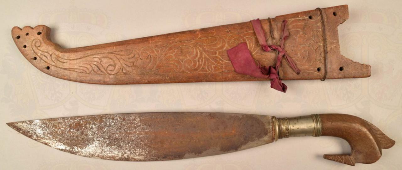

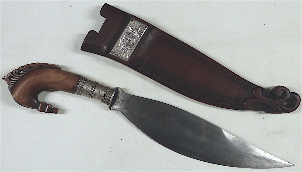

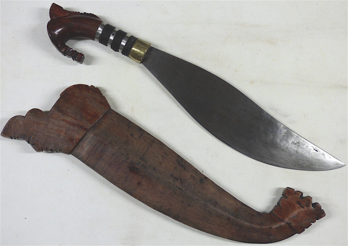

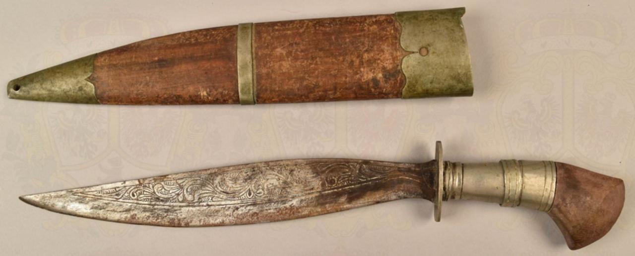

Old 10th September 2023, 12:06 PM   #7
Originally Posted by drac2k View Post
Great catch Sajen; they must be rare as I can't remember ever seeing another one.
Hello David,
Thank you, but it's not a great catch IMVHO. And I doubt that you have never seen one before, you rather didn't recognize it as "keping".

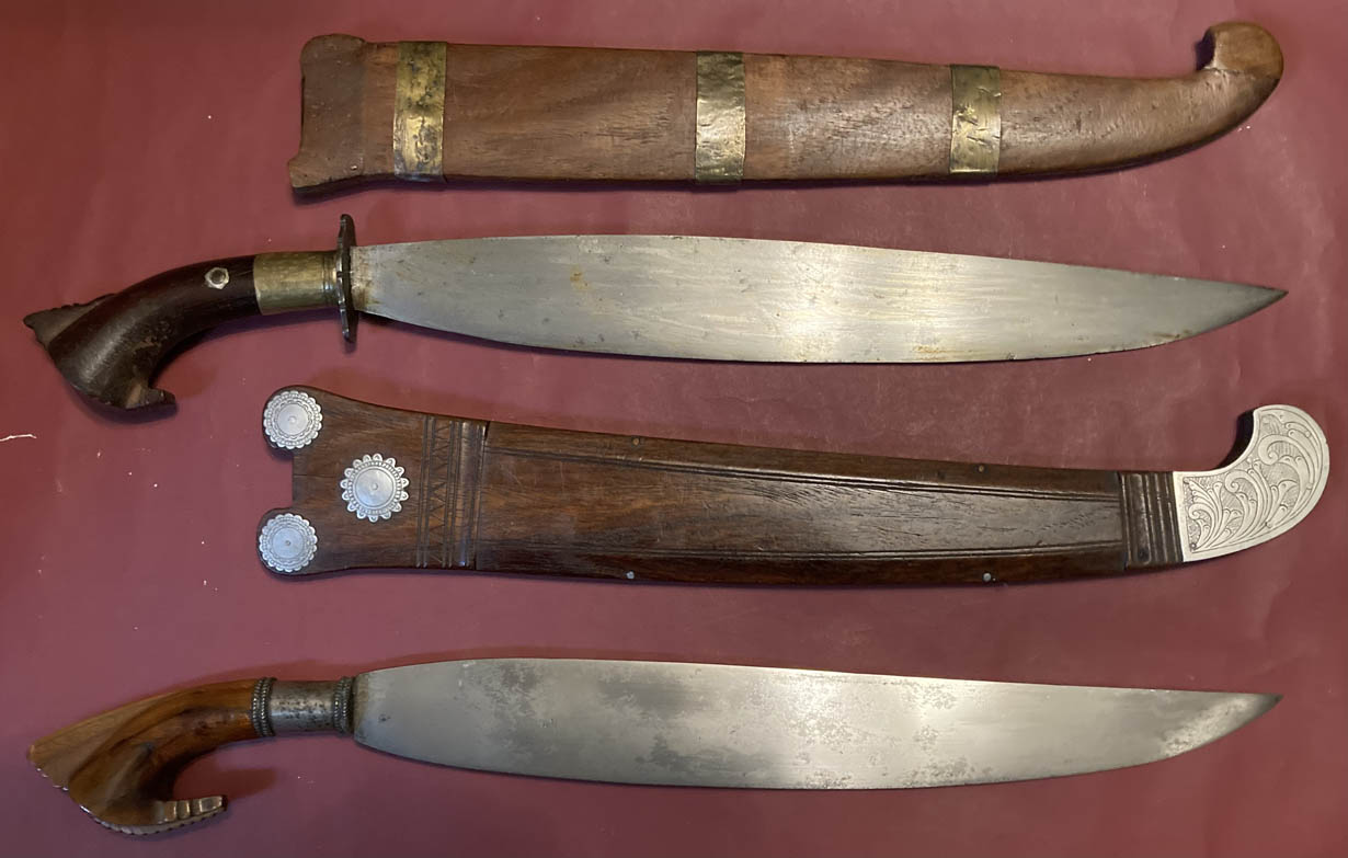

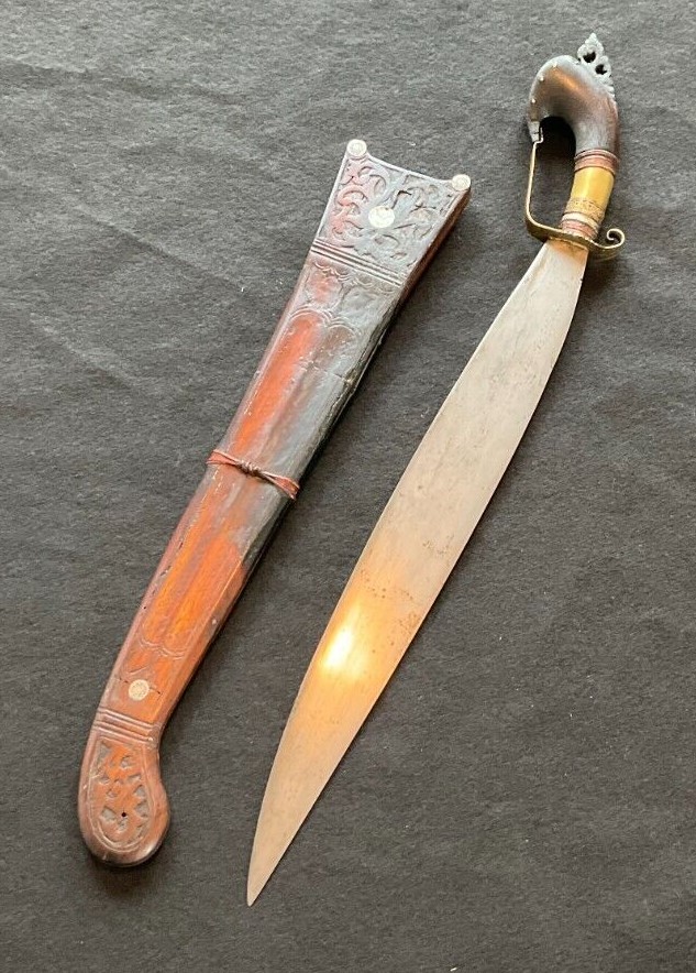

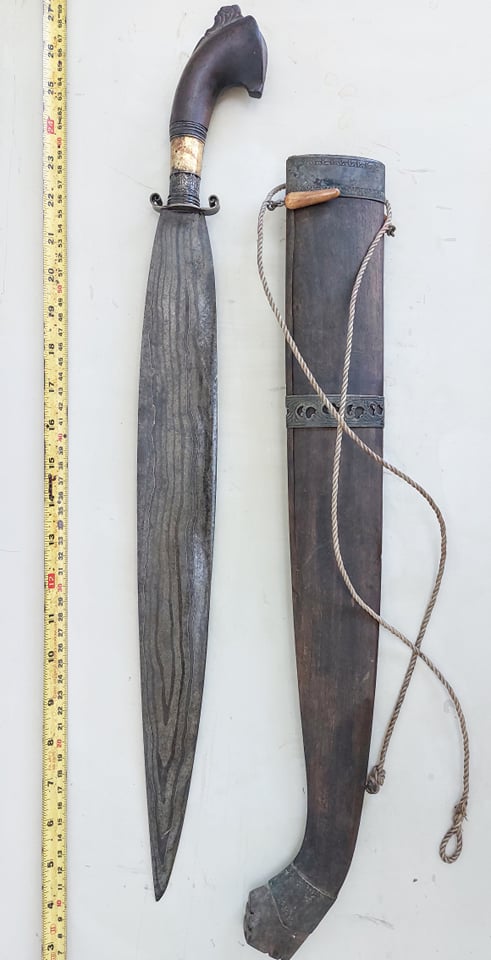

Our member Xasterix has introduced these knives for our attention in this thread: http://www.vikingsword.com/vb/showth...ghlight=keping
Most of them remember barongs and by ebay I've seen them described as barong.
Attached pictures of examples other members have shown them here.

Two of mine at the bottom of post #7 in this thread are late 20th C items from Tugaya (Lake Lanao region). The seller purchased them in Zamboanga, but referenced the Maranao city of Tugaya as the origin of them. I had originally thought, like most of us, that they were just fanciful recently made barung.
I have several other keping examples that may date as far back as the 1940s but probably not pre-WWII. One was attributed to the Mandaya but is clearly of Moro manufacture with a brass hilt and scabbard.
Old 1st October 2023, 12:04 PM   #14
Here you go! It's 49,5 cm long with a blade from 37,5 cm. Blade is 5 mm thick at the spine behind the handle.
Blade don't fit inside the scabbard, I guess due to the shrinking of the wood. Blade is still very sharp and I guess that it was used, there are several nicks in the edge.
Old 1st October 2023, 01:01 PM   #15
JeffS
JeffS's Avatar
Join Date: Sep 2005
Location: Singapore
Posts: 466
Cool - Definitely has it's own style. Thank you for the update.
