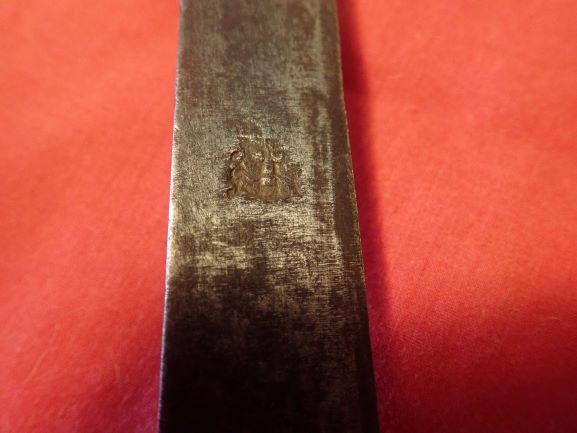

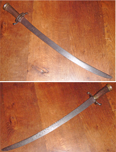

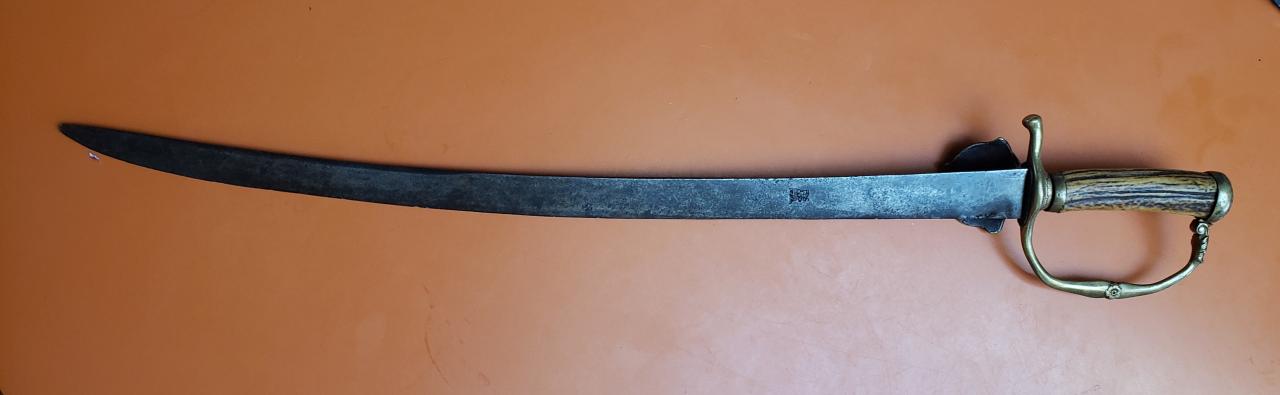

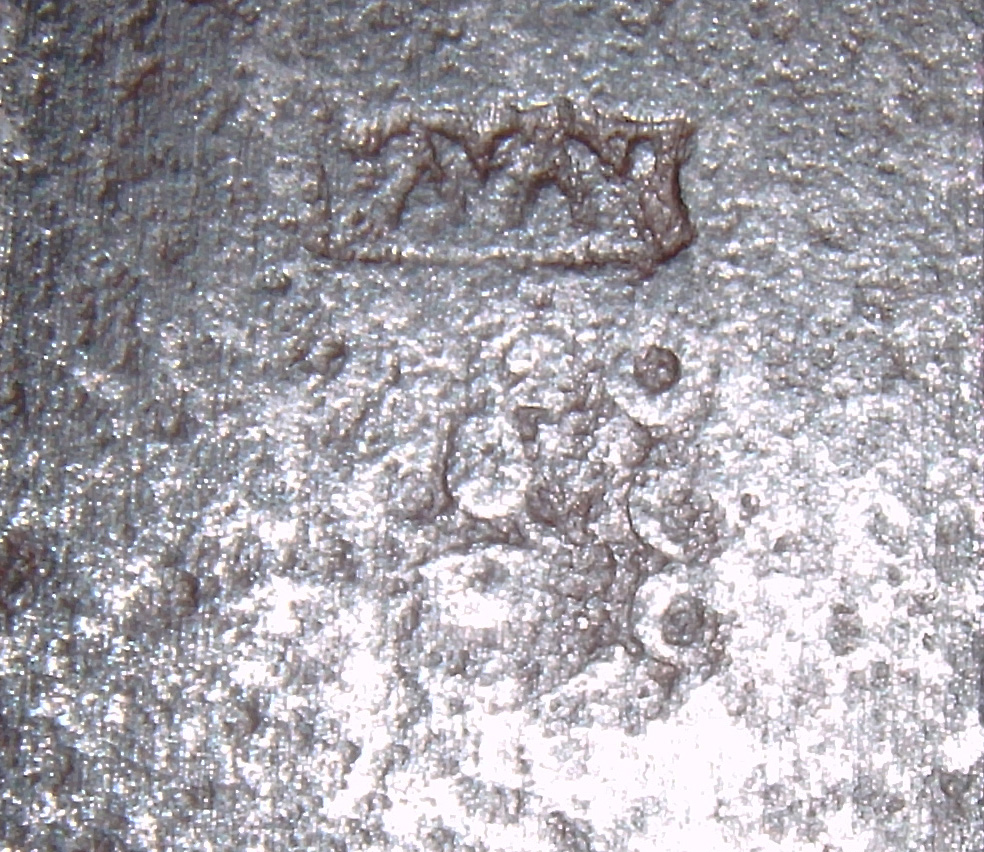

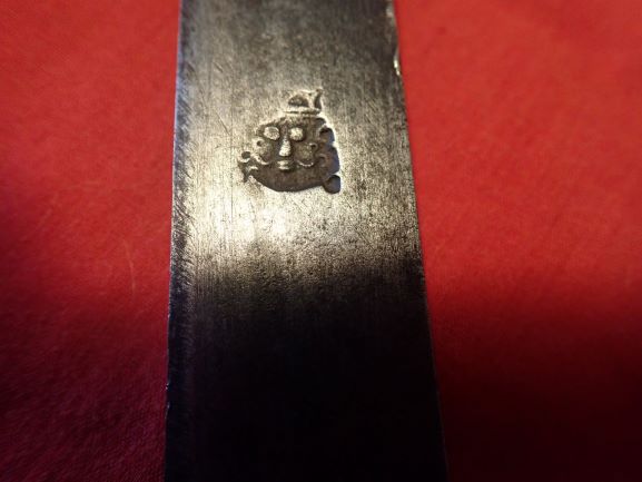

Hi Gents, Have a very worn European hunting sword but im interested in the deep King or Greenman stamp to both sides of the blade , does anyone know this makers stamps as ive seen before but cant find
Any information greatly appreciated

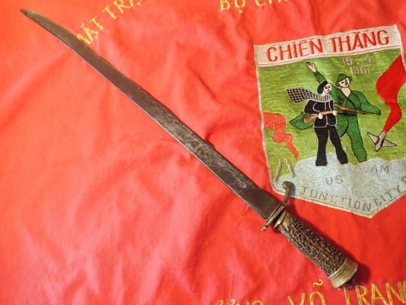

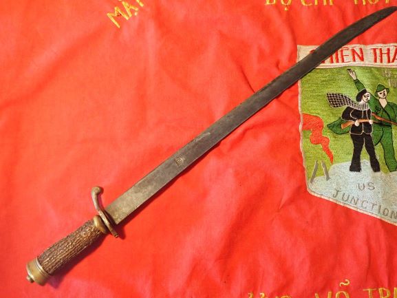

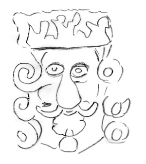

The full face Kings head is not seen as often as the side profiles.

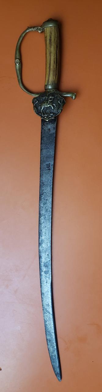

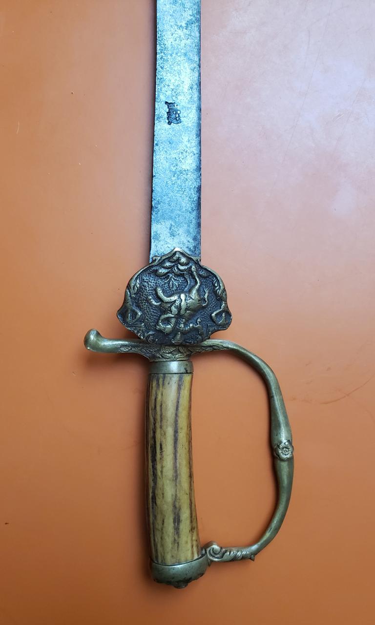

I recognised this stamp as being similar to one that I had on a hunting hanger something like fifteen years since, and had no luck in finding a makers name at the time. I've spent a few hours searching old photo files saved from long past computers and found a few photographs and a sketch that I made of the mark which, unusually, appeared on both sides of the blade, as does yours.

More pics to come, I need to reduce the sizes.

More pics.

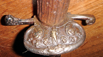

Everything about this fascinating hanger to me says it is English 17th century, and the blade is of the type, with the pitting etc. commensurate with most I have seen of that period.
The 'kings head' is as well observed seemingly reminiscent of the 'green man' theme which was popular in England in the 17th c. typically on hangers.
The Kings head typically of the Wundes family of Solingen was indeed virtually always a profile and not face first.
These caricature like figures were commonly seen on hangers as well as in the hilts of the so called 'mortuary' swords, and characteristic of the motif often seen.
It is tempting to consider that German blade makers in England, first at Hounslow Heath and later at Shotley Bridge might have amalgamated the kings head so well known in Germany with the green man in the same manner as later the running wolf was fashioned as a running FOX in England.
While obviously speculative, it does seem a tempting possibility given the clear tensions between these expatriate Germans and their home which had in effect declared them outlaw.
While the quality of German blades was of course well known, the English blade making industry sought to gain its own reputation especially toward the end of 17th into 18th with Birmingham.
Pending more definitive identification hopefully with other examples, I would suggest this as a possibility. Even today there are establishments using the green man theme in Hounslow. I have not ever found evidence of a green man marking either from Hounslow or Shotley, however that does not mean such could not have existed. The idea of perhaps an unrecorded maker using same is possible.

Yeah, what Jim Said! In all seriousness, Jim has succinctly described this hanger to a 'T'. The German made blades of this period (late 17th/early 18th) often had king's head markings. Those coming from Germany often had the 'Wundes' king's head stamp. The Wundes smiths came from a long line of craftsman. Their mark, however, was a king's head in side profile. The stamp on the two swords thus shown could very well be an English maker, possibly imitating the German Wundes mark so very very frequently found on hanger's of this period. I keep assuming the 'crown' makes it a king stamp, but as Jim has shown in the pic of the Green Man from the tavern sign, it could very well be a stylized crown of leaves.
Just a quick note on the second hanger (Mel's sword). The abrupt guard jutting straight out from the piece is an indication that it is one of the earlier types of this sword (ca. 1690's). Likewise, although these hangers were used originally as hunting implements, they became popular with both infantry and naval officers due to their resilience in the field and their length. Both of these hangers have a longer blade than those typically found on hunting pieces, so I suspect a military vs civilian use.

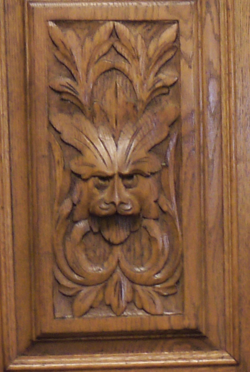

The Green man never occurred to me but having some examples of his face on several pieces of furniture that I've lived with, maybe it should have done.

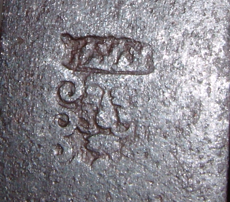

Mel, I can well relate, as probably most here can as well. I once had a great hanger similar to this one which had a mark looking like a sextant. Turns out the marking was 'Wirsberg' in Solingen (as I found over a year after trading it) and it was a solid 17th c. blade.
It seems that even with all the compendiums of markings that have been published, even though notably comprehensive, for all the examples shown there are still variations which were probably short run etc.

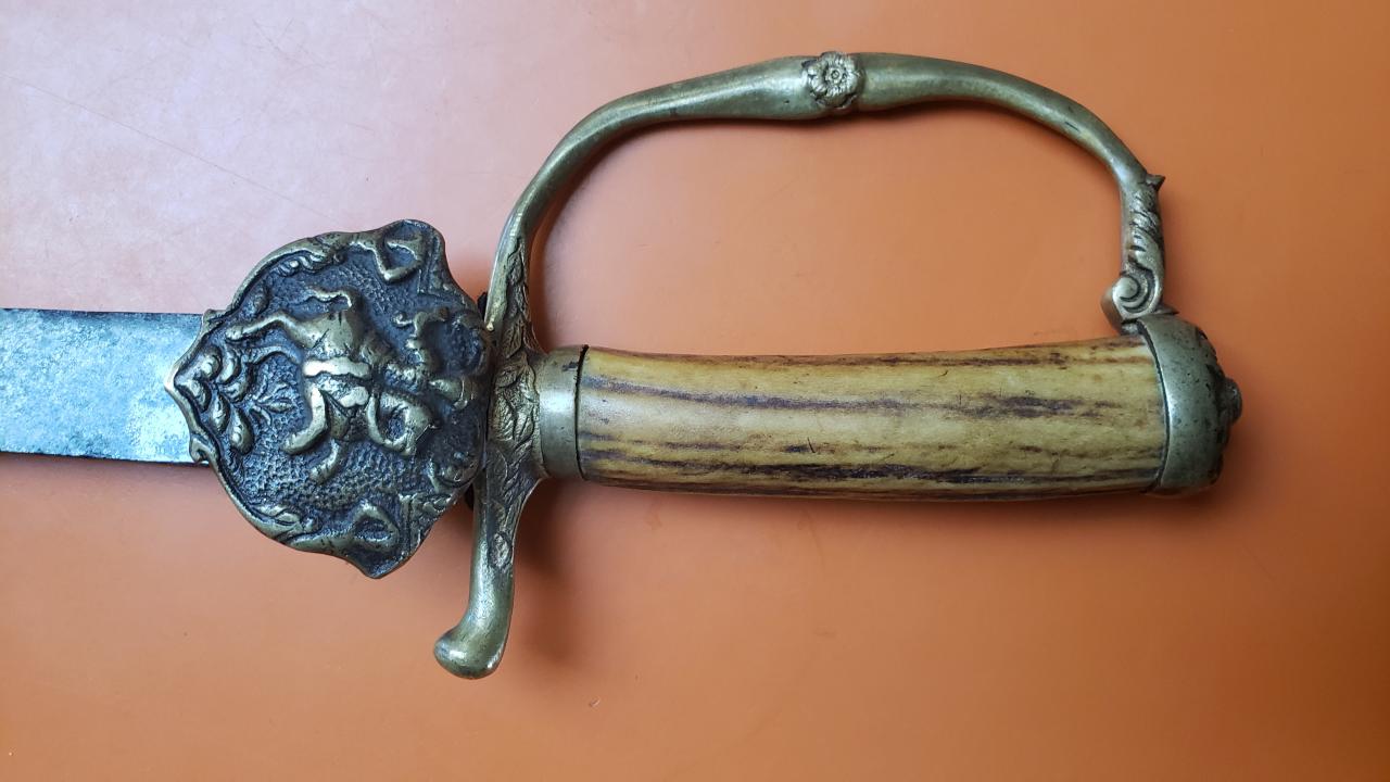

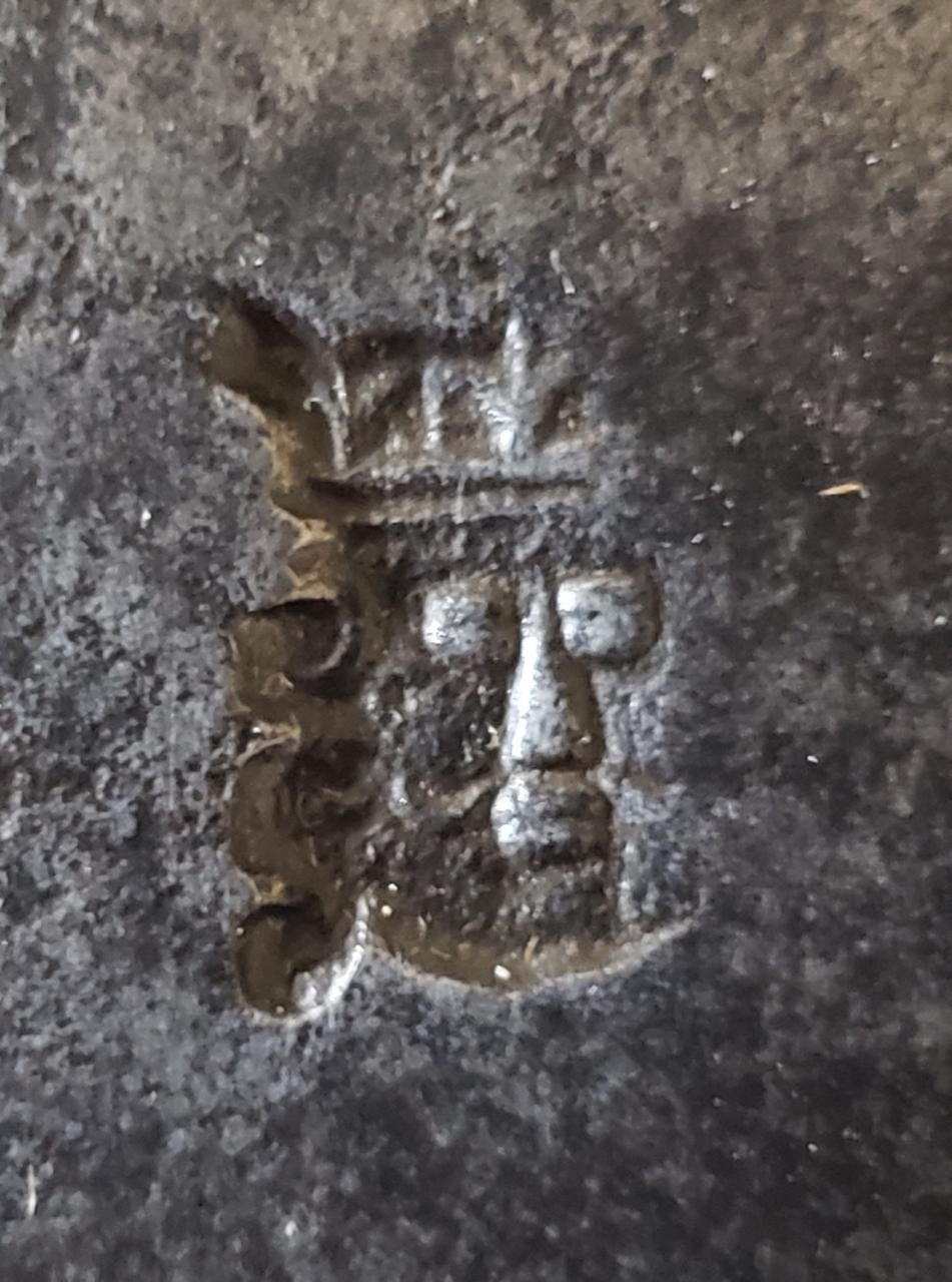

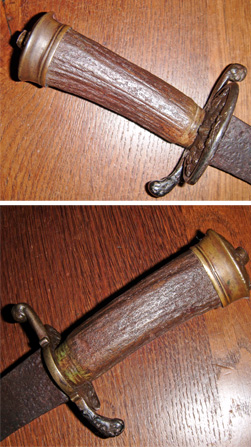

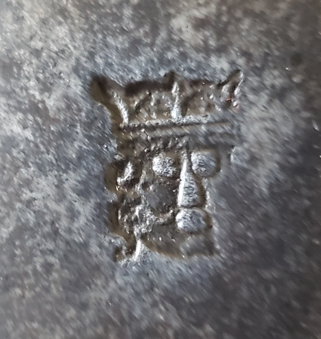

Hello all, I am new on this site and would like to add another Hirschfanger to this thread.
This also has the forward facing kings head. It appears to match the original sword marks well. Could be the same stamp. I am trying to gather more information if anyone has any new information on this mark and/or dating of sword.
I will post measuments after I make them.
Many thanks to Fernando for his assistance!

Very nice hunting hanger. Yours dates to 1740-80 era based on the folded down guard and plain knuckle guard (earlier examples have 'knobs' at the mid-juncture of the bow or cherub's faces). While many of these are thought of as 'hirschfangers', hanger swords such as these were used throughout Europe. Along with the gentry, who used them for the hunt, they were also popular with the infantry and among sailors on ships (their smaller size and mostly brass fixtures were resistant to rusting). Also, remembr that the vast majority of swords (or at least the blades) were being made in the German states at the time and shipped all over the place. The king's head' marking in profile was a common mark for the Wundes family of smiths, which goes back well into the 17th century and often found on blades of the period. I've always liked these types-

A thought on this unusual face marking. While the Wundes' of course did use the kings head in variation, there could be a possibility of the typical wry British sense of humor at play here.
With the running fox used apparently at Shotley Bridge, and later by Samuel Harvey of Birmingham.....seemingly a take off on the running wolf of Passau..perhaps such a parody might have been applied here. (a Wundes type kings head with green man wearing a crown).
The sometimes almost whimsical figures on hilts such as the mortuaries, as well as the green man figures mentioned.........it seems that gun makers often placed grotesque faces on gun butts, and they seem to have had their own favorites, perhaps even in the sense of markings. Gun makers were often cutlers as well, so possibly such a figure might have extended to blades in this manner?
Often makers marks did not reach the Cutlers Co. in London, but though tenuous seems somewhat possible,
