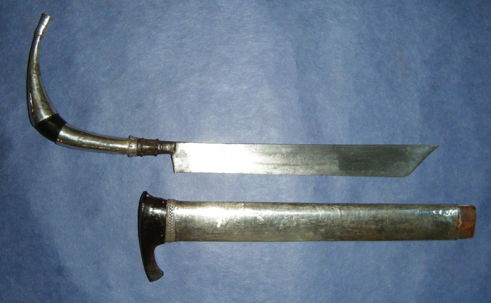

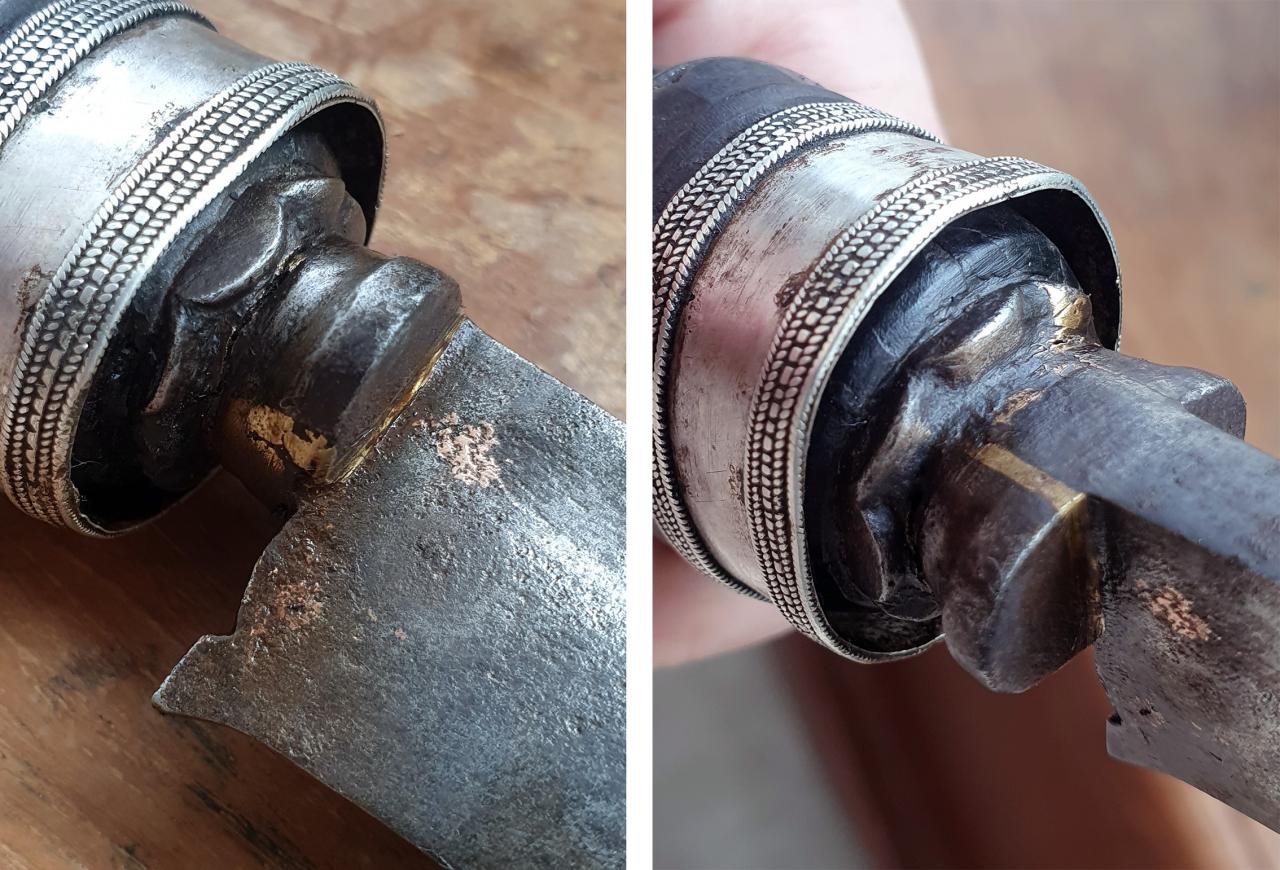

I've started cleaning this piece which was part of an auction set. I have a long way to go but want to understand better what I am looking at before proceeding further. The small fullered blade (42cm) was set in the Batak handle with natural resin with the top part of the integral bolster emerging. After removing the the silver ferule for cleaning I noticed the tips of a Aceh crown emerging below the bolster so I cleaned away the crumbling resin to expose the part that emerges from the handle. This looks like a very small Luju Alang that was reset into a Batak figurine handle and dressed with Batak scabbard. The scabbard has a heavy silver throat and sleeve. Looks to be low-grade gold as a collar and suasa decorations on the silver foot. The silver bands are very variable in size. My first thought was that this must have been an old rehandle job to better sell for tourists but the scabbard looks like it was made for Batak use and the gold and silver content seems unnecessary for a tourist sale. The bolster and crown are also partly yellow metal and the base of the blade appears to have suasa streaks on it. Hope I can get help on the following questions:
1. Is this a Aceh Luju Alang?
2. Could this rehandle be for Batak use (instead of tourist) and the figural hilt correct for this purpose?
3. What is going on with the yellow metal at the bolster and crown and suasa (or copper) streaks on base of blade?

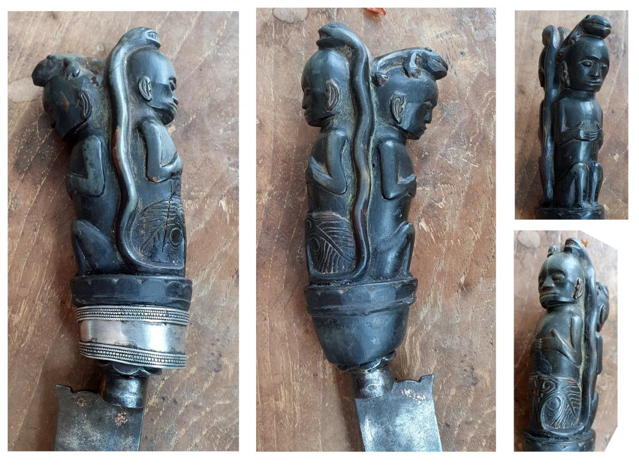

While the "snake" (rather from the mythological naga spectrum) and "lizard" (possibly Boraspati ni Tano?) motifs are certainly traditional, they obviously were quite en vogue with the colonial officials and tourists. From the craftsmanship, this hilt does not appear to be from the "good ol' days", I'm afraid. Also the janus-like double faces or back-to-back figures were a common motif of hilt carvers during the first decades of the 20th century.

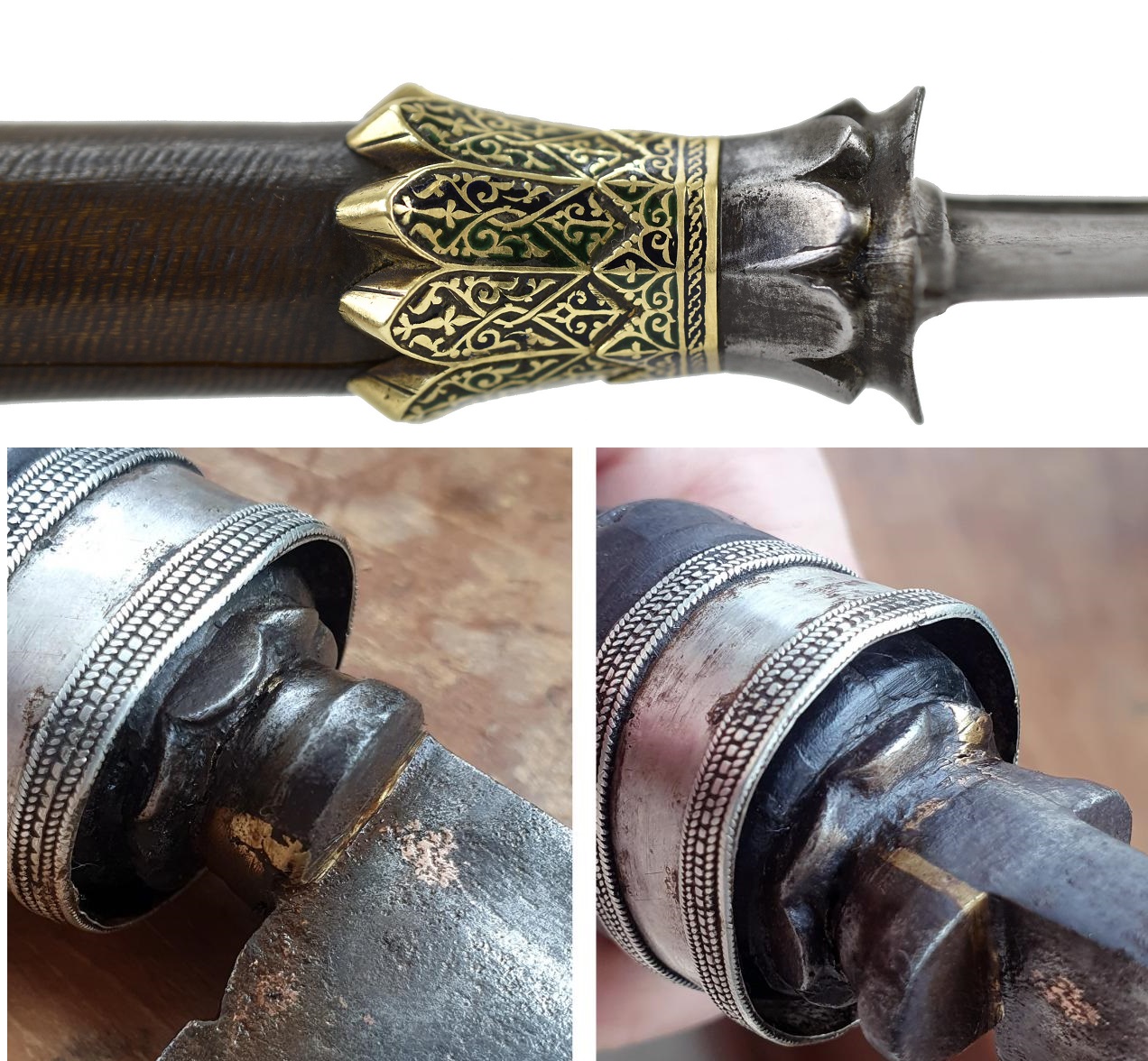

From what I can see, the lateral wings got brazed onto both sides of the blade in an attempt to mimic the corresponding Aceh feature; could this possibly made from some sort of knob that got cut in half? BTW, are you sure that the blotches on the blade are not remnants of the brazing? Same-o with the calyx which looks pretty decent - 6 lobes?

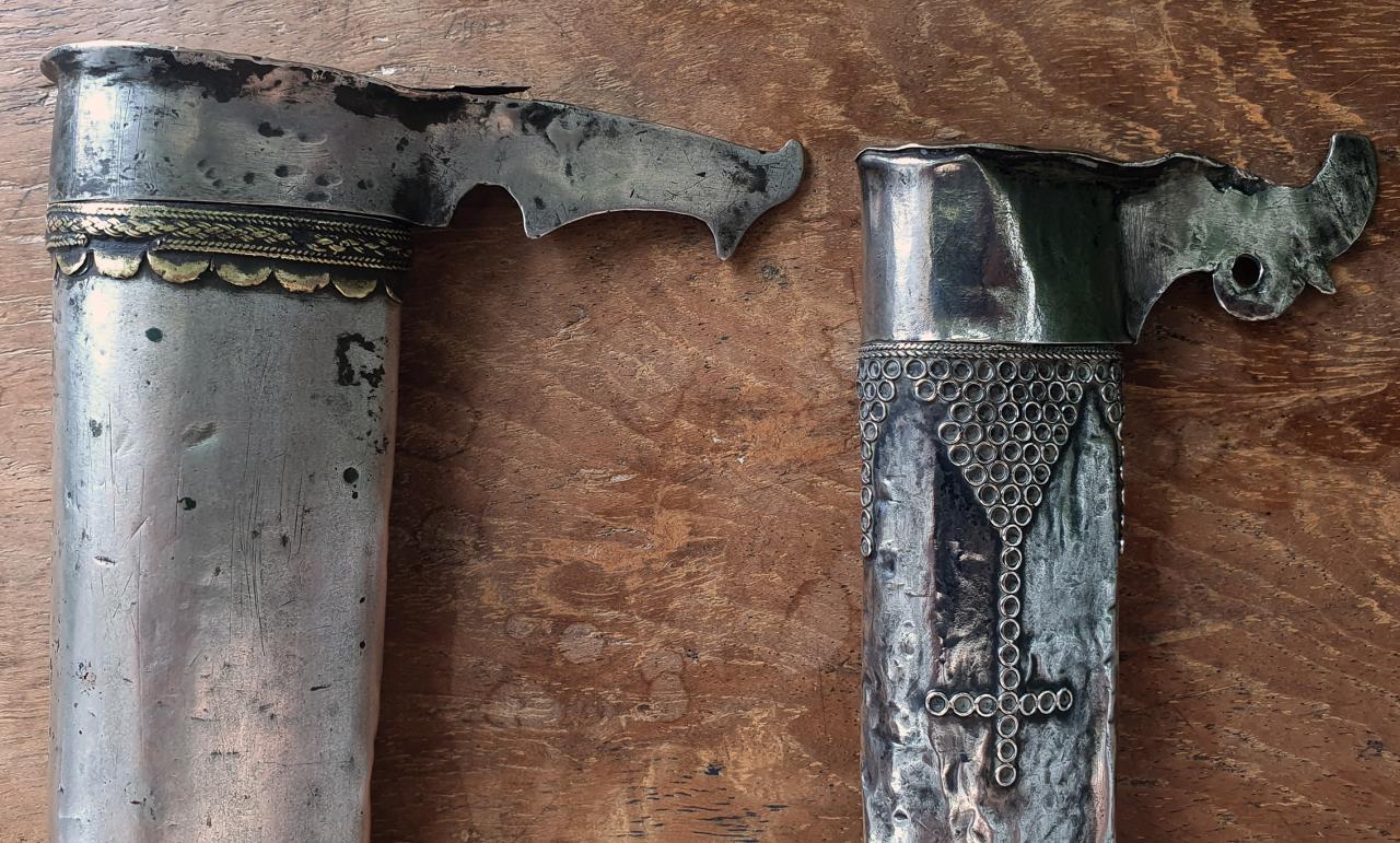

The scabbard exhibits some traditional Karo features including the profile of the crosspiece. I have a Karo dagger with a similarly almost-2-dimensional crosspiece. I have not yet been able to ascertain that this is a genuine old style though.

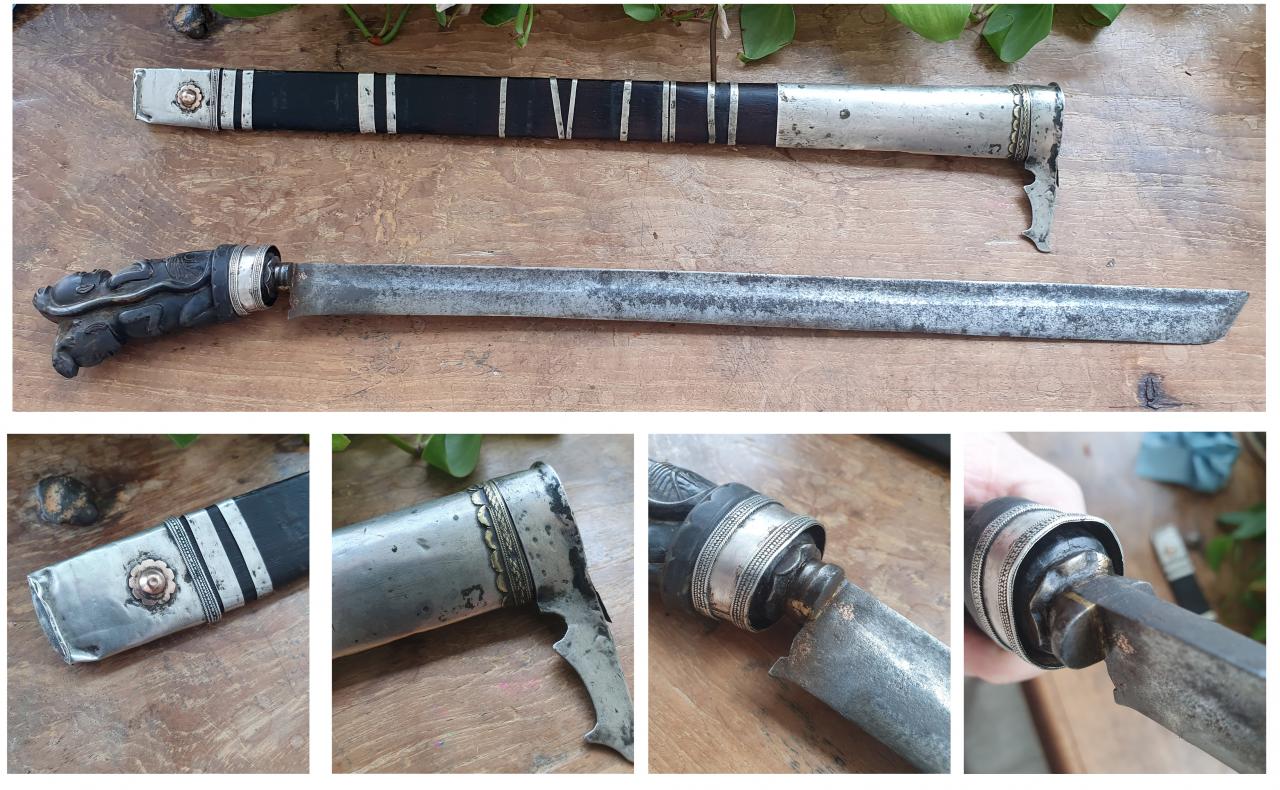

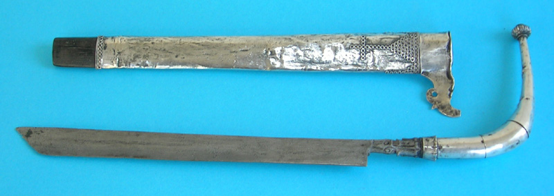

Hello Kai,
Some lopah petawaran scabbards have similar cross piece styles, see attached examples. I think that this is a very old genuine style IMVHO.
Old 3rd September 2023, 05:22 PM   #5
Hello Kai,
I agree that the hilt looks like a later replacement and doesn't show the best carving. But the nice silver ferrule seems to be made for this hilt. And then the brittle resin which was removed from Jeff.
It takes time for the resin or cutler's resin to get brittle.
The blade got a new handle a long time ago but to be certain that it was done for selling purpose is a little bit gamy IMVHO.
Quite possibly - however, traditional silver/gold smithing survived for much longer time since jewellery enjoyed continued interest within Christianized culture.
The time frame I'm suggesting (around 100 years) should allow for some ageing, especially if starting with a recipe for filling cavities rather than a more elastic mix for setting functional blades.

Old 3rd September 2023, 06:11 PM   #7
Post
Hello Detlef,
Yes, possibly: As I mentioned, it is tough to find well-provenanced, early examples. I haven't seen any of this specific laterally compressed type that I firmly trust to be from the old days, say, over 150 years old...
Paolo's LP seems to also exhibit this thin silver crosspiece; it's most likely much younger than the blade though.
As I mentioned, the crosspiece style - as seen in profile! - is genuinely old. In addition to your example, there are more flamboyant traditional shapes, too.
Old 4th September 2023, 05:34 AM   #8
JeffS
JeffS's Avatar
Join Date: Sep 2005
Location: Singapore
Posts: 466
Thank you for the discussion. Funny, I'm the owner of that lopah petwaran now... Minor point, but still curious - the metal streaks at the base of the blade are not the same material as the braising. It has distinct copper or suasa appearance. I've blown up the photos.

The bit of the "crown" (or is it a flower?) sticking out of the resin does look a bit like the ones on a sikin panjang, so that would suggest a reshaped blade. But it's a little thicker than the examples I could find just now, especially the flared section at the base of the blade sticking out of the "crown". Not sure what the normal range is on these.
