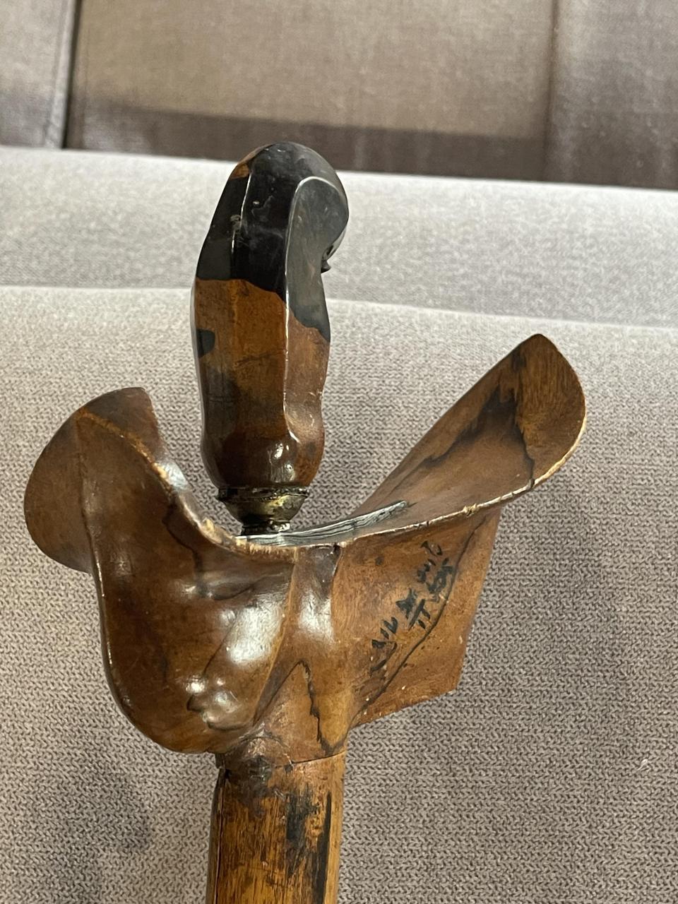

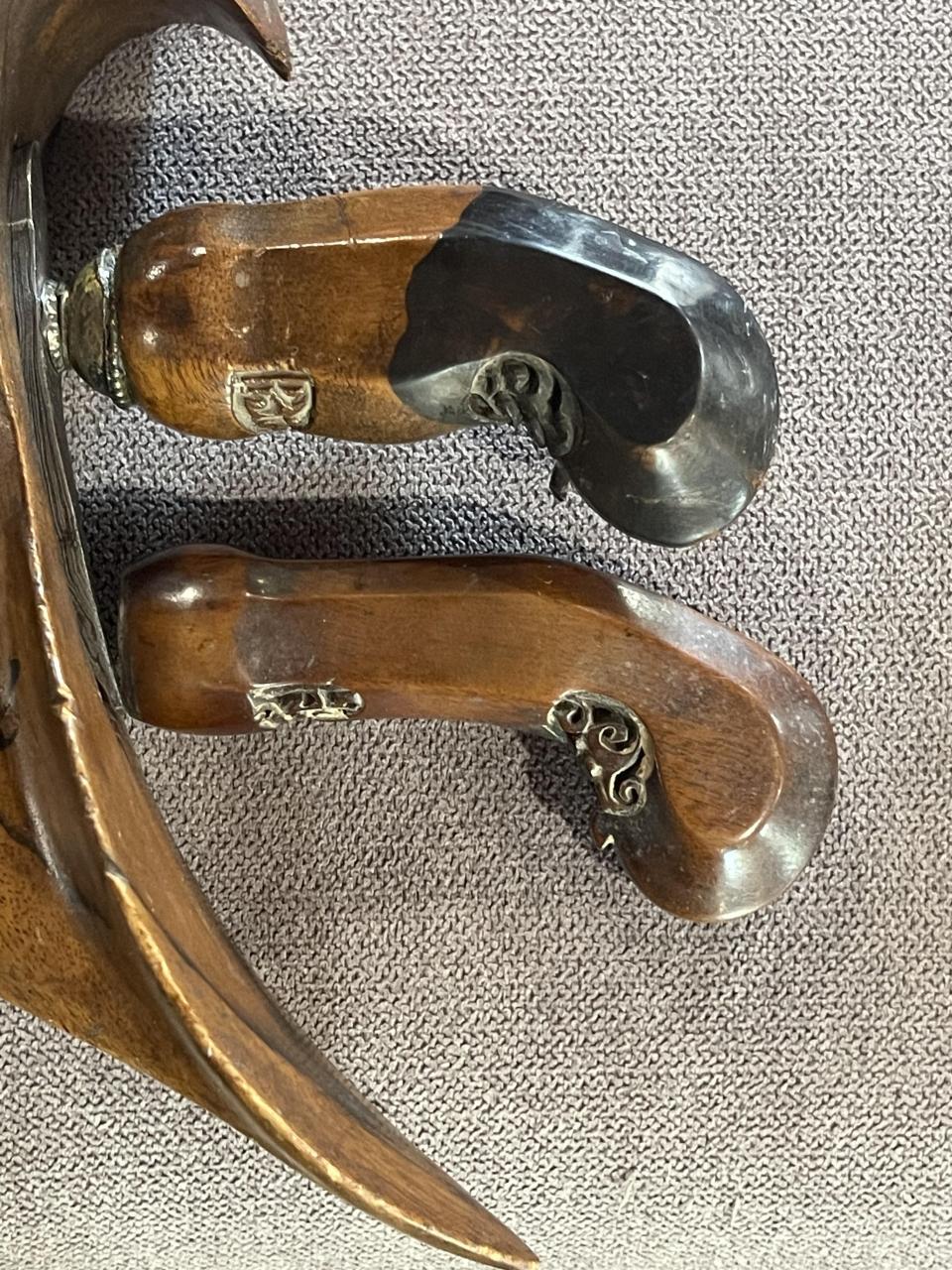

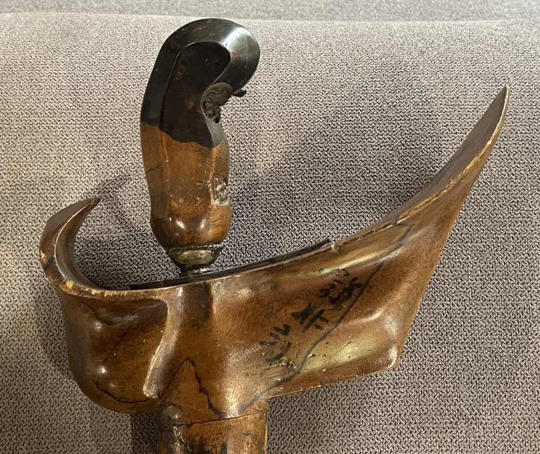

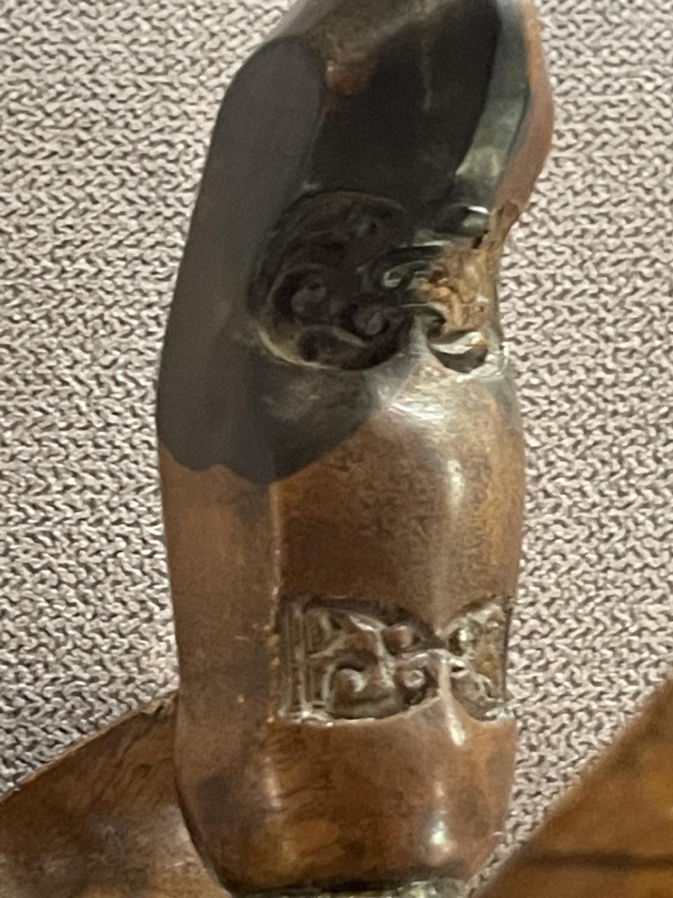

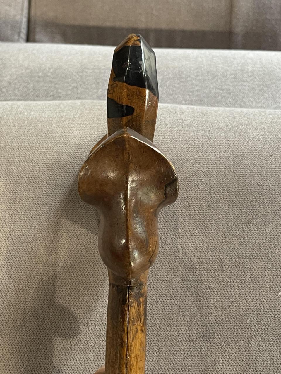

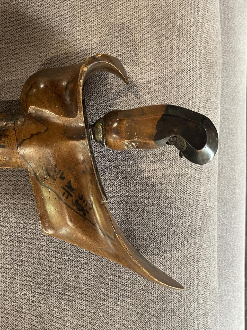

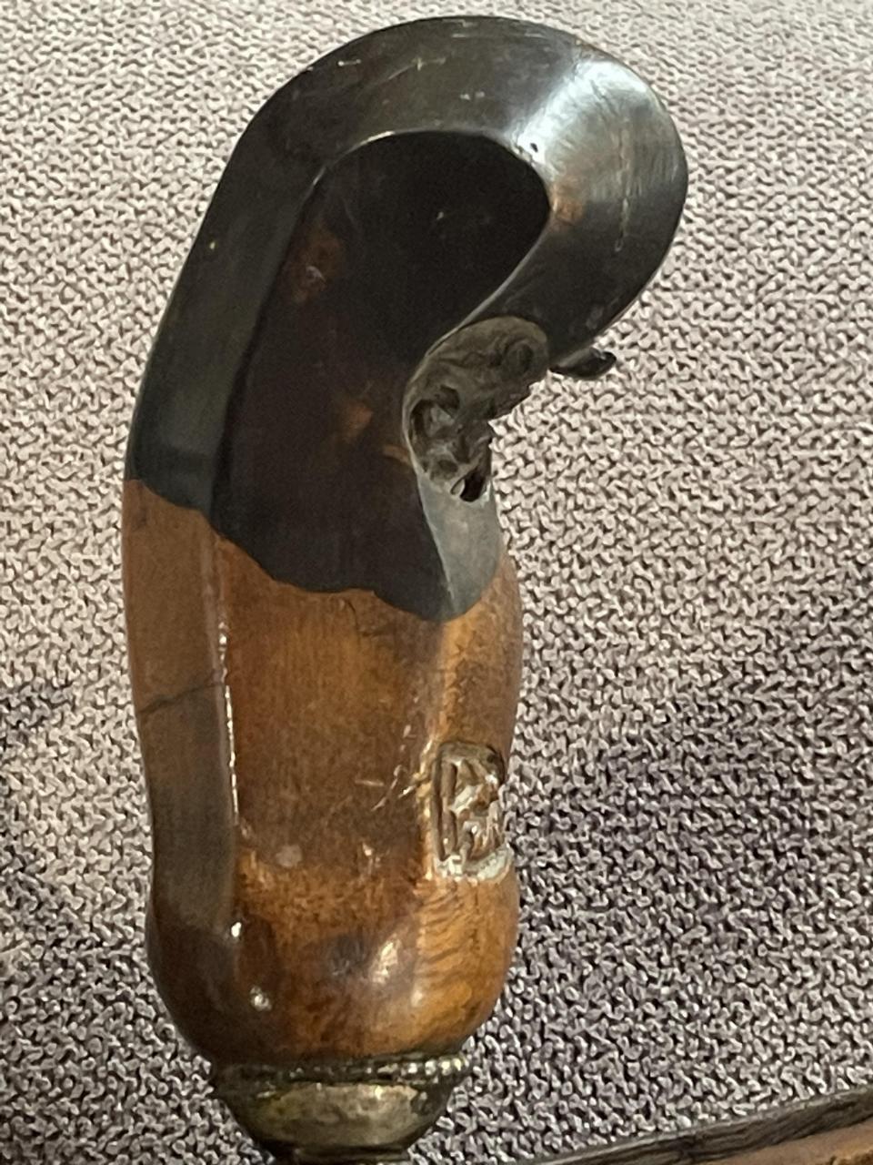

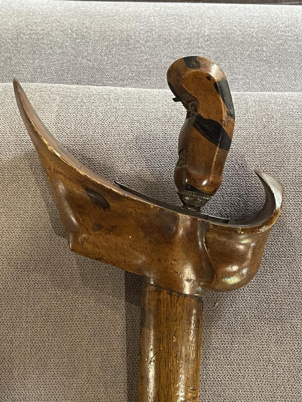

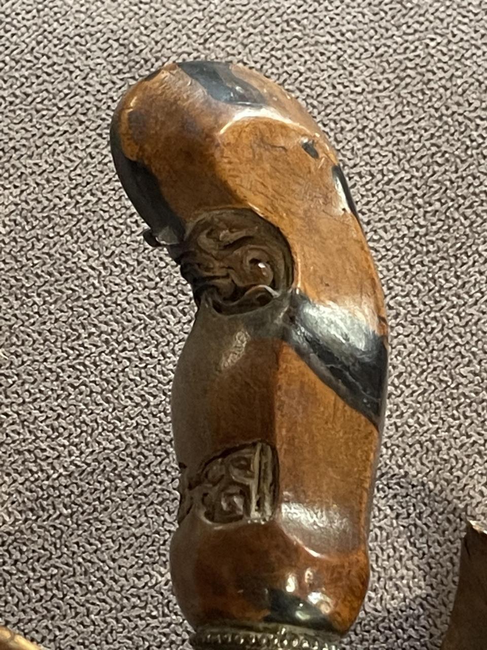

I've been waiting for this to arrive for many months now and I finally have it in hand to provide images and ask questions.
YES, the hulu is reversed... it is set fast.
1/ Is the hulu Deder Yogyakarta?
2/ Is the timber Timoho?
3/ The Warangka seems a little broader than most at 6cms... it this typical or denote anything?

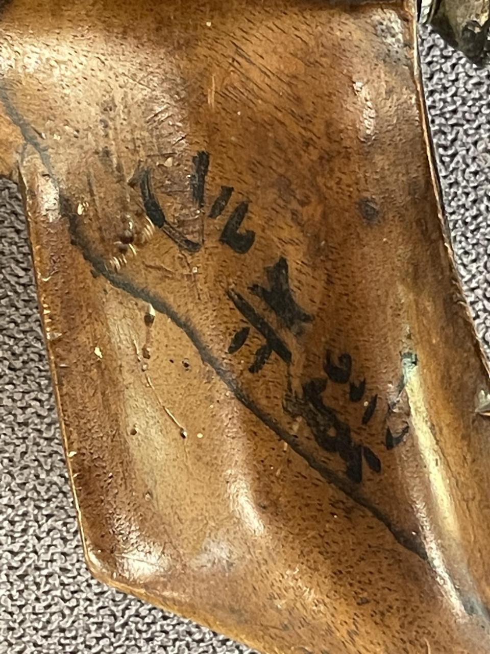

4/ Can anyone offer insights or translation to the inked characters to the side of the Warangka?
5/ Are there any determining factors in the images presented which could be indicative of a safe estimated age range for the dress?
Any other insights welcome.
Gavin
EDIT' Mods, can you please rotate images, they were in the correct orientation on my PC.

Based upon what I believe I can see, this hilt & wrongko looks like East Jawa, maybe East of North Coast through to East Jawa and maybe including Madura.
The wood might be timoho, it is certainly pelet.
Wrongko looks true to type, from the pics there does not seem to be anything unusual about it. A full length shot would help, but from what I can see the wrongko looks to be kagok capu, this form is found in Surakarta, but more commonly in Madura & East Jawa.
The hilt looks a bit like a Jogja narada kandha, but it appears to be too robust for this, the hilt style tends to Balinese bebondolan, but is too small for that.In my opinion, East Jawa. Mendak is North Coast through to East Jawa & Madura.
I cannot read the text.
For me, absolutely impossible to give an age assessment on dress that I could rationally defend, but if you'll settle for a rough guess:- pre-WWII.
I really do need to see the blade to have a halfway decent idea of what we're dealing with.

Hello Gavin,
I'd guess at Japanese script from WWII...

Like Alan I would place the scabbard and hilt to East Java. And pictures from the complete keris and the blade would be very helpful.

I think pre-WWII is a safe bet. But it could, of course, be older.
I would also place this as East Jawa. Though not a deciding factor, the mendak style is also East Jawa.
I realize your questions right now are about the sheath, but will you show the blade as well?

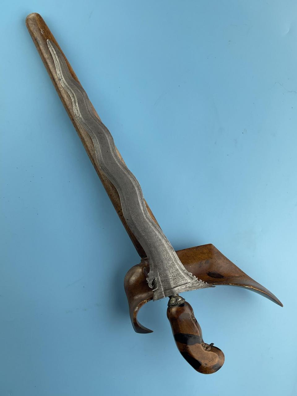

My query was only on the dress because it has a non Java blade within and that I found the hulu particularly interesting to me.

If non-Jowo Gavin, what is it?
A keris complete can sometimes tell a story, just looking at hats & coats tell us little about who wore them.

It is a classic hexagonal cross sectioned Bugis blade Alan.
Looks like an old marriage, I cannot see evidence of modern tampering with the timbers, a perfectly snug fit. The inside of the wrongko retains old dry patina with a warm glossy patina over the lip where the blade has rested and moved in and out... old timber working reliefs within seem undisturbed.

This sort of thing is very often a keris that was used by a mercenary. Javanese rulers at all levels, as well as private businesses all used mercenaries from societies that understood combat, usually Madura, Bugis, Bali. Scabbards were frequently discarded before & during combat & replaced with whatever was handy later. The idea that everything --- blade, dress & etc --- must match is a nice one, but nobody ever told the people who actually used keris.
For a dress keris all components of the dress should be correctly mated, but even then, the keris in that beautifully mated dress will sometimes be from somewhere other than where the dress is from.

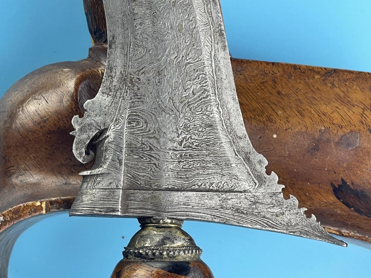

The subject is intriguing, and I present the blade for viewing.
This not the average Bugis man's keris. To my eye and hand it is expertly made.
The edges are some of the sharpest I've ever encountered and they are very clearly defined within a single row of twistcore that has been layered quite well.
It is thick, robust, weighty, but so elegantly balanced. It contains a "symmetry" of sorts (for want of a better word), within the asymmetrical blades that keris are.
If indeed it is an older marriage under the subject you have pursued, the blade may offer a better glimpse in to time.
Gavin

Love this blade! Thanks for showing it.
Any plans to try to loosen the adhesive fixing that hilt so that you turn it around?

Beautiful blade! I personally would keep this keris like this but would try to turn the handle in the correct direction.

Superb, the work of a master.

Yes, a gorgeous blade.
What is a bit unusual for a Sulawesi blade is the single twisted rod on a side. This actually could be the first such blade I see. Two rods on a side are much more common.
Old 5th July 2023, 12:09 AM   #17
Thanks, Gavin!
Could you please provide a pic from about the middle of this neat blade, too?
From the base of the blade, the pamor is tough to evaluate despite the very nice stacking.
