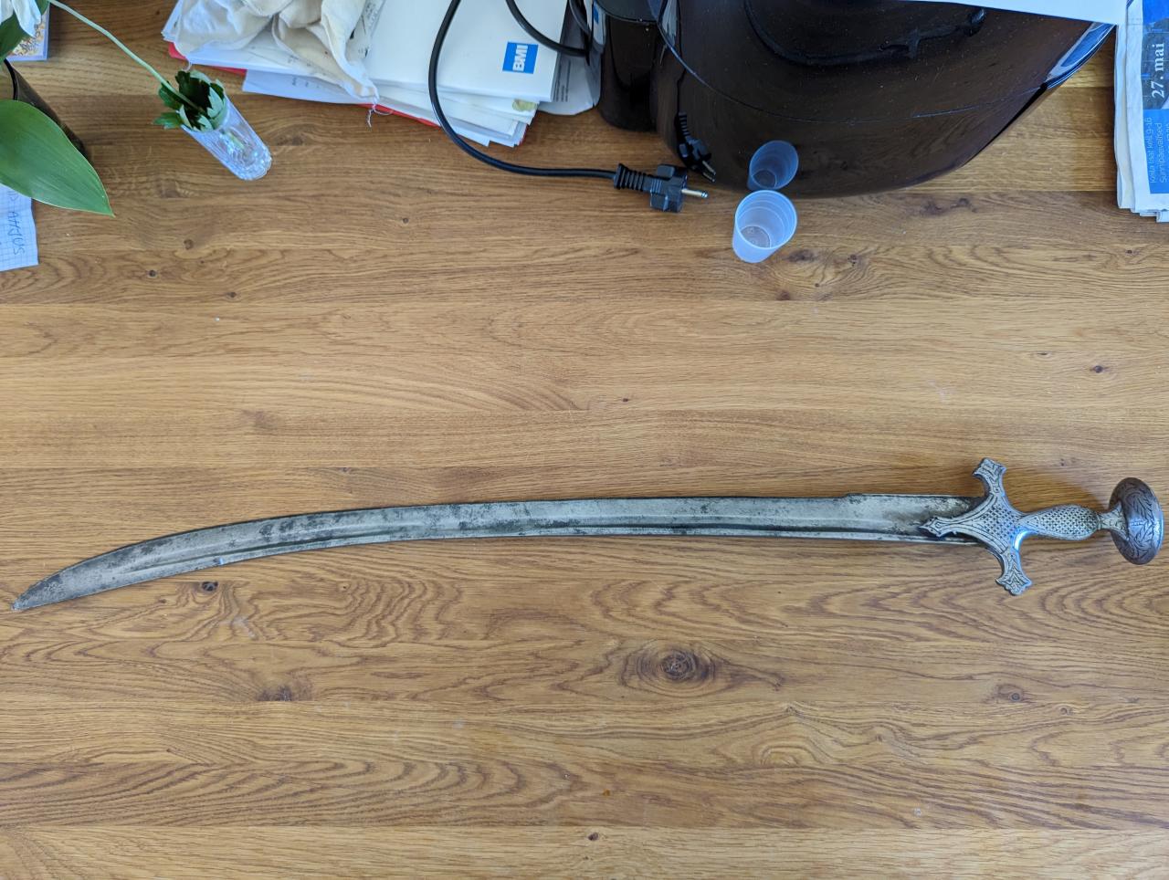

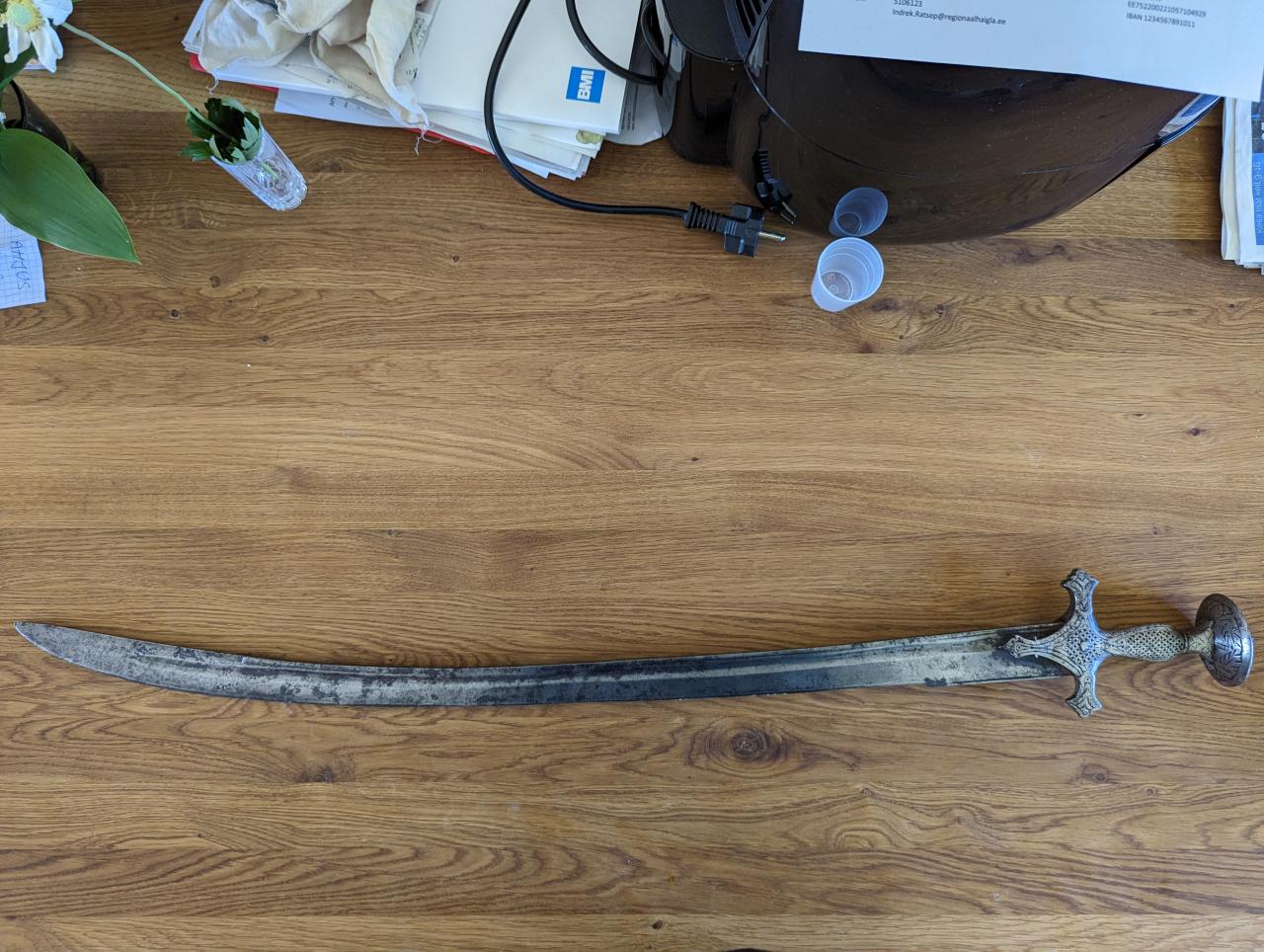

Hello fellow blade enthusiasts!

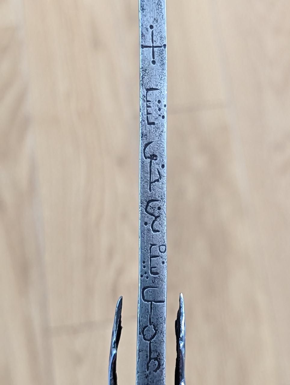

I have had this tulwar for some time now and it would be interesting to know more about it. So I'd appreciate any thoughts about it (including the inscription on the spine of the blade)
Thank You in adavance!

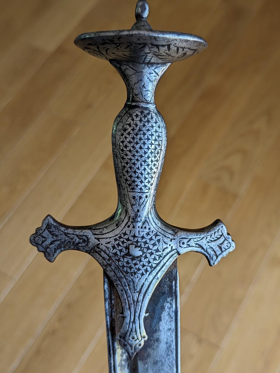

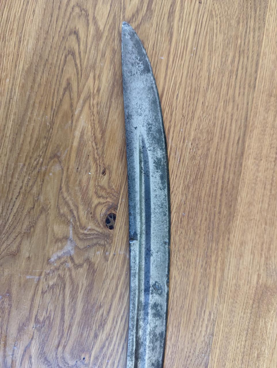

Hi Rareis. Your tulwar is actually of a pretty rare type, dating to around the late 17th century, at least for the hilt alone. The blade is a bit more ambiguous, however given how worn it is a maybe 18th century-ish date would be best.
To give a bit more detail about the hilt, it was likely made in (what is now) northern Karnataka, around Bijapur (Vijayapura) or one of the production centers near it. This area was known for producing mostly katars and basket hilts with extensive piercing in the same style as your tulwar, and indeed it seems like, while rare, they produced some tulwar hilts in this style, as shown by your example.
The inscription on the spine is likely a persian-based language like Urdu or Dakhini, the predecessor to Urdu. Or, indeed it could actually be a Farsi (persian) inscription. Either way, I am unfortunately unable to read this script, so I cannot tell you more about it than that. Worth noting that it seems like the inscription is surrounded on either side by decorations, so based on how short it is the inscription likely gives a person's name, a place where the blade was produced, or a short religious saying.

Thank You Nihl very much for your expertise. It gives whole other perspective to my sword. I really appreciate the forum and the people that know their blades

So I did take a crack at the inscription. I'm not a native speaker or anything but enjoy translating anyway. The inscription looks like عمرپيند بن خونشا to me though I'm not super certain, this was just my best guess. The translation would be pretty similar in most Persian influenced languages it seems. My best guess at a translations is something like "Omarbind (or Umarbind?) ibn Kunsha". So a name then? Once again this is not my area but is my best guess. I hope it is not super far off.
