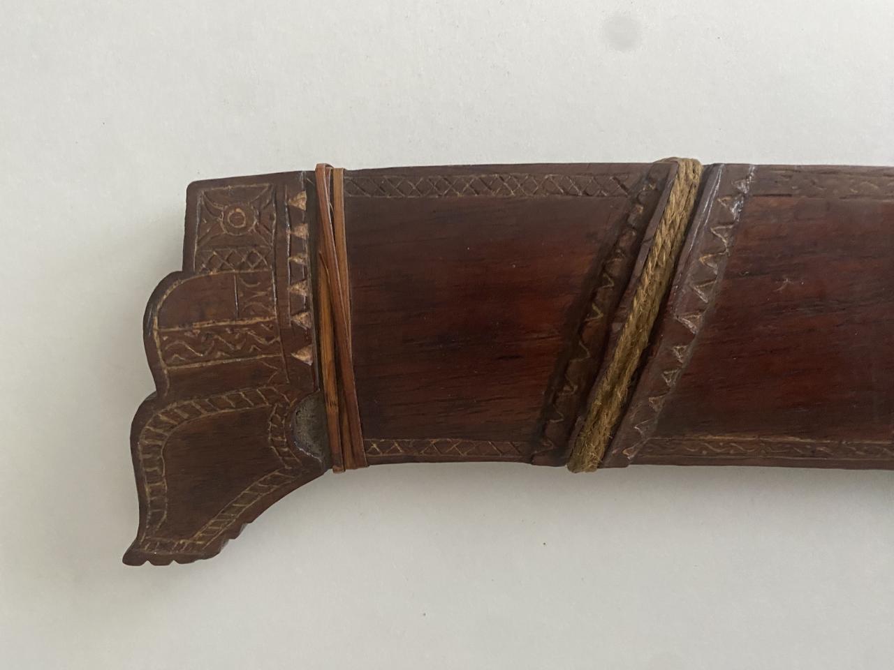

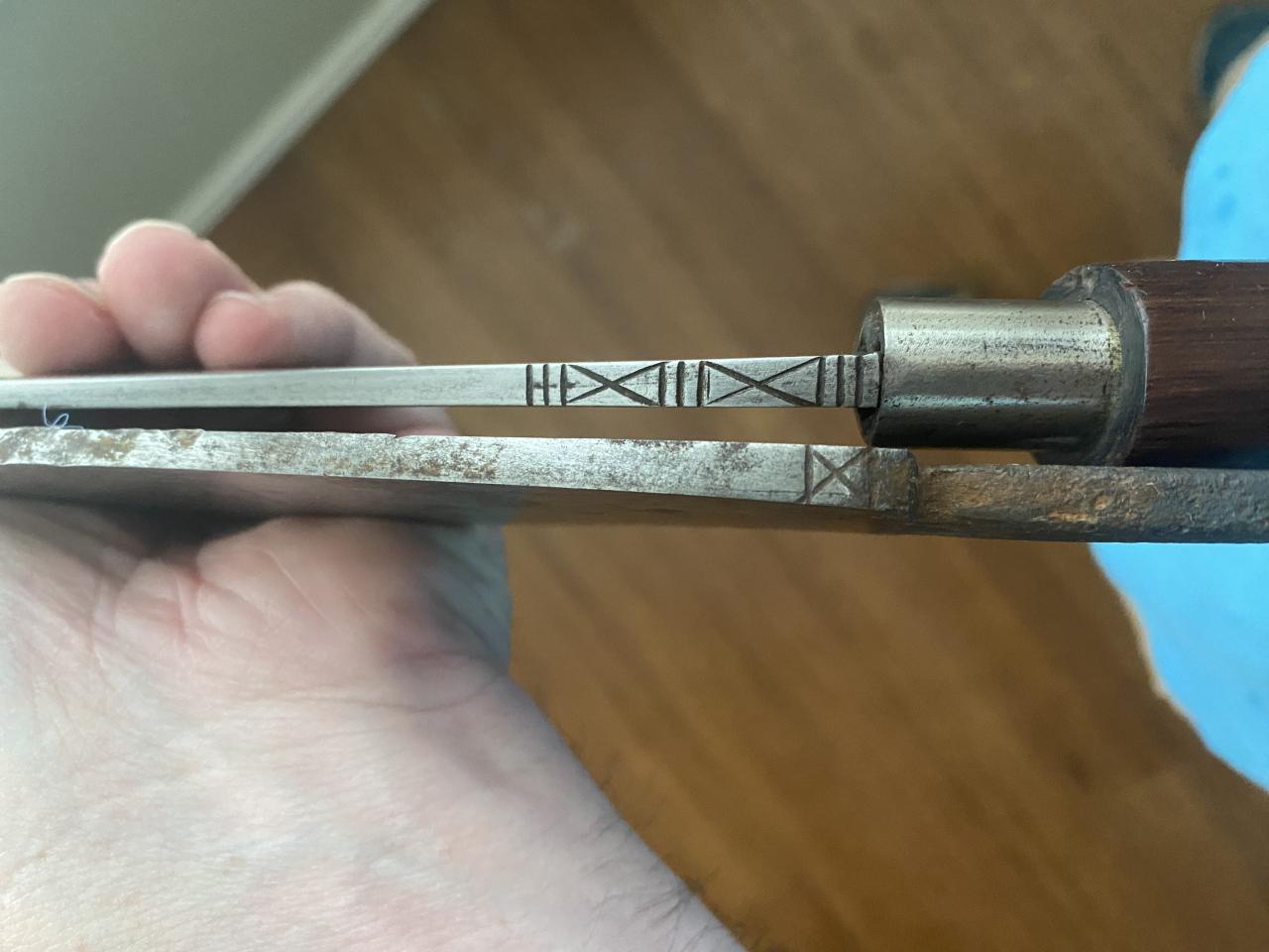

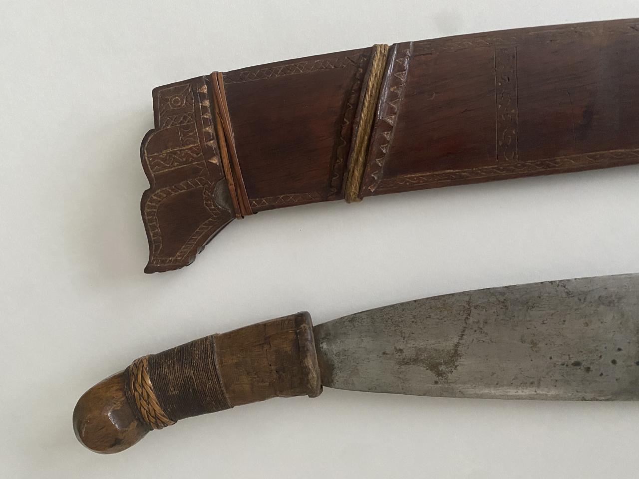

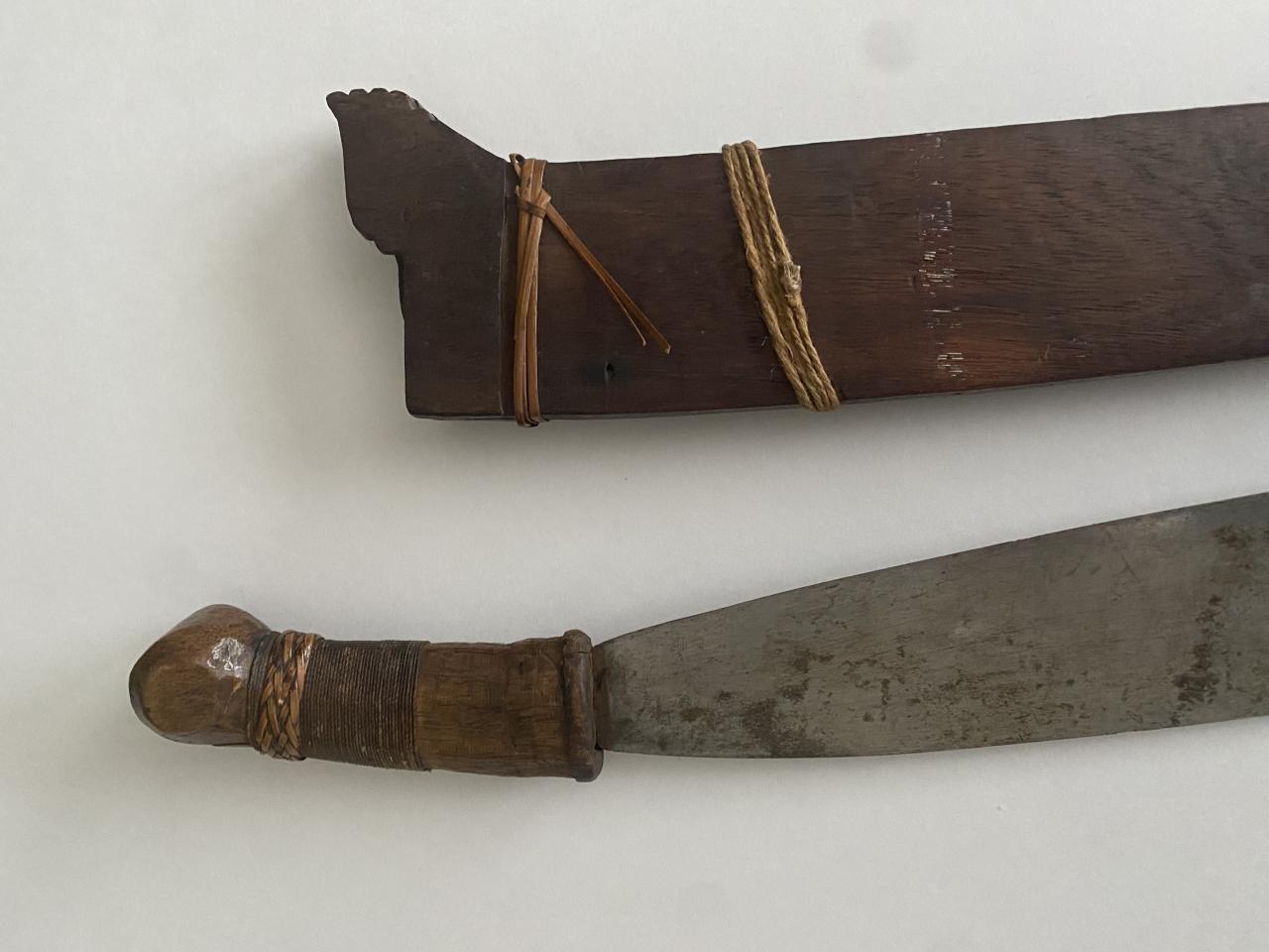

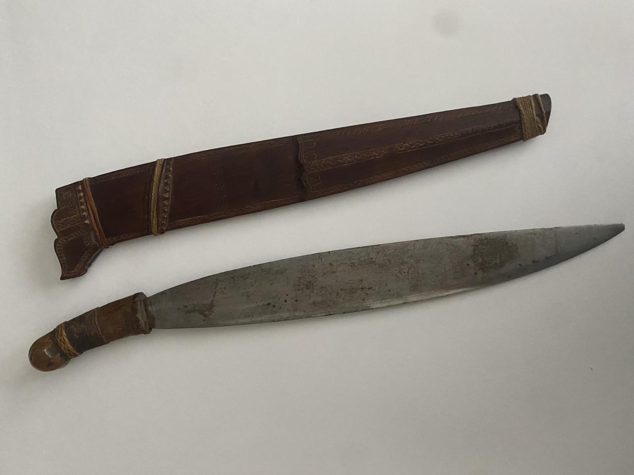

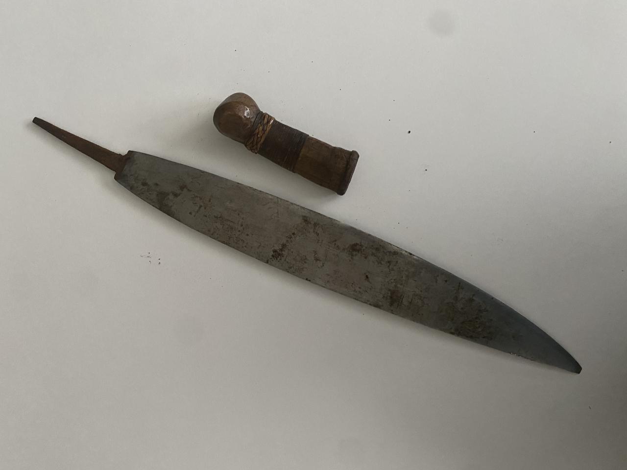

New addition to the collection. Hoping to get some input on this. Can I call this a barung or keping? Blade is pretty thin, slightly tapered. I suspect it’s an older blade that’s been re-handled. If so, can anyone identify the sword the hilt would have originally belonged to? I noticed the blade has a “x” mark similar to my Luzon Hundang. I was able to wiggle the hilt off with little effort. Overall feels like a well-used piece. I feel it might be from Palawan? Thanks!
Dimensions: 52 cm overall length, 41 cm by 6 cm blade.

At first look I thought it's from Palawan as well, mainly because of the rattan weaving. If it's indeed from Palawan, they call it badung.

Interesting piece you have there. I took your picture and outlined where the maximum width of the blade occurs. It is actually on the hilt side of the blade rather than further towards the tip. A Palawano badung has a much more forward-weighted blade, with the maximum width closer to the tip than the hilt. Thus, this is not a Palawano badung IMHO. It is more in keeping with a Sulu blade that has been dressed in another fashion.
In the following picture, I have shown the line of maximum width on your blade and also two arrowed features of your scabbard: one is the slanted area of attachment for a string belt; the other is a small "wing" to the throat of the scabbard on its bottom side.

To summarize, I think you have either a Sulu barung blade dressed in Chavacano fashion, or a bolo made and assembled in Zamboanga.
