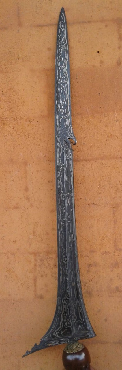

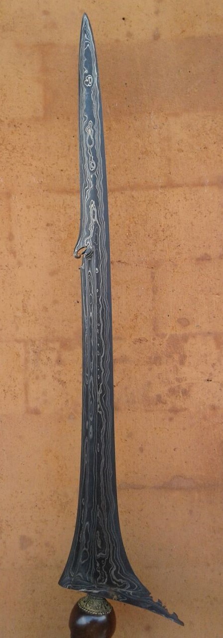

I want to save this keris Kamardikan for our records!

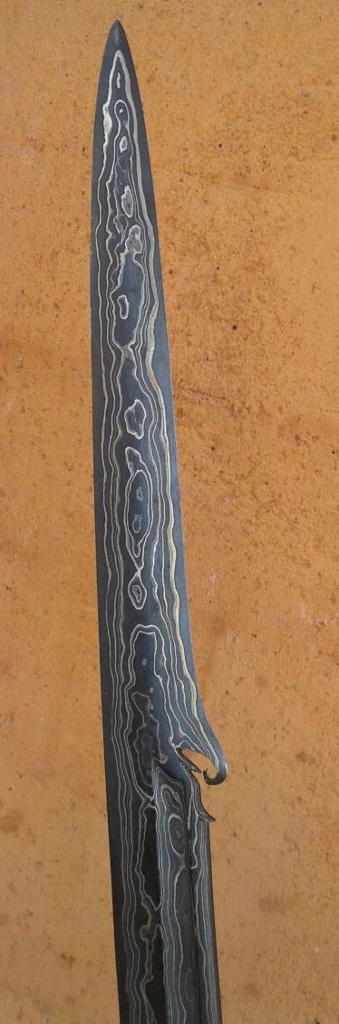

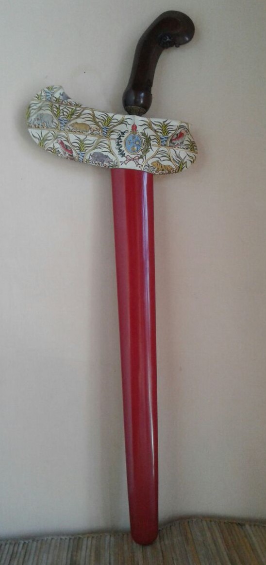

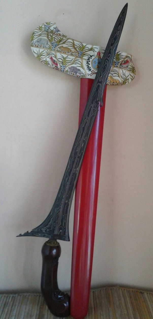

Nice looking Mahesa Kanthong blade. I like the sunggingan as well. Is this just something you ran across on the internet or do you own it. Kebo/Mahesa keris are another special interest of mine.
What makes it "important" to you?
Old 8th June 2023, 09:39 PM   #3
Hello David,
Thank you for your comment! And no, sadly I am not the owner of this keris but have handled it many times. It is now in Saudi Arabia with a person who don't will know about this keris.
The importance I will exemplify a little bit later, I hope that Alan will recognize this thread and I am curious what he thinks about this keris.

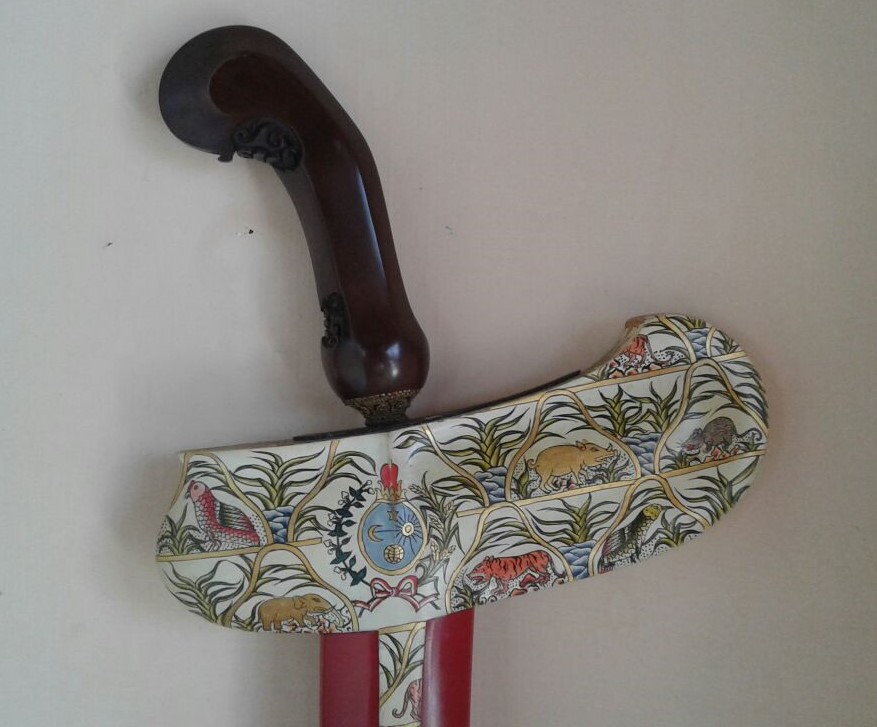

One thing I can tell before, the wrongko and the sunggingan are the work of the people who work to this time for the keraton Solo.
And we seems to have some similar interests, I also have a special interest in Kebo/Mahesa blades.

Looks like a Keris from Jitar.
(Which means Djeno or his relatives, but this really looks like Djeno or Yosopangarso.)
High quality indeed.
Perhaps except for the Mendak, but the fit of it is good.

Wow, Gustav, you have a very good eye!
This keris was ordered 1990 by Dietrich Drescher by Djeno and when I remember correctly 5 years later finished and fetched by Wolfgang Spielmann and was until his death in his possession. The wrongko is from cendana but by carving a little fault pops up so it gets its sunggingan.

Posts: 7,232

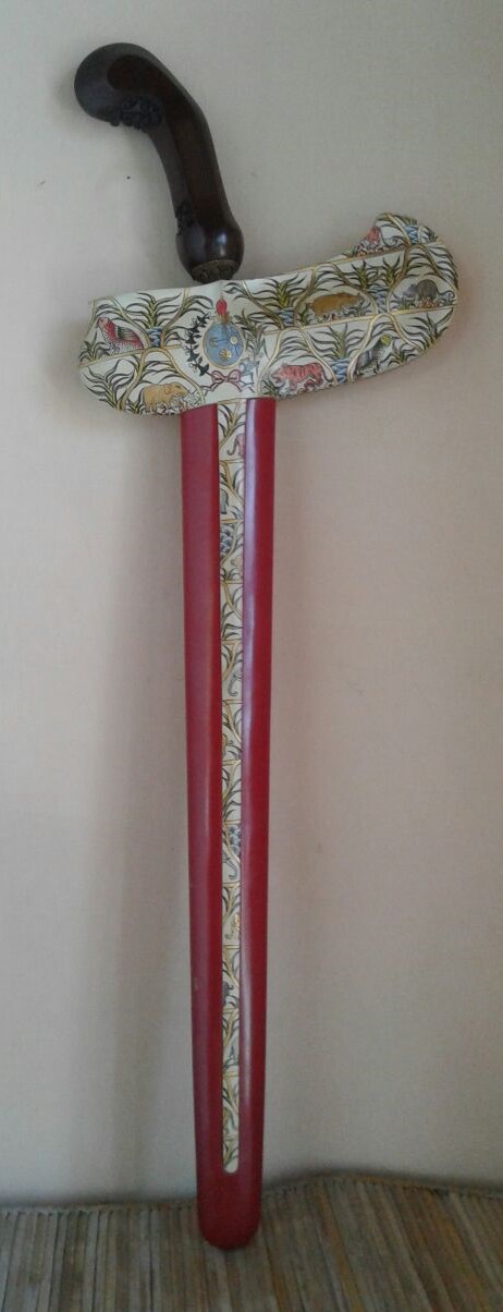

Yes Detlef, I have noticed this thread, but I cannot really contribute much.
In 1990 the man who was recognised as probably the best sunggingan artist in Solo, and some people believed that he was one of the best of all time, was an artist from Pajang, just next to the rail crossing, his name was Legiman.
I have looked closely at the sunggingan work on this wrongko, and to my eye it does not appear to be Legiman's work.
I have a number of wrongkos that were painted by Legiman, and in fact, he was the only artist that I ever used for sunggingan work. When his eyesight started to go I stopped ordering from him, and any sunggingan work I acquired after that was not bespoke, but purchased from a dealer.
I am uncertain if Legiman was still working at his best at around 1995, when it seems that this keris was dressed, but if the work was not done by Legiman, I would have no hope of identifying who might have done it.
I do not know who might have painted this wrongko, nor who might have made the wrongko itself.
The keris itself certainly does look like the work of Djeno. I will not comment on this blade because the indicators that I have been taught to use in the appraisal of quality vary very widely from the ideas of collectors in the Western World, & for that matter from the ideas of most people in Indonesia who are outside Solonese society.

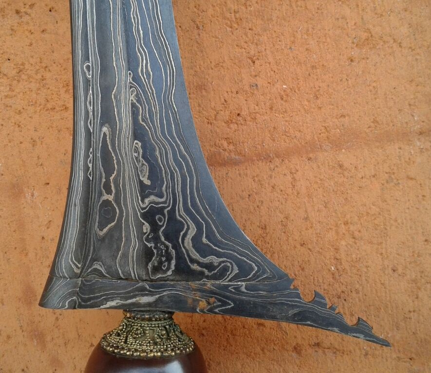

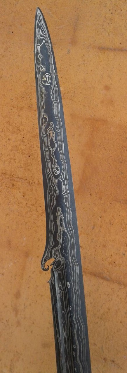

It looks like someone has allowed some rust to slip in on the gonjo of this important keris.
Old 9th June 2023, 06:09 AM   #8
Yes, I've noticed this. Wolfgang Spielmann lives his last years on Bali and after his death his wife don't will given this keris the care it needs.

Hello Alan,
My memory regarding the painting can be wrong.
And I know that you have a different view about the work from Djeno.
But I have posted this keris because I think that Dietrich Drescher who ordered this keris plays a great rule that the keris is still alive. And only a few people have seen the work from Djeno, this was my intention.

Detlef, thank you for posting it, without doubt it is a valuable reference.
Do you have information on who did the Wrongko and painting?

My enjoy Gustav! My memory is stated in #3 but it's just my memory.
