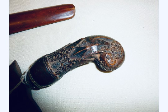

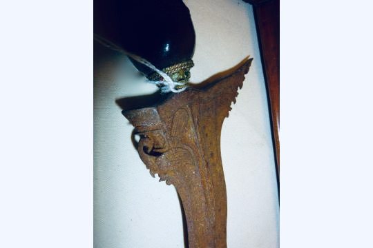

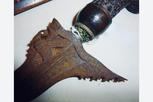

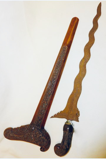

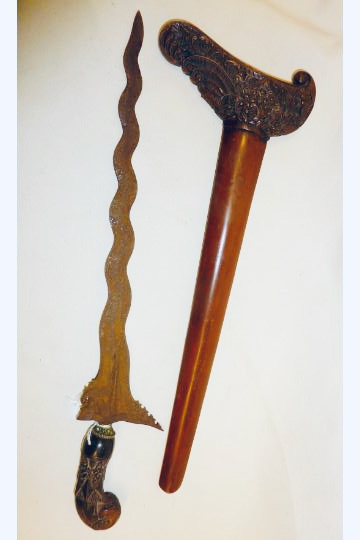

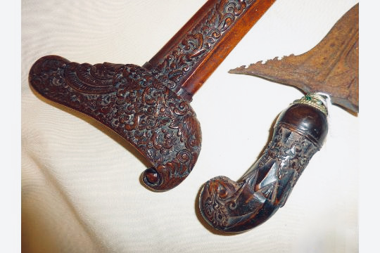

This is a recent acquisition. Keris are not my area of collecting, though I have the inevitable handful of items included as secondary pieces in auction lots, but this one caught my eye.
I'm afraid I only have the poor quality auction photos to share at the moment.
I would of course be interested in any information the knowledgeable might be able to share, but my primary request is for thoughts on how I might sympathetically restore the blade. Normally I would approach it carefully with a little oil and either 0000 steel wool or 800/1000 grit paper, but I suspect that is not the best approach with a pamor blade. Being UK based any products suggested would need to be UK available.
I would be grateful for any knowledge and suggestions shared.

Below is something I prepared years ago for people who asked me questions similar to your question.
I used to recommend pineapple juice as the cleaning agent, I no longer do because I can no longer buy pure, natural pineapple juice where I live. I could make my own, but that would cost too much, and ordinary household white vinegar is just as effective.
I actually completed the vinegar cleaning of three pamor pedang blades yesterday, I brought these back from Bali 9 or 10 days ago, and they were in heavily rusted condition, it took 4 days of exactly what is in the below cleaning instructions to bring these blades to a condition where they can be stained.
When your keris is clean it will need to be stained.
Staining a keris blade correctly carries an element of risk & I am not prepared to put instructions for this on a public notice board. If you wish to understand the staining process, PM me.
CLEANING A KERIS BLADE
Actually any mildly acidic agent will do the job. In Jawa the traditional agent is coconut water, but in recent years people have used other acids such as citric, and very dilute sulphuric.
Vinegar works well too.
Remove the hilt & mendak before beginning the process.
Scrub the blade with detergent and a hard toothbrush under warm running water, to get rid of any surface dirt and oil. Lay the blade in a trough and cover with the cleaning agent.
A plastic wall paper hanging trough is good for this. Remove the blade each day and scrub it under running water with a hard tooth brush, to remove the rust that the cleaning agent has freed up.
I usually do this twice a day-morning and evening.
After a few days you will find that most of the rust has washed off, but there will probably be still a few small areas that have little bits of hard rust stuck to them. Carefully chip these pieces of rust off with a sharp tool. A small sharp pocket knife blade, or a saddler's needle works well.
Most blades come clean in under a week, but it could take longer.
My experience with household vinegar is that longer periods in the soak do the blade no harm at all.
When all the rust is off, wash the blade thoroughly, and if you do not intend to stain it, kill residual acid with bi-carbonate of soda. Paint on a slurry, leave for a few minutes, thoroughly rinse off. Pat the blade dry, and then leave in hot sunlight, or use a hairdryer or heat gun to ensure it is totally dry.
This completes the cleaning process.
Storage in a plastic sleeve & use of oil is recommended.

Plenty of information already given.
I would say that it is indeed not recommended to use any abrasives on a finished kris blade.
Mild Acids are all going to do the job.
Etching, is optional, but is not an easy job but... you may certainly try the methods recommended in many threads here. If you have someone whom washes in Warangan over there ( we have a few in the NL) do that.
About preserving in a plastic sleeve with oil, in the NL this is not done, to my knowledge ( and I know quite a few collectors) . I don't think that in a normal British house this would be a requirement unless humidity is very high. Collectors in tropical climates may have different requirements but temperate climates don't, in my experience, require this.
I would add that this is a Maduran blade and sarong and that the hilt is showing in the opposite orientation. Its is normally (or it should be) only friction mounted with some cloth inside you should be able to gently ease it off and then when finished with cleaning put it in the right way.
