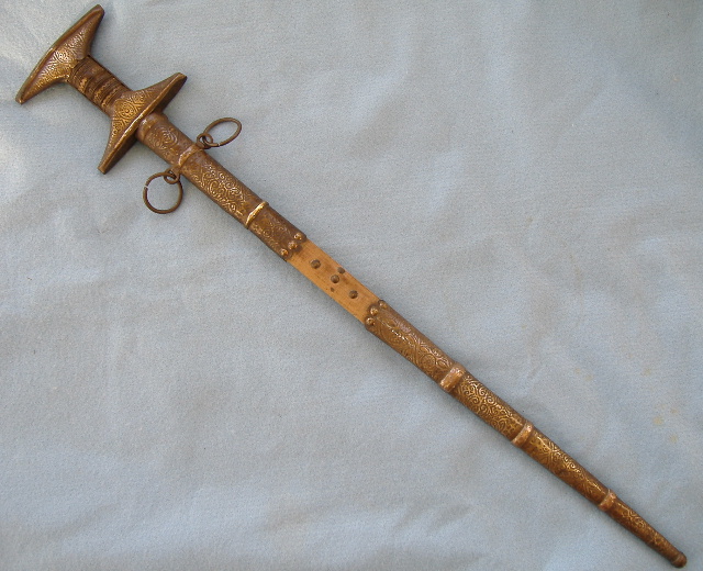

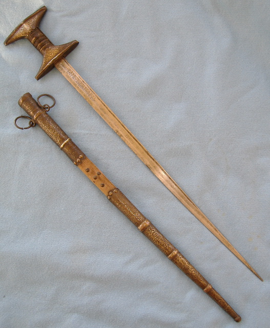

This sword has been attributed to Africa from Morocco to Ethiopia. Personally, I think photographic evidence strongly suggests Morocco, and I believe this form has already been the subject of a previous thread.

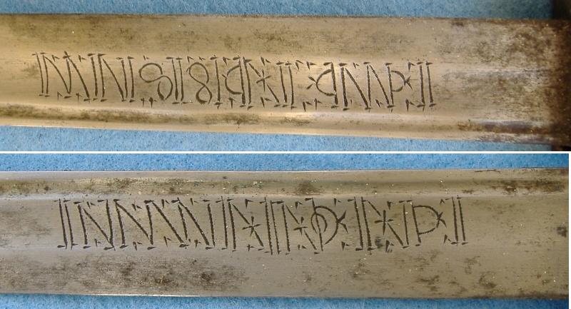

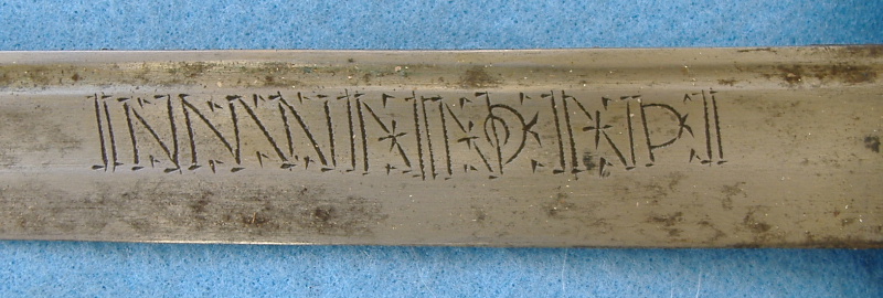

But, check out the inscription on this one. This example has the thickest, heaviest blade I have seen on one(though I have seen only 4), and I have never seen an inscription of this nature on anything.
One forumite has already suggested to me privately that it may have been a crude attempt to mimic a European inscription in a practically illiterate manner. I can understand that theory when you consider the prestige of European blades in much of that part of the world.
Any ideas??

Very nice sword! Here is a link to the Berber alphabet, just as an option to consider. To me, there is no resemblence, so most likely it is an imitation of text in Latin:
http://www.omniglot.com/writing/tifinagh.htm

I agree with Teodor on his observation on the Berber alphabet, and just wanted to add the history lesson to support what you said on Morocco!

If you invert (mirror) one of the images, you will find that some "characters" look alike .

I know nothing on this subject, but a quick look at "Ancient Berber (vertical)" (http://www.omniglot.com/writing/berber.htm) looks much more likely than an example of Ethiopian script (http://www.ancientscripts.com/ethiopic.html). I also tried Coptic just for fun, but that just looks like Greek.
