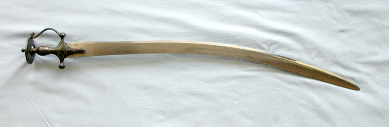

One interesting thing about swords are, that they were inherited, and when sharpened often. Have a look at the attached. At the base it is half a centimetre broader than at the curve. Normally the blade would be as broad at the base as on the curve, but not here. So this indicates to me that this blade may be a lot older than the hilt.
Old 24th January 2009, 08:55 PM   #2
Posts: 10,851
Hi Jens,
Definitely an interesting observation, and the wavering on the blade surely does evidence this blade has experienced a long working life. Whether passed on in families, or simply traded and reworked, it is just a matter of time as the only way to make the blade servicable is the grind to sharpness.
Presumably, this was often a do it yourself project rather than relying on armourers who would have been a bit more skilled at uniformity. Perhaps this would evidence a weapon in use outside the perameters of established forces?

Jens, I think we can make such a presumption, but the continuos sharpening is only a circumstantial evidence of a possible and probable change of hilt, not a conclussive one. We cannot infere automaticcaly one fron the other. But your point is very good, tough I think we can find relatively unused blades with the hilts changed all over the world.

As far as changing of the hilts goes my theory is one size does not fit all. So as a sword is recycled through it's different owners each being slightly taller or shorter with varying hand sizes one could assume that the hilt could be easily replace to fit the individual warrior. Take a look at this photo from the 19th century they three are not Indian but are a good example of what I am talking about.

Thank you for your answers. I am of course guessing, as I can’t know for sure.
When it comes to the hilt sizes there is something strange. On almost all the hilts on the tulwars, the grips are within 5 mm, from 7.5 cm to 8.0 cm. The smaller hilts must have been made for children; I know of bigger hilts, but they are rare, and sometimes you see the disc has been removed, maybe to give room for a bigger hand.

I think if a hilt has koftgari in good condition and a worn blade, there is a strong likelihood of the blade being rehilted....but for a blade with a munitions grade hilt it would be rather hard to say.
Apart from the old tulwar I have that had been attacked with an angle-grinder, I have never seen a tulwar with severe grind-marks to the edge. Could this mean that a worn blade was sharpened many many times, by removing the least possible amount of metal, and not just a few times by someone removing a lot of 'beef' all at once?
I would think so, as these were often heirlooms as well as weapons, and I would imagine that they were preserved as well as possible and not sharpened away needlessly.
I have a rather old tulwar, with the blade worn down by maybe 25%, but the hilt in this case has most of the koftgari worn away, so the two parts may be original to each other.
I have often wondered when a tulwar blade was considered to be past being useful.
The worn one mentioned above, has the sometimes seen rather thick spine, but the blade is now rather narrow.
I wonder; It has been kept sharp, so was it considered a viable sword to take to a fight?......a secondry weapon?

It is a interesting feature you bring up Jens. You see the narrowing from frequent sharpening not uncommonly on Talwars with laminated or mono-steel, and rarely on wootz blades. This same feature can be seen on some central Asian sabers but rarely anywhere else. I have read, but can't remember where, that the Sikhs' were obsessive with sharping their blades. It was mentioned that it was quite a dishonor to have a dull blade. I would think then that the narrowing more represents use and custom more than age. Your point that a hilt with minimum wear would not likely be original to a well used blade, would seems valid.
Is it possible that the blade was intentionally ground down to lighten the blade? If so then your hilt may in-fact have been the original one.

We will never know how common it was to change the hilts, but we can try to guess, looking at the type of hilt/decoration and how worn the blade is. Some blades were used/kept for reasons of veneration, but the hilt could have been changed, due to the change of fashion – depending of how big the owner’s purse was.
Like it has been mentioned, it is likely to believe that in most cases the owner or one of his servants made the sharpening, and why sharpening the edge not being used? This is likely the reason why most blades are worn at the curve. Please remember, that swords were expensive, so when sharpening the blade there is no reason to believe they removed more steel than necessary.

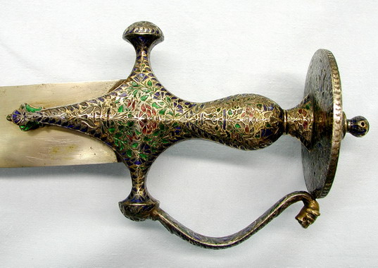

Here is also a picture of the hilt - worn, but still nice.

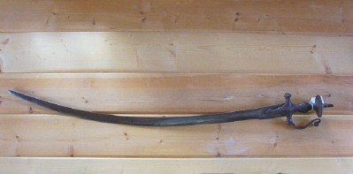

Here is one of mine with a much sharpened blade. Very sharp and does not appear to have seen a grinder. The hilt I believe is original to the blade.
Cheers
bbjw

This is a very good example of a blade, which has been sharpened all the way, and not only at the curve

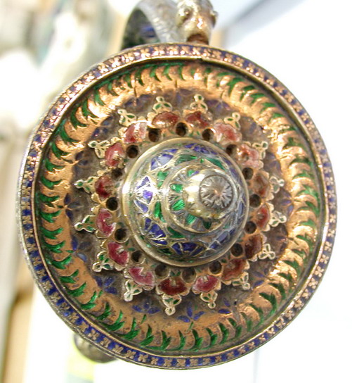

Here is the top of the disc.
Old 26th January 2009, 08:54 PM   #18
Pukka Bundook
Join Date: Jan 2007
Posts: 803
That is spectacular Jens.
Simply stunning.
I'm glad I asked to see it!!!!!
R.

Default Inlay?
Jens,
What kind of work is it on the hilt?

The hilt is gilded silver and the enamelling technique is champlevé. You have to be careful when judging the picture of the disc, as it was cleaned just before it was taken, and the light was very sharp. I am not yet sure from where it comes, but as the red enamel is brownish, it could indicate Sind or that area. It is a pity it is not more intact, but it was my first enamelled hilt and I bought it many years ago.
