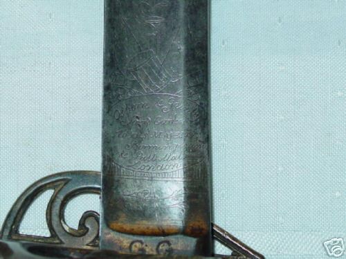

Old 28th May 2018, 02:58 AM   #6
Bryce
Bryce's Avatar
Join Date: Aug 2017
Location: North Queensland, Australia
Posts: 202

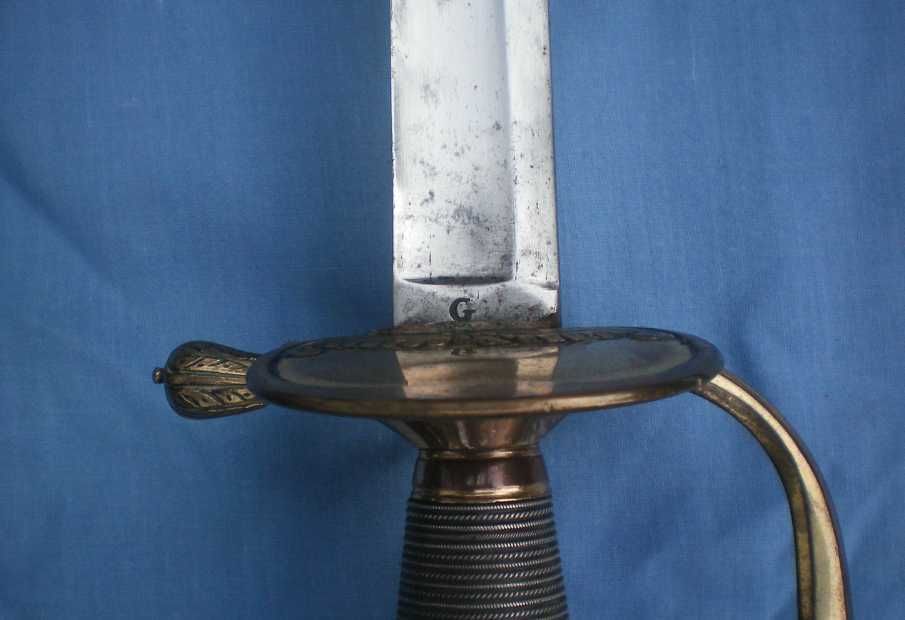

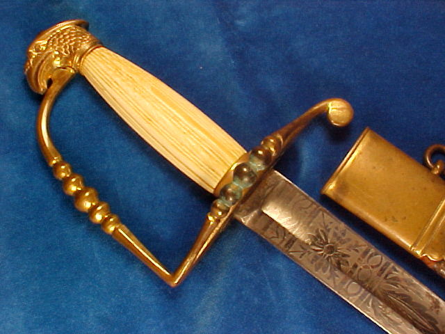

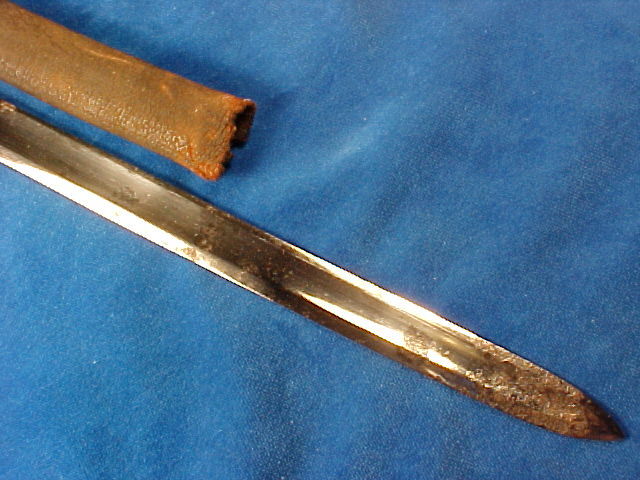

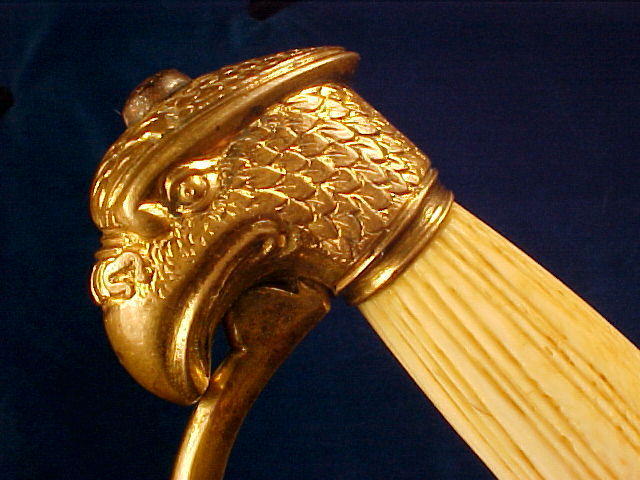

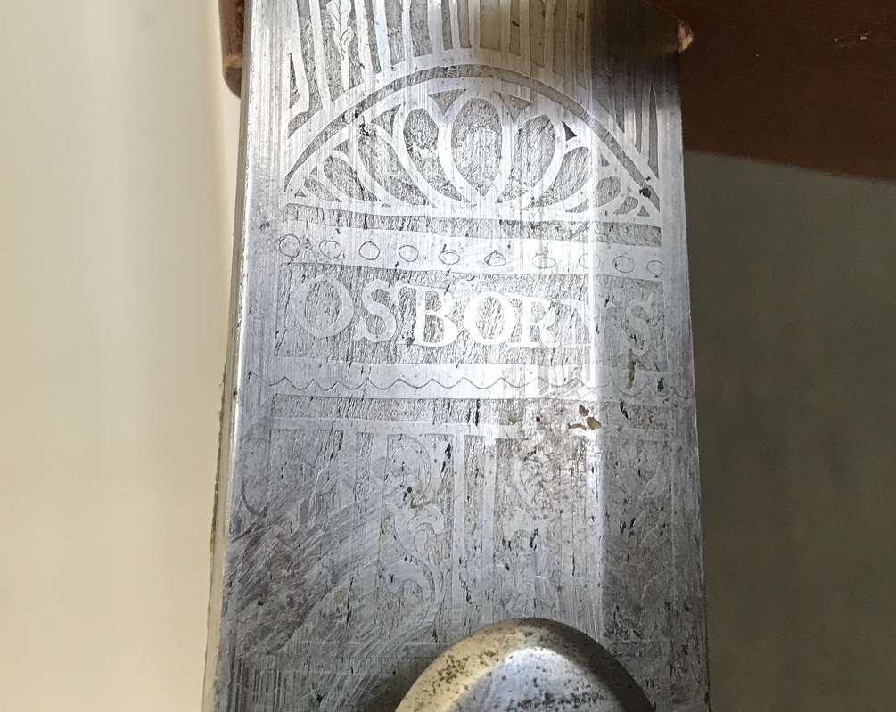

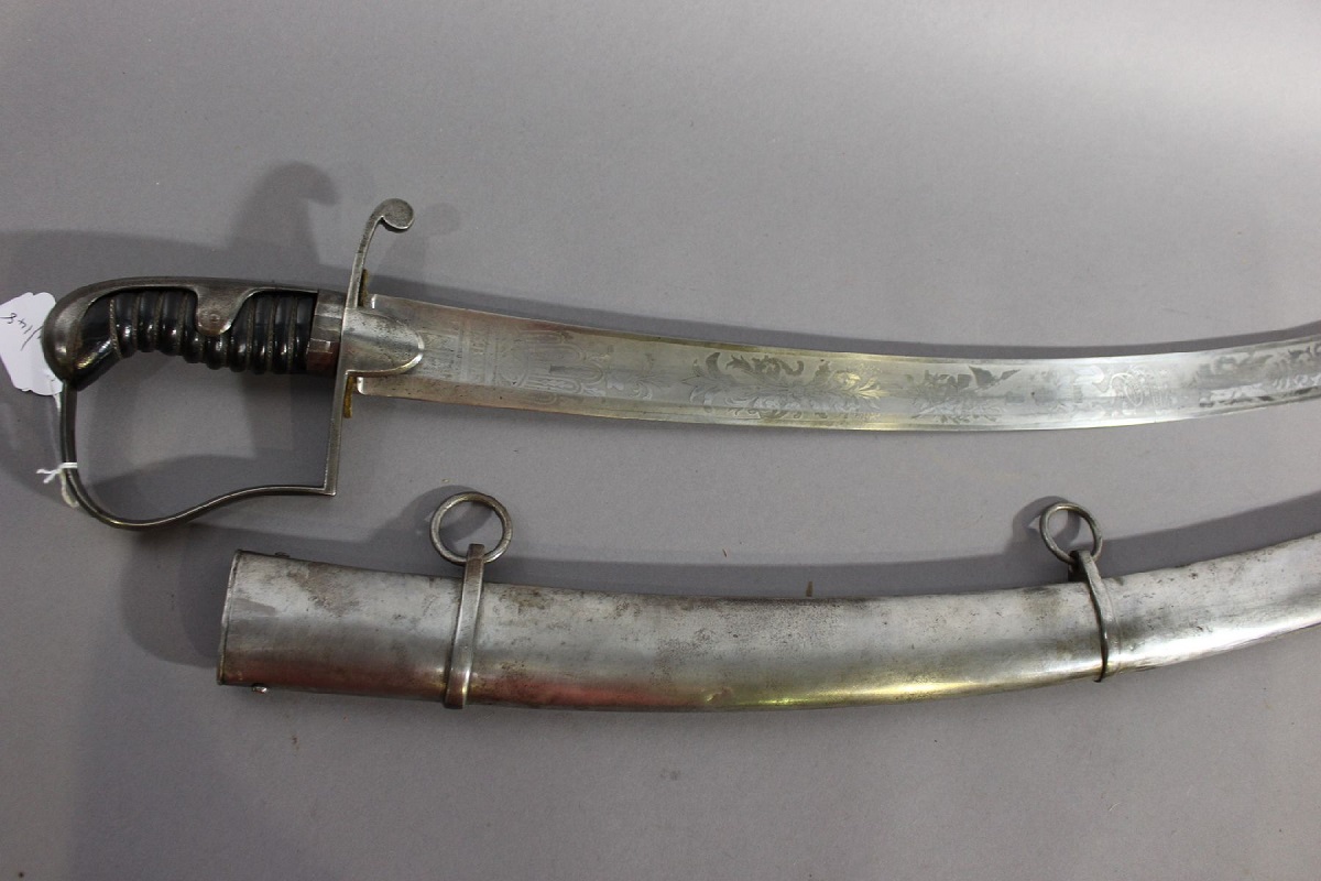

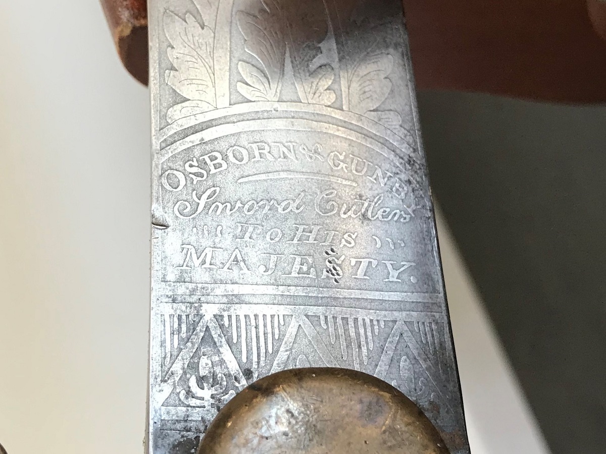

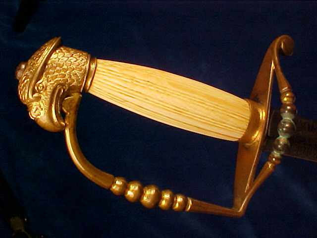

GC you may be interested in this G stamped Osborn that I own. These are the dealers pics as I have never gotten round to photographing it myself.
Cheers,
Bryce
