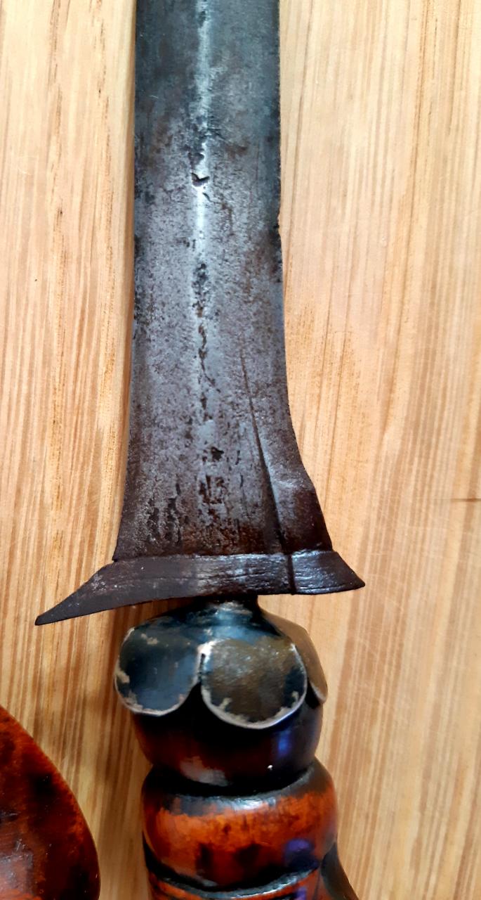

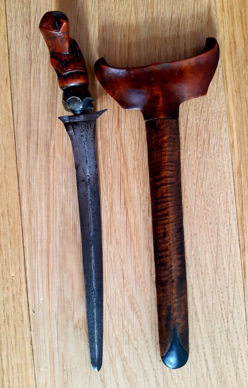

Please could you advise me on this keris? 18cm long blade length including ganja. The scabbard reminds me of the Tajong keris type. There is no pamor on this blade. Any age estimate? This is one of the first keris that came my way and I am quite attached to it.

Interesting and unusual small keris, my best guess about its origin is Jambi or South Sumatra (Bengkulu), and my age estimate about 100 years old. Is the blade fitting neatly into the scabbard? Other opinions are welcome

Yes the scabbard is a perfect fit and appears original to the keris.

These small and simple blades do pop up once in a while. Often they are from modern monosteel while a few sport laminated blades; the gonjo of yours is definitely laminated.
I'd like to see more close-ups: A top view of the scabbard and all sides of the hilt might help.

I think the blade is laminated and not mono steel. I will try and take more pics but as I say the scabbard is a perfect fit in all respects.

The scabbard definitely seems to be from Sumatra as that inserted toe of horn is a common feature. Lovely wood on the stem which i assume displays chatoyancy.
I see no reason to assume the blade is modern monosteel. It seems to have some legitimate age as well.
While it's difficult to place the origins of blades like this, that are obviously made far outside the standards of any court, it seems somewhat safe to place it in the same area as sheath if indeed it appears the sheath was constructed specifically for it. So South Sumatra is at least a good starting point.

This scabbard tip is also found on the Malay Peninsula. The crosspiece does seem to have Sumatran vibes though.

I think it is much more common on Sumatran keris (not that it never shows up on a Peninsula sheath.
But i am glad that we both agree this is far more likely a Sumatran keris.
I do think that you will have a hard time pinpointing the exact location of origin with a village made keris like this. Even the sheath crosspiece is not exactly an established recognized form, but village work as well. Could be from any number of places.

I do own my fair share of 'villager keris' though I am not sure what this term means and if it is to be contrasted with more sophisticated ' city keris'. But in this case its worth pointing out that the ganja appears to be a different composition than the blade. The scabbard is also very well made of very good timber with a buntet. The hulu too is well carved and of good wood. It seems to me to be fairly decent overall with attention to detail in its manufacture. I am not therefore clear in which area it lacks refinement.

I cannot say what others might mean when they say something is "village work", but for me it is a keris that is made outside the purview of the keraton and do not necessarily adhere to the stricter pakem or, if outside Javanese influence, the court standards that are expected for keris created for a higher social level. This does not mean that a village keris cannot be well made, or even sophisticated. Village keris exist an all levels of quality of execution. It also doesn't mean that village keris are not worthy of collection. I dare say that MOST of the keris in our collections are certainly not made by an empu, but that does not mean they are necessarily made without skill. And even keris that are made with lesser levels of skill or refinement can have character and presence that draws us to them. Your keris does not seem very refined to eye, but it does seem to have "character".
