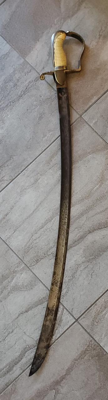

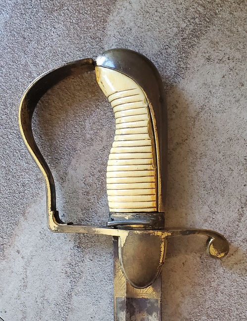

This saber of M1796 light cavalry form seems British of course, but it seems unusual in having been gilt bronze, ivory grip, and a strange fixture on the guard which seems to be to hold a sword knot.
When I see hilts of this character in this period I think of naval officers, knowing that often they favored cavalry sabers, though there is no evidence of the fouled anchor anywhere.
What do you guys think?

...the (quote) "strange fixture on the guard, which seems to be to hold a sword knot" .
he did, but it's not obvious. It's a 'staple'-like fitting on the bolster in the grip photo.

This is an officers saber of the stirrup hilt M1796 style and appears British, though the squared sword knot fixture on the guard apparently for sword knot seems unusual.
It seems to have been gilt bronze hilt with ivory grip which always seems to suggest naval to me, though there are no fouled anchors apparent anywhere.
This does not automatically exclude naval use, and naval officers often seem to have followed cavalry patterns in fighting swords.
I have attached a similar example from "Naval Swords & Dirks", Sim Comfort, 2008.
I would very much appreciate comments, especially on this curious fixture for sword knot which is different than anything I have seen. The gilt is mostly gone, as is the bluing and gilt motif on the blade.

A nice, high-grade, standard Georgian British officer's sabre is about all that can be said of it. Some general rules of thumb can be followed, such as the gilt hilt is more likely to be infantry/naval than cavalry, and curved sabres are more likely to have been carried by the 'Flank officers'.
But ultimately, with the prevalence of all the militia, volunteer and yeomanry units at the time, plus, with the habit of officers to 'do their own thing', without a solid province or identifying engravings, it is impossible to know what branch of service the original owner came from.
The lanyard 'ring' on the furrel is a common variant seen on 1796 Pattern light cavalry officers' sabres, with other another type being an integral part of the guard, extending out next to the langet.

It would be nice to see more of the blade markings from Jim's sabre, but from what I can see, they look similar to the ones supplied by J J Runkel. If true, this would date it to pre-1808.

1796p swords with brass hilts are commonly described as yeomanry officers swords. The sword knot loop is not uncommon. I would not go so far as to say it's naval though could have been used by that branch on an individual basis.
I think the ivory = navy notion is just another of those misconceptions created by early collectors and then spread by less-than-scrupulous dealers looking to cash in on a "navy premium".

I still have it, but not handy to examine presently, these photos are it for now. It did not have a scabbard. When I can I will get to it unless there are more photos.
I am hoping with this thread we might see 'cavalry' sabers of the M1796 form with ivory hilts. Clearly ivory was used on the mameluke sabers but cannot recall any of these stirrup hilts with it. Also, that curious sword knot fixture on other examples......that example on your Osborn is most telling.

Default white hilted saber
here are three photos of an almost identical sword to Jim's in my collection. The sword knot ring is at the pommel. Well marked with George III cipher and coat of arms on the blade (which is German -by J.J. Runkel of Solingen). I assumed that it was an Officer's private purchase modeled on the 1796 cavalry saber, though the blade is not as heavy.

Posts: 303
That’s a lovely sword. How long is the blade? Do you have an image of the whole sword?
Having a small lanyard ring like that is an interesting choice. I have to wonder how well such an arrangement would stand up the the rigours of mounted combat. Of course there are practical alternatives that can be used while still retaining the ring.
The at of arms is the pre-1801 type, so while not exactly a precise measure it does help identify this as an early sabre. My observation has been that sabere blades supplied by Runkel tend to be on the larger size for dismounted or purely dress use.

Very nice!! Note that in the coat of arms, the three fluer de lis in upper right quadrant are present.....this theoretically changed in 1801, so presumably this is pre that 1801 date. However it is quite possible that technicality was not readily observed, and that blades on hand with cutlers and outfiitters might have been used later.

In 1801, when George III renounced his title as King of France under the Treaty of Paris, the French Fleur de Lis quartering was removed,and replaced with the Scottish Lion.

Default late 18th Century British Sabers
As requested, here are photos of the whole sword. the blade is 32.5" and the overall length is 37.5" This sword has a milder curve than a similar lion headed saber it sits next to on my shelf (blade 30", overall 35.25"). I added photos in case you are interested in seeing both. The second sword is blued with gold for half the length of the blade, and has a very fancy brass guard.

Thank you for the additional photos, at 32.5 inches thats the standard length for the 1796 Pattern LC. So your’s is most certainly a cavalry officers, most likely from the Yeomanry, given the guilding.
Your other sword is the 1803 Pattern ‘Flank Officers’ sword. The flank companies were the Grenadiers and the Light Company that marched on the flank of the regiment. These were seen as the regiments’ elites with the Grenadiers often at the front and in the thick of battle while the Light Company ranged out, scouting ahead and skirmishing with the enemy before full engagement by the regiment. From 1800 the officers of these companies were given permission to carry sabres (a habit they had already acquired) in place of the 1796 Pattern infantry officers sword. Drawing on the ones that were popular in 1803 an official pattern was declared with a lions head pommel and GR cypher for the guard.
Lots of variation exists in the grips, with leather and shagrin being most common, but ivory and wire grips are also found. Because the hilt is the pattern, there is a lot of variation in the length and shape of the blade in these.
Of course, over time others chose to carry these swords, so it is not impossible that your’s belonged to a high ranking general officer, rather than a ‘Flank officer’.
