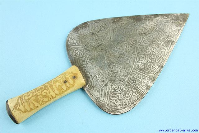

The script covered example I have here is I believe an 'alem' and while it seems to correspond to the wide leaf blade type ', I think it was likely used as a battle standard. This is suggested by Artzi in the blue backed illustration of one of similar wide blade form (apparently remounted with ivory handle).

I am wondering on my example, which seems to have a bit different shape but is indeed quite large, may be intended as a 'standard'...in the manner of the example shown with the ivory handle. The 'decorative' script overall seems, like thuluth, to be based on repetitive wording or phrases, but arranged in accord with the shape of the blade.

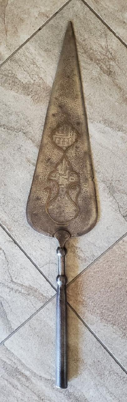

I have that chaps spear. Also its the one that killed Gordon don't you know.

Apparently, every afternoon, certainly "frequently", the Khalifa held a big parade-like affair on a big field in Omdurman to whip up the faithful. Likely, your spear blade could have been used as a standard along with the flags, troops and drummers to keep the festivities going. It's a little small for battle, even for small units where the flags and mounted amirs provided directions. Yet religious figures could have hoisted it instead of a sword. Of course all of this is just a guess.

Not sure about being too small for battle. The blade alone is 30 inches long and the spine starts at 1/2 inch thick.

My opinion is based thusly. If Jim's floor tiles are 12 X 12, the blade length is of that scale. The blade is riveted to the shaft, not very strong. Plus, the shaft is around a foot long, certainly too short and out of balance with the blade for two handed close combat. Better battle options were available.
