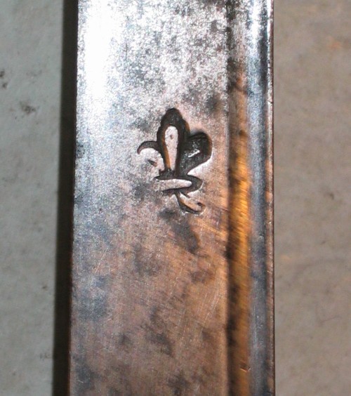

Hi Jim, I hesitate to post this as it is perhaps not as early as you are looking for.
It is a pre 1804 cutlass with a FDL on each side of the blade and a broad arrow mark and a stylised H on the guard. Hollier?
Regards, CC

WOW! yeah, THAT is exactly what I hoped to find, and perfect that it is on a double disc cutlass is outstanding. This is I believe evidence that a good number of blades were coming into England and possibly Scotland from France.
There were Solingen makers in the Alsace area (before Klingenthal) and I think St.Etienne and Tulle were making blades (not sure of details) but it has been suggested the fluer de lis may have been a 'state' mark from the arsenal in Paris.
In Nuemann, the numbers of French hangers with blades of this type with FDL on blades is compelling. In Campbell's book on the swords from Culloden, it is noted the FDL is often found on British blades of these times.
Thank you so much CC!!

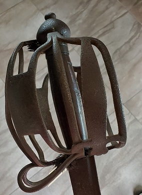

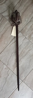

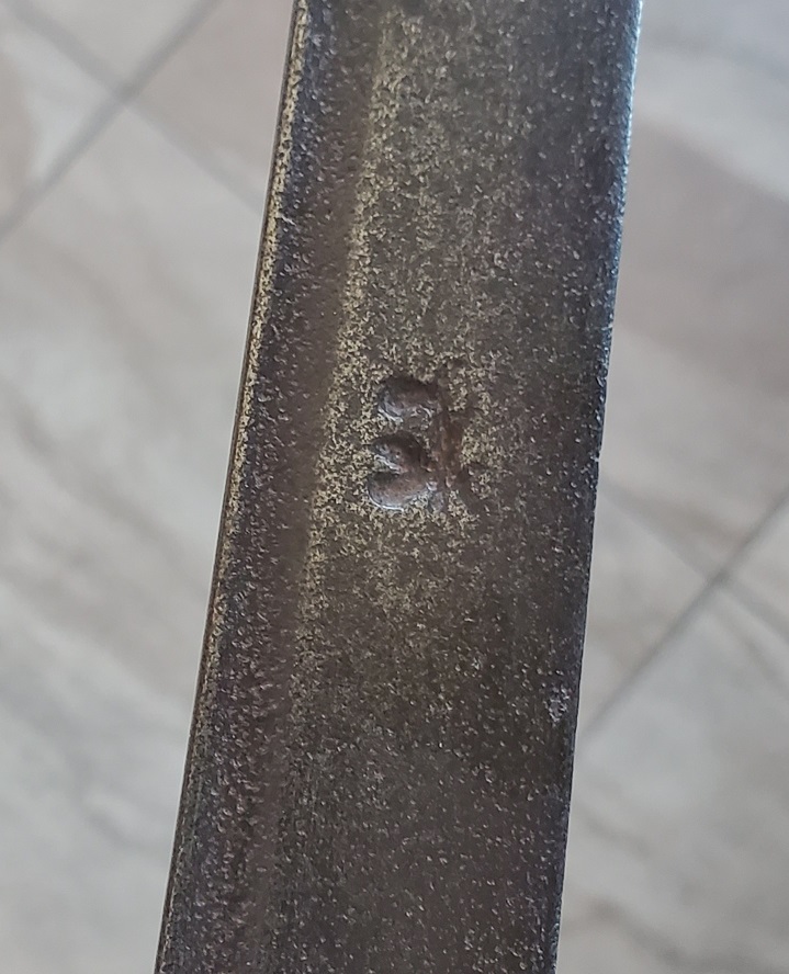

Here is a 'tubular grip' cutlass which as with yours prevailed from the period Hollier seems to have created the DD hilt (late 1720s) through the 18thc
By the type of blade this may be 1740s-50s but unmarked.
The basket hilt, though the guard attached 'in the Scottish manner' is clearly for British army forces and of 'dragoon' form, though the blade is relatively short for a horseman. Note the FDL on the blade, suggesting in the same 1740s period as the cutlass.
