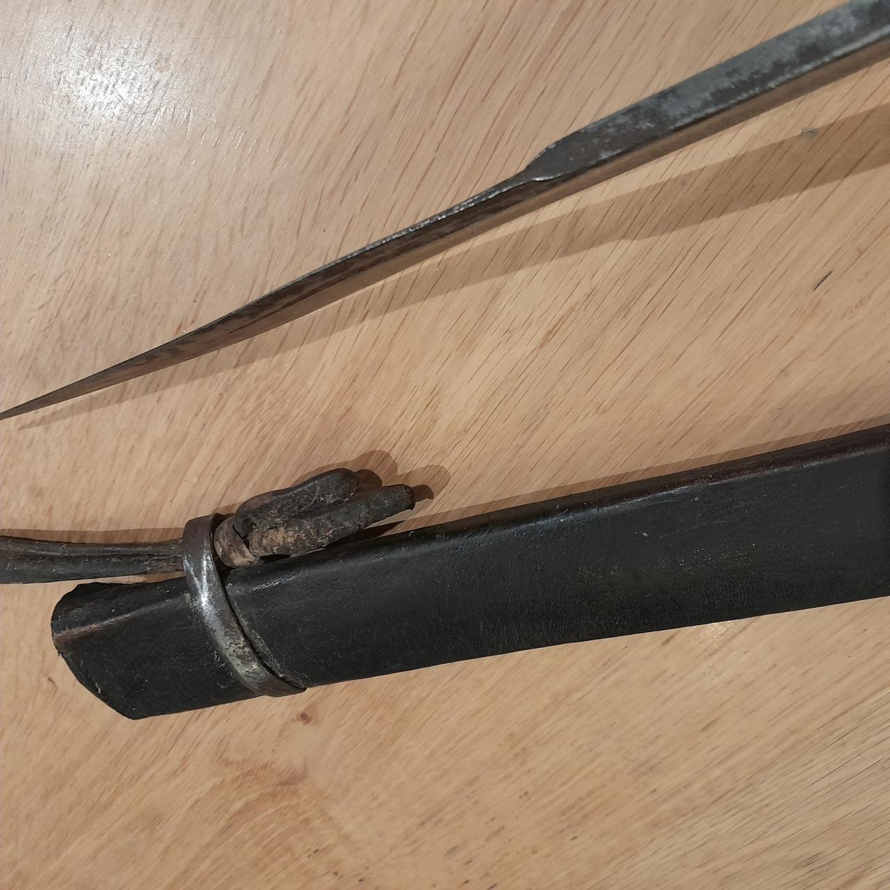

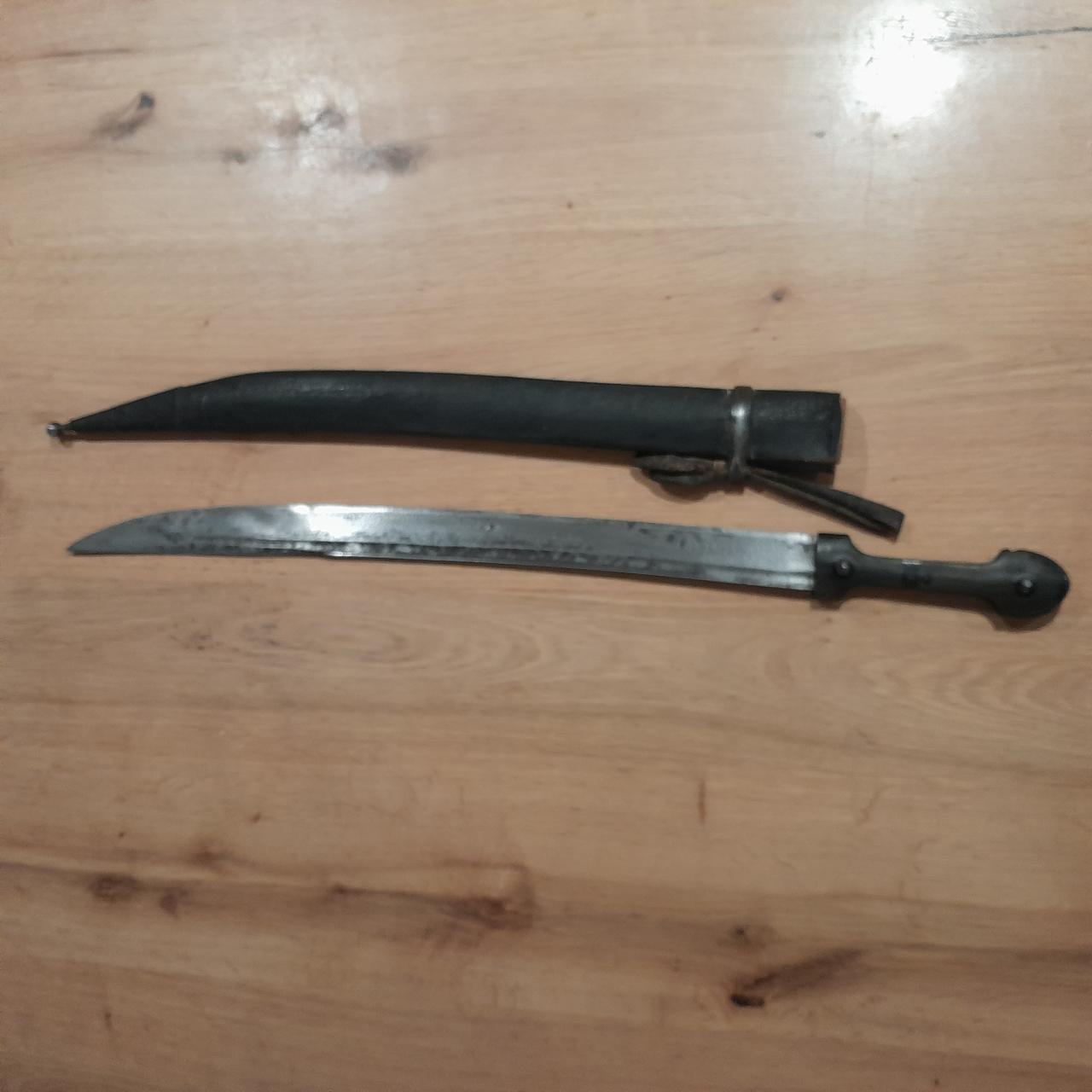

Here is an interesting long beibut dagger I found that I would like to show you:

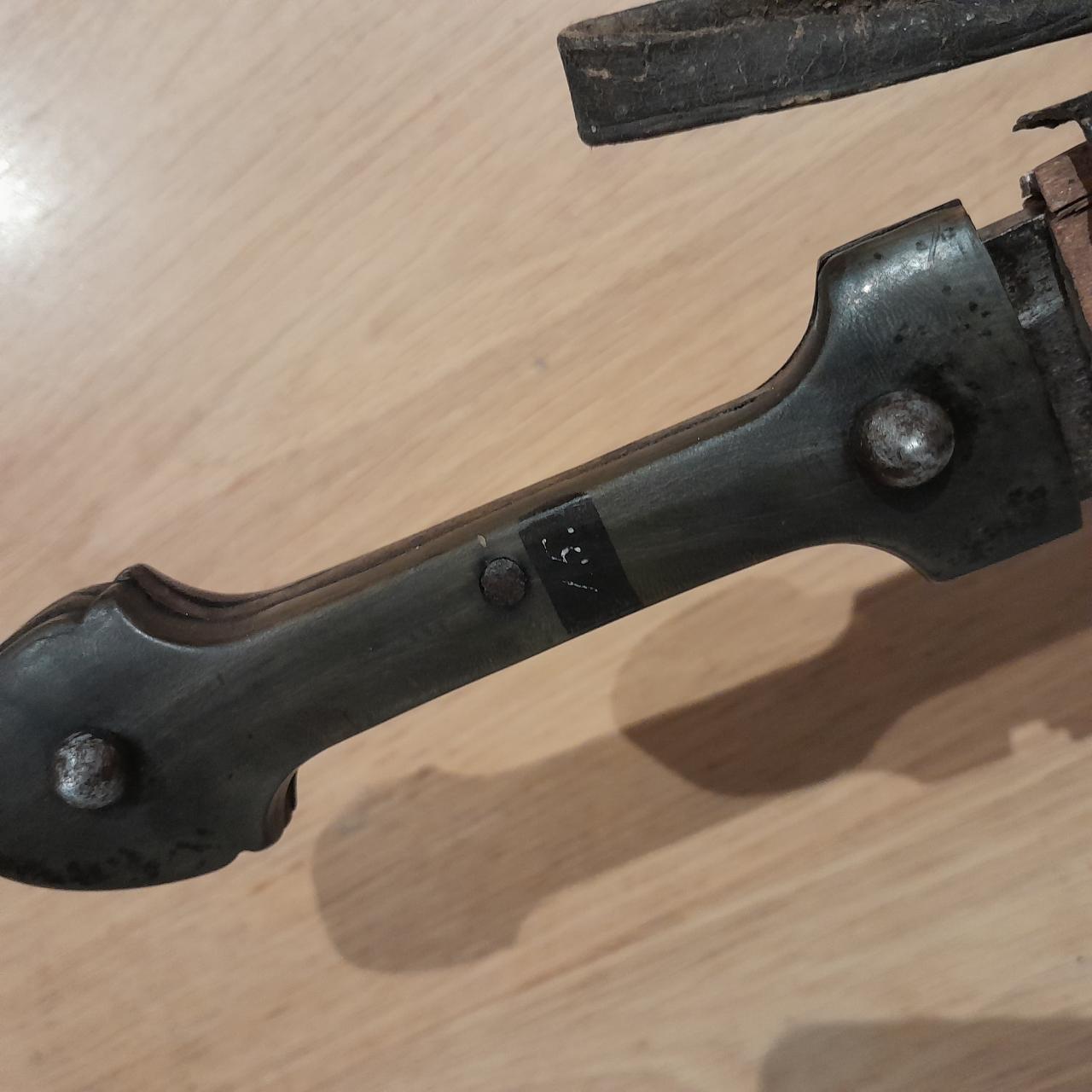

large military type model but with horn handle and a ''15'' written on it.
A mix between europeans and east european-asian influences
Under the scabbard, an interesting blade, I hadn't seen it before I got it, a nice surprise !

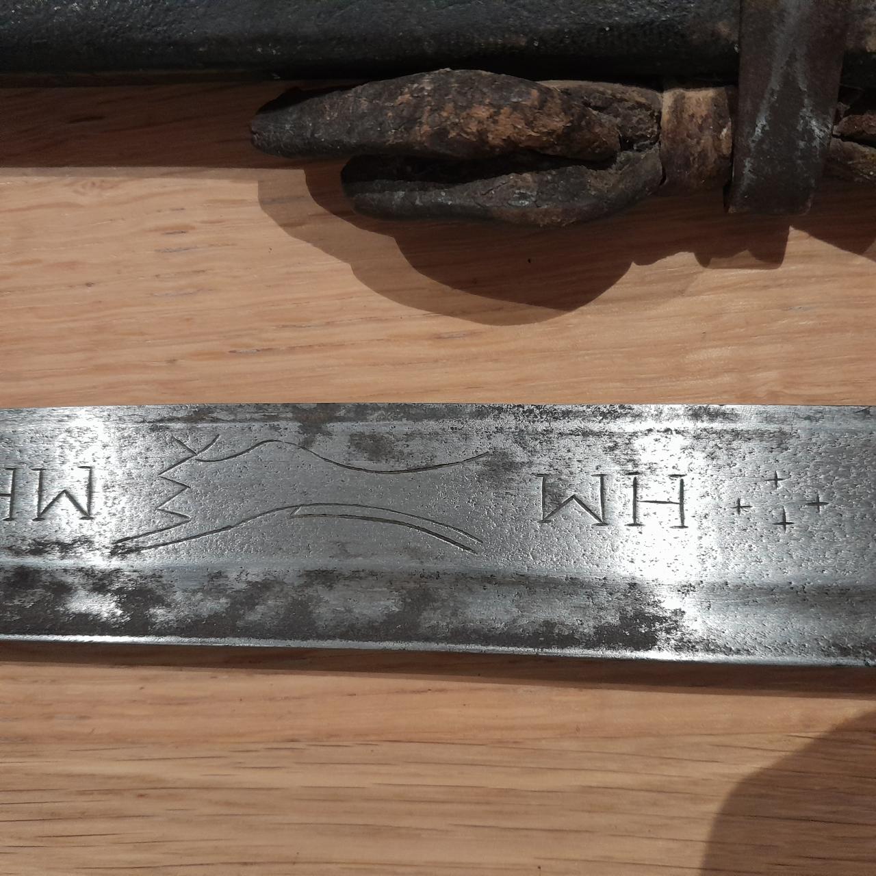

It is very rusty but with an unusual very large yelman and a Passau wolf and the initials H and M and small crosses on both sides.
a very old blade ?

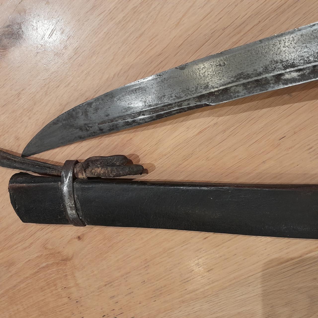

the tip- bouterolle also with the leather that goes over the leather sheath seems to me unusual with ''classics'' kindjal and reminds me 18th-19rh Prussian-Austrian short swords models.
Here some pictures

I forgot the size: 65cm long 70 with scabbard

Most likely explanation would be a cut down shashka blade. European markings, including the running wolf were widely copied in the Caucasus.

If it's the case, the black-smith has reshaped all metal hilt part fo perfectlyr suit the grip shape,

How about a broken blade not a cut down one? Is there evidence of a scarf weld where the blade joins the hilt? I have read that some Caucasian cultures carried a second shorter blade as a backup often repurposed from a broken blade.

It seems to be the ''regular'' tip of the blade/shortened sword with the large yelman but it wasn't welded to a separate metal hilt.
A single piece of metal
Old 30th November 2023, 06:00 PM   #7
francantolin
Posts: 969
Perhaps these two pictures are better...

I would say it is not original pasau wolf, from time, wolf would be in 180• turn to the text, probably later. Or some other country made and marked with famozs mark.
