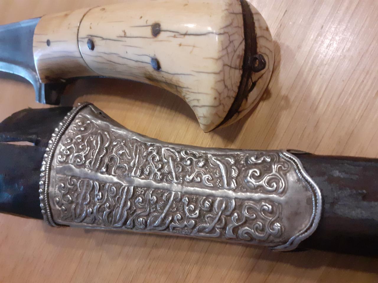

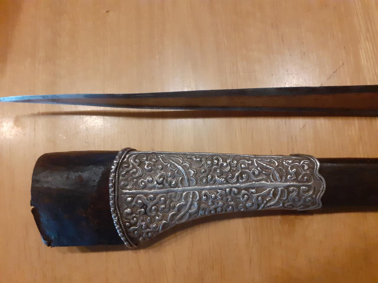

Hello dear members,
today I come with a massive karud dagger
I just acquired.
Afghan or north indian origin,
The hilt is made of bone or walrus ivory.
The silver scabbard mounts looks unusual to me:
Makes me think of Tibetan-bhutanese daggers or kappala . Or chinese origin.
So maybe all was made in eastern Afghanistan area close to China ?
Or in northern India ?
Or a later add for the scabard ??

Hello francolin
Congratulations on a good purchase.
Very interesting scabbard mounts looks.
It is hard to tell if this karud comes from eastern Afghanistan area close to China or it belonged to a resident of Nepal. We are accustomed to very specific forms of Tibetan daggers. And at the same time, absolutely Indian (in our understanding, daggers and sabers) were actively used by the inhabitants of this region.

IMHO, it is a typical Afghani Pesh Kabz with straight blade, popularly known among collectors as Karud. The chamfered edge is a dead giveaway.
The handle was repaired as witnessed by the inserts.
The 2x1x1 rivets occasionally were seen on Central Asian daggers.
I would not exclude elephant ivory as a handle materiel from these pics, the slabs suggest solid source. It is for you to decide. The bone, IMHO, is less likely because of concentric cracks at the top of the pommel and the absense of superficial short black lines going lengthwise: remnants of periostal blood vessels. Also, it might be interesting to see a pic of the top of the pommel: any long bone has a bone marrow cavity that would present as an " open space" in the middle. Would also measure the thickness of the solid " bony" materiel at the top: it looks very thick and it might be difficult to imagine a long bone with such a thick cortical layer. Walrus is also unlikely: no secondary dentin seen. I would not exclude the possibility of a scabbard belonging to another, smaller, Pesh Kabz with leather ( or fabric?) extension being added to accomodate this bigger sample.
I see nothing that would suggest, and am unaware of any similar dagger in either Nepal or China. Both are far away from Afghanistan.
These are just suggestions: you have it in your hands and can correct each and every of my uncertainties.

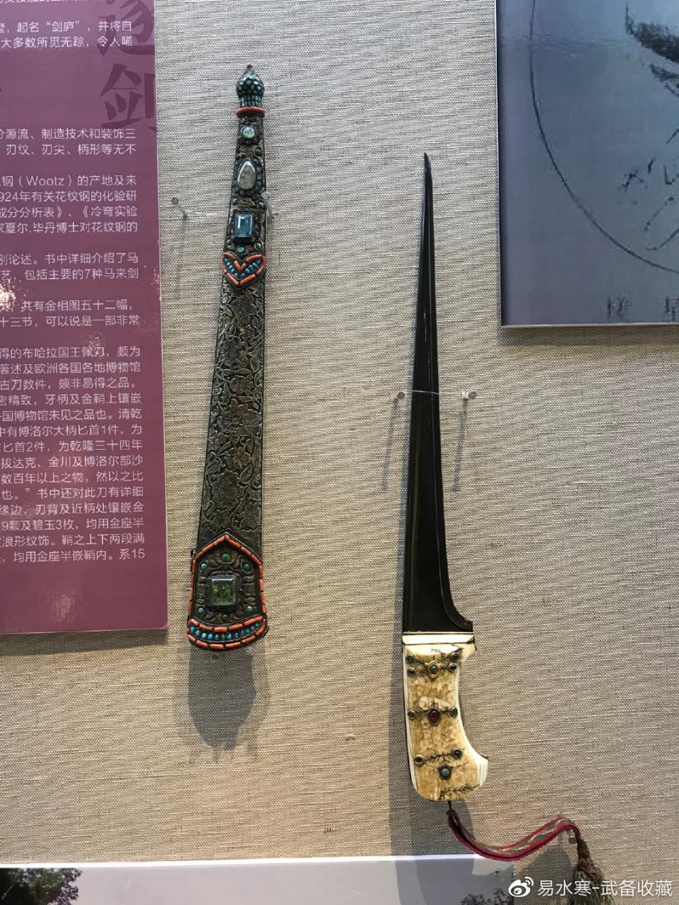

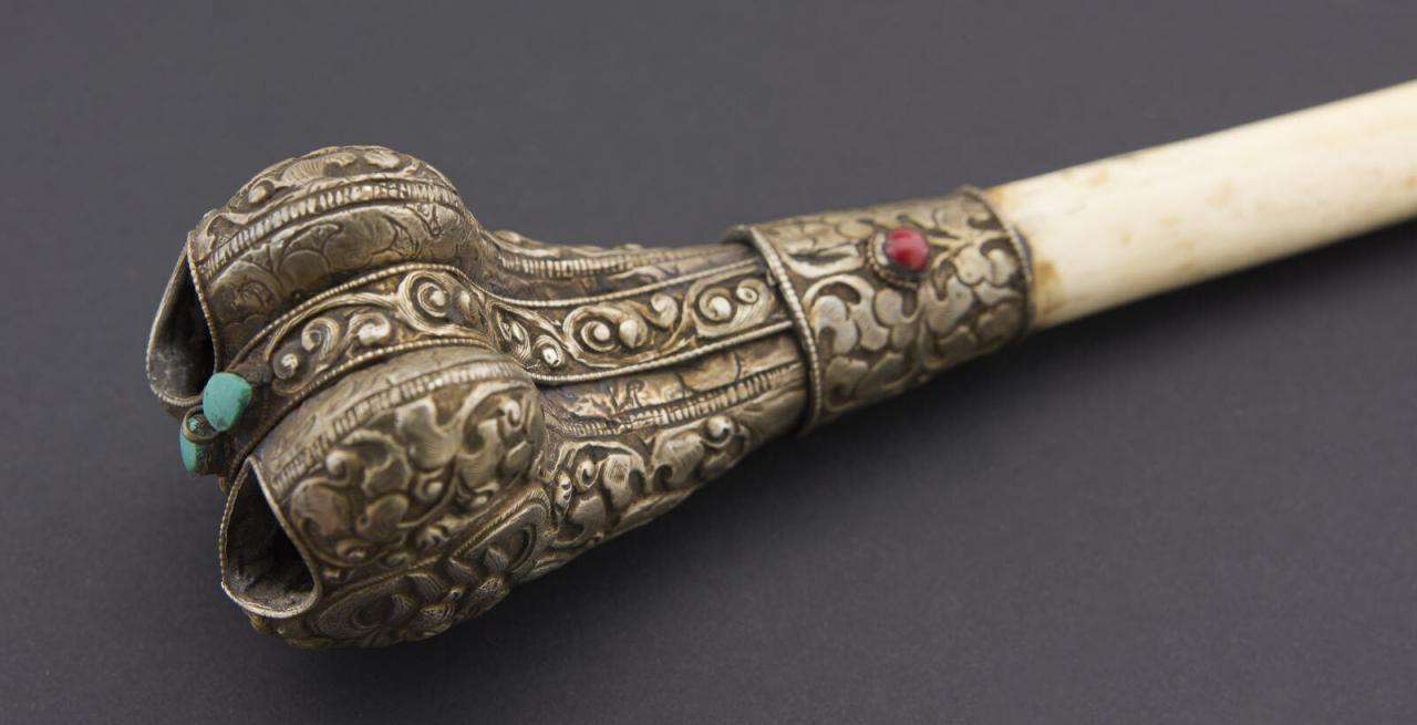

Undoubtedly, this Karud dagger itself is of Afghan-Indian origin. Of main interest are the details of the scabbard.
No, Tajikistan and the Tajiks of Badakhshan certainly have nothing to do with the decoration of the details of the scabbard of your new dagger.
When I talked about the eastern Afghanistan area close to China, I meant a small area of the territory, which I circled in red on the map.
Unfortunately, I do not have photos with the native people of Nepal who have Karud daggers. But the use of talwars and kutars by the Nepalese is absolutely known. Therefore, the possibility that Karuds could also be used in this region cannot be ruled out.
Well, the second image that I am posting is a Karud in an absolutely Tibetan-Nepalese sheath from the collection of the museum Gugong in Pekin.

Exact ! Wakhan nomad people living in the ''wakhan corridor'' area.
Nice and interesting picture of this karud with his coral turquoise silver scabbard in '' tibetan himalayan style''.
I wonder what is written in chinese on the description and if they call this dagger ''karud'' ?.....

Yes, my friend, your eyesight does not fail you
The karuda scabbard from the Gugong Museum is decorated exactly in "tibetan himalayan style". I deliberately placed the image large enough so that can clearly see the features of the decor, including the classic Tibetan use of red corals.
Unfortunately, I do not know what is written in the museum next to the Karud dagger. I think that in China this weapon had its own local name.
I think you understood my idea that although the images of the Nepalese with Karud daggers are not known, but since the native people of the region undoubtedly actively used talwars and kutars, as well as we know are also Karud daggers with scabbard decor typical for Tibet (at least an item from the Gugun Museum and Your dagger), it is likely that there was occasional use of karud daggers by the people of Nepal. After all, "travel" arms is not uncommon. I remember that in some old topic, Ariel gave an example of a Georgian saber, the blade of which was made from the Indian Khanda sword. Georgia is much further from India than Nepal is from India or Afghanistan.

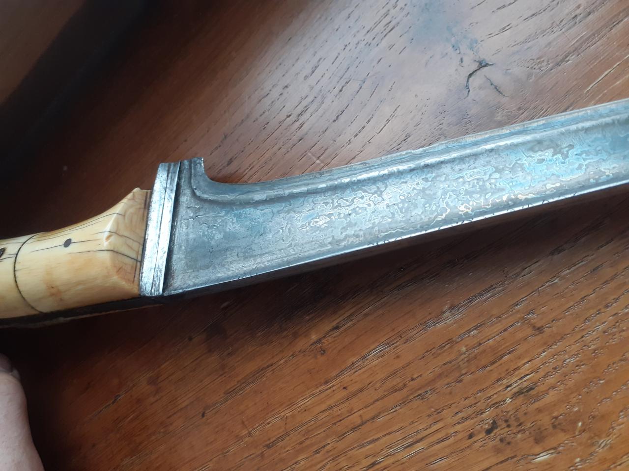

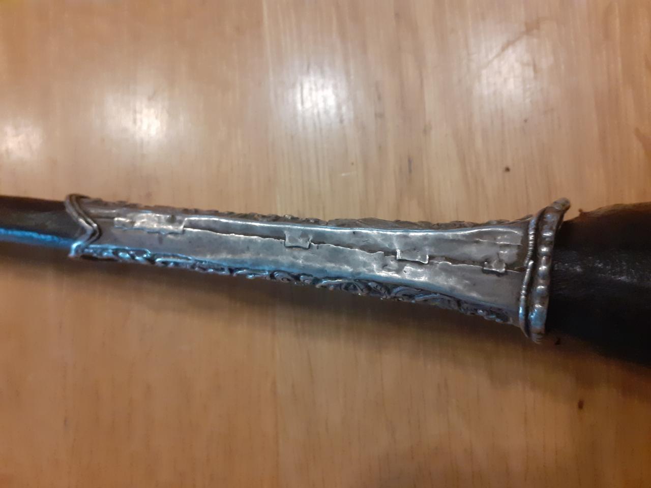

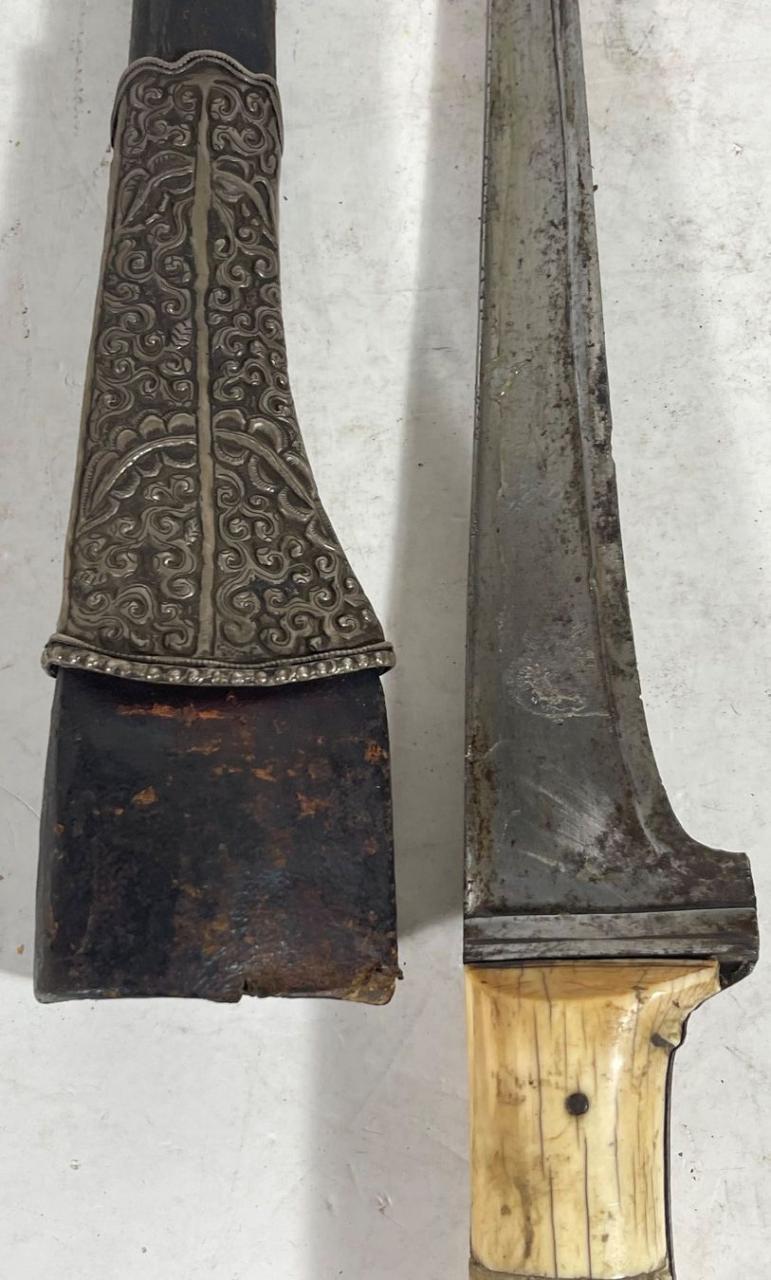

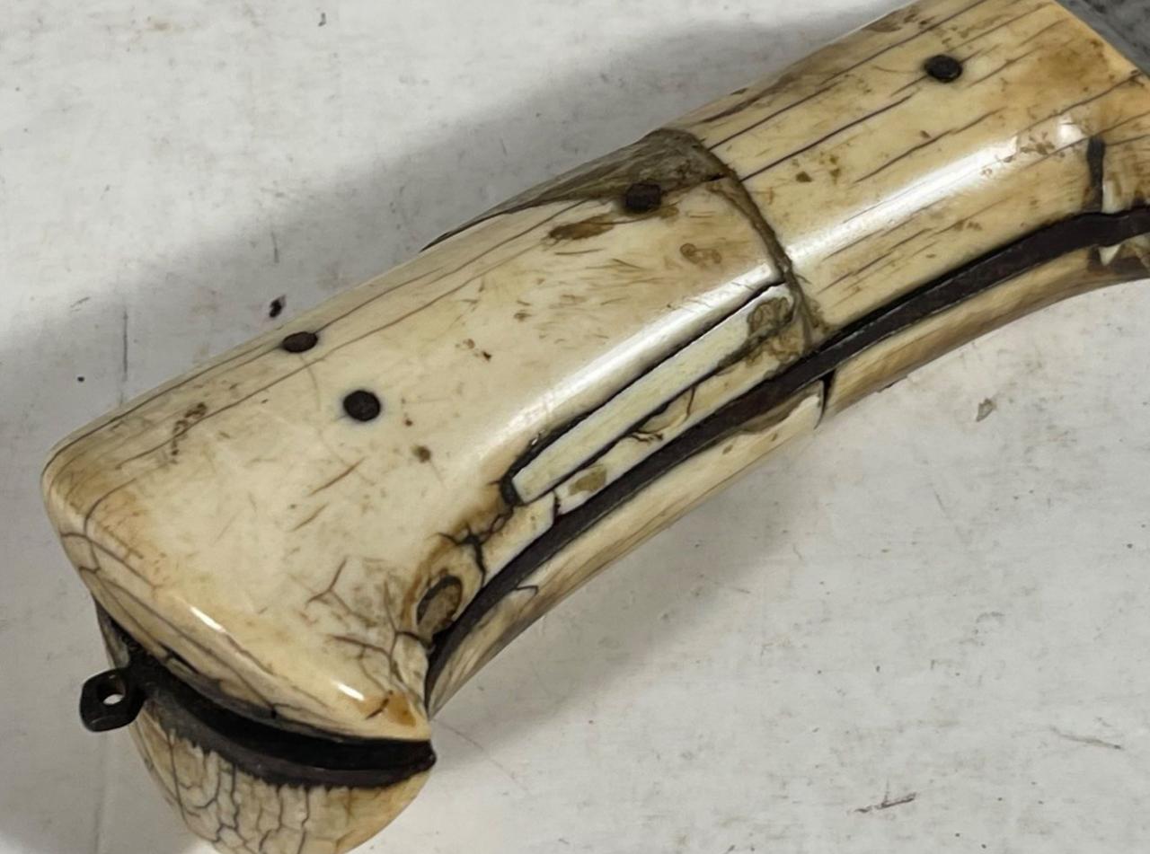

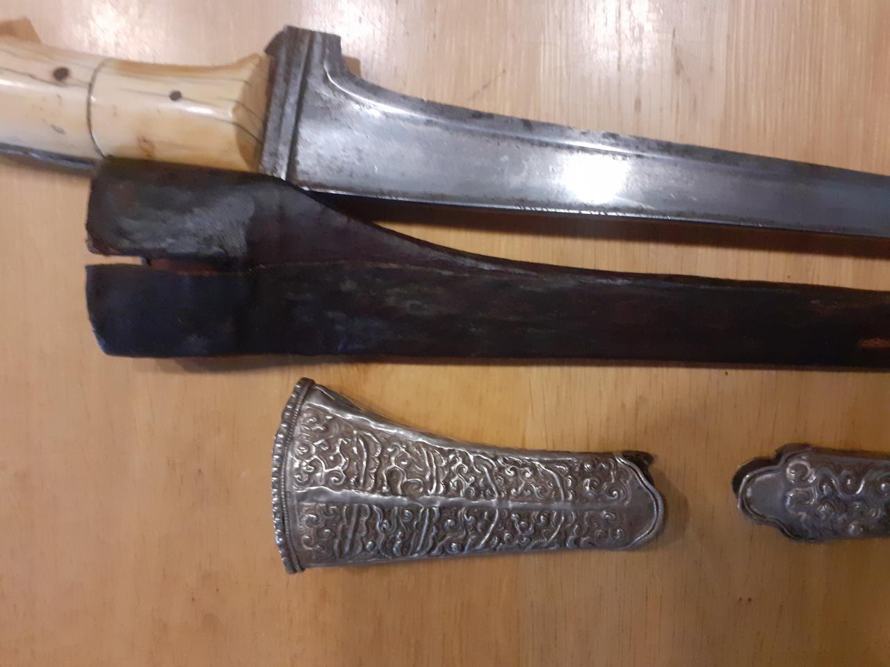

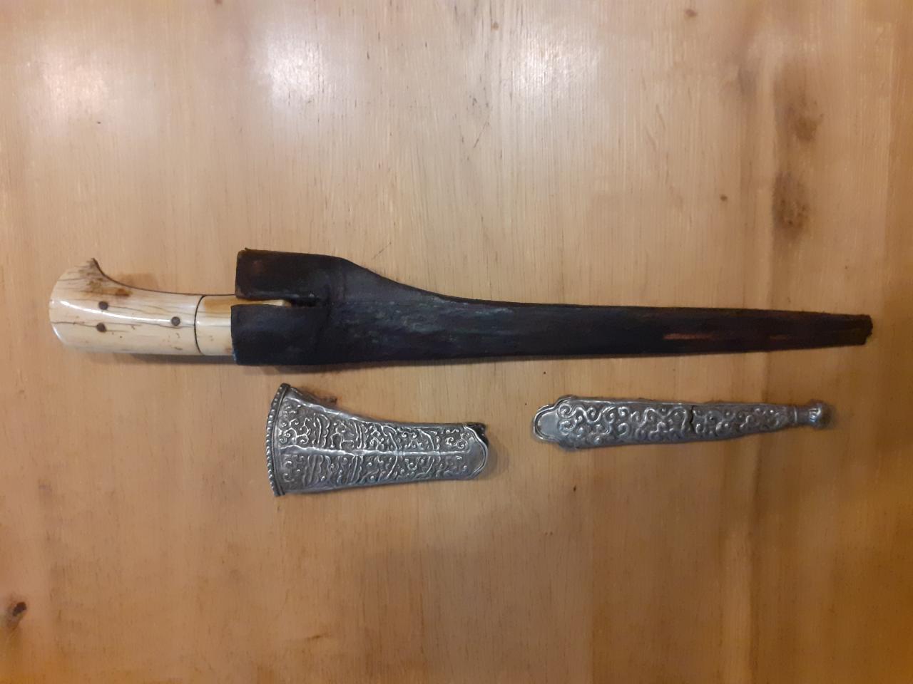

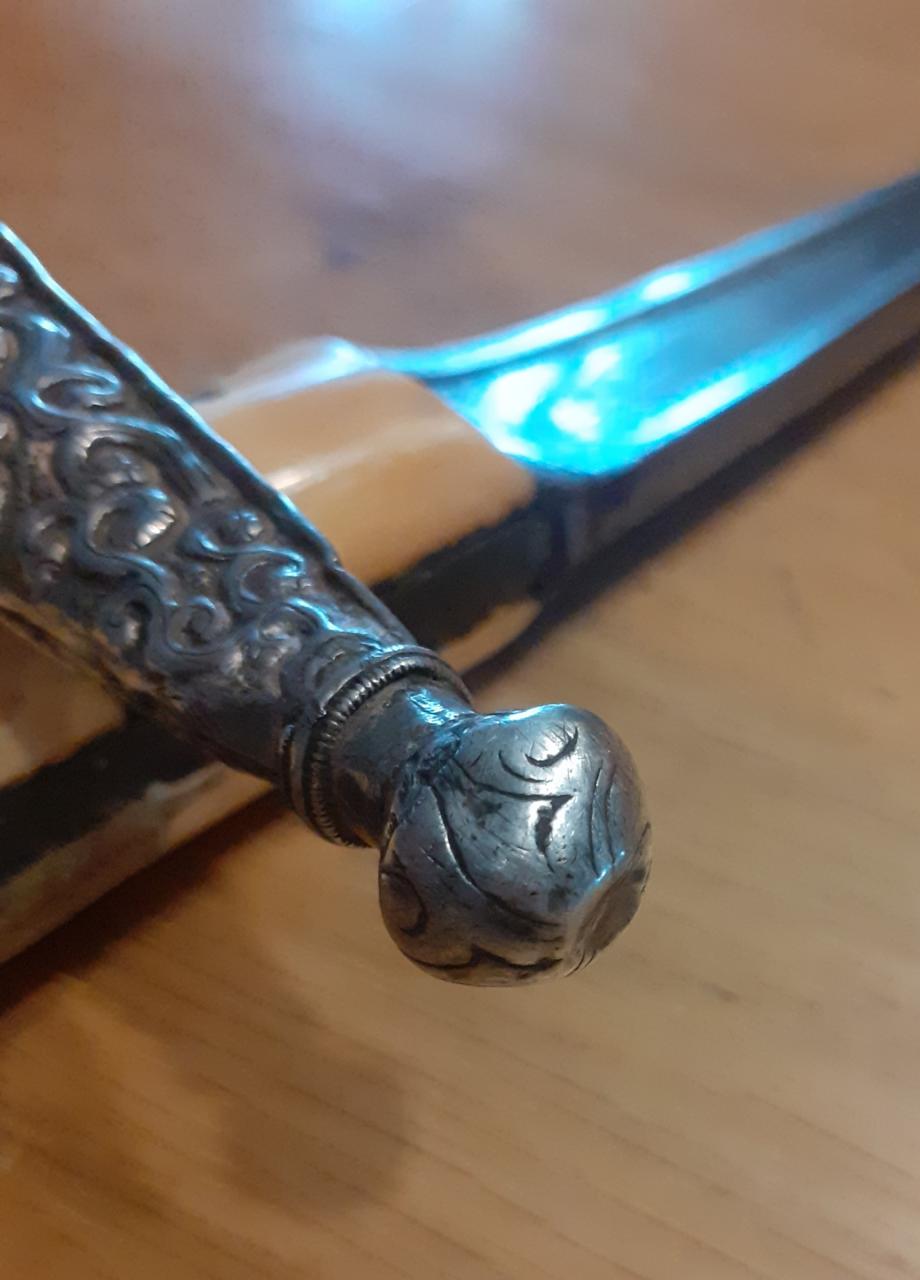

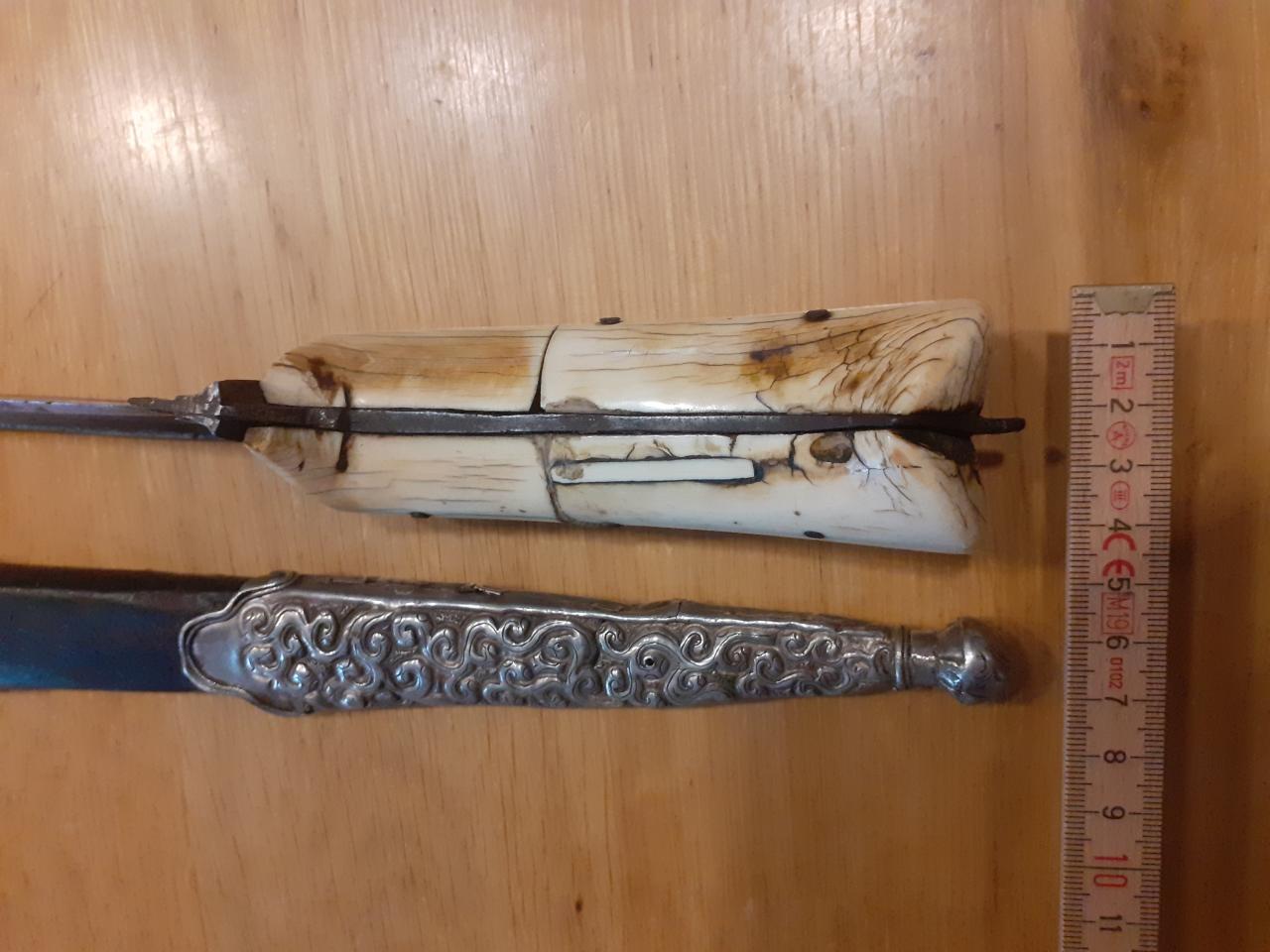

I just receveided my new toy !
The hilt must be ivory ( elefant as Ariel said ) and a repaires piece made of resin...
The scabbard seems made for the blade,
not shortened...
The mounts fits good too .
The foliage work suggests me mongolian ( saw look like embossed silver work with stylised clous...)
or Himalayan origin as we said.
( coincidence ,the karud come home with snow falls today )
I forgot to mention it: dagger length 46cm,
52-53 cm with scabbard

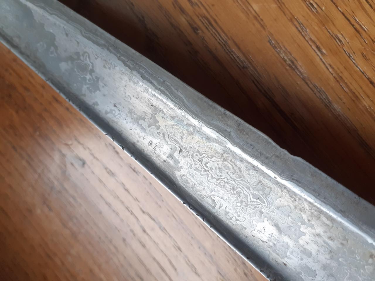

Old 9th December 2022, 12:10 PM   #17
francantolin
Posts: 964

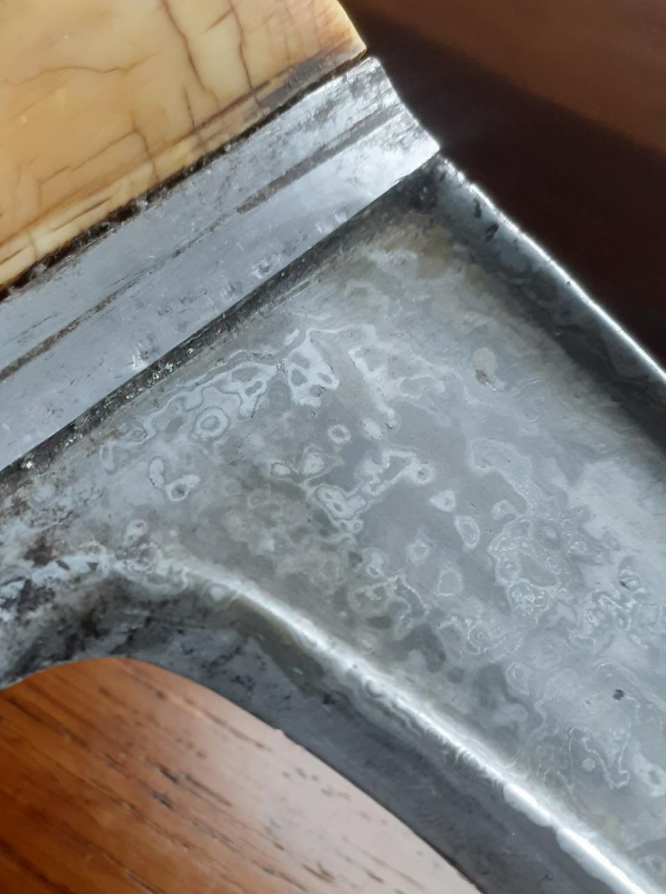

And etched blade!
Couldn't resist

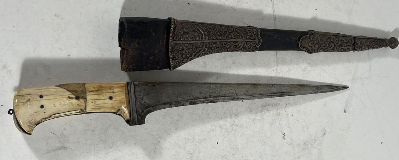

Really interesting find !
This one, not the same but a nepalese ivory dagger
from the MET, with a ''pesh-kabz... shape''
contrary to the usual nepalese knives or kukhris.
Really old , Dated 1650-1700...
BBking is offline   Reply With Quote
Old 10th December 2022, 08:43 PM   #19
The blades are different.

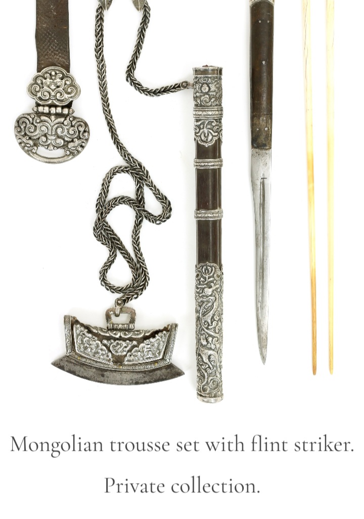

Thank you for the picture of the nepalese '' pesh-kabz'' and link ( an amazing Garuda carved on the hilt ! )
For me the silver work on mounts is sino-tibetan
So I come back to the wakhan- eastern Afghanistan origin...
Two pictures: a tibetan kangling and a mongolian trousse set.
I don't think the scabbard was made in Tibet or in far
Mongolia but they illustrate the clear chinese, sino-influence.

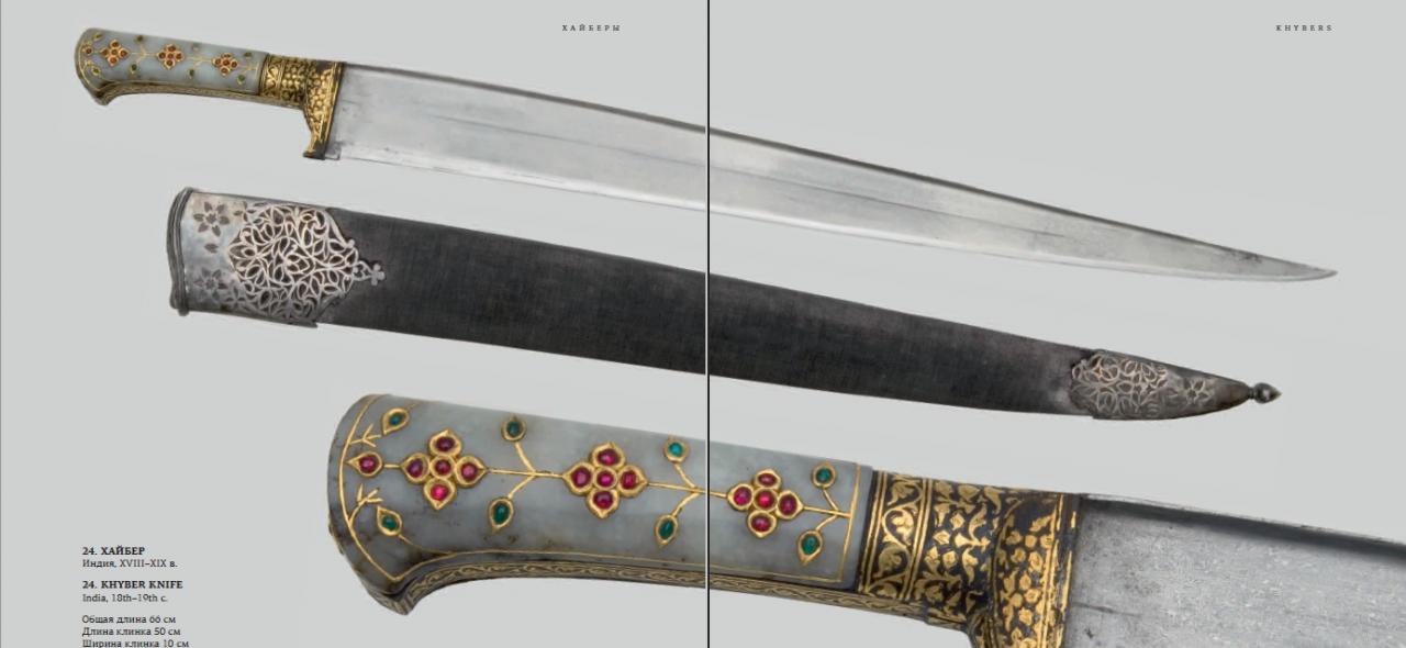

Here's another example. The Khyber knife is undoubtedly an Afghan arms. But I think that any of the forum participants, looking at the Khyber in this photo, will say that this is an Indian arms:

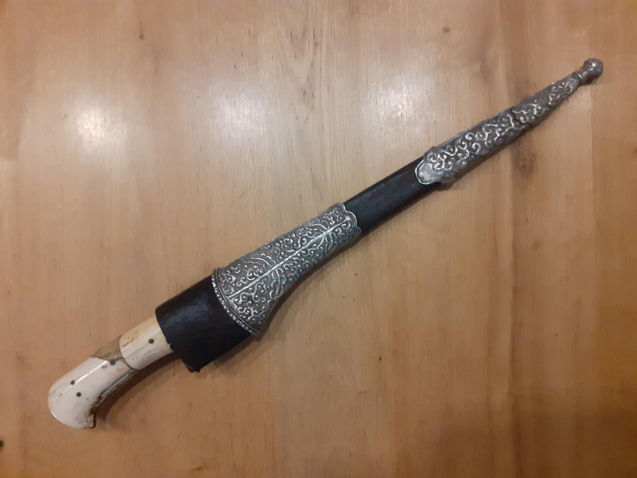

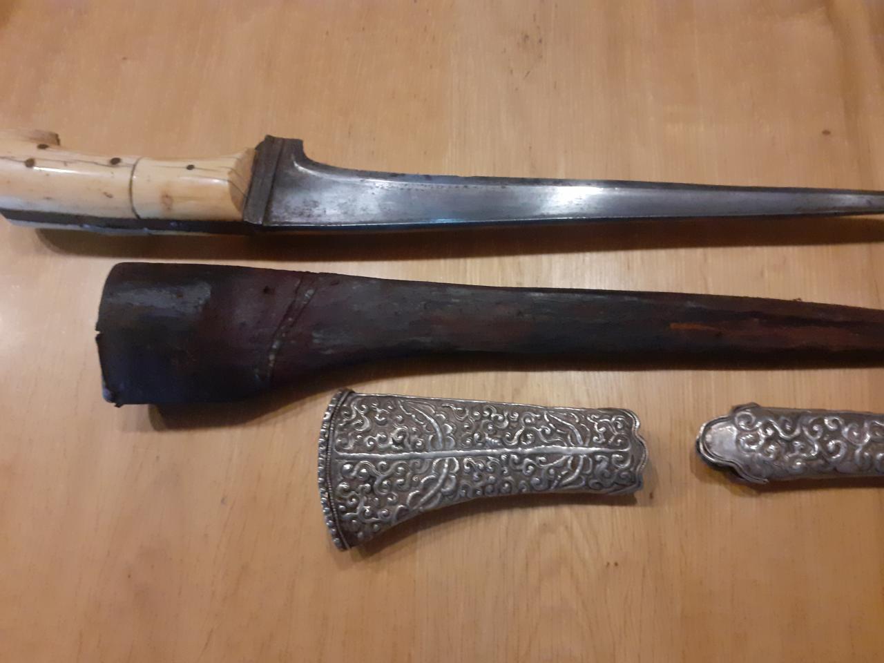

Lastly, we look at the decorations. Here we see very “ Buddhist” repousse motives of the scabbard parts. This tells us that they came from a different tradition. Whether this ” karud” found itself geographically somewhere else or the scabbard was decorated by a “ buddhist” master in CA is unknowable. In any case this “karud” never became an established pattern of a “Buddhist” weapon tradition but remained firmly as a CA weapon.
Thus, our final description may sound something like “CA pesh kabz with straight blade and a scabbard redecorated with “Buddhist” repousse motives”.
This is the best we can do with strange objects.
Old 12th December 2022, 04:14 PM   #27
mariusgmioc
mariusgmioc's Avatar
Location: Austria
Posts: 1,918
Or "CA karud with a scabbard redecorated with “Buddhist” repousse motives”.
