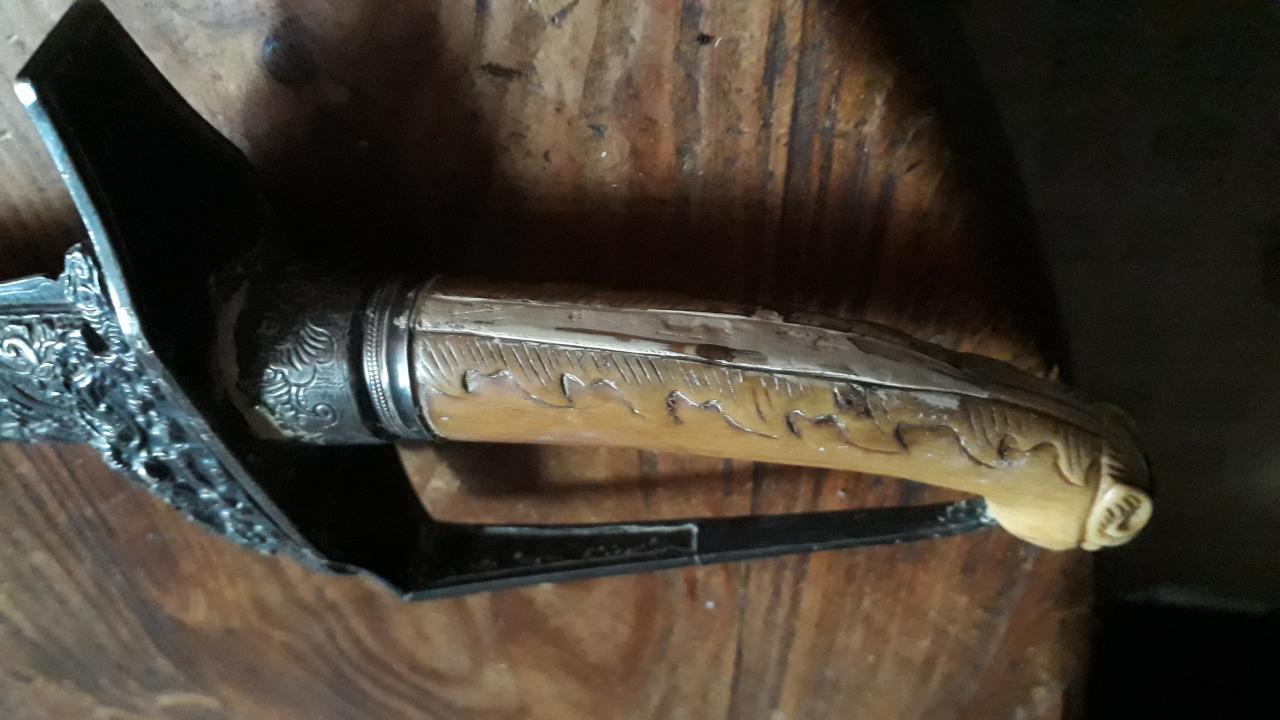

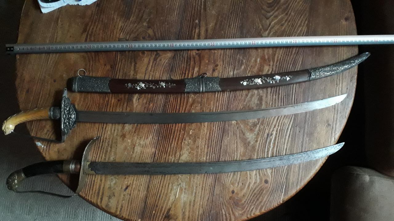

I picked up a slightly unusual guom officer's saber last month (or at least, that's what I think it is).

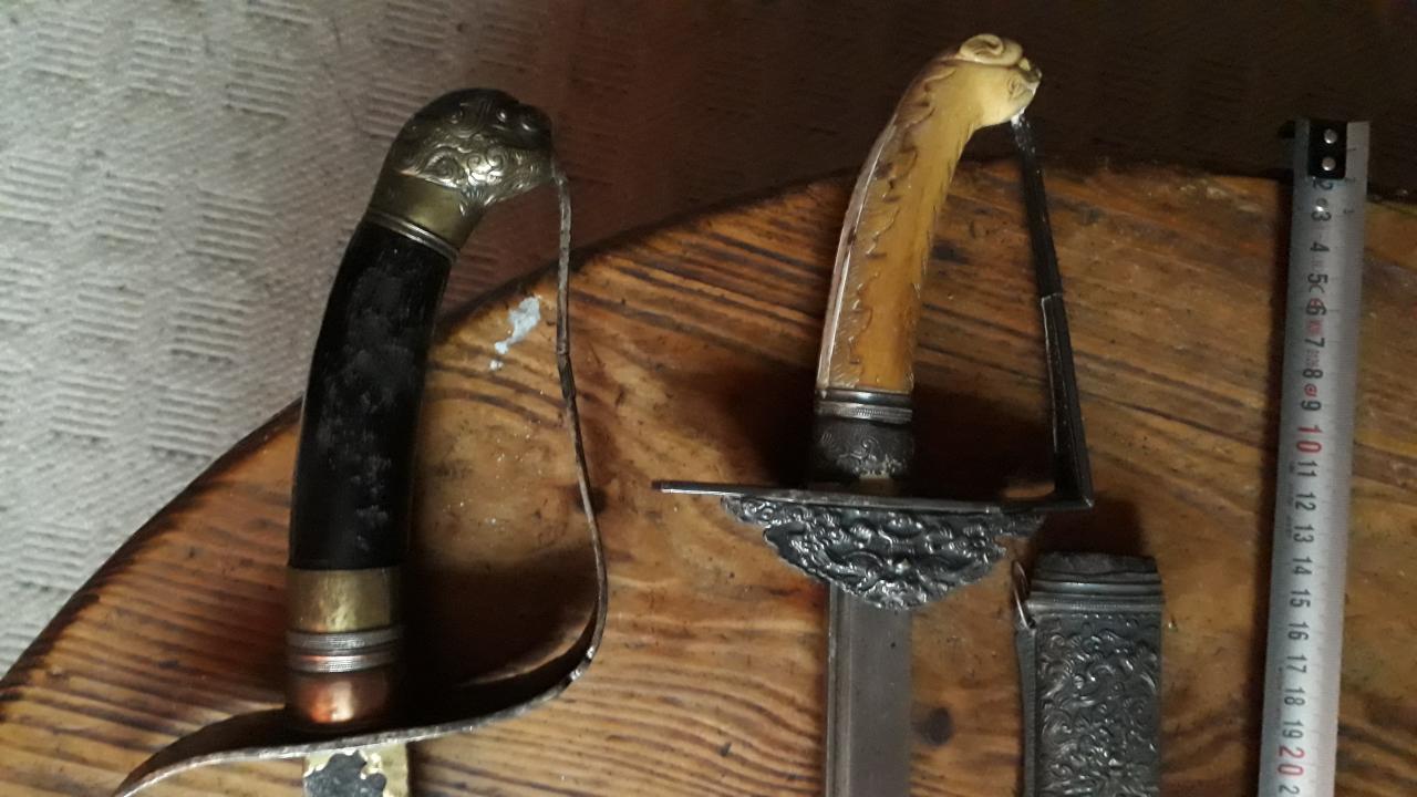

I've had one without a scabbard for a while, shown for comparison (with the dark horn grip).

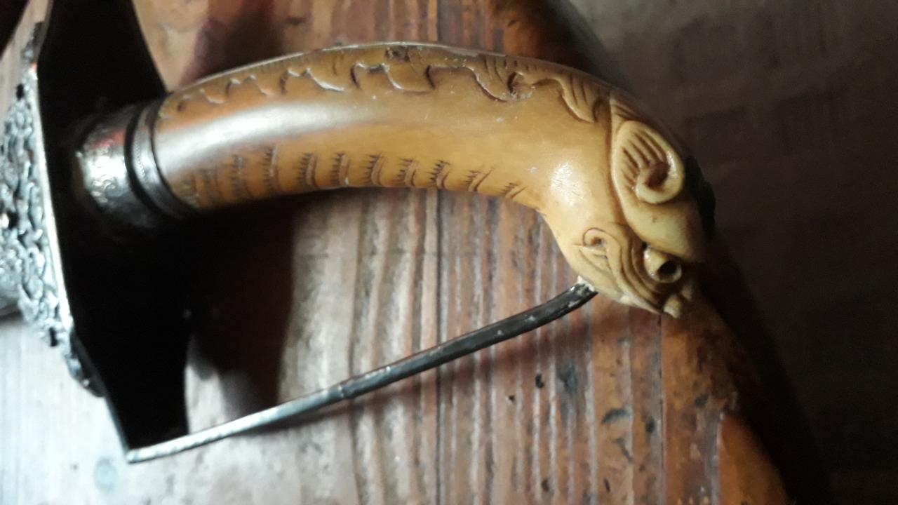

The "new" one has a (what looks to me like) ivory grip, with an admittedly somewhat ugly old repair (it looks like it was once split and then glued back on rather crudely; the whole guard could use some cleaning). I suspect the lion(?) head pommel may once have had inlays in the eyes. It looks a little bit stoned with that smirk.
The blade of the new one has considerable girth near the guard but it tapers quickly and the blade is otherwise quite thin and light. It has some geometric patterns of decoration. It looks like it's laminated, though it's hard to tell from the pictures since my phone's camera is not great.
The one I already had does not have much distal taper, and it has a fuller running down the spine and is somewhat shorter and even lighter than the new acquisition. The new one lacks such a fuller. Both have solid connections between the grip and the blade, but loose guards. Both are rather sharp.

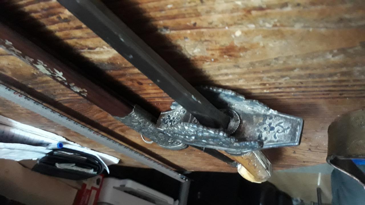

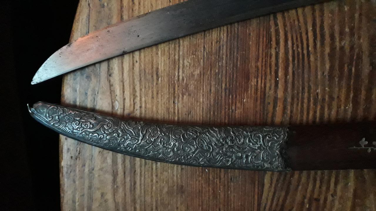

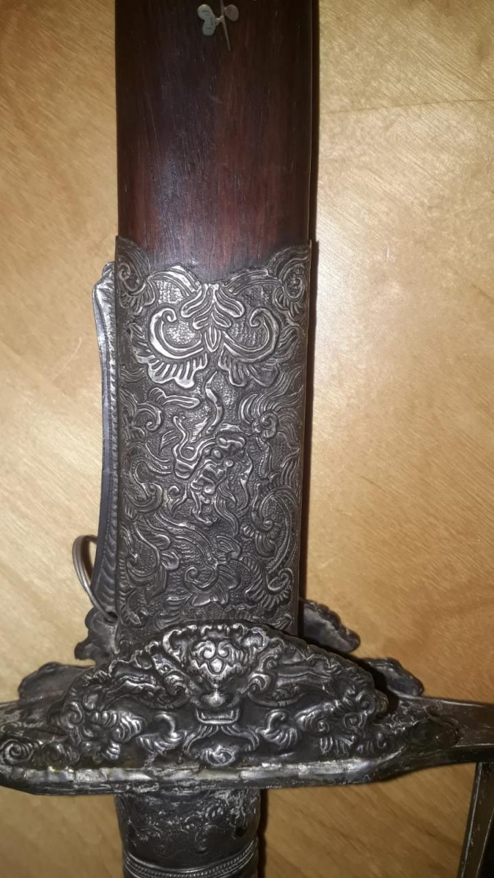

The scabbard is decorated with mother of pearl inlays and silver fittings with both scrolling patterns (strikes me as waves or clouds or maybe floral) and a somewhat hidden dragon meandering through. Demon faces on the "plates" that are attached to the guard (not sure what these are called; they also show some signs of an old repair). The chape has a few dents and may be missing it's very tip. One of the rings is a modern replacement.
I hadn't seen one with these kind of decorative plates on the guard before except in one unclear museum photograph that had a subscript calling it an "Ayuddhaya sabre" somewhere on this forum in a thread that I can no longer seem to find (so I've attached it). Are these a common feature?
Your thoughts would be appreciated.
Also if anyone can recommend a good overview book for continental South East Asian swords I'd appreciate it, as I don't have much reading material on swords from this part of the world yet.

Congratulations on an unusual and complete specimen with good quality silverwork and scabbard inlay. As you say, the forward-projecting plates on the guard are a distinctive feature; this is the first example of a guom that I've seen that has these. I can't vouch for the Ayutthaya attribution in the museum catalog, without corroborating info it sounds a bit outlandish to me. There were military confrontations between Siam and Vietnam in the early 19th cent., there are Thai silver-mounted dhas in the historical museum in Saigon which were capture pieces modified by the addition of Vietnamese silver-inlaid disc guards; I'm sure that the one in the possession of the Thai prince's estate might have been a trophy from one of those encounters as well.

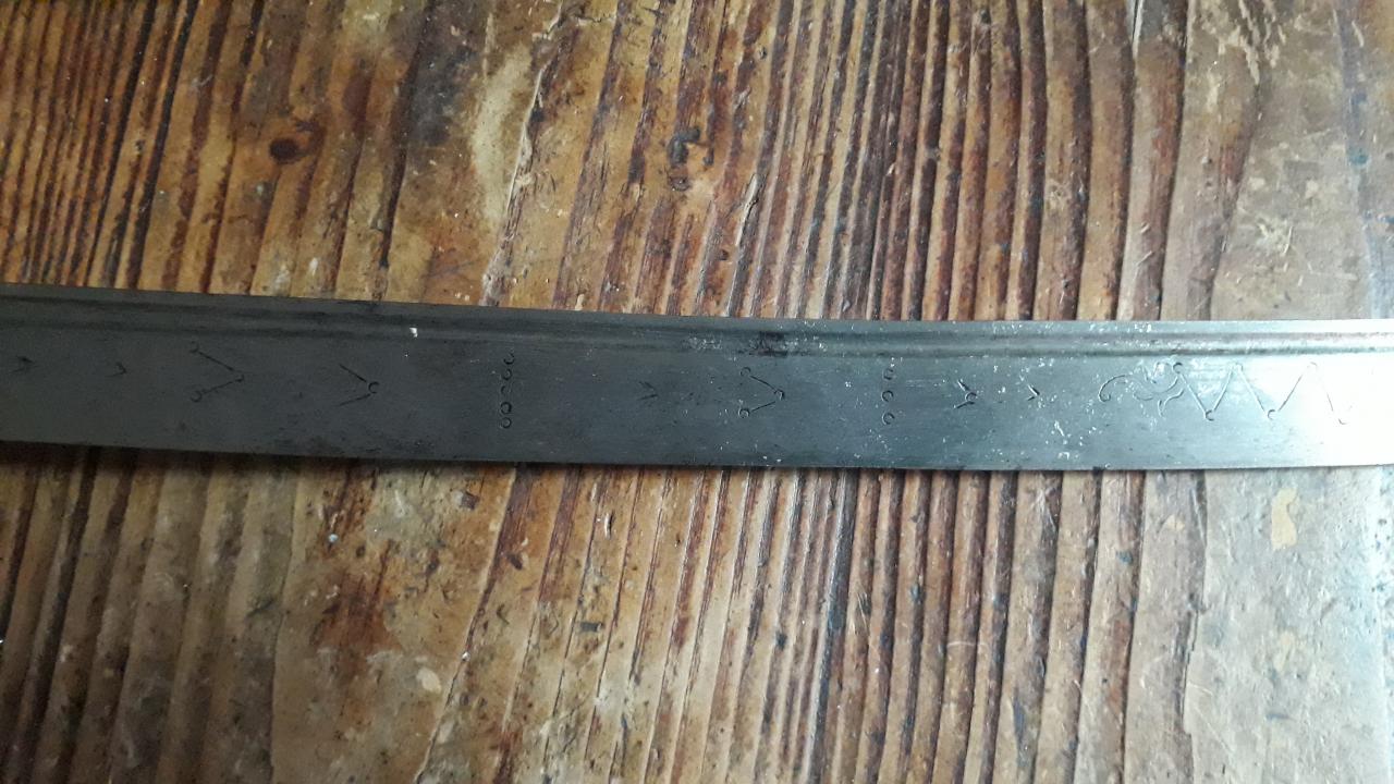

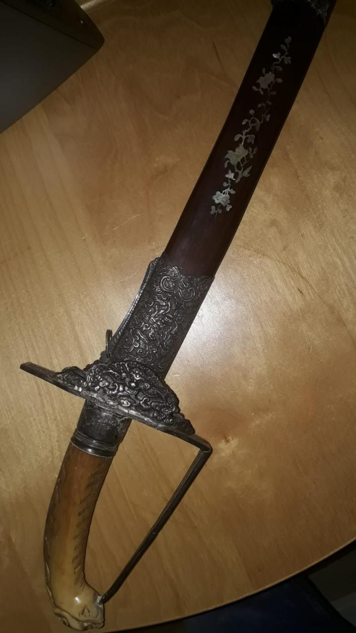

Well, 95% of my pictures were blurry again, but here are some of the less disastrous ones.
It's clearly undergone significant repairs to the grip. Something I failed to notice before is that it looks like the guard may have been broken and welded back together at one point. The sides of the crack line up well so I assume that the parts do belong together. It looks like the plates were riveted to the guard as can be seen in the pictures; the rivets are missing in one corner, leaving two little holes.
Some measurements: I can't quite get my calipers between the plates on the guard but the blade is about 2.6cm broad and 9mm wide at the base, then (distal) tapers quickly to about 5mm 10cm down the blade, then a gradual taper to about 3mm at the end of the fuller, then down to 1mm near the tip. The length of the blade measured from the tip in a straight line to the shoulders is about 67cm. From the tip to the peen is 81cm. 87cm total inside the scabbard. POB 10.5cm from the base of the blade. I don't have good scales here so unfortunately I can't give an overall weight.
The scabbard grips the blade well enough to hang suspended from it by friction without support when I'm holding the grip of the sword, but not well enough for it to hold the sword in when I hold it upside down while holding the scabbard.
I wish I had a better replacement ring for the scabbard as it looks a little silly. }|:oP

Thank you very much for these photos!
I see that this sword had a long and hard life. But he is still a strong and cheerful old gentleman
In my opinion, the blade is quite typical for this part of Indochina. The decor is a stylized image of the constellations. The same or very similar ones were depicted on ancient Vietnamese flags, which, for example, were used in Nam Giao - the ceremony of sacrifice to the Earth and Sky. On Chinese blades, the stylized image of the seven stars of the Big Dipper can often be seen, but this is the first time I see it on a Vietnamese blade. And the style itself is different from the Chinese.
The crack on the handle looks too regular and symmetrical for accidental damage. I can assume that there used to be a decorative insert in this place, for example, a silver stripe.
Thank you for the wonderful input so far, it adds a good deal to what we know about a field about which so little reference material exists.
On this blade, yes, the arrangement is different from the usual Chinese, but I still see seven "stars". As other readers are no doubt familiar with, the typical Chinese arrangement on double-edged blades is a simple zigzag to accommodate the overall shape of the space; on sabers you occasionally see them as inlaid dots, typically between segmented channels along the dorsal profile.
