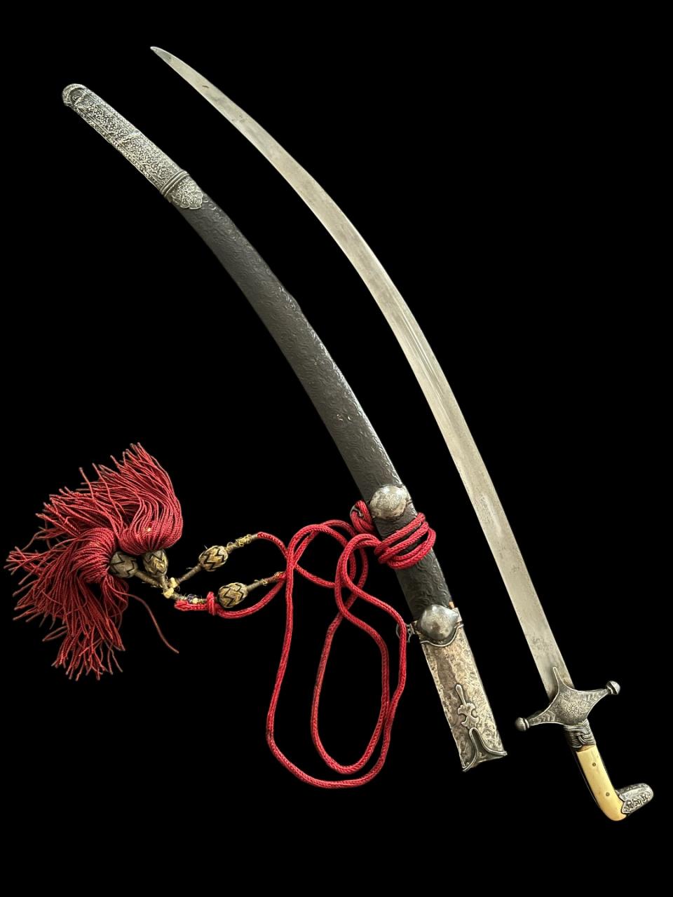

It took me a while to acquire one, but I was finally able to with the help of a friend, to whom I am very grateful. I can finally claim that I have collected all the major types of Omani/Zanzibari swords. The nimchas fascinate me the most, but shamshirs seem to have been reserved for some of the highest ranking members of society in Oman, Zanzibar and the Comoros, such as royals and grand viziers.

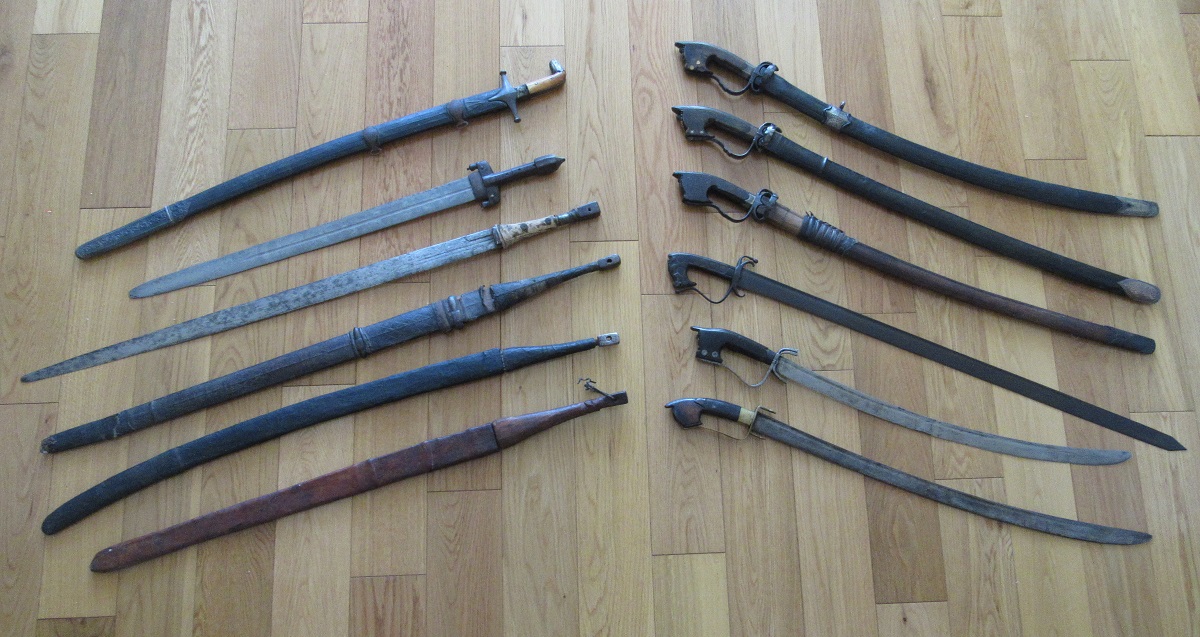

Marvellous collection !!
Glad if you share some pictures of the others...
( nimcha or old straight model )

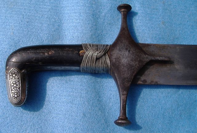

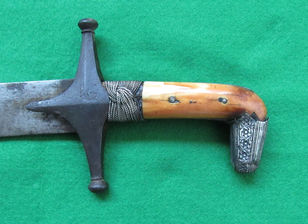

I am glad you like my little grouping. I will post a thread on the nimchas where I will go over them in more detail. The kattara and the straight saifs I have posted on this forum before, sometimes with unintended consequences resulting in very long threads with some controversy.

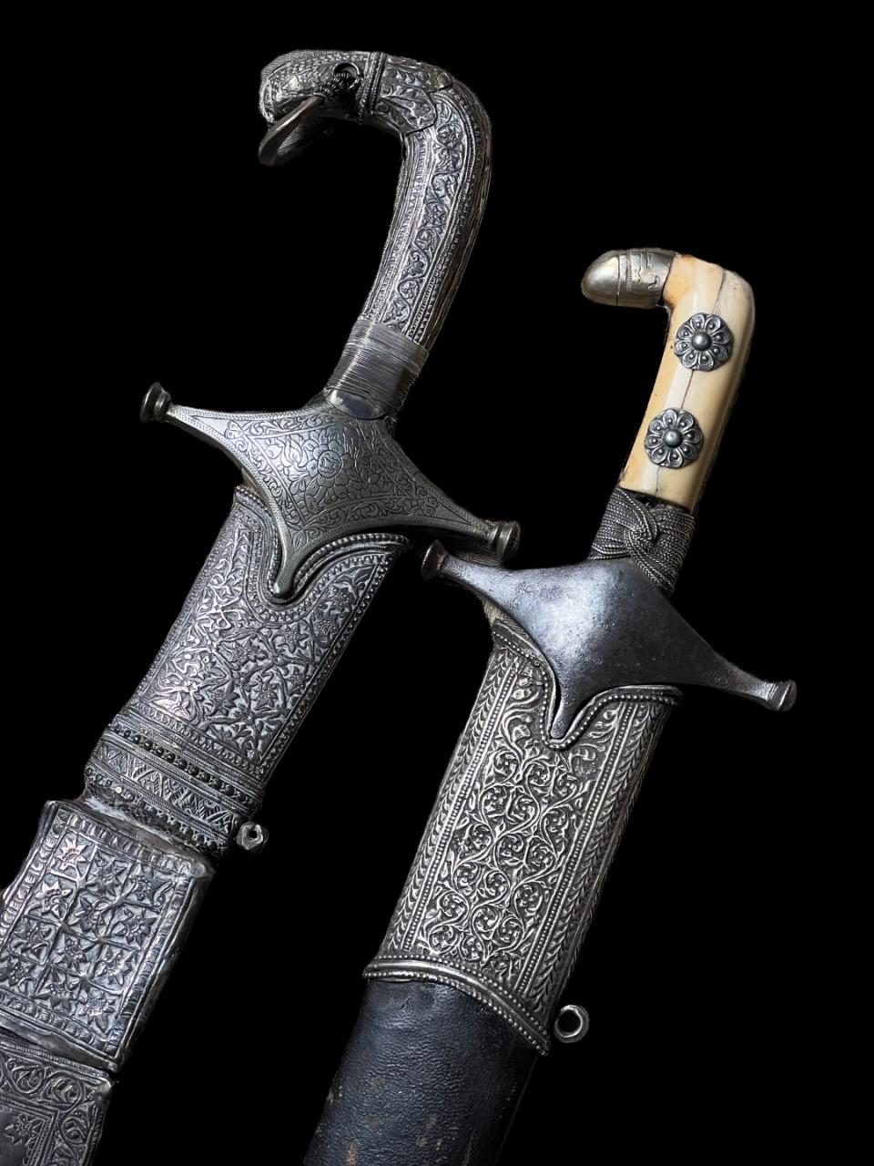

Back on the subject of Omani shamshirs, here is a side by side comparison with a typical Persian hilt to show some of the differences:
- Some minor crossguard differences;
- The twisted wire wrap with the characteristic knot;
- The Persian pommel cap is cylindrical, short and generally not decorated, while the Omani pommel cap is conical, slightly longer and often decorated - the 6-petal flower motif is found on all kinds of Omani sword fittings.

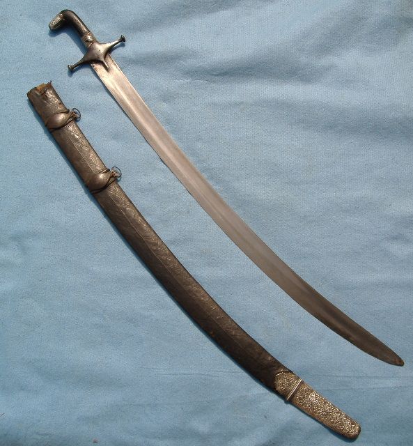

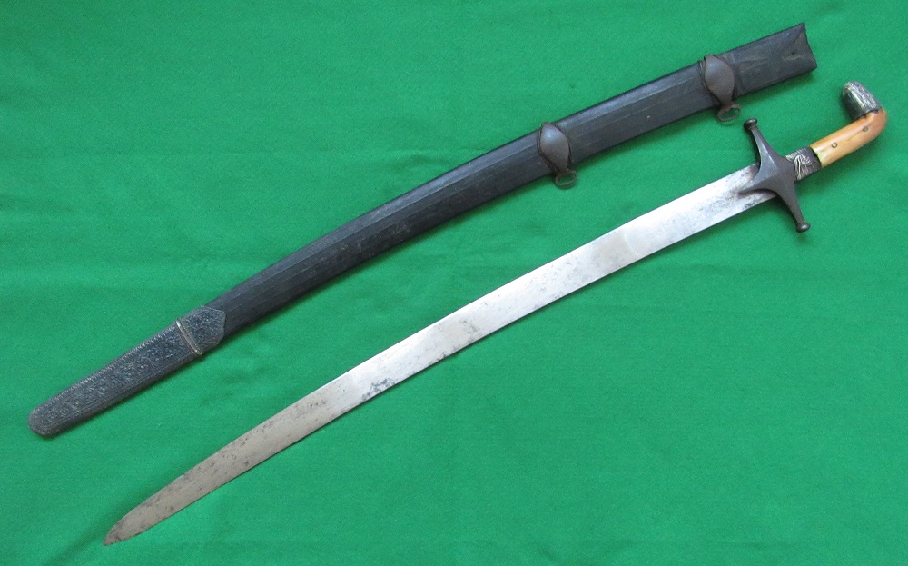

Hi TVV, This is a sword I bought 17 years ago on oriental-arms, where it was described as "most probably from the Arabian peninsula and one of the execution sword style". Then, I also read somewhere that when the pommel of the hilt is only "slightly" curved, the sword is from the south of the Arabian Peninsula and when it is sharply curved, it is from the north - but I'm not sure. So - is it FOR SURE it is comming from Oman, or from its sphere of influence?
I'm attaching old photos (I didn't take new ones).
Martin

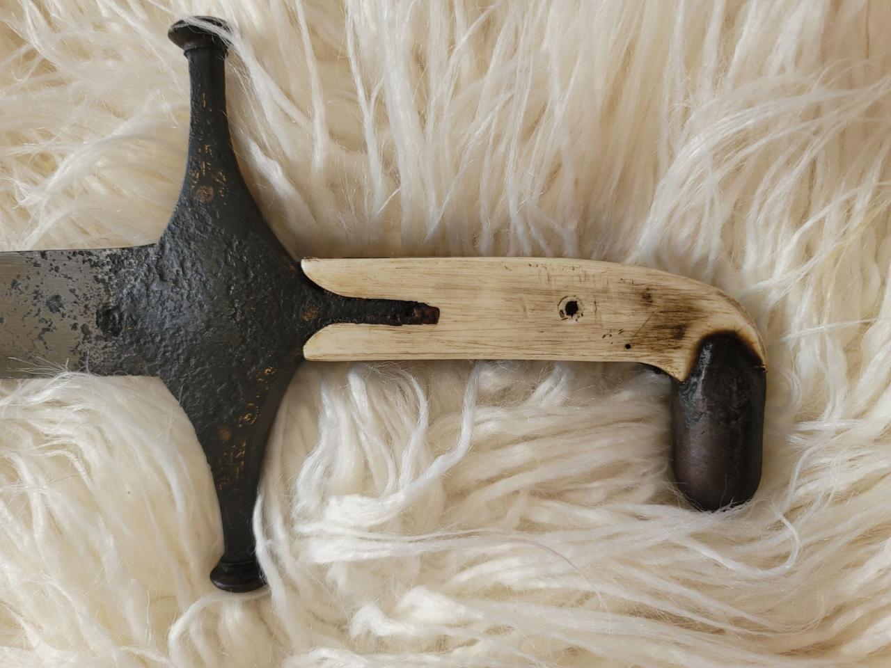

ASPaulding
ASPaulding's Avatar
Join Date: Sep 2021
Posts: 84

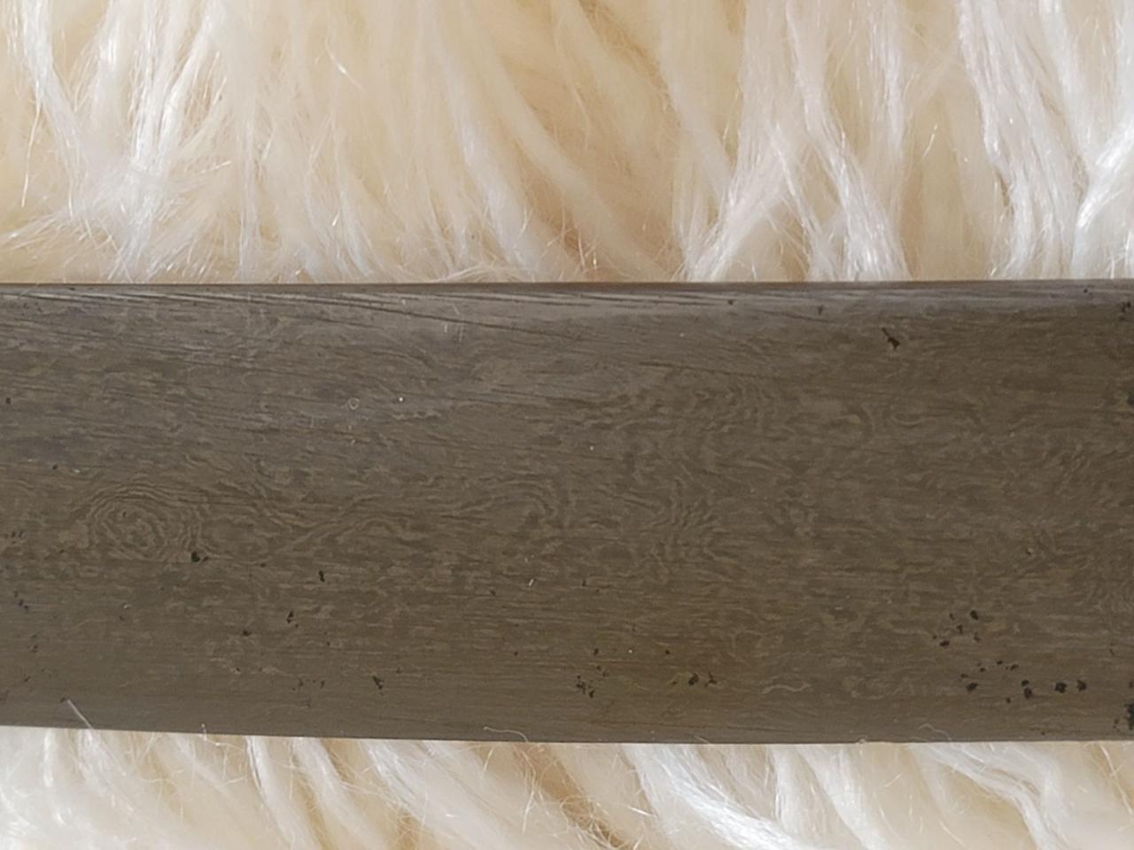

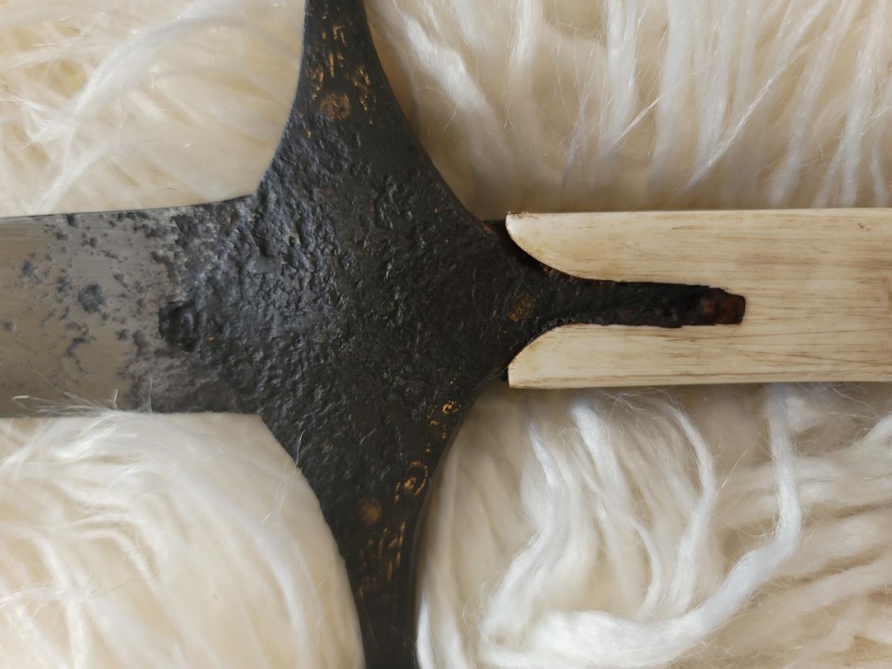

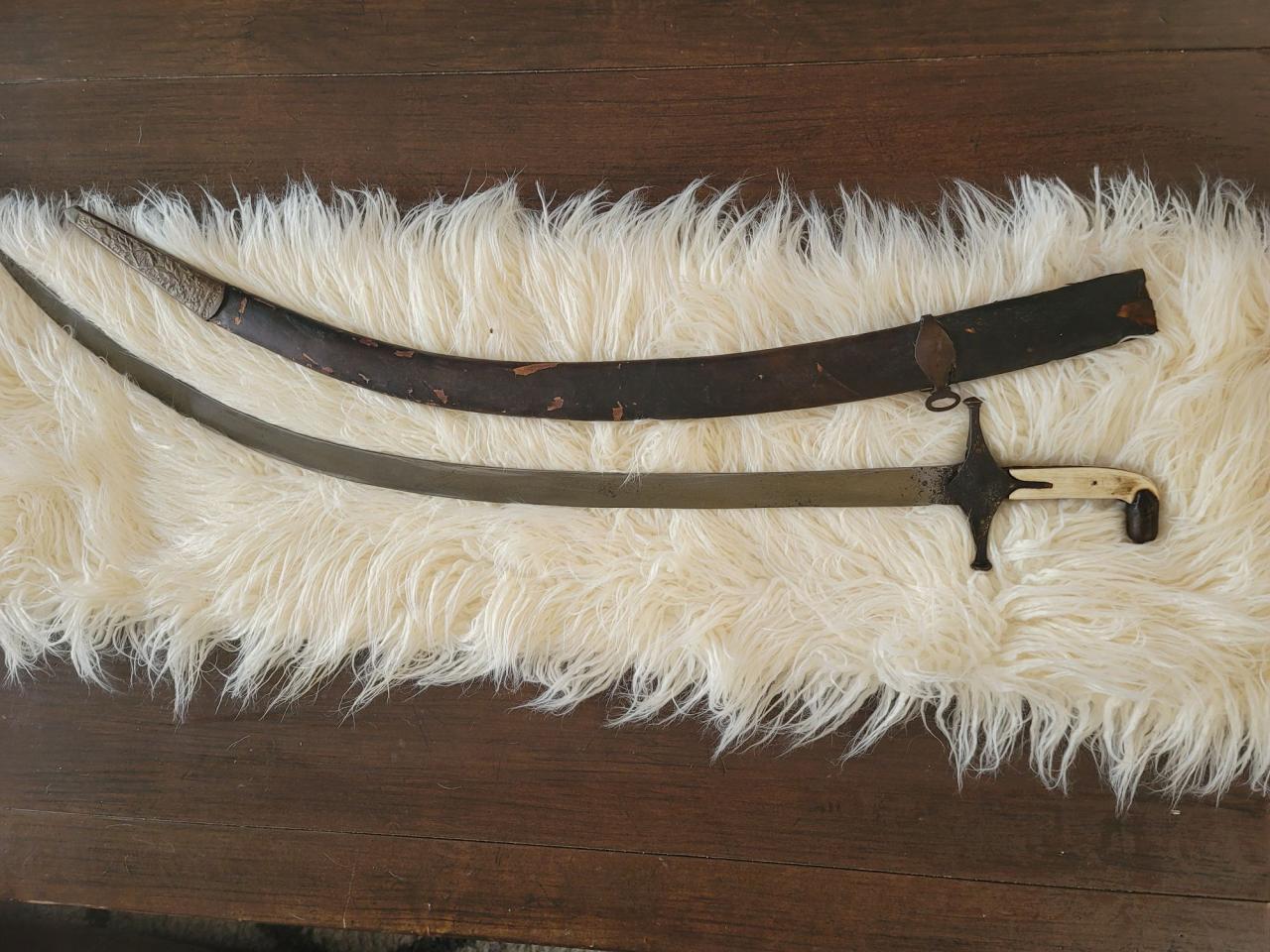

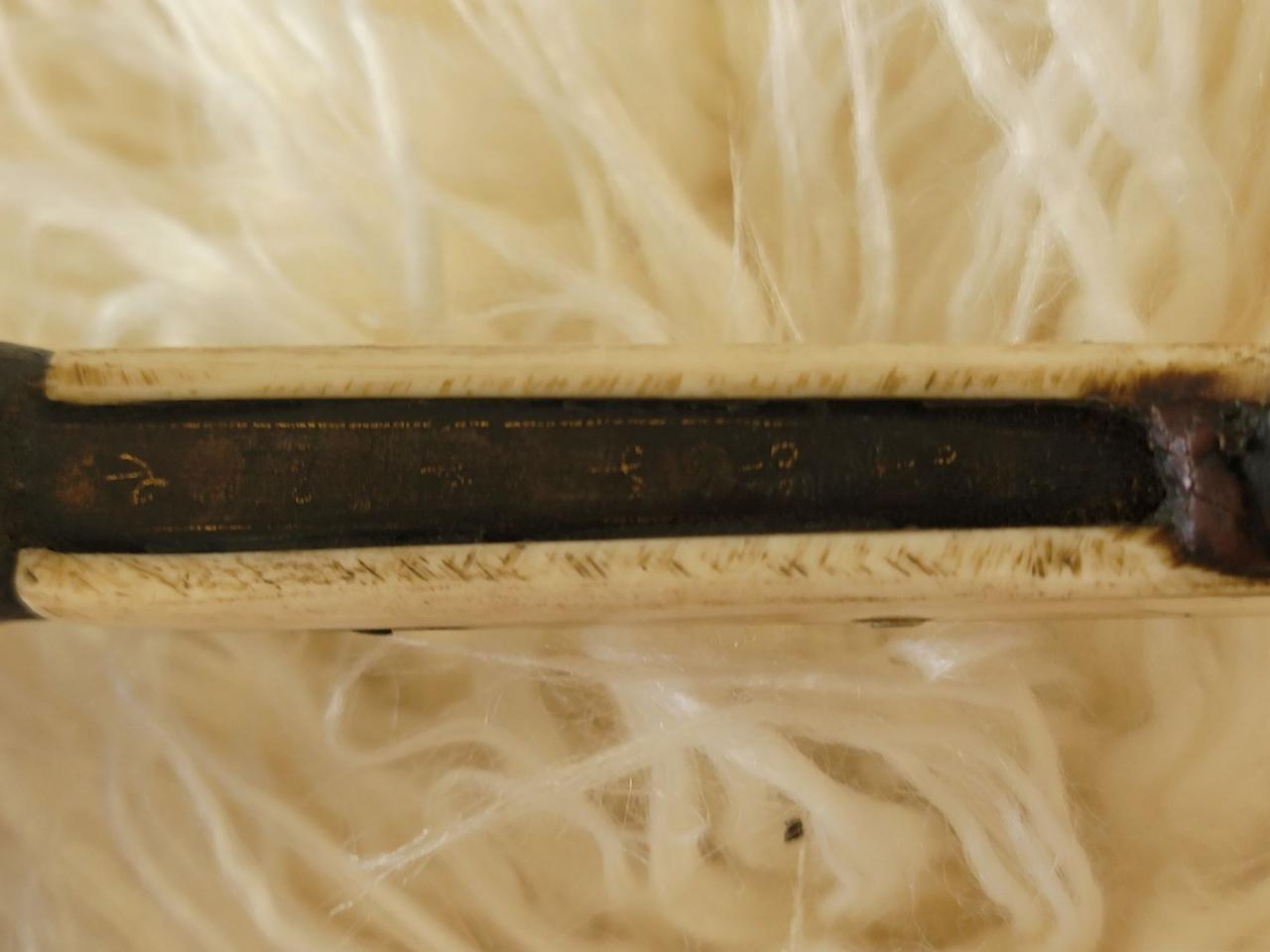

May I get your thoughts on mine to. I particularly curious about the age. I just got mine last weekend. Thank you

Martin, everything on your beautiful sword suggests an Oman/East Africa coast origin (these were also quite popular in the Comoros based on surviving photos). Thank you for sharing the detailed pictures.
ASPaulding, congratulations on your classic Persian shamshir with a wootz blade. I do not have the expertise to tell you whether this is an 18th or 19th century blade, but it is undoubtedly a nice antique sword.

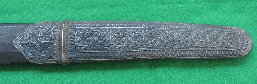

Teodor,
Marvelous collection!
I have only one comment: if you include Zanzibari swords because Zanzibar was governed by Oman, you may still need to add a Baluch shamshir for completion.
http://www.vikingsword.com/vb/showth...uchistan+sword
Baluchistan belonged to Oman for a long time and was sold to Pakistan only in the 1950s.
I remember we had a long and detailed discussion about Baluch shamshirs, but I could not find it and had to show just mine.
Persian blade, "Indian" pommel with classical Baluch ring and silver wire wrapping of the upper languet ( regretfully, no Omani knot).

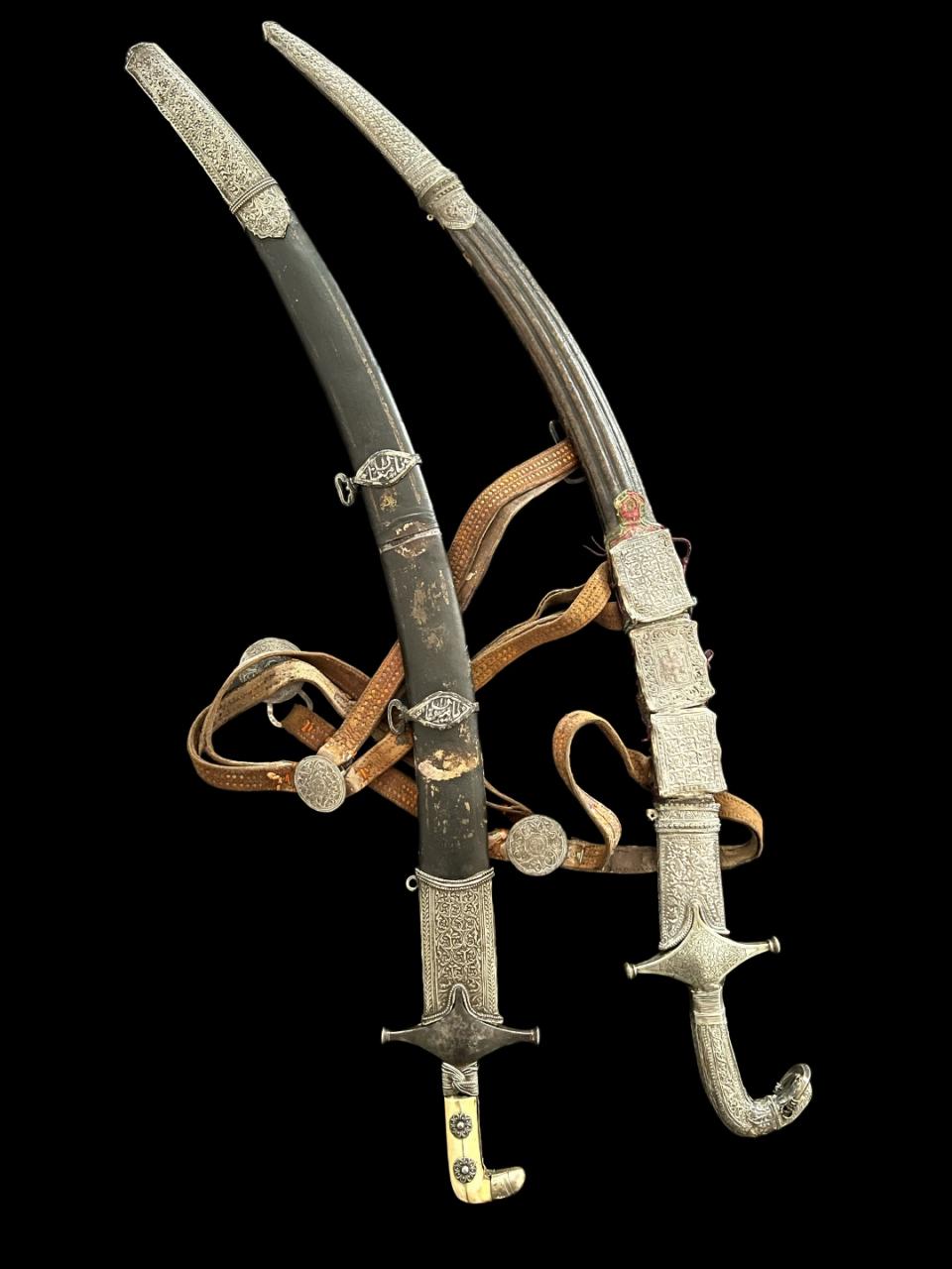

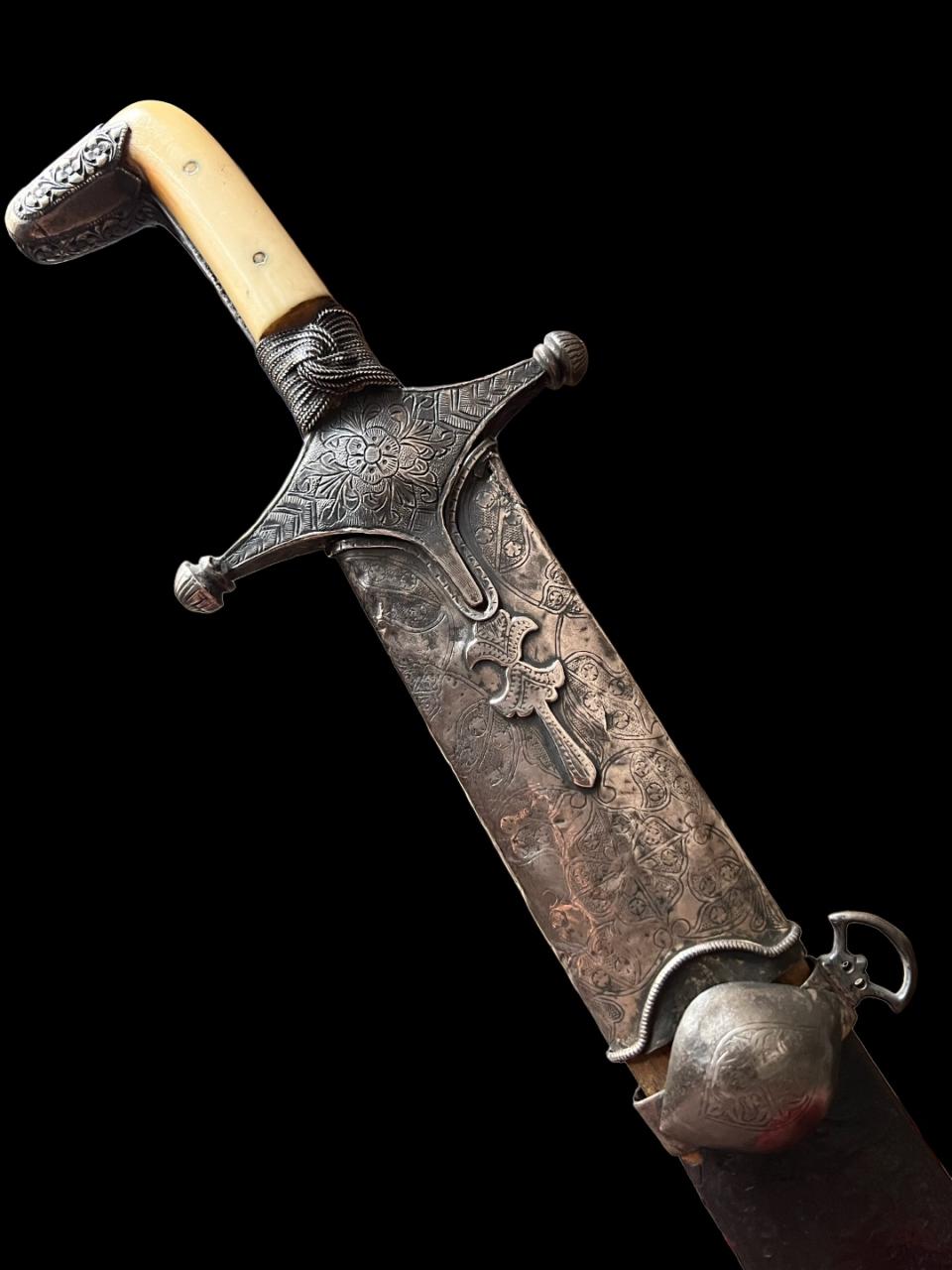

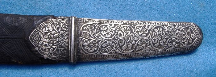

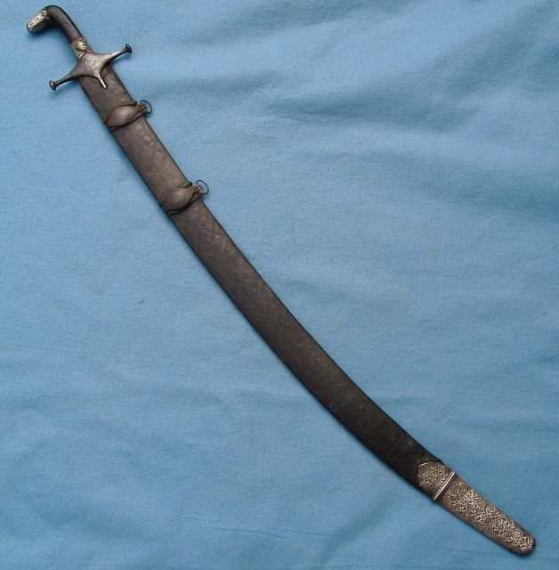

Here are the pictures I received from Lotfi of some really nice and interesting Omani (and 1 Baluchi) shamshirs with outside influences. I will let him make his comments on them.

Thanks Teo,
Those two examples are interesting to me due to their unusual features such as the lockets which borrow from other styles. The first borrows from Arab swords usually found further north and one is closer to the usual baluch example.
Note that the sword photographed next to the baluch example has poorly made editions and its pommel was likely identical to the typical Omani examples.

Fabulous swords!
Agree 100% with your attribution.
I am not surprised by both Omani knot and "akrab" on the first one. After all, Oman is in South Arabia.
