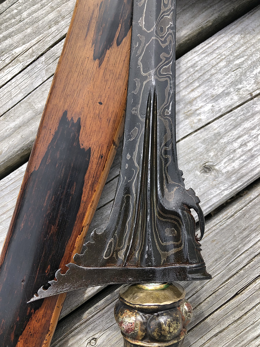

Those of you who still surf eBay looking for deals may have become a bit dissuaded by that venue lately as many prices have become ridiculously high even for the most common of village keris. I really don't spend much time looking there as i did many years ago when i was young and first starting to collect keris. So i was quite amazed at what people were asking for keris on that venue these days as well as the general misinformed nature of most of the auctions there (that part is, unfortunately, not unusual). But i was surprised when i found this Bali (?) keris at a rather incredible price and no one seemed to be bothering with it. I add the question mark because it is an unusual form for Bali and i wonder what the origins might actually be.

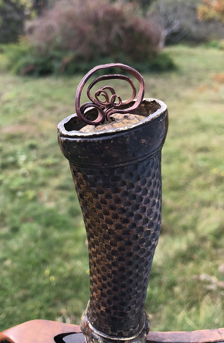

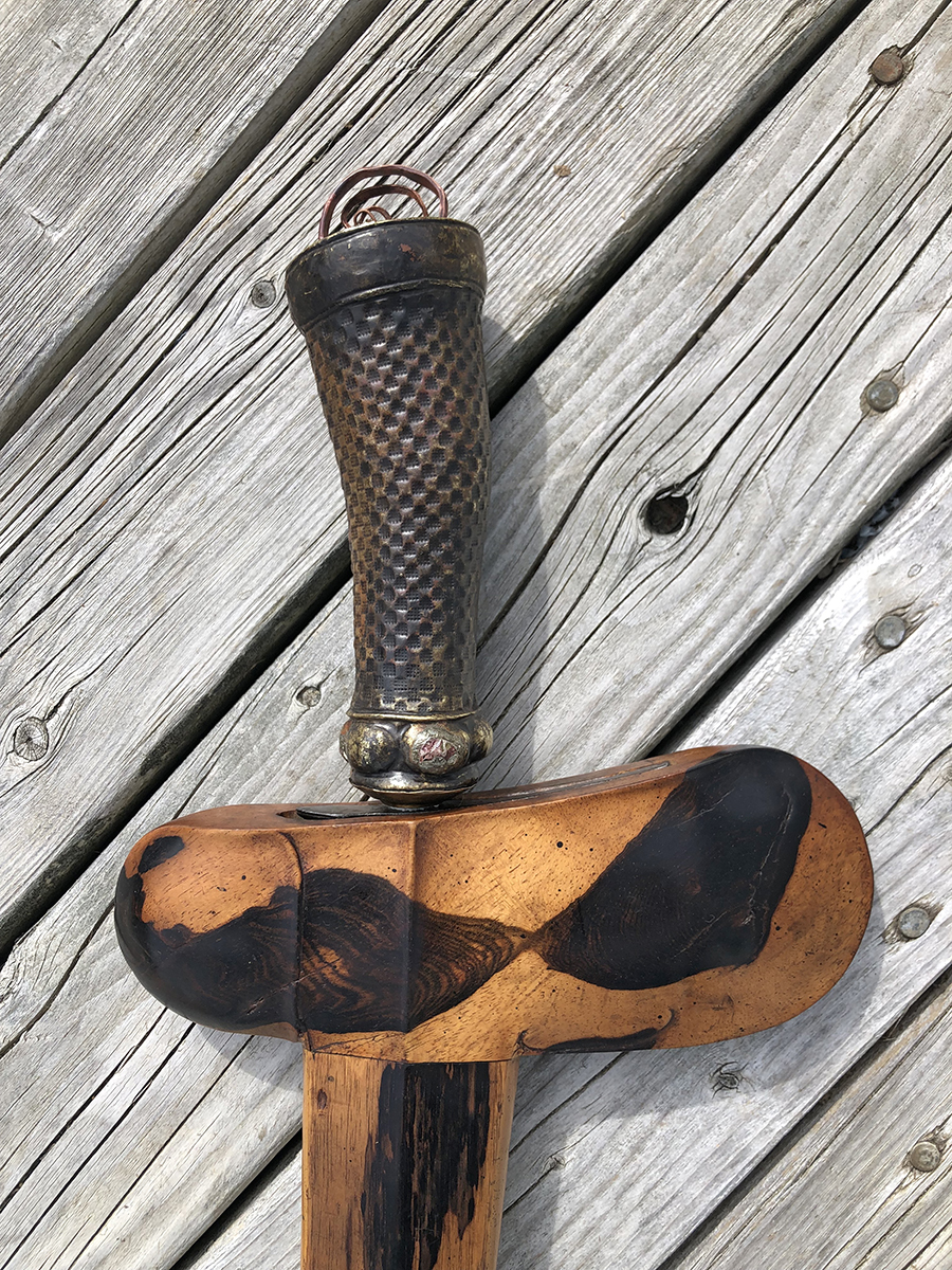

The brass gerantim hilt is in the worst shape. The "sprouts" at the top of the hilt had been squashed flat to the end of the hilt so i carefully pried them up and tried to reshape them. I may fiddle with it further, but i am worried about snapping the metal if i play with it too much, so it might be best to leave well enough alone. The body of the hilt is a bit banged up as well and it has lost most of its gold wash, but it is still fairly solid. I may in fact search for a replacement in time, but it will do for now. No uwer came with the keris.

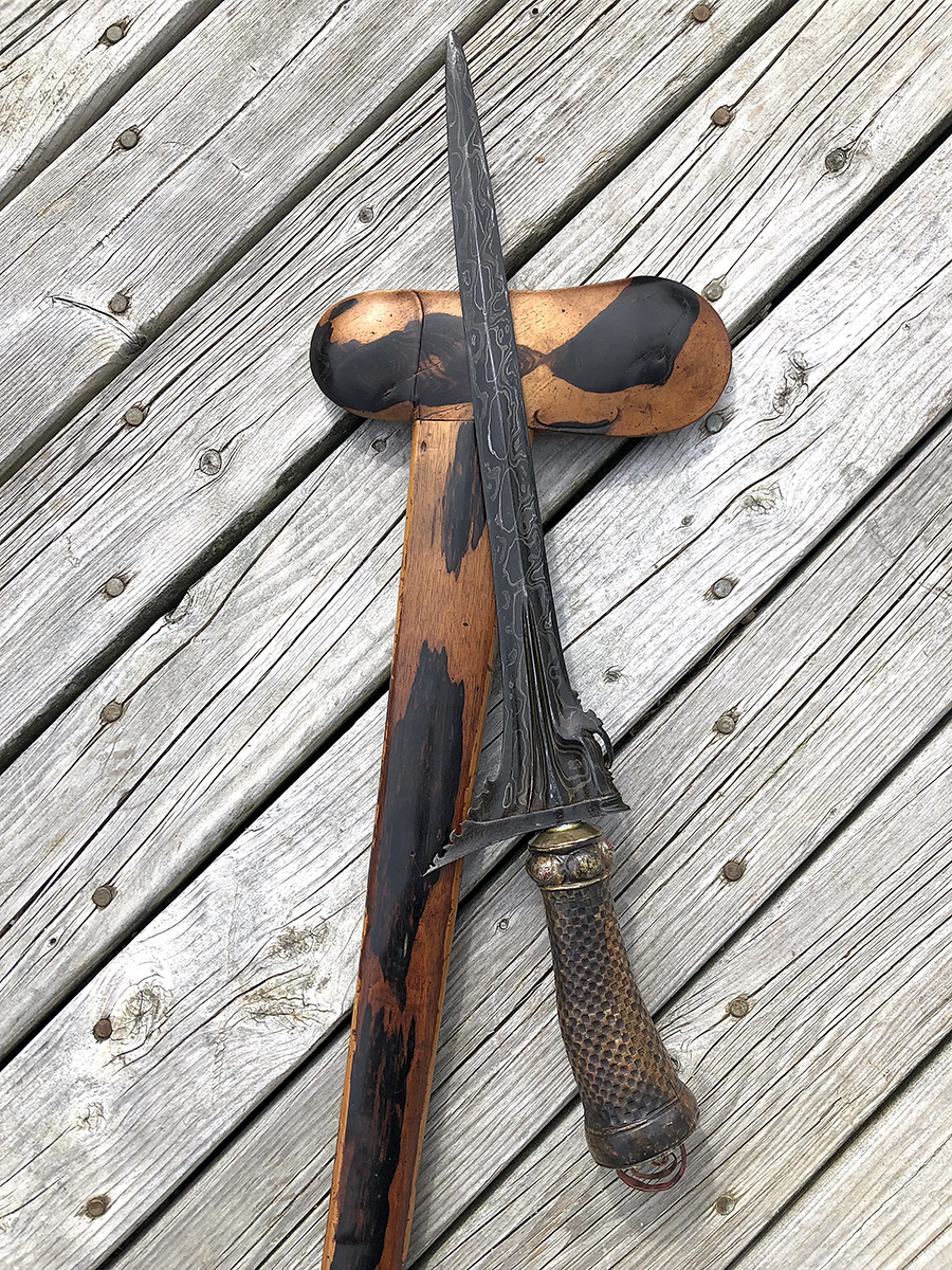

The blade is a bit short for a Bali keris at 33cm (13 inches). It is a dhapur i have seen before but don't know too much about. I am specifically talking about the shape of the kembang kacang, with its long trunk and the long kebo-like gandik. Does anyone know a more exact origin for this form? I know i have seen other examples of it in the past, but cannot remember where or when. Could it be a Lombok form?
Full disclosure, the blade does have a little damage to the sogokan on the other side (not shown) that may have come from strikes to the blade. Hard to say. Anyway, it is not so bad as to spoil the deal.

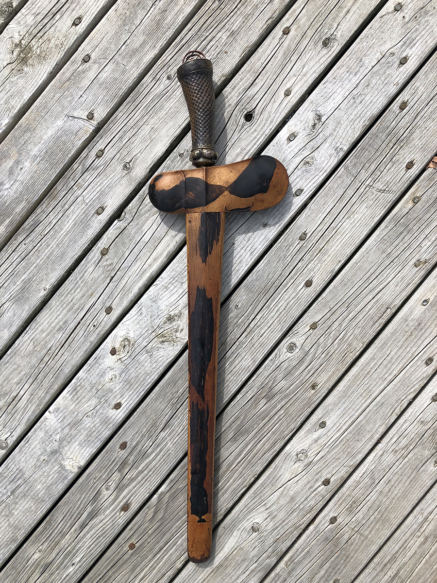

The sheath is desirable pelet wood with some nice patterns. The blade fits well in it, though from the space at the front i would image it was not original to the blade. Not really a concern for me.

Sorry about the quick cellphone photos, but you should be able to get a good idea about this keris from them.

A nice find and an interesting keris, David. I too am curious by the long sekar kacang, as well as the feature above the jenggot. I wonder if they were intended as ron dha-like carvings.
Actually I believe they were once fully formed ron dha either eroded or partly broken off.

I tend to agree with you on this front Alan, but when i see a blade that falls outside the more common appearance of Bali keris from the period i tend to look for other possible origins. It has little to due with the shorter size and more the odd appearance on the gandik.
