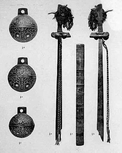

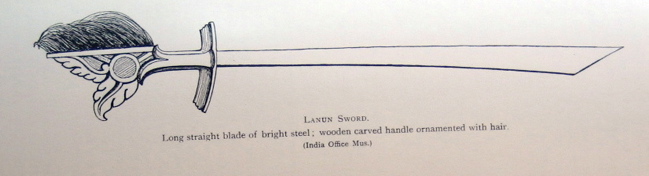

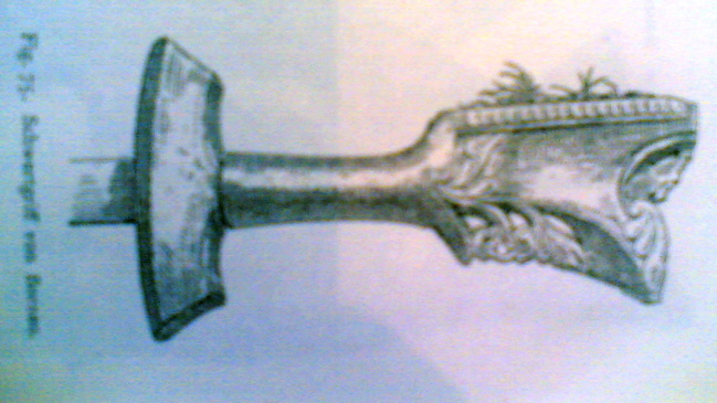

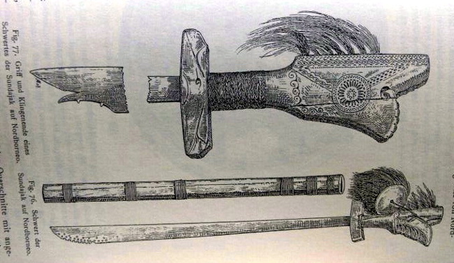

I had a look in two other books and found the following illustrations of Kampilans collected in North Borneo in the 19th C.
The first is from Ling Roth, The Natives of Sarawak and British North Borneo, published in 1896.
The two other illustrations are from W Hein, Indonesische Schwertgriffe, published in 1899.
PS Sorry about the picture quality on the Hein 1 but I only have my mobile phone camera available at the moment.

Very helpful pics Michael. They really go a long way towards making the N. Borneo point.
