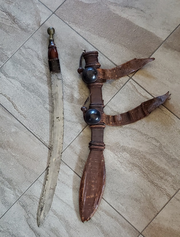

This takouba has a blade which appears to be an 18th century hanger or short saber blade, probably German and with a slight curve, single edge. This places it categorically as the takouba form termed 'aljuinar' (for curved blade).
What is curious is the sort of horseshoe shape mark in the blade.
With European blades of these forms of 18th c. often various symbols in much the same position sometimes occur, obviously the running wolf, or the fleur de lis. It is tempting to think of this perhaps being the omega, but this is not typically seen used in this manner, and the mark is crudely executed so probably native.
I am imaging by the leather work on hilt and scabbard this might be from Saharan regions from Mali, Burkina Faso as it seems also with Cameroon in mind. Thoughts as well?
Much of Tuareg symbolism can be found on material culture items of course, and jewelry. I recently acquired the 1958 "Au Sahara" by Jean Gabus, and on p.60, this type mark is used in linear fashion on boxes in the silver thread.
It is described as 'haver' or sabot (Fr.=hoof).
So my question is, why would this 'hoof' mark be so placed on the blade?
We know that the familiar dual moons (dukari) are intended to imbue magic into the blade. We are still unclear on what the 'enigma' mark which seems to have been from the Agadez regions of Air in Niger c. 1916.
Any ideas on the symbolism of a horse hoof in Tuareg parlance?

The example of takouba I have posted here is peculiar in being 'aljuinar', that is having a saber type blade as opposed to more typical broadsword blades of takouba. It is European and likely 18th century.
From notes I just found, its provenance is from Ouagadougoo in Burkina Faso where it was acquired there sometime over 30 years ago and I got it from the guy who originally acquired it some 20 years ago.
While I deemed the curious mark at the center of the blade to be of 'horseshoe' character, it is more clearly an arc with dots at each end, rather similar to the 'sickle' marks of dual arcs (usually dentated) of 'Genoa' and which have three dots at each end.
I have seen takouba with this 'Genoan' marking approximated with paired arcs but plain, no dentation, and with single dot at each end. Could the mark on my sword simply be 'reduced' from that application? as we have agreed, we cannot possibly know, but the possibility is clearly there.

...While I deemed the curious mark at the center of the blade to be of 'horseshoe' character, it is more clearly an arc with dots at each end ...
Yes, i was hesitating to enter, to say that i also saw (separate) dots; even one of them with a 'buttton' look ... so to say .

Well noted Fernando, and this is the case in point, perception.
While my initial reaction was that the mark, to me, resembled a horseshoe, It is hard to determine what the individual placing the mark intended. In reading through Gabus(1958) a marking which resembles the Greek letter omega (an arc with voluted ends) seems used widely in Tuareg context in decoration, and termed 'horseshoe'.
This recalls cases where the Tuareg, seeing the cross and orb marking as used on German blades, as a drum and sticks. This seems to have been seen as representative of a chief, or in terms of authority. As Ed has noted, in Funj parlance, this mark was used to mark property, so in essence similar as representing authority or 'ownership'.
In other cases, the European markings known a 'the doll' or 'fly' were seen by Tuaregs in accord, but in their parlance the fly was symbolic of a brave and skilled warrior (the leaping and evasive tactics in combat situation?).
While it was tempting to think of the horseshoe in the widely held symbolism in Europe and other of 'good luck', it is unclear what the Tuareg perception of the omega like mark or this dotted arc might be.Though we of course do not know, it does seem worthy of note and consideration to possibilities.

The arc looks to me to be rinsed, perhaps an inlay rather than an indented/stamped mark. If correct to me that would place the mark into a "higher??" category of presentation and rarity. Also, do the dot go all the way through the blade & what if anything else is on the back side? Getting curiouser and curiouser.

Thank you Ed, the dots are indented, not through.

To my eyes the semi-circle looks above the surface of the blade; could be shadowing, and not below the surface as a stamp. Could just be my eyes and the photograph. An indented stamp is a typical mark, but a raised inlay would seem special.
That truly is interesting Ed, I dont have the sword handy right now so cant say for sure, but if this were raised I would have noted it as that would be incredibly unusual. I cannot say I have ever seen such an application. How would this be carried out on a European blade long after original production?
