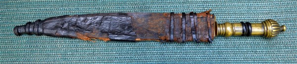

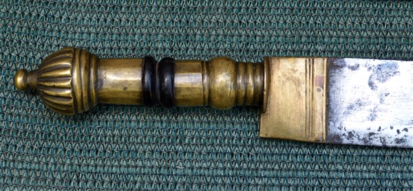

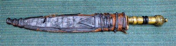

Hi everyone !
I recently bought an interesting knife, with a nice handle, but I'm having trouble determining what it is exactly.
I've seen somewhat similar daggers described as "moorish daggers" with no further information (http://www.africanarms.com/gallery?m...m-mali-39-2-cm). It also has some similarities with some faca de ponta, but the sheath looks rather african in my eyes. Someone in a group suggested that it was a Yoruba knife, but I haven't been able to find something similar.
The handle is heavy and made out of bronze with a hard wood (ebony ?) insert. The sheath is made out of leather with some textile covering, maybe red velvet originally.
I've started cleaning the blade that was deeply pitted and rusted, it has a "wavy" engraved design near the spine on both sides. The whole knife is 36.4cm long.
Thanks in advance for your help and let me know if you need any more pictures or information !

An South American dagger, I guess Brazilian, I have seen 19th century Faca de Pontas like this, Mineira knife could be an other possibility.
See this threads: http://www.vikingsword.com/vb/showth...azilian+dagger
The handle construction and the bolster are give aways for me.
Very nice knife.

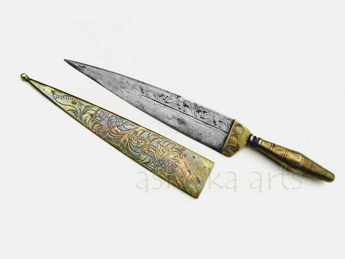

Attached some 19th century Faca de Pontas from my collection.
From up to down: 32,4 cm, 39 cm, 32,5 cm, 18 cm

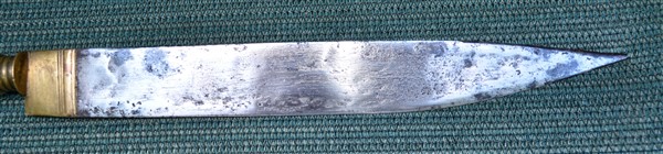

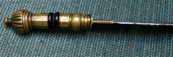

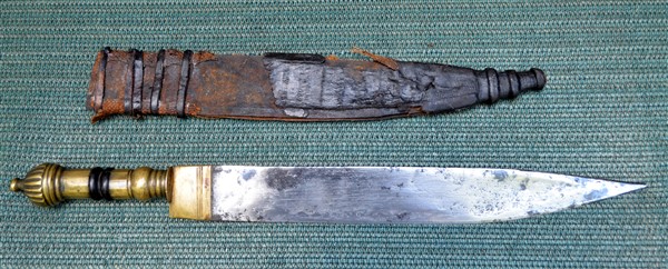

Can you show a picture from the bolster like this?

So most likely a South American knife with a West African sheath? That's quite a travel for a knife!
Here is a picture of the bolster :
Yvain is offline   Reply With Quote

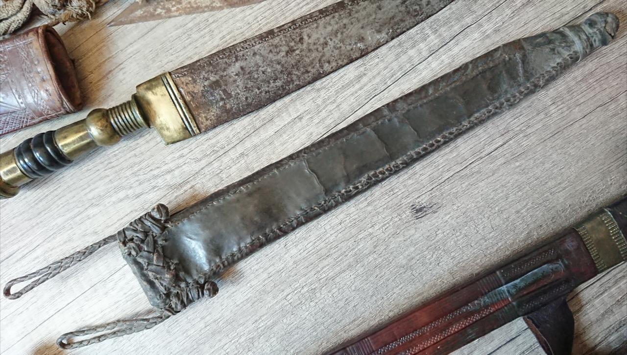

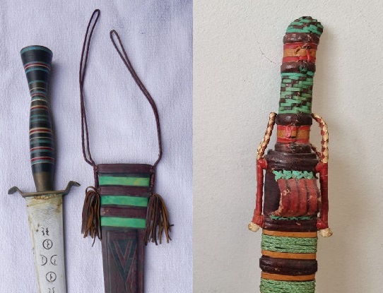

Adding a picture of the back of the sheath, it has a Mandingo flavor to it in my opinion

Also the fastening of the belt loops somehow reminds Mali .....
Yes, very similar. It's somewhat typical.

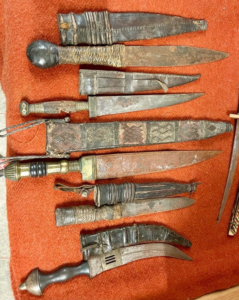

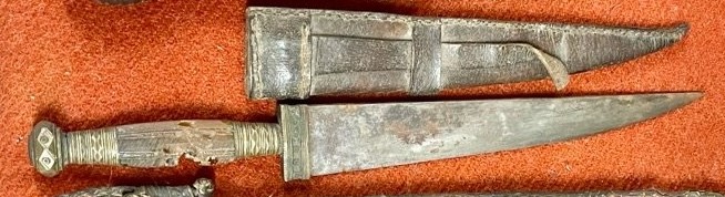

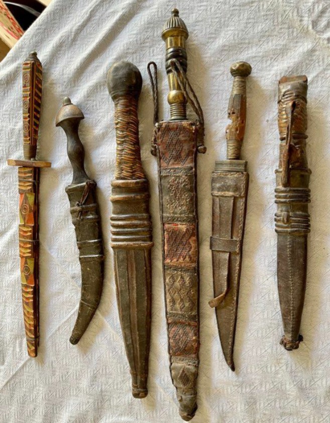

I might add that I picked this knife from a lot of North-West African, see picture attached.

Dealers frequently lump items together in groups and get descriptions and origins completely wrong. A past owner may have added the loops to a sheath meant to be shoved in behind a belt, like most South American knives. The subject knife doesn't seem to fit in the group of knives in the last post.

It could be that the knife right from the one in question is a Faca de Ponta as well but I need to see the blade.

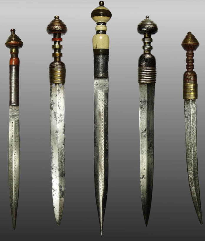

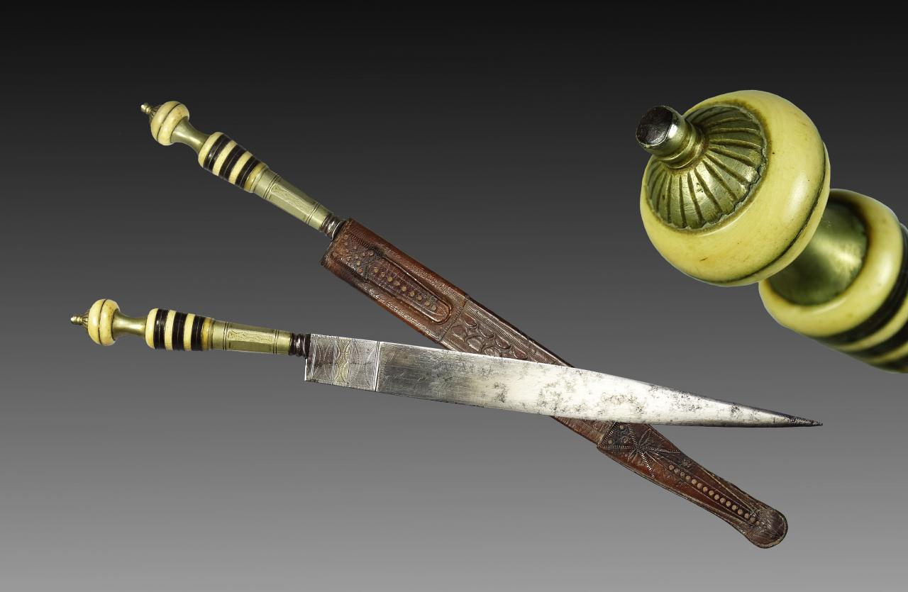

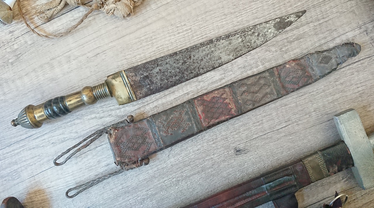

Well, while searching for similar sheaths to make some comparisons, I did found something very interesting, namely the first picture below. Sadly, I wasn't able to find its source or anymore information about it besides the file name ("mandingo short sword old african dagger antique knife"), but I think this is still a very interesting find for several reasons.
First, and even without seeing the blade, it is a way closer match to my knife than any faca de ponta I've seen before : the handle is very similar in shape, seems to be entirely made out of bronze/brass, and with the same central turned, dark wood insert ; at first I even thought it was an old picture of my knife before noticing some slight differences. Second very interesting point : the sheath, which is also in a very distinctive african fashion, similar to what can be seen on some Mandingo/Malian knives.
It's not much, but it is definitely adding weight to Tim Simmons theory, and I would love if he could tell me more about it.
Kronckew :
This lot was sold by a private seller, not a dealer, and considering the comparable state of all of the knives, I'm led to believe that the lot wasn't created yesterday, but I might be wrong. Regarding the sheath, I don't think the loops were added later : the leather is similar to what was used on the rest of the sheath and shows similar wear, it is also a very common fastening method on african knives (see examples below) ; also, the embroidered motives made out of thin leather strips reminds me of what can be found on some Mandingo knives sheaths.

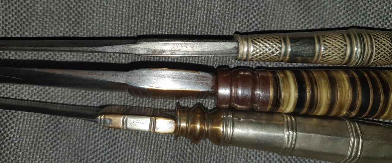

Detlef :
I also have a picture with the knives out of their sheaths, but I don't think the knife to the right of mine is a faca de ponta.

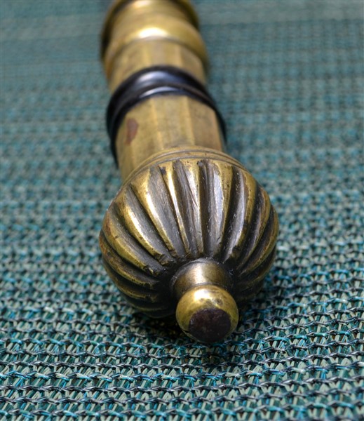

Hello Yvain,
The knife that you referenced belongs to me and is almost an exact match, except mine, is larger, almost a sword. The craftsmanship is excellent, and the scabbard is almost identical except that it doesn't have the loops, however, this could be due to the poor condition of my sheath and they may have fallen off. The scabbard is leather, with a burlap-type cloth insert as is yours; there isn't any evidence that it had a wooden lining.
The pommel has a minaret tower look to it which would indicate its Islamic influence and since the Mandingo People are 99% Muslim, this certainly wouldn't detract from its attribution to these people.
I found this weapon to be well made, sturdy and I would guess a very efficient fighting knife.

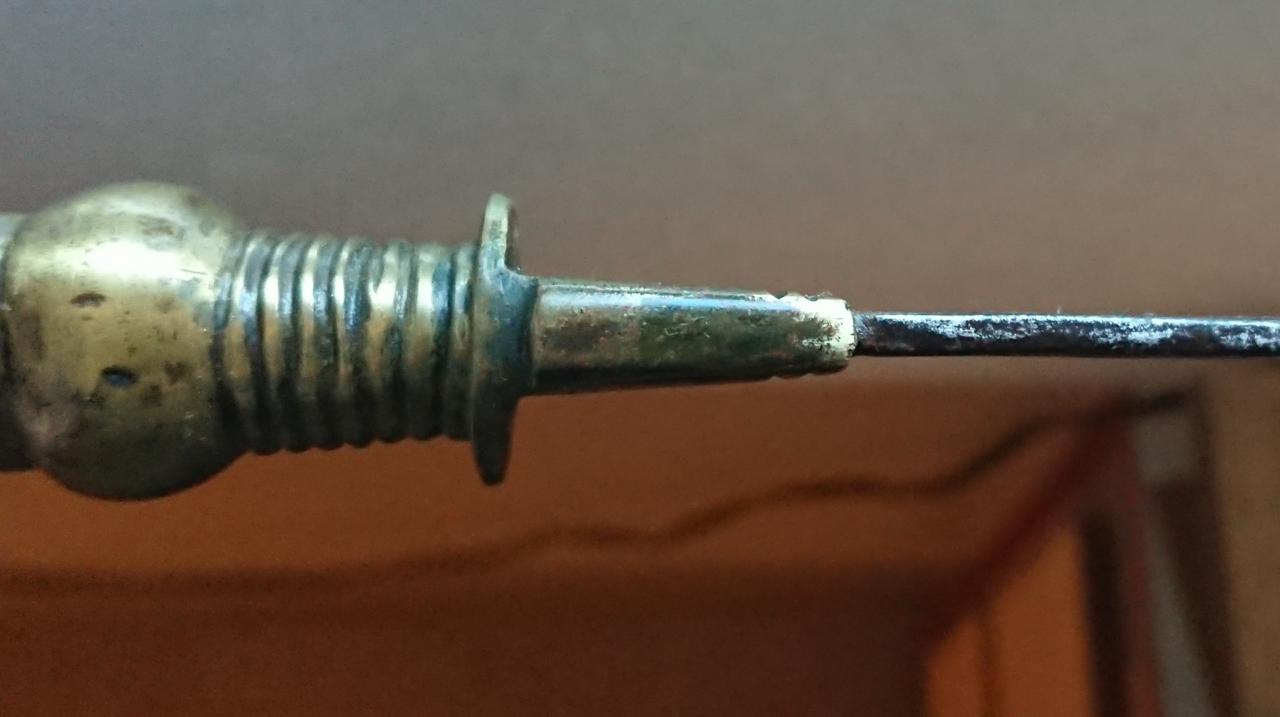

I didn't expect the actual owner of it to show up! Do you happen to have better pictures of it, and would you mind sharing them here? Do you have any additional information about its provenance?

Sure thing. While all things are possible, my bet is on African; also the scabbard fits perfectly(what is left of it).

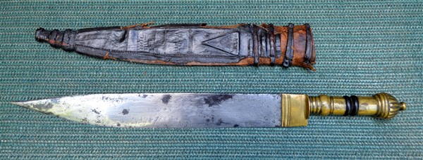

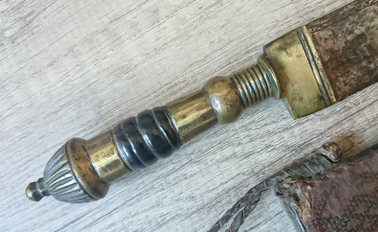

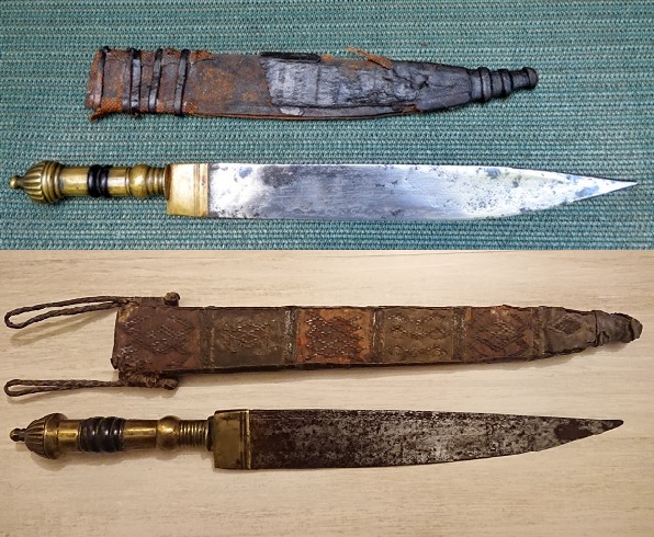

Thank you very much for the pictures Drac2k ! It's truly amazing how similar they are, did a quick and dirty comparison between the two. How long is the sword approximately ?
Regarding the sheath, it definitely looks African (Mandingo ?) to me, and I'm starting to doubt that two very similar faca de ponta somehow ending up in African sheaths is a coincidence. I definitely need do to more research !

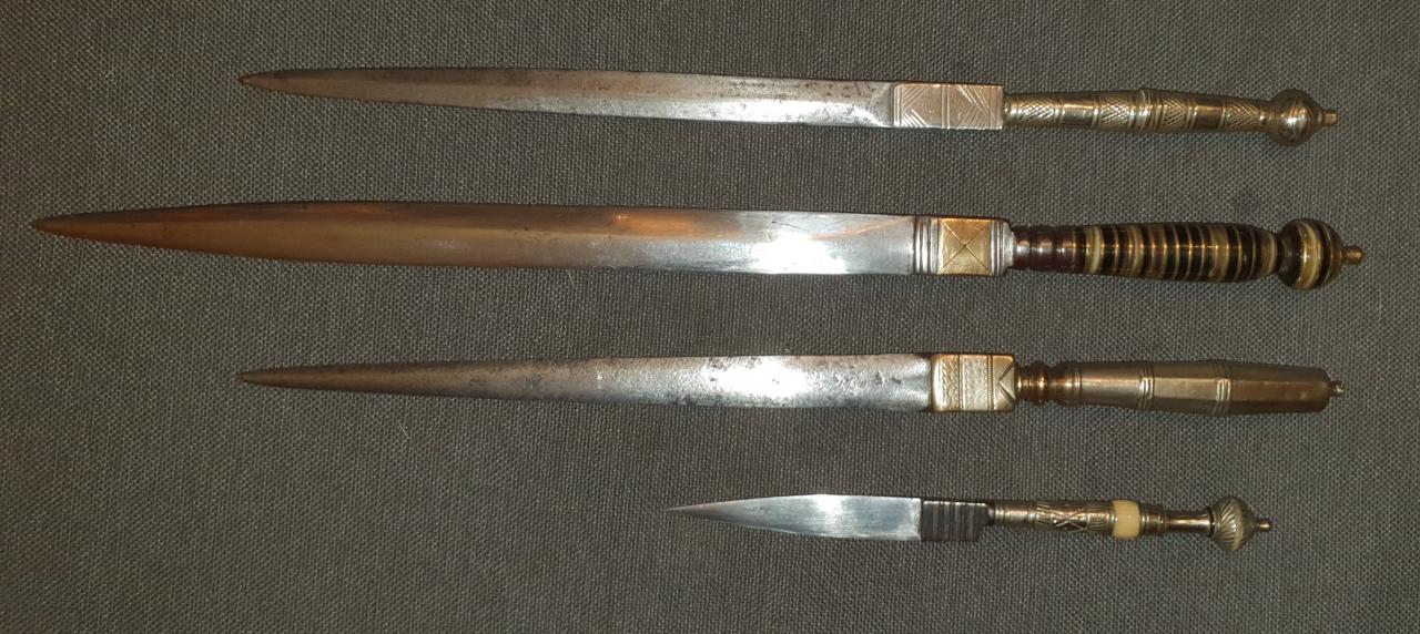

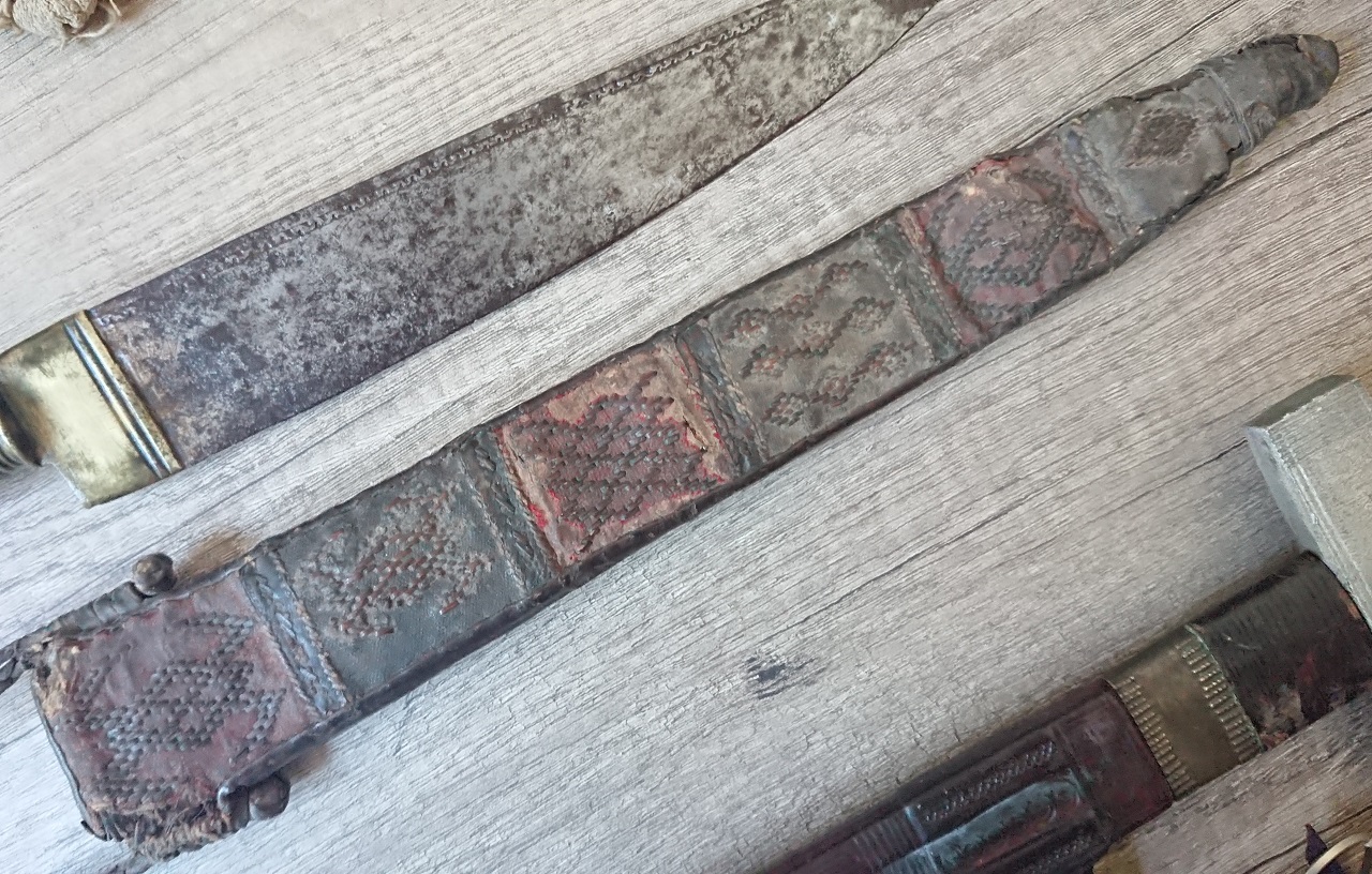

Enclosed is photo of scabbard from Mali with a typical cord fastening

I think that Yvain's knife is very likely African. I found a website (http://www.africanarms.com/gallery?a...nife&ba-page=3) which shows a group of five daggers listed as Manding. The leftmost and center daggers in the set look so much like faca de ponta that frankly, if either dagger were to be accompanied by a characteristic fdp sheath, I don't think anyone would have too much problem seeing them as Brazilian fdp. The above website has other Manding examples that look a lot like fdp. The site also shows an actual fdp and says, "This is a Brazilian so-called Faca de Ponta, around 1900, you can see here the Spanish influence in Africa as well as in South America". It should also be noted that a huge portion of Brazil's population has African ancestry, much of it Manding.
Sincerely,
RobT
Old 17th January 2022, 10:10 PM   #28
Hi All,
Hello Rob,
When you look closely you can see the differences, especially where the handle meets the visible blade. Old facas also have a thick bolster, often with brass or german silver.
But for sure you can see the influence.
BTW, the shown faca on this site is the one mentioned above.

Yvain, sorry about the late reply; the blade is 16" long x 2" wide with a total length of 21" long.
