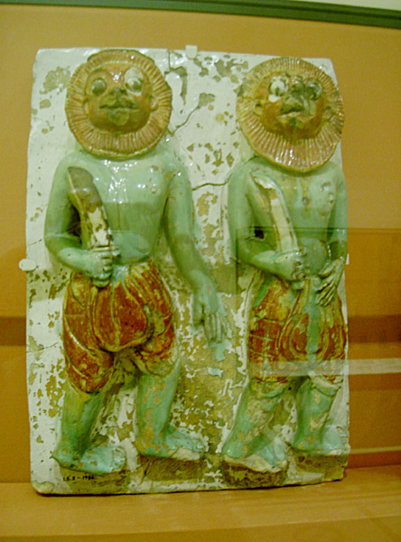

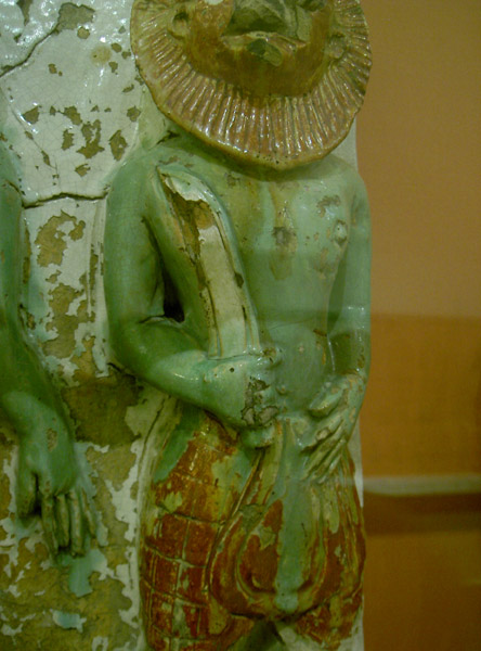

i'm not sure how early iconic references go with burmese swords, but i stumbled across these a short while ago. i hope they are relatively unknown, and of some use.
they are of the late 15thC, and show a dha-shaped blade with no guard, and a dha-shaped grip.
the guys are warriors of mara, from the shwegugyi temple (erected in 1476).

Very interesting. I have not seen these before, and if the date is correct, they show a very early representation of a dha. It is funny that the demonic hosts seem to be the best source of actual contemporary weapons depictions. I have seen a number of daab being carried by Mara's minions in temple paintings from Thailand (much later, though). I guess the artists had freer rein in depicting the bad guys.

i believe these have been well researched and so the date is more likely to be correct.
yes, it is the same with indian art, in that there is a whole host of monstrous creations wielding the weapons we are desperatly trying to research. however far removed from reality the creatures were, the weapons seemed to be exremely realistic and so a great resource to benchmark dates and styles.
apart from these, what is the earliest iconic reference for the dha-shaped sword?

Interesting data. Thanks for the information. These are fairly wide bladed for dha, and quite short if these demonic figures are supposed to be of the same stature as ordinary Burmese. More of a chopper than a sword. They remind me of the length and width of Cambodian leaf-shaped blades from about the same period.

the pious king dhammaceti (r.1472-92) of pegu in lower burma built a series of temples to honour the life of buddha. the most distinguished was the temple complex of shwegugyi, erected in 1476. it was decorated with an extensive series of large-scale glazed tiles, many of which illustrated the demonic warriors of mara's army, sent to disrupt the buddha's meditation immediately prior to his enlightenment.
this tile, with owl-headed figures bearing swords, is typical of this series.
