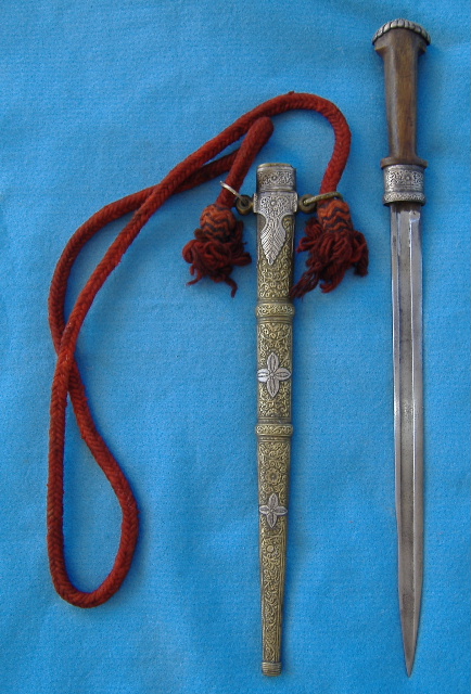

The dagger with red cord is a Moroccan genoui with what is believed to be a Mannlicher-Berthier 1892 (as seen to left next)

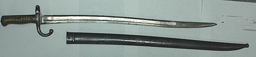

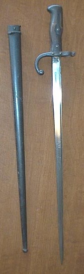

The next two are the yataghan blade Chassepot or the straight blade Gras

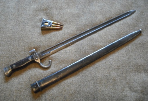

Evidence of marks on blades was just found out there, although in a late period, yet within the period of the Legion in Alger. A bayonet used by the 2nd Foreign Parachute _(2e Régiment Étranger de Parachutistes, 2e REP). The only airborne regiment of the French Foreign Legion.The regiment was constituted in Algeria in late 1955. There, the 2e REP would actively participate in the Algerian War (1954-62). In 1967, the regiment left Algeria as the last French airborne unit and was stationed on the island of Corsica.
Still leaving doubts if weapons distributed in an earlier period were also marked.

Excellent evidence that the convention of marking the Legion's weapons did indeed exist, as per this obviously far later example than the period we are considering. Thank you for continuing the search!!
