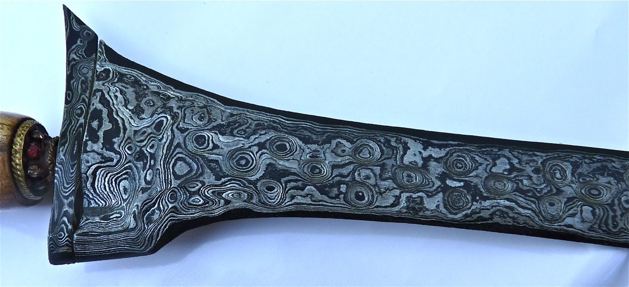

Here is yet another on of my kerises.
This blade can not be very old, but I bought it mainly for the pamor.
Thanks!
Dan

A very well controlled pamor; I like the blade .

Thanks! I had seen other Udan Mas blades (I think on this site) and they appealed to me quite a bit. When I saw this, I knew it was for me.

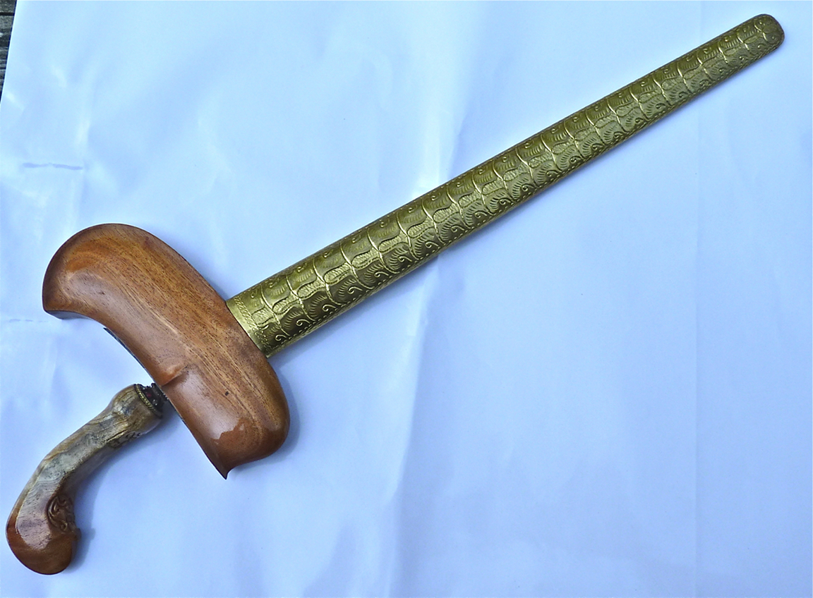

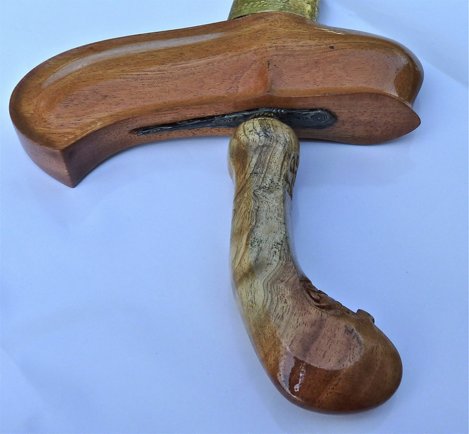

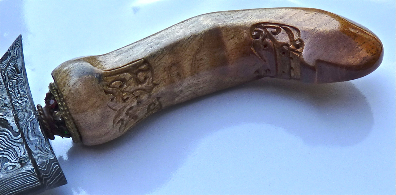

Nice blade. I have one very very similar, and think both are recent manufacture. May I suggest you to provide better hilt and mendak?

Agree, a good hilt and mendak and you have a nice recent keris.

dbhmgb
dbhmgb's Avatar
Join Date: Apr 2012
Location: Maryland, USA
Posts: 112
Done.

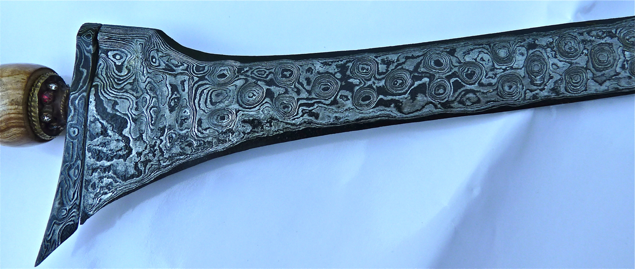

Another similar piece from my collection and also recent, sorry for the picture quality.
I would like to mention that a specific problem frequently encountered when collecting recently made krisses is that there are many twins on the market (from the same maker?), which is a bit irritating if you aim at owning unique pieces...

Yeah, this is actually related to the other thread about collecting new krisses. It would be nice if Gio could show us his similar blade as well for comparison purpose.
I attach another picture of my kris from the other side of the blade.
Jean

It is the pattern of the udan mas that is the same here; 2 1 2 1 2 1 and so on down the blade .
Good workmanship but a little unimaginative in execution .

Right observation Rick, thanks. This type of repeating pattern seems standard on many modern UM blades. The shape and dapur of both blades also look similar, mine is 37.5 cm long excluding the peksi and was probably made in Madura.

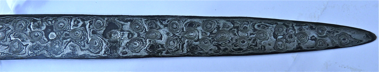

Hi Jean,
Here is my blade.
Sorry for the bad pics: it is cloudy today.

Thanks Gio, the blade looks similar indeed but from the pictures the pamor pattern is less regular than on the 2 others, may be made by a different person?

Yes, Jean. I seems that in my kris the dots are not regularly spread over the blade.

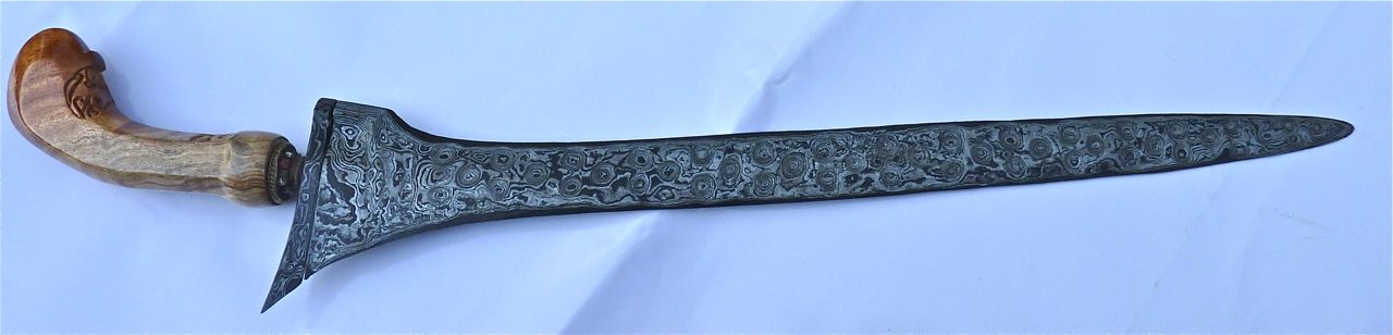

An UDAN MAS blade I spotted with 3 in a row dot arrangment.
Said to be a Tuban blade.

Paul, it would be very unusual for a Tuban blade to have this pamor.
Tuban was not known for producing manipulated pamors of any kind.
A full length photo + a photo of the top of the gonjo would be useful in assisting a possible identification.

Here are some extra pics. Would welcome input.
It is really a big, strong and beefy blade. Maybe the pics don't tell.

The pics tell very clearly Paul.
I would definitely accept this blade as stylistically Tuban.
Quite unusual I think. I cannot recall seeing a Tuban blade with manipulated pamor.
The details appear pretty crisp do we know where this has been?
Reason I ask is because we expect Tuban blades to be old, rather than young, but if this went to Europe a two or three hundred years ago, it could well look like this
