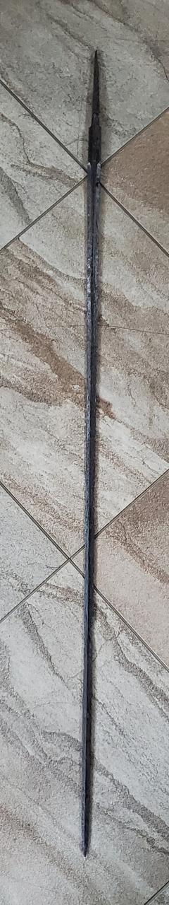

In the colonies of New Spain from the 17th century until Mexico won its independence in 1821, the sword had its presence in numerous variations throughout, and seems to maintained its place in honorary sense long after.
The reputation of the Spaniard and his skill with the sword, particularly the rapier and the mysterious fencing system known as destreza, has long been well known. It seems there is a degree of evidence that these existed in Spains colonies, but it would seem in the more metropolitan and well settled regions.
For those out there familiar with the rapier and fencing as well as dueling of course, my question is, in the relatively remote region of Alta California, were these practices extant, and in late 18th to early 19th c. ?

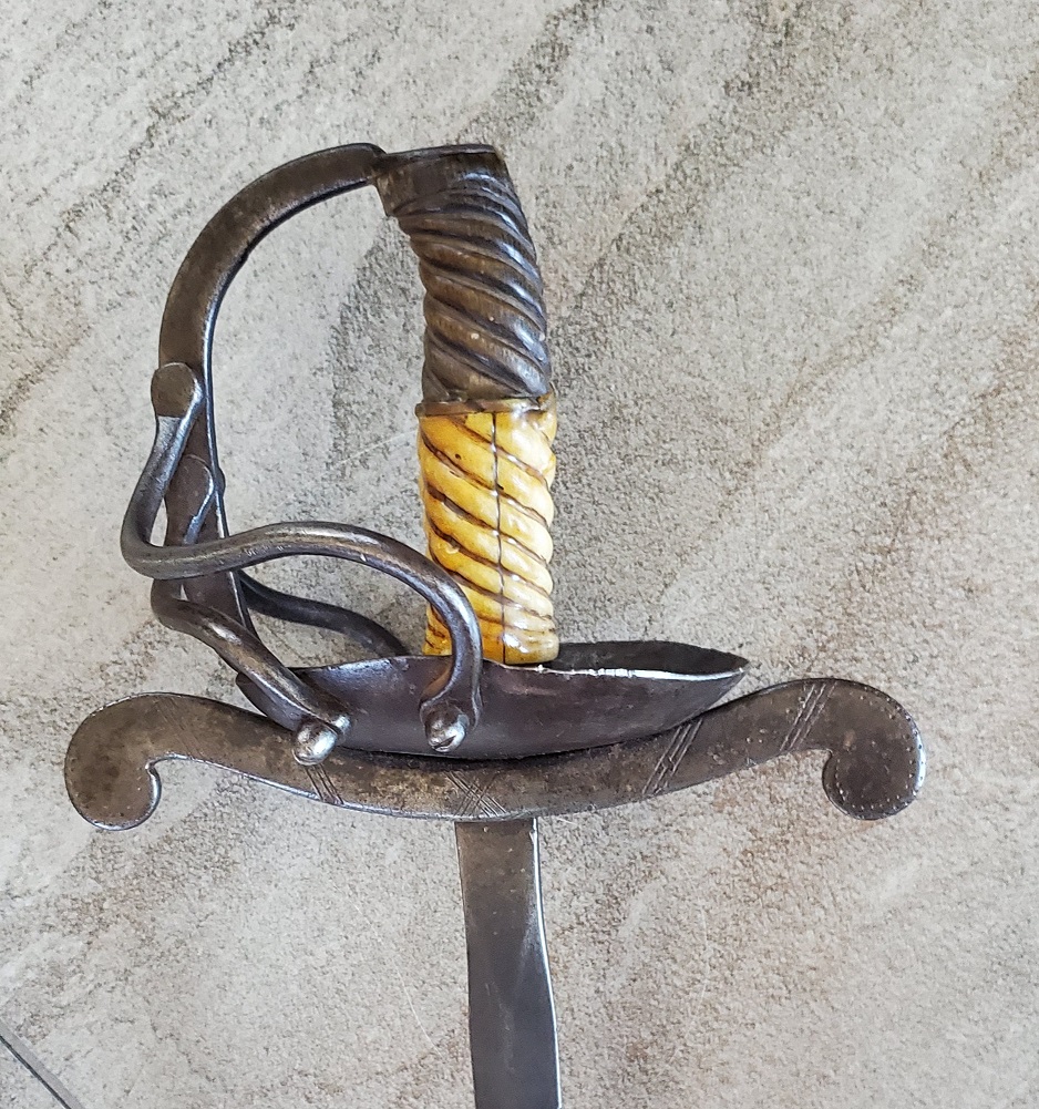

The sword pictured is elementally a rapier, however too small to be regarded as a weapon, more likely either a dress or perhaps practice weapon.
These type hilts are known to have been on swords used during the Mexican revolution period of c. 1810, and in frontier areas, but with more substantial blades.
With this being the case, the suggestion is that some sort of practice or sword drill perhaps was carried out with swords of this type, but far more substantial evidence or accounts are needed. Clearly if this were a practice weapon it would have a button or rebated blade.

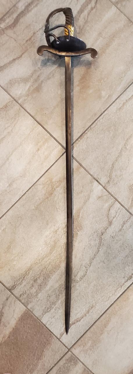

Yesterday I got this 1meter long Colichemarde with functional pas d'ane. A not so small smallsword, probably Spanish.

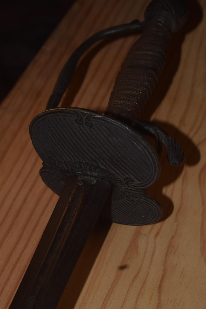

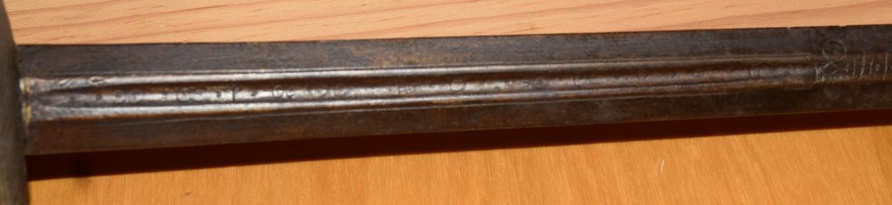

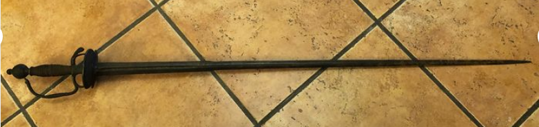

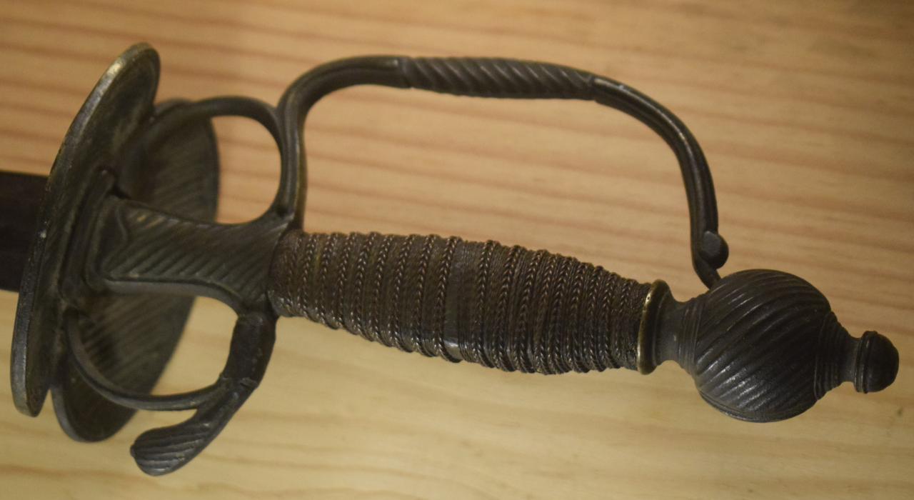

The colichemarde in question arrived, and it had a couple of nice surprises (the original description was very poor). Indeed Spanish with two inscriptions:

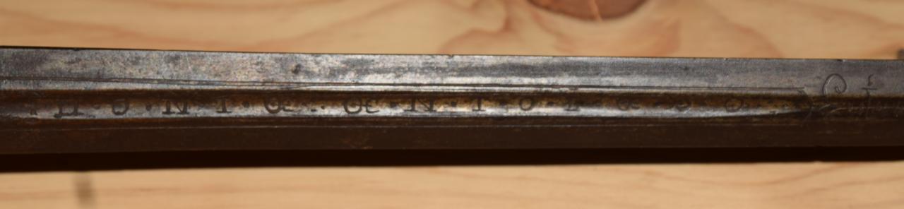

M O N T E E N TOLEDO
D E P E D R O V I E L
Possibly Pedro Biel was the first owner. The blade originally was a rapier one, and only later transformed as a colichemarde. Hilt is filthy, but it could be silver. I will make pictures later.

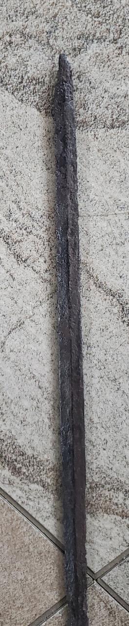

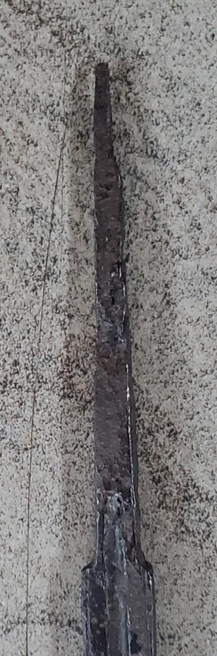

When rapiers ended up in California according to some accounts, the blades were shortened. The one blade (unmounted) I have I think is about 1700, has JESUS one side MARIA the other, a Toledo mark, and about 41" long.
Found in Panama off a shipwreck.
I dont have access presently, but need to get pics of markings.

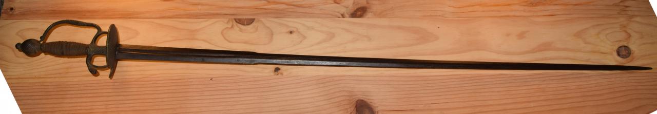

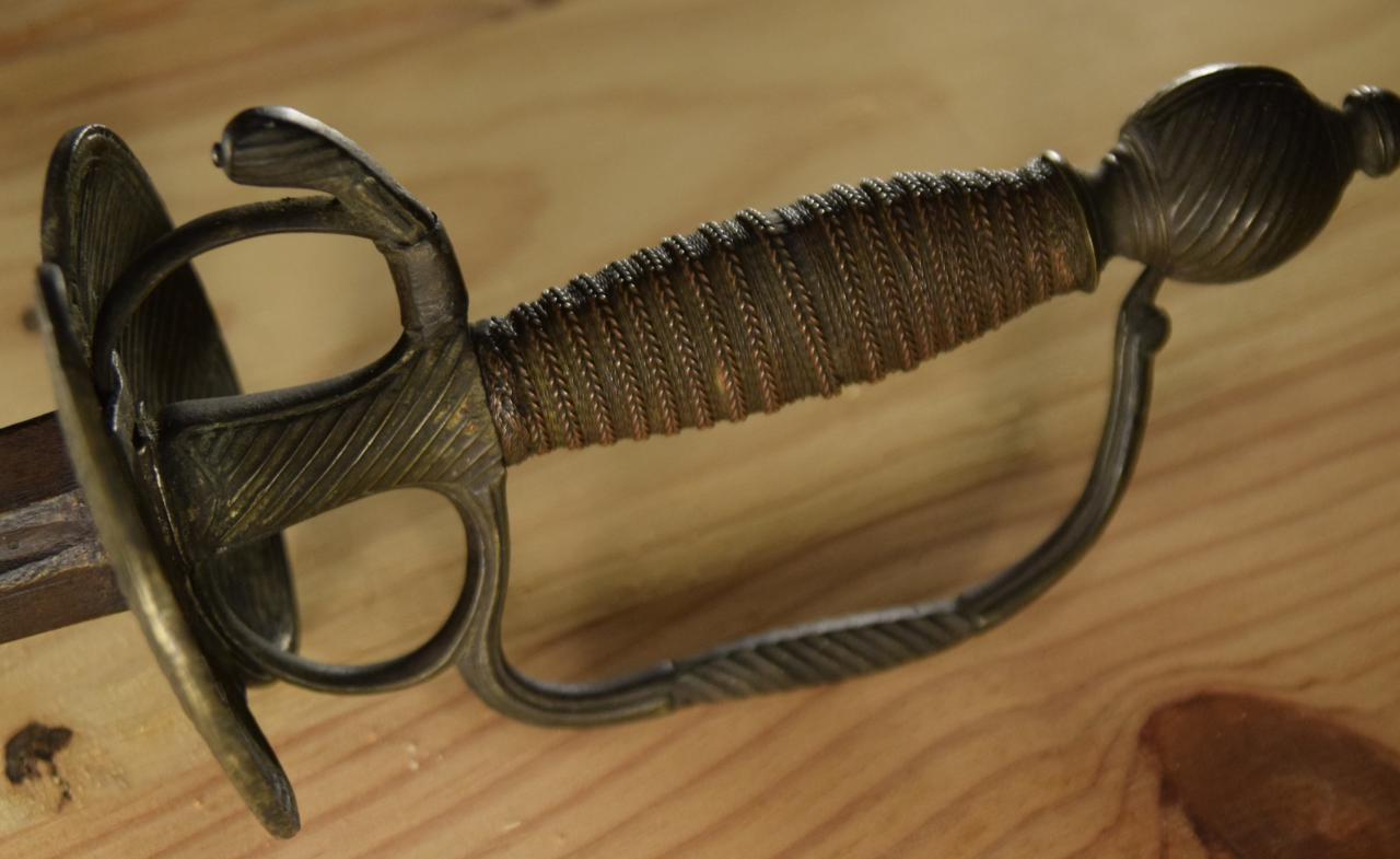

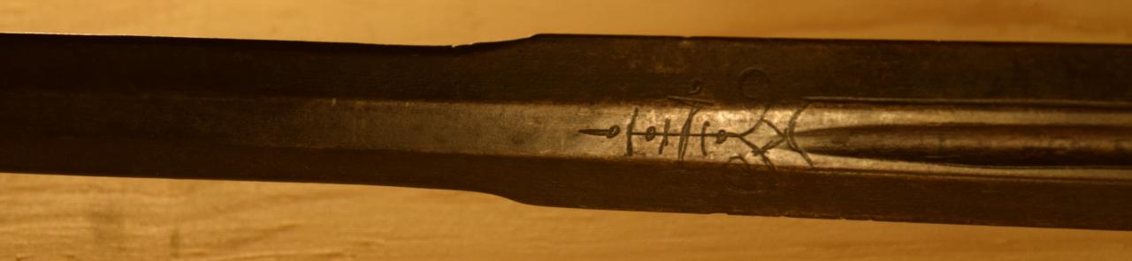

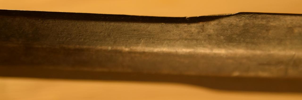

I had a photo session yesterday.
The sword is 1.03 m total length. The blade comes from a Rapier. There are known dated works from this swordsmith, Pedro del Monte, in 1610 and 1630.
I have seen Pedro del Monte described as somebody that made colichemardes, but probably his blades were apropiate to make colichemardes afterwards.
A new bevel has been created, recessed from the original blade, and this has a less acute angle.
Old repair on the hilt. Hilt is brass. Cleaning still proceeding.
Now I believe the inscription, changing sides reads:
D E P E D R O D E E L
M O N T E E N T O L E D O
(No Pedro Viel)
Old 19th February 2022, 01:23 PM   #14
Posts: 10,848
Thank you so much for this follow up!
What is intriguing about this sword is that this very early rapier blade has clearly enjoyed a long working life as the form of the small sword hilt seems around 1770s. The early colichemarde blades were said to have been from honed down rapier blades in 1680s, but blade makers began making them in the broad forte but narrow rapier blade combination soon after.
These were essentially evolved out of transitional rapiers with the advent of the smallsword for a 'faster' weapon, and these were primarily a dueling sword.
The styling of the hilt on this with the diagonal lines resembles a French type I once handled which had provenance to New Orleans during the War of 1812.
As you have indicated, this appears a very early Toledo blade which has been repurposed into colichemarde profile, and the 'anchor' device at the end of the fuller seems 'added' perhaps at this time.
While I dont know the provenance of this particular sword obviously, it is tempting to consider the colonial possibilities. The amalgamation of French style hilt and early Toledo blade does not seem unusual. As the Spanish system of swordplay (destreza) began to give way to French and Italian forms, it is believed to have continued nominally in Spains colonies . While many Spaniards still held to their beloved cuphilts (Castle, 1885) there would seem of course a proclivity to move toward the newer, faster weapons .
I would add here that in styling, French and Spanish were paired closely through Bourbon rule.
Although admittedly speculation, I would simply suggest these possibilities as reasonably plausible, and that this is truly an intriguing example!
