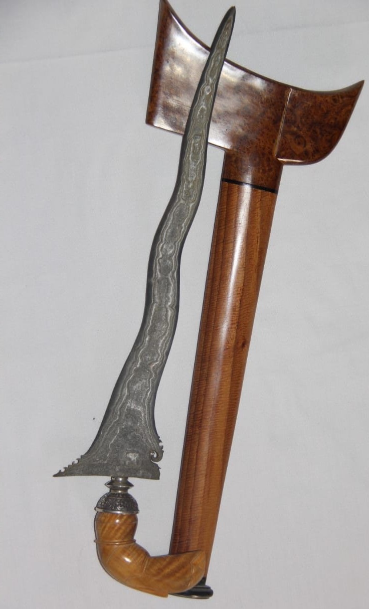

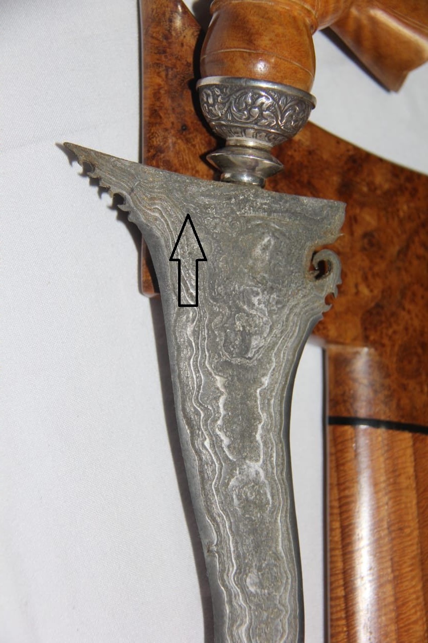

Default Bugis keris gonjo iras
Hi, I asked around and some people told me it is to test the skill of the craftsman while some people said it has spiritual meaning. Anyone knows exactly what is the reason for gonjo iras? I think some Balinese keris also has it.

There are several specimens of Bugis kris blades with ganja iras shown in the reference book "Senjata pusaka Bugis" so it seems to be quite commonly used in Sulawesi.

David, I do not know of any long standing, spiritually tinted explanation for a keris that has an integral gonjo, however, should one wish generate such an explanation, it would not be difficult to do so.
What I do know is that fitting a gonjo to a blade is a painstaking, difficult job.It can be quite frustrating trying to get a neat metal to metal fit.
When making a blade that is intended purely for use as a weapon, it is much easier to simply forge the asymmetric shape into the blade base than it is to spend time fitting a separate gonjo.
If you spend less time making that object, you can charge less for it, you can increase production and make more money. If you make more money you can support more wives and maybe have each of them living in their own house so that there is more harmony in your own house.
I truly do believe that the economic argument for the integral gonjo is pretty hard to move past.
First & foremost the keris was a weapon, then it became a number of other things. The gonjo that we see fitted to very early keris in monumental works very probably was also made necessary by the limitations of forge technology at that time.

If we consider the design of early keris and other keris-like implements, as shown in 1000 year old monumental works, we can very clearly see that these weapons, at this time, did in fact have a separate gonjo.
http://www.kerisattosanaji.com/origin-of-the-keris
The manners in which a keris, or keris-like implement, was held when employed as a weapon dictates that the blade base needed to be sufficiently wide to cushion the hand and forefinger against impact. In many other weapons employed in a similar manner, but coming from other societies, this cushioning effect is achieved by the fitting of a separate guard to the blade.
The keris became an icon of its society of origin as time passed, and it achieved over time, the esoteric interpretations that it now carries.
In early Javanese literary works the keris is depicted as purely a weapon. This weapon function continued for hundreds of years, and still exists, alongside the many & various esoteric interpretations attached to the keris.
