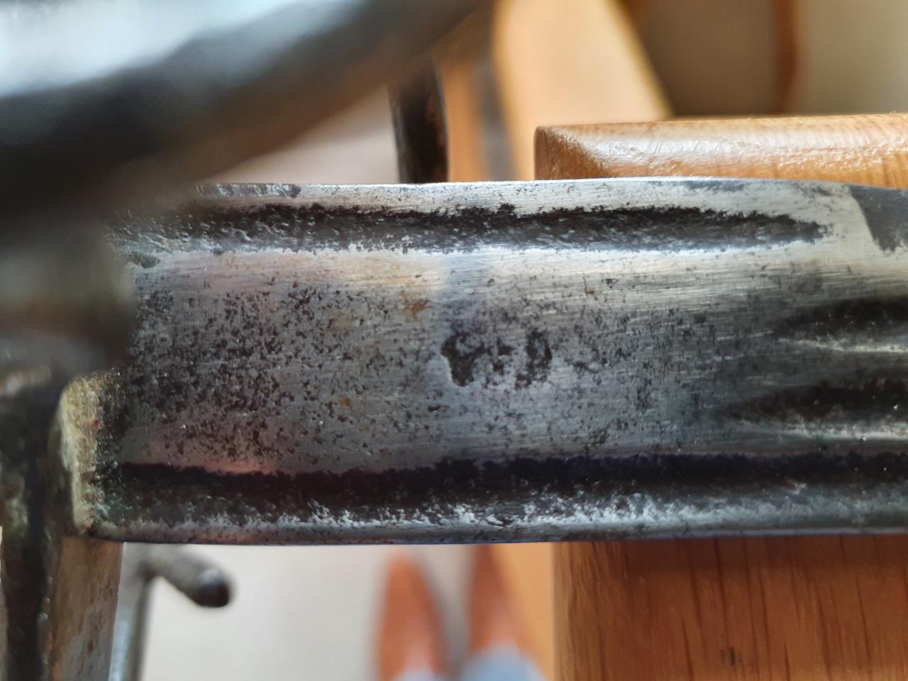

I've got this early English basket hilt aka 'Irish Hilt' and I'm trying to decipher the maker on the blade, who's name is in the middle fuller. Anyone heard of the maker please?
The lines in the fullers read;
Soli Deo Gloria ("Glory to God alone", one of the Protestant Five Solae)
WILHELM TESCHE ZVNEOMEN
Me Fecit Solingen (Solingen made me)
Triarii is offline   Reply With Quote
Old 6th November 2021, 04:10 PM   #2
WILHELM TESCHE, yes. You may use the Search button to find further info on him .

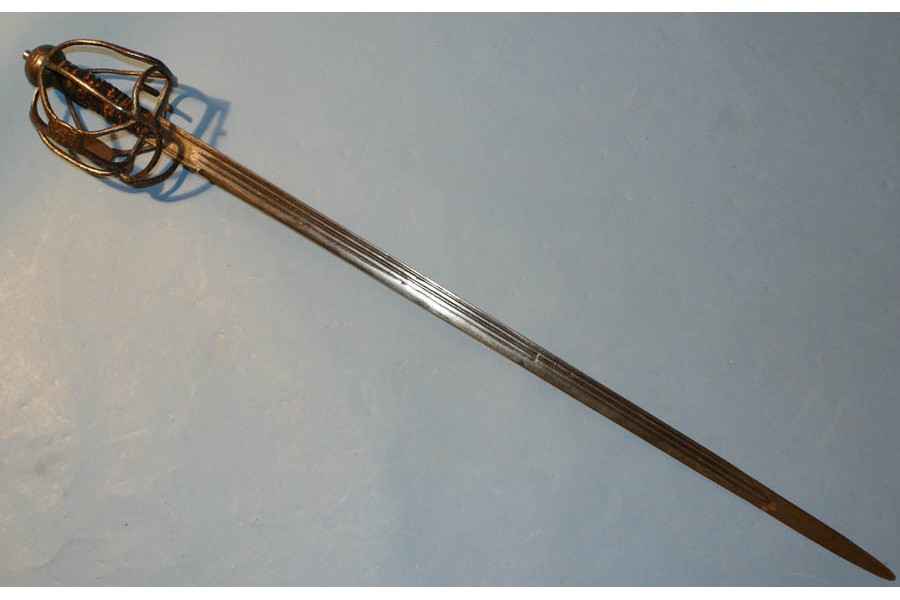

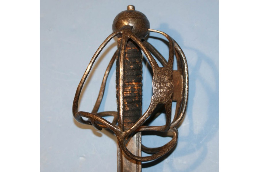

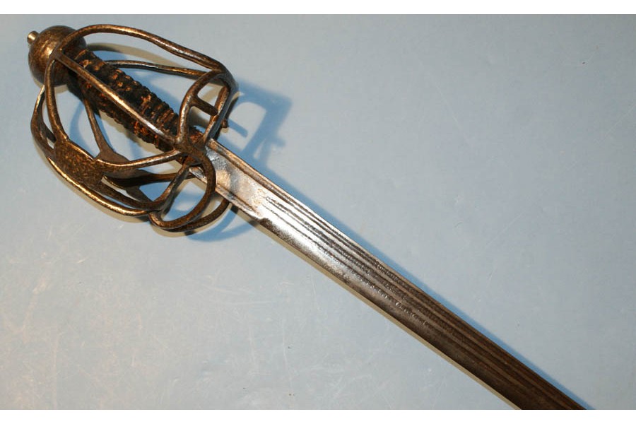

Here's the whole sword. I've realised that 'zutnomen' is German for 'to be attributed' so the 'zuntomen' is a stamping typo or older spelling.
Interestingly, Wilhelm Tesche the elder was active 1590 to 1625 and the younger from 1640 to 1676.

The blade appears single edged, is it?
Old 7th November 2021, 07:36 PM   #8
Triarii
Join Date: Oct 2021
Location: Bristol
Posts: 165
Yes, it's a backsword blade.
Old 7th November 2021, 11:02 PM   #9
Posts: 10,856
That blade type would then place this in the 1620s at earliest into 1640s, as these kinds of backsword blades were prevalent on cavalry swords in that period and well through 18th c. The well known 'mortuary' swords were backswords, and swords worn by British cavalry units were as well.
I have not researched the hilt form, but seems typical of many 'dragoon' forms. The "British' units comprised of course of Scots and Irish used varied forms of basket hilt types, most fashioned in garrison towns by local artisans , some in London by several makers there.
Fascinating area of study (I've been hooked for years!) and VERY nice example!!!

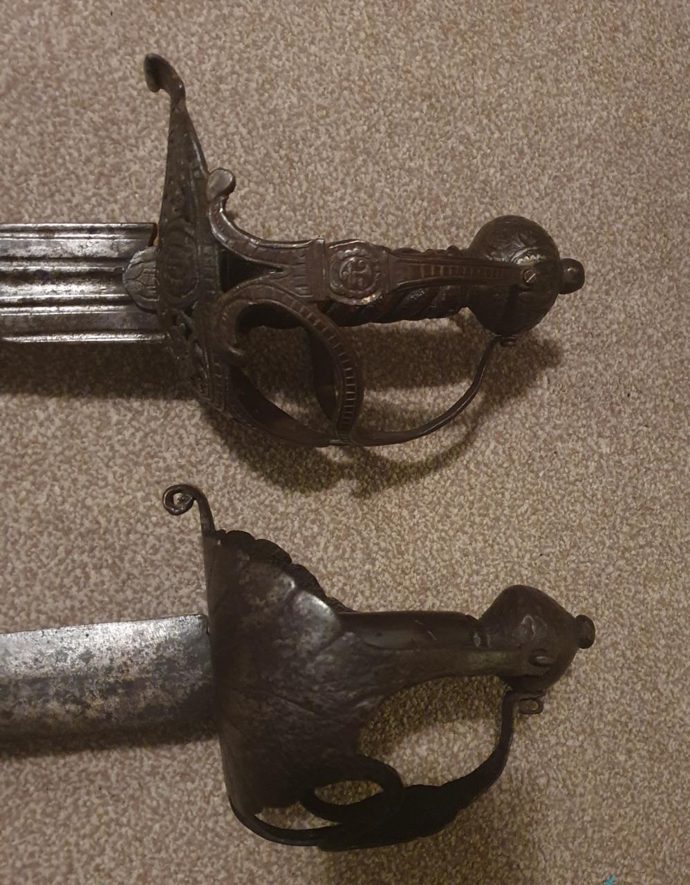

Mid C17th British military history, tactics and equipment are my 'thing' hence the collecting of swords from the period (a move from Georgian ones).
I've found that the basket hilts are more commonly used in the English Civil War in munition and officer quality (eg Lt Gen Massey and Col Hammond portraits) than I thought. One to explore. The long thread on this forum is great.
I have seen the so-called mortuary (and proto mortuary) swords with broadsword blades. I have one, but that's not typical because the blade is likely to be from the early to mid C16th.

I have Stuart Mowbrays book and I managed to get in contact with him about the riding sword featured there, which is in his own collection.
I don't have Mazansky, but I found the 100 page essay by Claude Blair in the Caldwell book really useful in getting to grips with the evolution of the basket hilt.
I'd be very interested in any information you may have on basket hilted sword production in London.
Here's the mortuary sword (and a proto mortuary sword for comparison). My jury is out on whether the latter is for infantry or cavalry use.

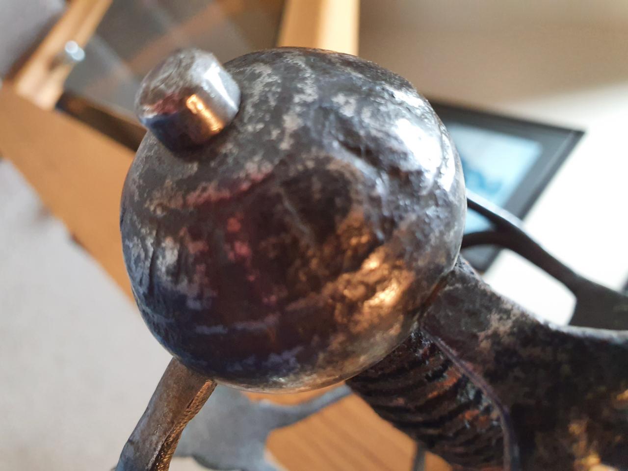

Forgot to say, yes, the new grip on the basket hilt is awful and is on my 'to-do list. The mortuary sword has a latten Passau wolf on it.
The late Mr. Blair's paper on basket hilts is outstanding!
By London makers, I was referring mostly to Jeffries and Drury, who hilted these military basket hilts for infantry units including Black Watch, known to have used these. They turned them in in 1784 as infantry ceased carrying swords.
As far as the range of English basket hilts, there were numbers of them produced in garrison towns such as Glasgow and Sterling, following more Scottish style. Most others were likely produced by many 'sword slippers' in any number of locations.
