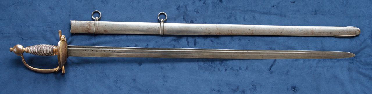

I have an interesting sword coming my way, it is a 1796 Heavy Cavalry dismounted service sword. But instead of the regular double-edged spadroon blade, this sword has been mounted with a backsword blade that is marked 'Andrea Farara'.
From what I have seen the sword does not appear to be an out of period frankensword. The scabbard fits well and looks period made. Also, the sword would have been three times more valuable if it was in a basket hilt, as the blade is in very good condition.
I'm thinking that this is a family blade put in a dress hilt, either for a superior officer or a heavy cavalry officer that didn't want to risk losing a family heirloom on the field of battle. As always this is pure speculation and all comments are welcome.
Video: 1796 Pattern HC Dismounted Service Sword

This is an absolutely beautiful sword, and it does not seem we see many of these. The video is excellent as well, as it shows how well this sword responds to handling, it seems very well balanced.
The term spadroon is always confusing as it derives from Italian and German fencing styles using lighter swords, but in England became a fashionable term used for single edge officers swords in 1780s into early 1800. It seems that mostly it is used for stirrup hilt straight sabers of the 'five ball guard' type. These were used 1780s into early 1800s, and became the model for French swords of the type as well as the American eagle head pommel swords into 1820s.
The blade appears to be of the regular cavalry backsword forms used from 1770s to 1790s. Obviously of course the ANDREA FERARA markings are spuriously added, but in degree following the convention of that makers named applied to Scottish basket hilt blades in the 17th and 18th centuries.
Only physical handling and close up forensic examination can say if the sword and blade are homogenous, but as well balanced as it appears being handled I think optimistically. My only concern is the unusual application of the Andrea Ferara marks.
This does not appear to be a heirloom blade from the early basket hilts of the early part of the century, but the notion of adding this marking might well suggest a Scottish officer of cavalry unit.

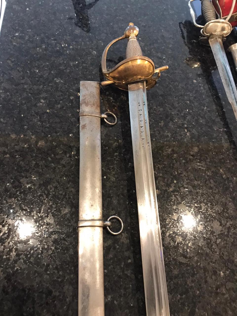

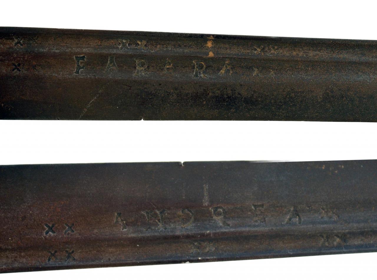

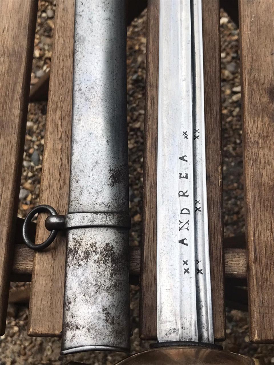

Here is a photo of the markings from one of the swords I mentioned earlier:
Old 8th October 2021, 07:38 PM   #6
Radboud
Join Date: Sep 2021
Location: New Zealand

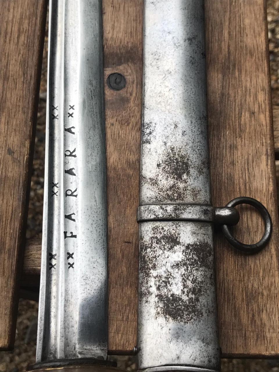

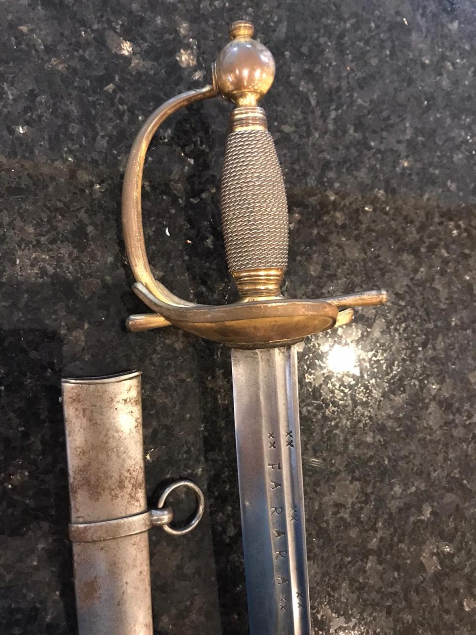

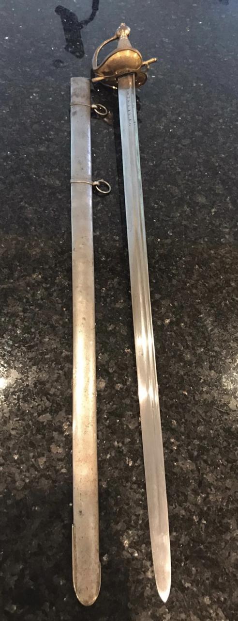

Posts: 303
Here are the photos the vendor sent me of the markings plus a couple of the sword

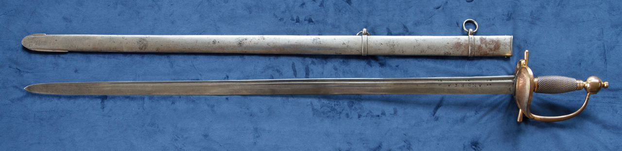

Apologies, I meant to add this one as well:

This is more bizarre than I thought. This is a heavy cavalry M1796 sword scabbard of the standard troopers form, also of the 'ladder hilt' pattern carried by officers.
Apparently in little known circumstances which have been remarkably researched by Richard Dellar (author of "The British Cavalry Sword: Some New Perspectives"2013) and presented in his "Did the French National Manufactory at Klingenthal Make British Blades ?" ("Man at Arms" Vol.43, #4, Aug. 2021),
there are some interesting possibilities.
As the author notes, despite the compelling evidence that some blades were mounted with Klingenthal markings, these may have been Solingen blades may have been acquired from there as surplus after the end of the Runkel enterprise.
This was during the post Waterloo occupation of Paris. Several British officers had weapons that needed refurbishing and contacted the Klingenthal works, known for high quality blades. However as they did not have the necessary patterns to produce the British heavy cavalry blades , they used contacts in Solingen to acquire a number of blades. As noted these 'anomalies' have turned up with Klingenthal markings.
After this "...other British officers followed suit and ordered replacement blades either as a result of damage or for ENHANCEMENT".
Could it be that this blade, which is basically of the width and profile of a heavy cavalry blade of the heavier form of 1796 for combat, was made at Klingenthal or in France in this situation ? If being commissioned privately for 'enhancement' the Andrea Ferara might have been so placed.
Clearly this is a tenuous suggestion, but the remarkable evidence in the Richard Dellar article offers compelling plausibility.
These swords all have such stories to tell!

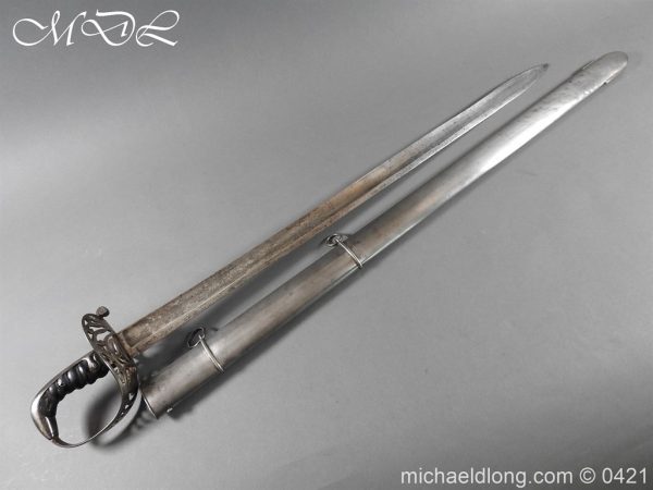

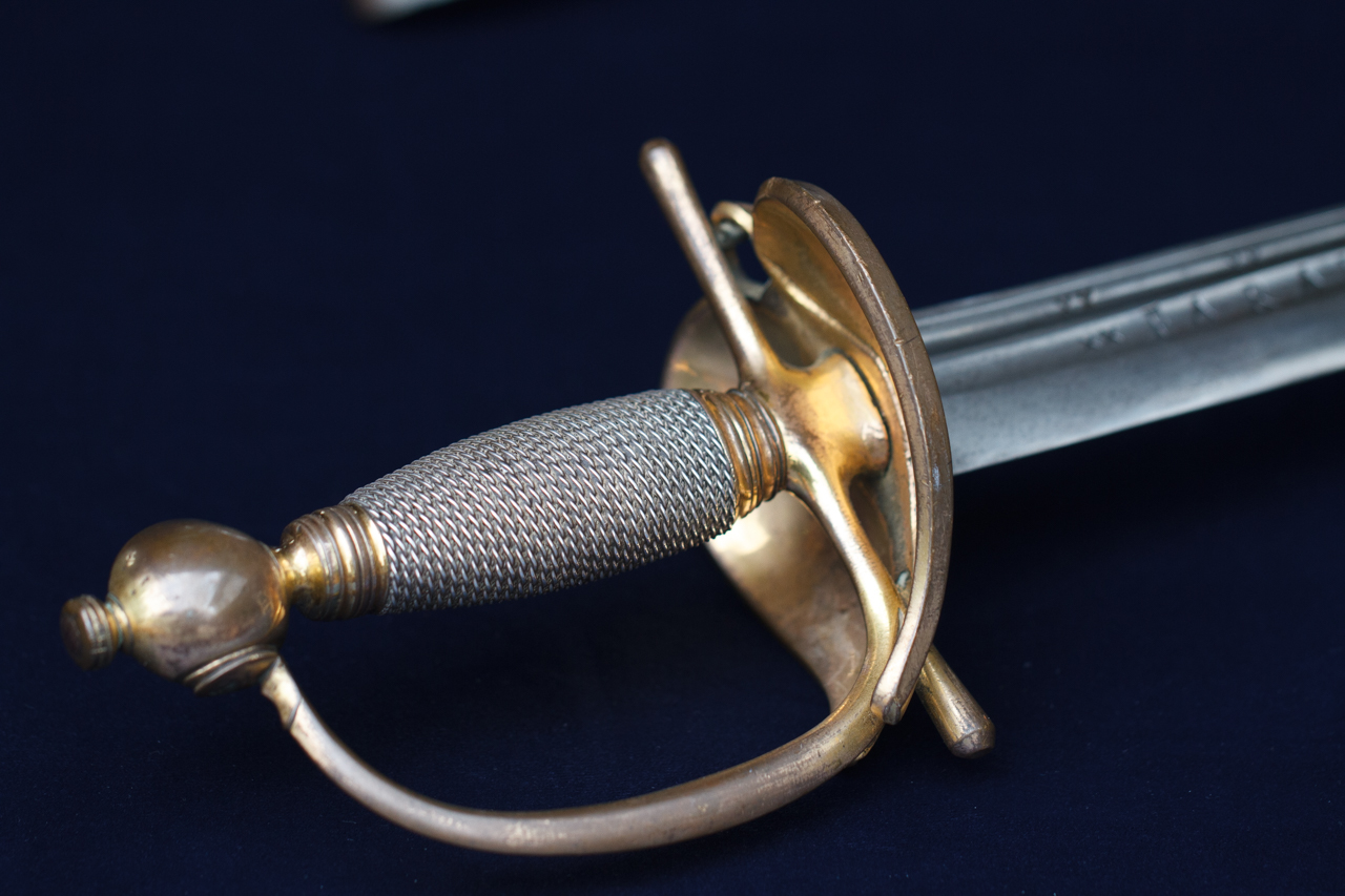

This image (from MDL, for informational purposes only, not in stock) is the M1796 heavy cavalry officers 'honeysuckle' or 'ladder' hilt noted.,

Thank you for your comments. I still think this is more of a backsword blade of the profile of the basket hilt swords from the time, especially with the double fullers. Most 1796 HC undress swords I’ve seen have the single broad fuller and follow the shape and style of the trooper version.
But like you say the scabbard is of the heavy cavalry style.

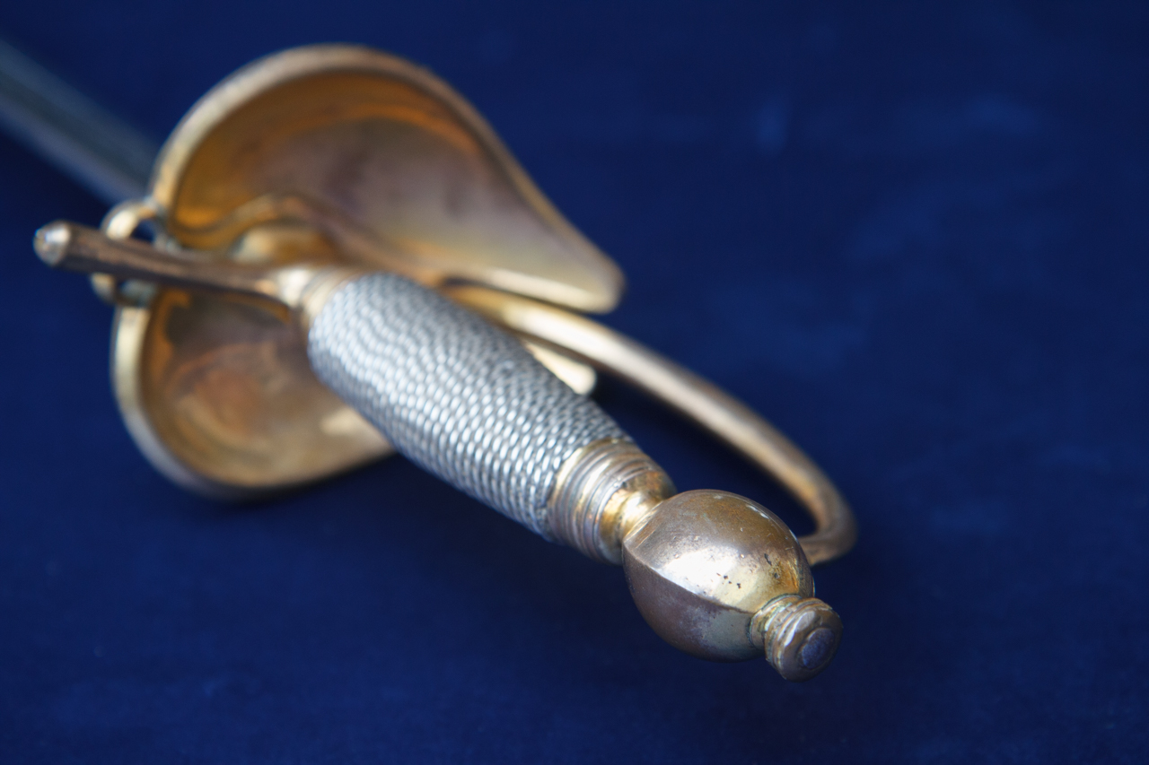

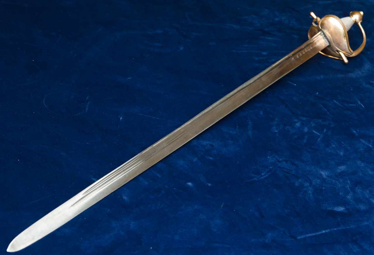

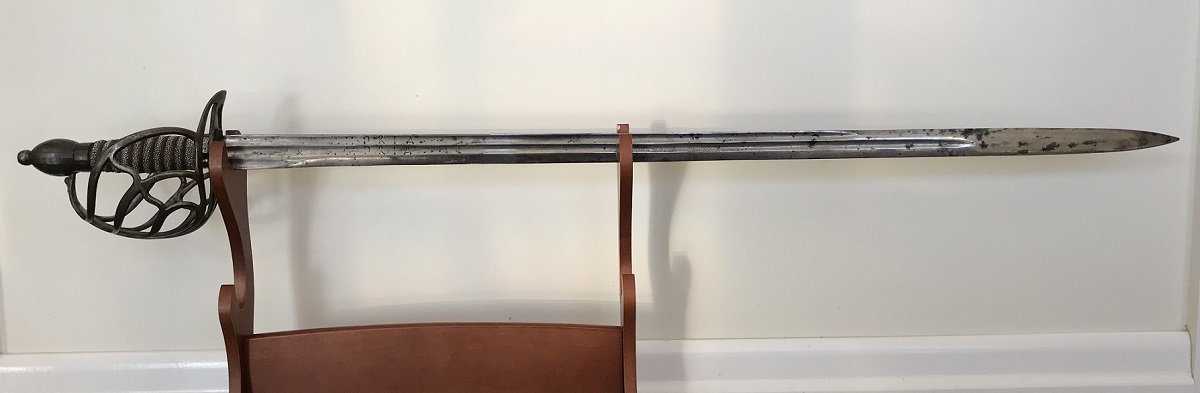

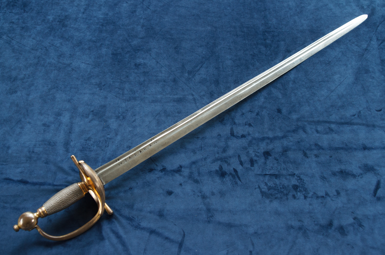

So the sword finally arrived yesterday and I was able to take some photos of it and get more of an impression of it in the hand.
The stats are:
Length Over All: 975 mm
Blade Length: 823 mm
Point of balance: 125 mm
Sword Weight: 870 grams
Total Weight: 1250 grams
Guard
- Length (Across the hand) 125 mm
- Width (Across the hand) 87 mm
- Height (Including langets) 21.9 mm
- Thickness 2.0 - 4.0 mm
- Inside (Grip to guard) 39.7 mm
Grip
- Outside Length 135 mm
- Inside Length 100 mm
- Width 31.7 to 17.9 mm
- Thickness 24.0 to 20.0 mm
Blade Width Thickness Thickness Inside Fuller
- Ricasso 32.0 mm 6.1 mm 3.8 / 5.2 mm
- 200mm 28.9 mm 4.5 mm 1.9 / 2.8 mm
- 400mm 27.7 mm 3.2 mm 2.0 / 2.5 mm
- 600mm 25.2 mm 2.7 mm 1.3 / 1.5 mm
- 800mm 16.5 mm 1.3 mm
My initial thoughts are that while the stats appear fine on paper and the sword balances fine, I don't think that the grip is optimal to the style of fighting this type of blade favours i.e. cut over thrust. But when held at the lower end of the grip it feels serviceable. Naturally, these are just the opinions of someone who has never trained in sword fighting.
