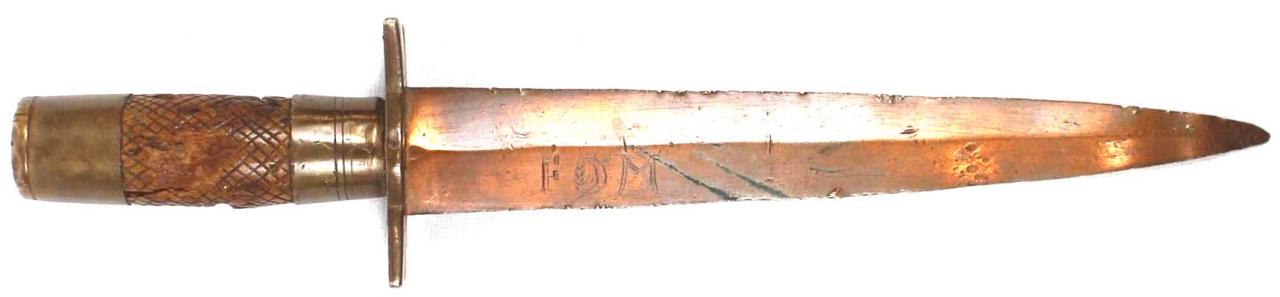

Greetings folks,
I got this copper dagger several months ago. The blade is all copper and so are the mounts. The initials "FDM" are engraved onto one side of the blade.
I have no idea where this is from and I've not seen its like before. Is it American? Filipino (1900)? European?
Any assistance is welcome.

Location: Russia, Moscow
Posts: 379
It is often difficult to distinguish between daggers from French Indochina and the Philippines.
Old 10th September 2021, 01:15 PM   #3
David R
David R's Avatar
Join Date: Jan 2011
Posts: 1,164
Going by what I have seen here on this site, it's Philippine and specifically for use against supernatural threats.

Old 11th September 2021, 02:04 AM   #6
Posts: 4,738
Hi Jose,
I also think your knife is from the Philippines--Central or Northern Luzon. Rick's is a bit harder to place given the hilt style, but could also be from the Philippines. Apart from a non-specific "spiritual purpose," I don't have anything to contribute. Sorry.
Old 11th September 2021, 10:59 AM   #7
Hello Jose,
Another vote for Philippines and Luzon.
The one from Rick is from Batangas I guess, see this thread: http://www.vikingsword.com/vb/showth...ghlight=copper

Old 11th September 2021, 03:18 PM   #8
ausjulius
Location: musorian territory
Posts: 497
those nonferrous bladed knives are a cultural thing among malayian cultures though out south east asia.. its for "fighting spirits" ive seen people in the 21st century carrying small brass, copper or sliver kris around rolled up in their sarongs to protect from bad magic . ect

Hi Bob! It is for this reason that I do not want to dive into details
Old 11th September 2021, 11:58 PM   #11
Posts: 7,409
Thank you folks. I'll land on Luzon, but musty admit that I haven't seen a copper knife like this from the Philippines, or any PI knife like this.
However, I agree with the copper being used to dispel evil spirits.
I got this hoping that it might still be Filipino, but knowing the risk it might not. Now to figure out the meaning of "FDM"..........
Old 12th September 2021, 01:54 AM   #12
Bob A
Join Date: Feb 2014
Posts: 469
The blade profile is similar to the Applegate-Fairbairn fighting knife developed in WWII, though the hilt is different.
If I had to choose between American, European and Philippine origin, I'd strongly favor Philippines.

Old 12th September 2021, 04:04 PM   #13
Hello Jose,
Remember the great copper and brass dagger collection from Robert.
Old 12th September 2021, 04:08 PM   #14
And here: http://www.vikingsword.com/vb/showth...ghlight=copper you can find a lot of information about non ferric daggers from the Philippines.

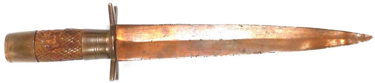

Old 13th September 2021, 04:33 AM   #15
Posts: 7,409
Thank you Detlef for the links. What threw me for a loop was the hilt: 1. how it was scored, 2. how the cross guard is made in the form of an "X" (though one could argue that it fits Philippine thinking), 3. how the mounts were made, 4. how badly beaten up the blade was. None of the examples I have seen (even on our site) matched this. However, I am aware that the Philippines, places in Indonesia, and Malaysia used copper blades for chasing away evil spirits. So again I took the chance that this is indeed a Filipino blade.
Almost nothing is documented on these except what Robert was fortunate to acquire.
Old 17th September 2021, 01:46 AM   #16
ausjulius
Posts: 497
i have several small brass, nickle and silver bolos, kampilan and kris from the phillipines.. from several different regions.. some of the ones from sulu have arabic inscriptions on them to ward of evil sprits.. its definatly a thing.. ive met people in the 21st century in indonesia carrying such little "magic" knvies around in their sarongs.... they sure have declined in popularity and maybe even vanished in amny malayian peopls societies in the 20th century.. but they were probably once universal..
Old 22nd September 2021, 01:56 AM   #17
Posts: 7,409
In this thread Bangkaya states that copper and brass were used to fight aswang spirits.
http://www.vikingsword.com/vb/showth...309#post266309
More of the mystery solved.
